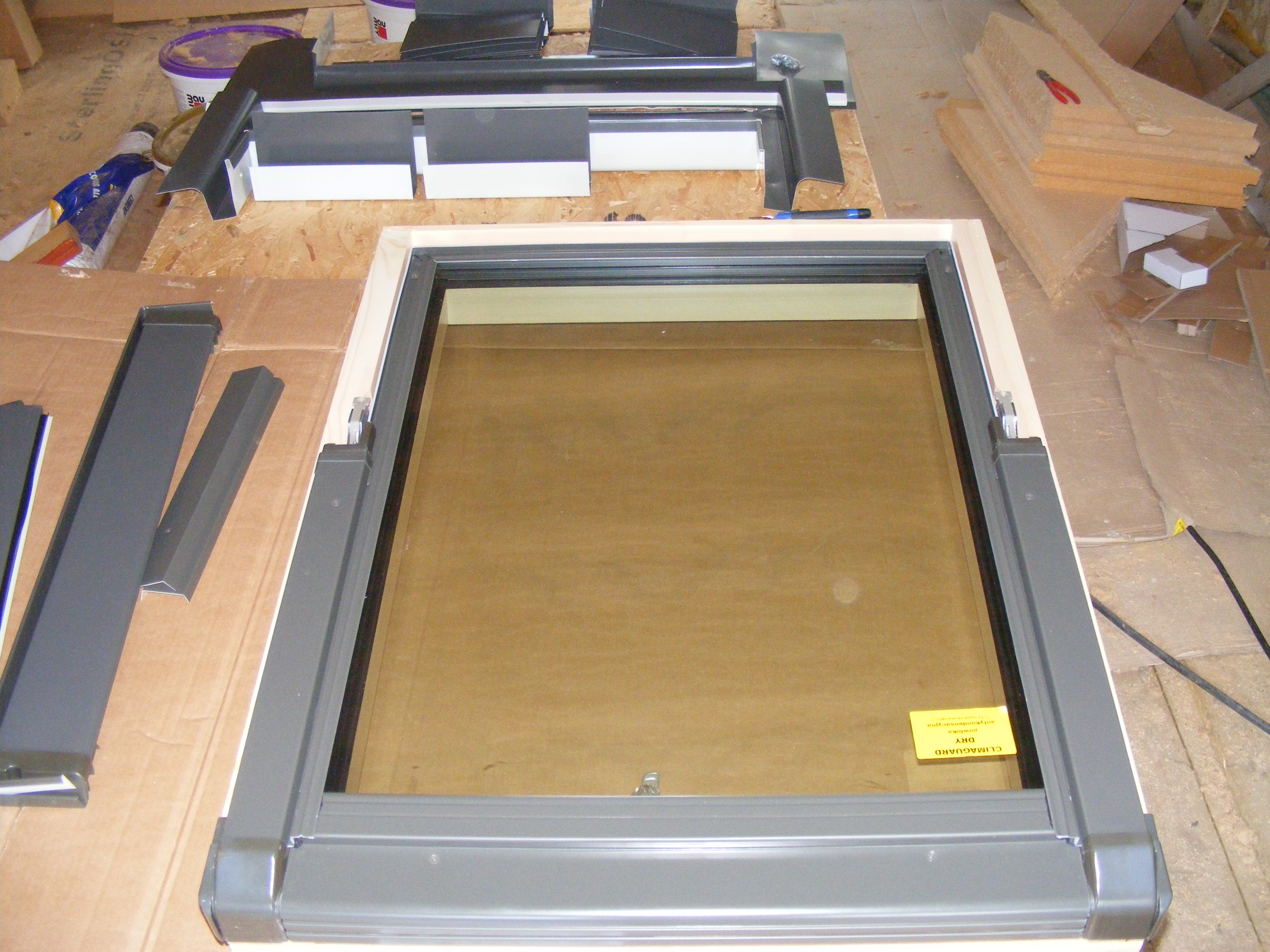

ProDave Posted July 21, 2016 Share Posted July 21, 2016 As the title says, I am looking to buy a roof window for my plant room, size 780mm wide 980mm high. Ideally I want triple glazed and no trickle ventilator. I haven't found any of the on line suppliers listing 3G roof windows, so thought before wasting more time I would ask the forum for anyone who has bought one and knows a good supplier. It will probably be Fakro or Velux and if similar price I would choose Fakro to get the handle at the bottom. But also worth discussing is how much premium is it worth paying in the real world to get triple glazing and no trickle ventilator? The standard 2G Fakro is being advertised by the loft shop as a U value of 1.3 and it's on offer for £169 there at the moment. and do I really need one without a trickle ventilator? the Velux roof windows in our present house, when the ventilator is shut it does seem to be a pretty air tight seal, so is that an expensive option not really worth bothering with? Link to comment Share on other sites More sharing options...

ProDave Posted July 21, 2016 Author Share Posted July 21, 2016 Looking at Sterling build, they have (in the size I want, 3G) Fakro £301.50 Velux £321.60 Roto £446 ECO+ £221.73 Anyone know anything about the ECO+ roof windows, it seems very cheap. This one https://www.sterlingbuild.co.uk/product/ECO-centre-pivot-pine-triple-glazed/eco-centre-pivot-pine-triple-glazed-roof-windows-78x98cm They offer that with free delivery and specifically mention the Scottish Highlands are included in that free delivery. Link to comment Share on other sites More sharing options...

ProDave Posted July 23, 2016 Author Share Posted July 23, 2016 I have collected prices and U values for a lot of different roof windows now, so thought it was worth tabulating the information. This is all for size 780 by 980 roof windows, centre pivot, wood finish internally. No special options like anti noise etc. Dakeu 2G U=1.4 £110 Rooflight 2G U=1.5 £133 Fakro 2G U=1.2 £186 Velux 2G U=1.3 £201 Eco+ 3G U=1.0 £221 Roto 2G U=1.2 £222 Facro 3G U=0.97 £301 Velux 3G U=1.0 £321 Facro 4G U=0.58 £1044 All prices ex VAT and delivery I still think the Eco+ 3G at £221 looks a good bet so I am likely to buy one and see. If it does turn out to be good, I have another two to buy later on. The last one, the Facro 4G at over a grand, shows to me a rather high cost for a small benefit that would have a stupidly long payback time. 2 Link to comment Share on other sites More sharing options...

ProDave Posted August 22, 2016 Author Share Posted August 22, 2016 It's here, it arrived today. First impressions are it's reasonably well made. The trickle ventilator is an opening strip across the whole top of the window. I suspect when it's closed it's not a brilliant seal. Fitting the window itself looks straightforward. The flashing kit looks very complicated, however I am not convinced I have the right flashing kit so I'm discussing that with the supplier at the moment. Link to comment Share on other sites More sharing options...
