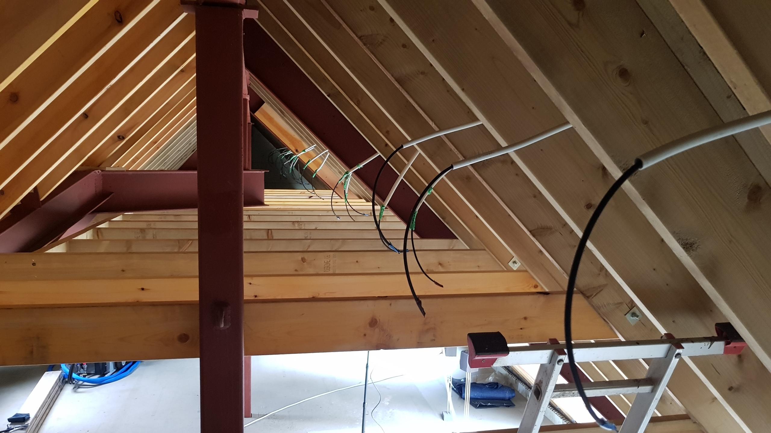

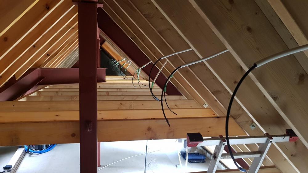

Nickfromwales Posted August 26, 2018 Share Posted August 26, 2018 On 24/08/2018 at 10:03, Alexphd1 said: We looped cable from every panel into the loft space with a connection. This will allow easier maintance and repair down the line, I have not seen anybody else do this. Not to sure how to advice on inverters I don't have any first hand knowledge. All seem to have a life span and don't seem worth to repair. SMA sunnyboy inverters have been in the game along time and we picked up one in a bulk solar thermal purchase. If you have shading on roof look at ditching the single inverter and sticking on micro inverters on to each panel ( this was another reason we looped cables into loft space as we have trees but are planning to cut these back). I am currently adopting this discipline for all new PV enquiries Its a no-brainer AFAIC, and means that you only have to go back on the roof if a panel snuffs it. Beware doing this as the manufacturer warranty can be voided if you dont use the connectors / connection method they stipulate. TBH the correct connectors were pennies on a 5.4kWp array so no point in not adhering to that regardless. My knee-jerk was to solder and heat shrink, but the supplier of the ( LG iirc ) panels said they should remain locally demountable and soldering wouldnt perming that. Makes sense upon reflection its just I would have soldered them without as second thought as your guaranteed a low resistance life-long joint that way. As there will be an E / S mix of elevations I suggested ( after a nudge from @PeterW ) they went for single panel optimisation, ( attic mounted in one unified location where access is clear, decked and lit, for the MVHR unit ), and then from the attic down to the garage where the inverter will reside directly below the CU. Solar Edge inverter with Export Limitation set for 3.85kW cut off, ( so no dancing around the DNO ), and with a 12 year warranty and dry capacitors make them my No.1 choice. On 24/08/2018 at 10:03, Alexphd1 said: quick check 300w black 8.33 solar (longest preformance manufacturer warranty I have seen but bit sceptical of 20 year warranty) is £110 each plus vat. You can get a better deal on quantity. Yup, very long warranty available with certain panels / manufacturers, but in fairness I don't see LG disappearing overnight so am confident with that warranty tbh. Link to comment Share on other sites More sharing options...

Alexphd1 Posted August 26, 2018 Share Posted August 26, 2018 Regarding cables warranty, we made up extra 2m mc4 male/female cables and looped them into with a extra connection inside. The panel connectors are still between the panel and flashing. I was warned if we do anything to the mc4 connector on the panel the panel warranty would be invalid. 1 Link to comment Share on other sites More sharing options...
Nickfromwales Posted August 26, 2018 Share Posted August 26, 2018 18 minutes ago, Alexphd1 said: I was warned if we do anything to the mc4 connector on the panel the panel warranty would be invalid. Cheers, and +1 to being told that. Couldn't remember the name of the connector. Link to comment Share on other sites More sharing options...
Alexphd1 Posted August 26, 2018 Share Posted August 26, 2018 Hopefully manage to wire them up in the rite order......?? Link to comment Share on other sites More sharing options...
PeterW Posted August 26, 2018 Share Posted August 26, 2018 Are you using micro inverters on that or just a single inverter and optimisers as I’m not sure you are supposed to mount micro inverters inside as they need a constant flow of air to cool them. Link to comment Share on other sites More sharing options...

Alexphd1 Posted August 26, 2018 Share Posted August 26, 2018 (edited) @PeterW we will be running a single inverter in the garage, it is a concern with cooling if did go the micro inverter route but hopefully the single inverter will work fine. I suppose we could run a extra MVHR intake and exhaust across the loft space, we have plenty of spare power in the MVHR unit??? Edited August 26, 2018 by Alexphd1 Link to comment Share on other sites More sharing options...
