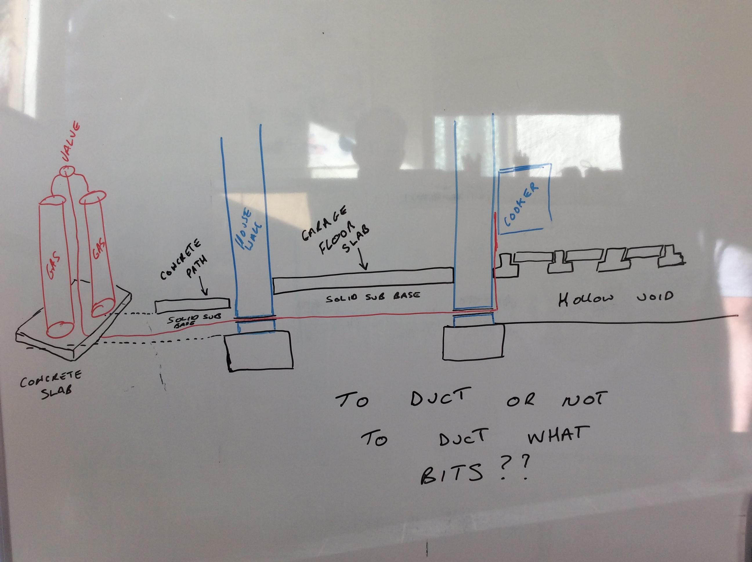

Russell griffiths Posted July 27, 2018 Posted July 27, 2018 Opinions please trac pipe under a block n beam floor. In a duct or concrete covered to protect it whilst building works continue or trac pipe pipe under solid concrete garage floor ducted or not. Cheers russ.
PeterW Posted July 27, 2018 Posted July 27, 2018 Why TracPipe..? Can you not get the entry point closer to the appliance ..?
Russell griffiths Posted July 27, 2018 Author Posted July 27, 2018 36 minutes ago, PeterW said: Why TracPipe..? Can you not get the entry point closer to the appliance ..? Not really, unless I want 2 cylinders sitting in the kitchen. Trac pipe? What else can I use supply will be from 47kg propane cylinders mounted outside the garage, pipe needs to run under solid garage floor and then under block n beam house floor will measure distances later out side will join to 2 cylinders via a change over valve inside will feed a 5 ring gas hob only. What are the other options as Trac pipe is dear as poison.

Russell griffiths Posted July 28, 2018 Author Posted July 28, 2018 Does this make a bit more sense. @Nickfromwales @PeterW
Nickfromwales Posted July 28, 2018 Posted July 28, 2018 (edited) That should be fine, and done in copper too. If all of those sub floor voids are ventilated then that won't be a problem. They just frown on you having a leak and charging a small cavity, whereas they're not so bothered about the larger ones. Duct from the bottles until the 'hollow void' with the duct sealed the dwelling side, and the other end of the duct visible and exposed to atmosphere. If a leak occurs it'll transport the gas to outside where it can be detected. Remember you only need 15mm, 22mm is way overkill. Edited July 28, 2018 by Nickfromwales Bold text altered ? 1

Russell griffiths Posted July 30, 2018 Author Posted July 30, 2018 After having a good look on the tracpipe website, it states that for all LPG installations any pipe entering a building must be above floor level can you shed any light on this @Nickfromwales is LPG heavier than natural gas or something so they don’t want it in a floor void. If this is the case it looks like I will have to run it surface mounted across the garage like @Alexphd1 suggested. Bloody hell life shouldn’t be this hard.
ProDave Posted July 30, 2018 Posted July 30, 2018 Is this because LPG is heavier than air so will pool in a sump? I guess (hope) my buried pipe is okay as it is sleeved and exits above ground level outside.
Nickfromwales Posted July 30, 2018 Posted July 30, 2018 Heavier, yes. TBH running it through the garage isn't a bad option.
Nickfromwales Posted July 30, 2018 Posted July 30, 2018 2 minutes ago, ProDave said: Is this because LPG is heavier than air so will pool in a sump? I guess (hope) my buried pipe is okay as it is sleeved and exits above ground level outside. Does it run downhill to outside, and is the duct end open to atmosphere?
ProDave Posted July 30, 2018 Posted July 30, 2018 1 minute ago, Nickfromwales said: Does it run downhill to outside, and is the duct end open to atmosphere? yes and yes (for now) though where it exits will get filled in with rocks as a French drain later on. It's a continuous run of pipe off a coil, no joints in the duct.
Nickfromwales Posted July 30, 2018 Posted July 30, 2018 3 minutes ago, ProDave said: yes and yes (for now) though where it exits will get filled in with rocks as a French drain later on. It's a continuous run of pipe off a coil, no joints in the duct. As long as trapped gas can get to atmosphere where it will naturally dissipate then you'll be fine. If that duct end will allow gas to fall to the void below the house then it could be an oops moment.
ProDave Posted July 30, 2018 Posted July 30, 2018 21 minutes ago, Nickfromwales said: As long as trapped gas can get to atmosphere where it will naturally dissipate then you'll be fine. If that duct end will allow gas to fall to the void below the house then it could be an oops moment. The duct is buried under the concrete sub floor so below the void so I can't see that happening.
Nickfromwales Posted July 30, 2018 Posted July 30, 2018 Just now, ProDave said: The duct is buried under the concrete sub floor so below the void so I can't see that happening. As long as the integrity of the duct is good then shouldn't be a concern.
