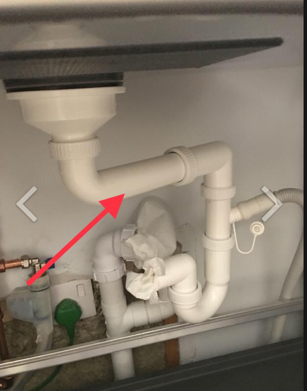

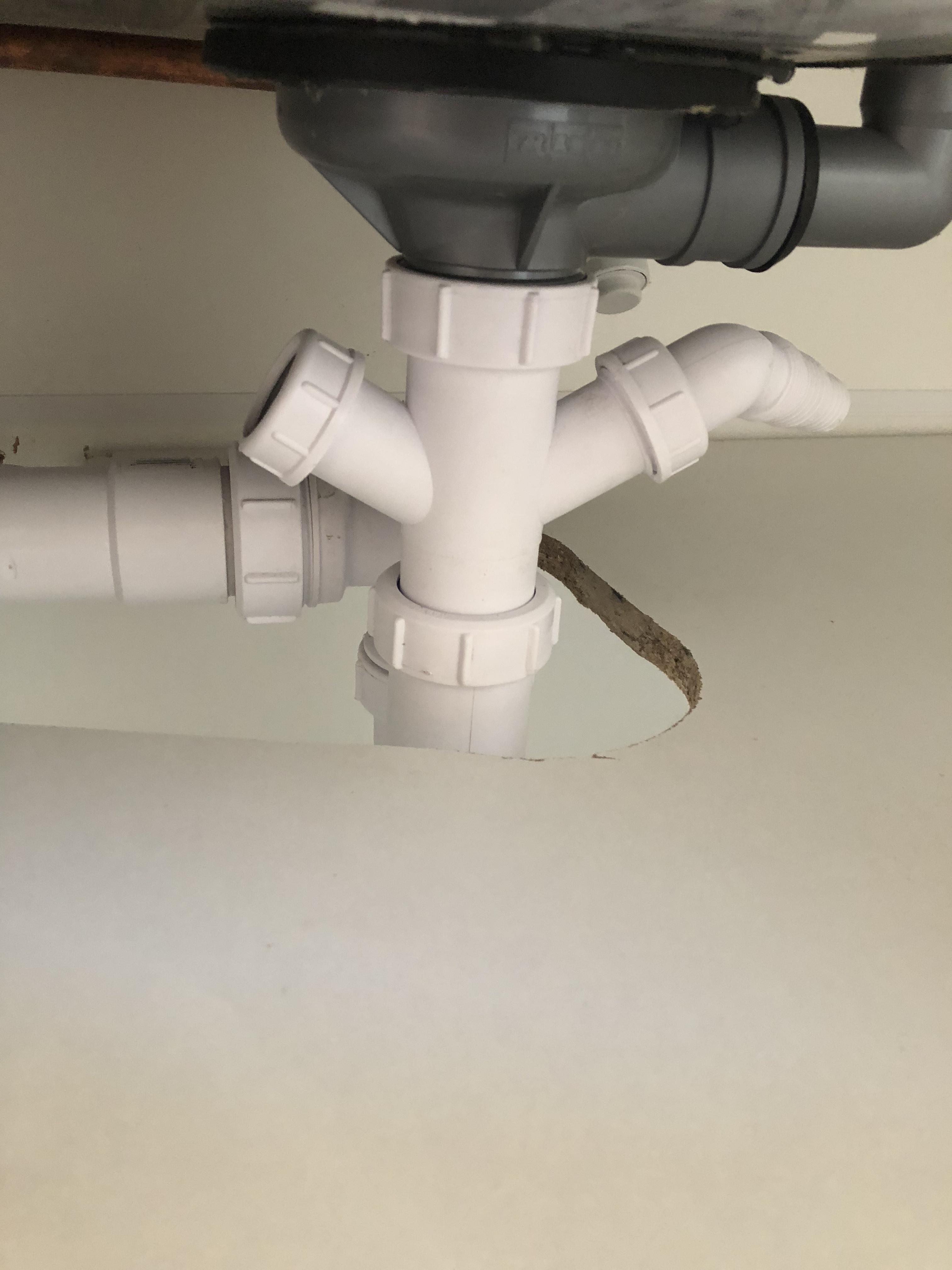

lizzie Posted July 28, 2018 Author Share Posted July 28, 2018 (edited) @Nickfromwales I think it was plumbers they have done a very peculiar connection in the cupboard under the kitchen sink, they have all connections for waste from utility/washing machine/kitchen sink/dishwasher going into one. They blanked off the utility waste for some reason. The incoming water is as much of a pigs ear and the whole installation is very noisy in the kitchen when washing machine is draining in utility. I think making me wait 4 days to come out and look at their install is pretty naughty. I have everything off on isolation valves but no kitchen water etc for 4 days is a pain. i fitted the Grohe device because we have all that plastic piping up in the ceiling and its got all the MBC pumped insulation around it so a leak would take a while to show and I wanted to know if anything was going on before the ceiling came down. I'm a bit old fashioned always had copper pipes I could go up in the roof and look at, this system of plastic buried in insulation is a worry for me......I am a bit of a worrier if I cant see what is what. It was me that found the device and asked for it to be fitted, plumbers thought I was mad! Edited July 28, 2018 by lizzie Link to comment Share on other sites More sharing options...
Nickfromwales Posted July 28, 2018 Share Posted July 28, 2018 I would tell them to call out immediately or foot the bill for someone else to come out. 4 days is BS. Any pics of the waste etc? 1 Link to comment Share on other sites More sharing options...

lizzie Posted July 28, 2018 Author Share Posted July 28, 2018 I have had to stuff paper in the waste that wont go back together. It stinks. I got one bit back but cant get the rest back. The white pipe is all jagged I dont think it was cut properly and the rubber ring is all distorted. The other bit of pipe I got back together is very much worse really ragged and uneven and rubber ring a joke. Link to comment Share on other sites More sharing options...
Declan52 Posted July 28, 2018 Share Posted July 28, 2018 What kind of plumber spends an age doing all that lovely copper work then cuts that 90 elbow with a hatchet?? Link to comment Share on other sites More sharing options...
lizzie Posted July 28, 2018 Author Share Posted July 28, 2018 The other one is worse @Declan52 Link to comment Share on other sites More sharing options...
PeterW Posted July 28, 2018 Share Posted July 28, 2018 That lovely copper is Tectite - fine for visible stuff but cannot be demounted... It “looks” professional but in reality anyone can do it as long as the ends are cut with a pipe slice - you can’t use the fresh end of a pipe nor can you use a hacksaw as it knackers the o-ring. My guess is that it’s leaking from a copper joint where he’s not done it correctly and if the waste is anything to go by, I’d expect he’s damaged a tectite fitting it. @lizzie what concerns me there is that part shouldn’t be into an ordinary elbow, that’s a waste set that he has hacked about and basically made a complete f&ck up of...!! It’s noisy as the long horizontal pipe is acting as an echo chamber ..!! This is a McAlpine double branch - see how the waste itself has the locking ring, not the fitting afterwards..? Link to comment Share on other sites More sharing options...

PeterW Posted July 28, 2018 Share Posted July 28, 2018 Right. The smell is probably because of this pipe. Chances are, crap is settling out as it flows down as it’s horizontal and that’s what smells. There looks to be only a small water trap to that too but shouldn’t be an issue. The noise is because the water from the dishwasher is hitting the side of the pipe as it rushes in - McAlpine fix this with a redirect flap on the inside so it goes downwards only. It could - and should - be done much neater than that and it just looks like a van job (that is a job done from crap off the van as I can’t be bothered to go to the merchants for the right stuff..) Got a picture of the other one ..? And if you paid for this then they should put it right. If they don’t want to then send them then bill. Where is the leak out of interest ..? Link to comment Share on other sites More sharing options...
