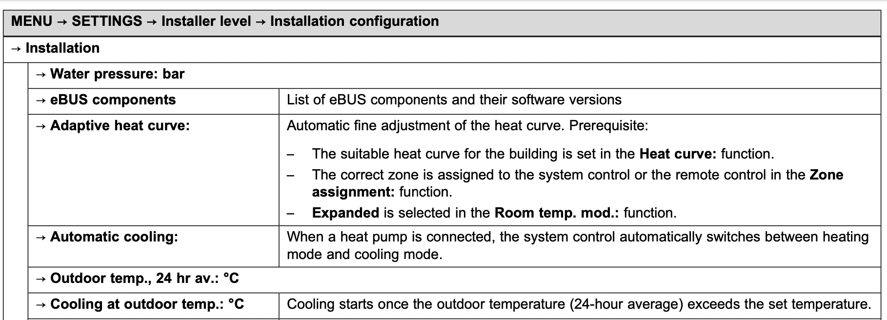

m0deller Posted July 29, 2022 Share Posted July 29, 2022 Active cooling enabled , and I've manually set a circuit to manually cooling .. but nothing so far 😞 Anyone else got this working on the aerotherm plus? Link to comment Share on other sites More sharing options...

m0deller Posted July 30, 2022 Share Posted July 30, 2022 We have cooling! When I looked last night, the Outdoor temp 24hr average menu item (sensoComfort Installer menu) wasn't displayed. I've looked this morning and it's now there. Looks like it needs 12hrs or so to start calculating the avg.  I can now manually enable cooling. Planning on using it via timed mode to make use of solar PV.  3 Link to comment Share on other sites More sharing options...
