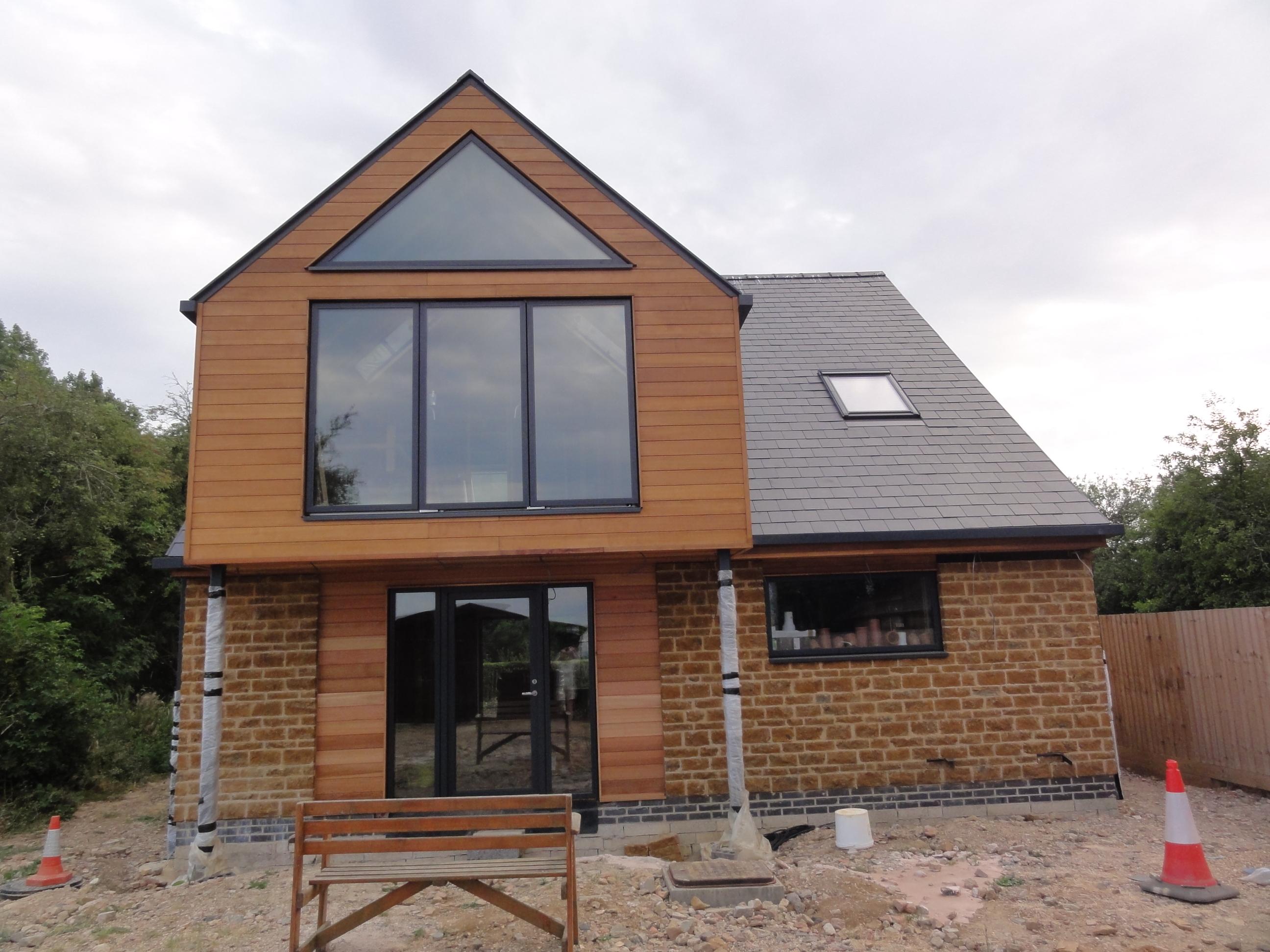

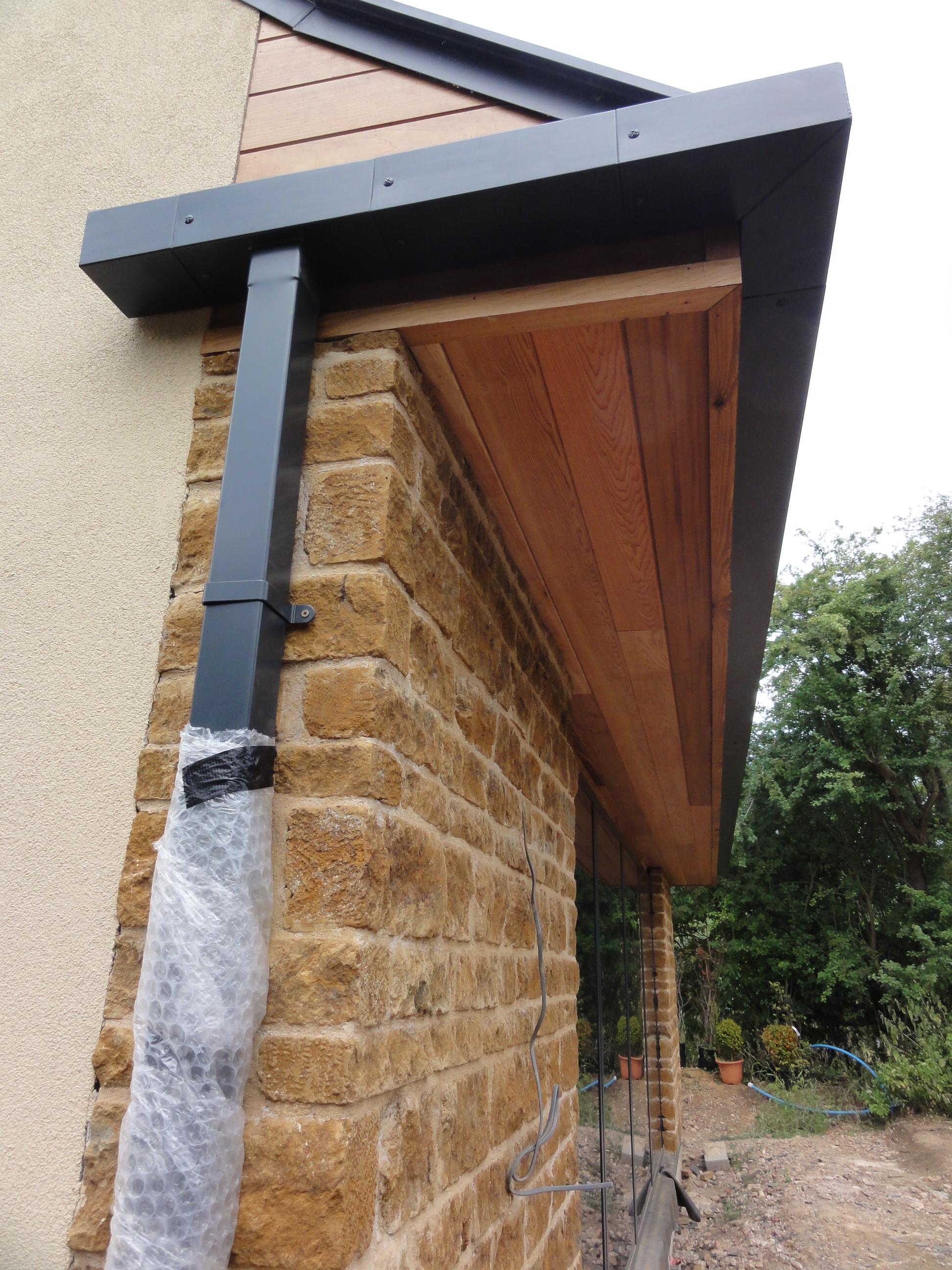

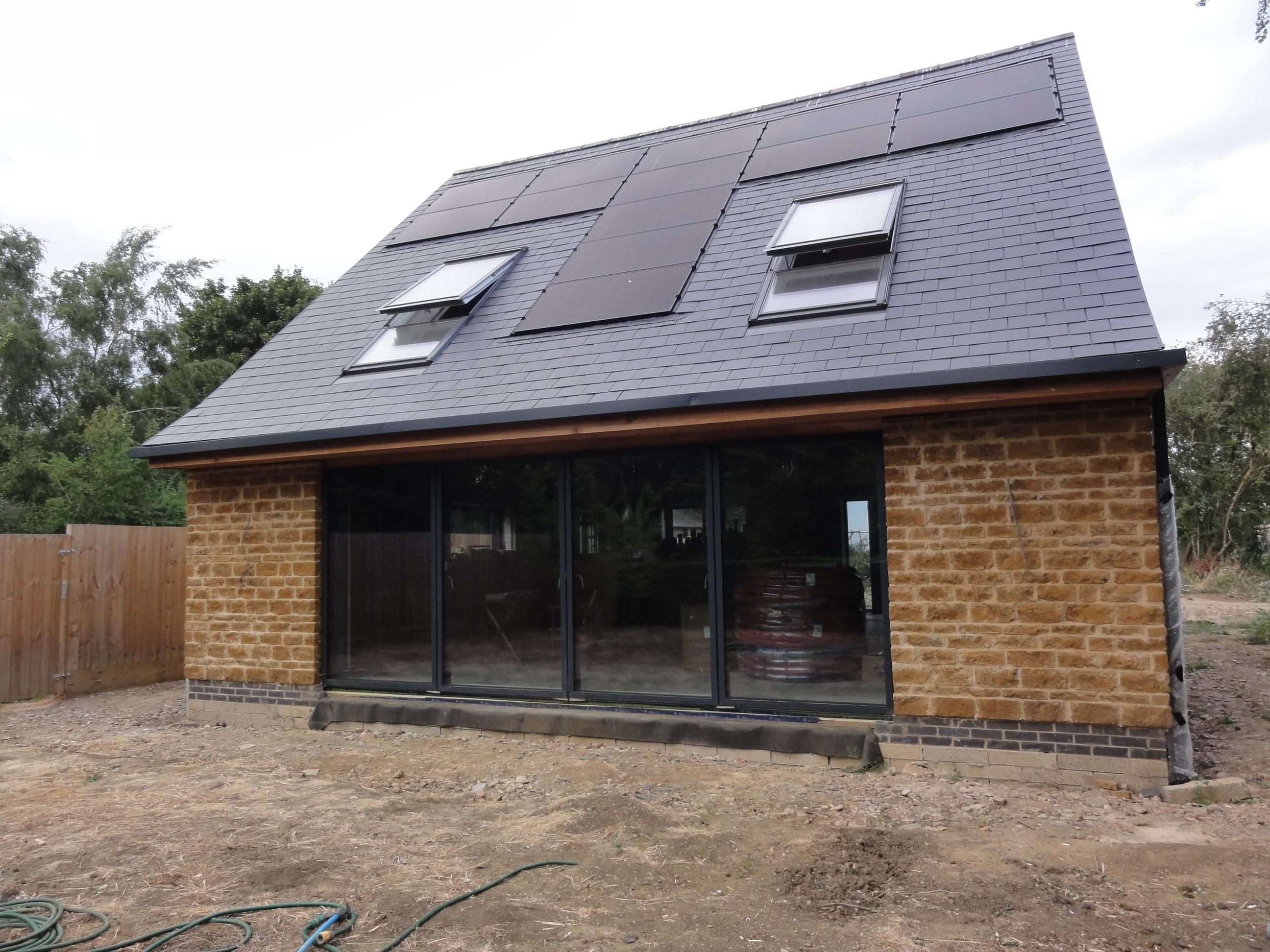

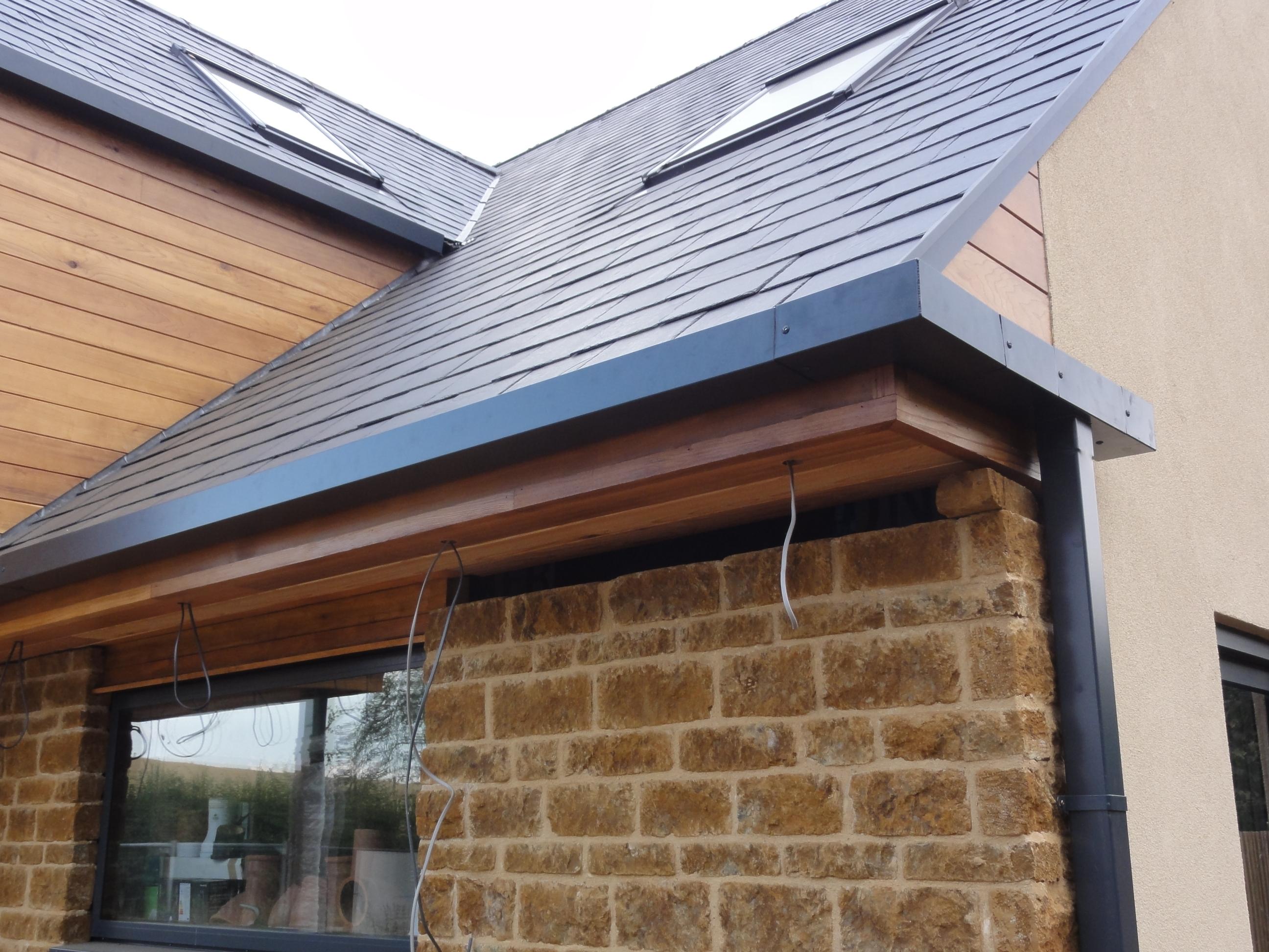

Moira Niedzwiecka Posted July 16, 2018 Share Posted July 16, 2018 Our guttering finished today. Really pleased with it. Now waiting for some rain to test it out & hopefully wash off the baked on pigeon poo on the roof. 6 Link to comment Share on other sites More sharing options...
lizzie Posted July 18, 2018 Share Posted July 18, 2018 @Moira Niedzwiecka looking lovely, well done 1 Link to comment Share on other sites More sharing options...
Hecateh Posted July 18, 2018 Share Posted July 18, 2018 very smart 1 Link to comment Share on other sites More sharing options...
joe90 Posted July 18, 2018 Share Posted July 18, 2018 I went for the black plastic imitation cast iron look and it looks great, not expensive and has a dimpled Matt look, great for our cottage., agree with others, lots of clips, Black gets hot and may sag. I have suffered from “gutter creak” in the past where the clips are too tight and when the gutter expands in the sun then cools it “clicks “ in the brackets, this stuff does not, the clips are looser letting the gutter move slightly, I will find out the manufacturer if you like? Link to comment Share on other sites More sharing options...
Vijay Posted July 18, 2018 Share Posted July 18, 2018 54 minutes ago, joe90 said: I went for the black plastic imitation cast iron look and it looks great, not expensive and has a dimpled Matt look, great for our cottage., agree with others, lots of clips, Black gets hot and may sag. I have suffered from “gutter creak” in the past where the clips are too tight and when the gutter expands in the sun then cools it “clicks “ in the brackets, this stuff does not, the clips are looser letting the gutter move slightly, I will find out the manufacturer if you like? I'd like to know the manufacturer too as I have to have cast iron (or effect) Link to comment Share on other sites More sharing options...
Vijay Posted July 18, 2018 Share Posted July 18, 2018 @Moira Niedzwiecka can I ask what guttering system you used? Link to comment Share on other sites More sharing options...
Ed_MK Posted July 18, 2018 Author Share Posted July 18, 2018 Very Nice!! It might not go with our cottage-style house though ....but its really clean and neat By the way Joe ...with my steep roof ..I have to go for a deeprun gutter ...I wonder if they do them in imitation Iron ? Link to comment Share on other sites More sharing options...
Ed_MK Posted July 18, 2018 Author Share Posted July 18, 2018 On 16/07/2018 at 20:09, Moira Niedzwiecka said: Our guttering finished today. Really pleased with it. Now waiting for some rain to test it out & hopefully wash off the baked on pigeon poo on the roof. nice bifolds too ! we are hoping to get them on our rear can i ask how you coped with the dropped damp-course in relation to the rest of the building Link to comment Share on other sites More sharing options...
