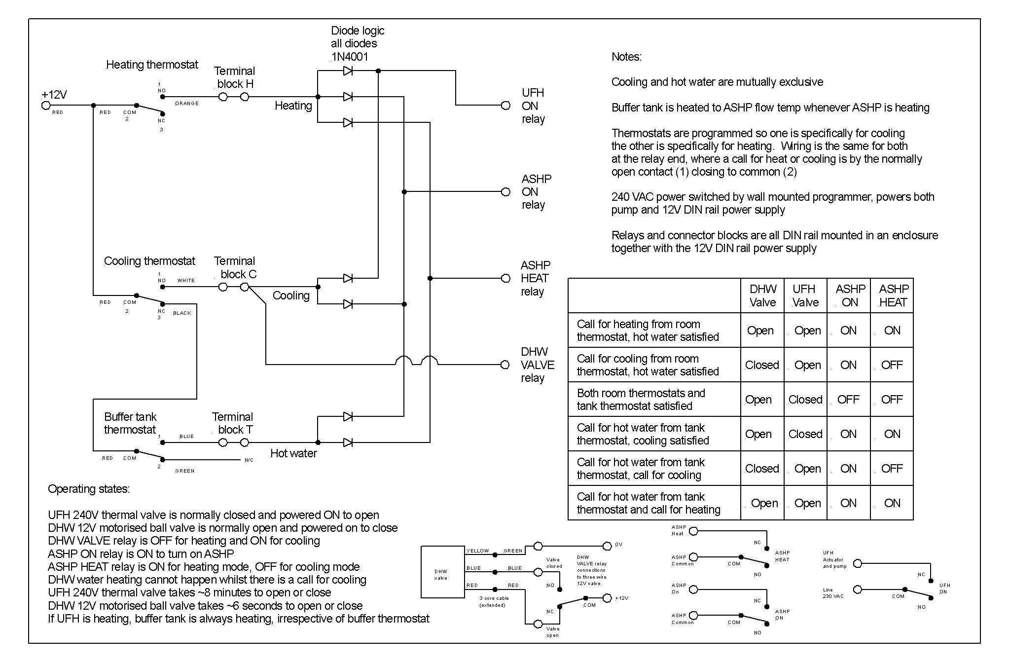

PeterW Posted July 27, 2018 Share Posted July 27, 2018 @JSHarris do you have the wiring diagram that shows your heat/cool switch over on the ASHP itself ..? Link to comment Share on other sites More sharing options...

Jeremy Harris Posted July 27, 2018 Share Posted July 27, 2018 2 hours ago, PeterW said: @JSHarris do you have the wiring diagram that shows your heat/cool switch over on the ASHP itself ..? Yes, sure, it's done via two wireless thermostats, one set to cooling switchover mode, the other set to heating switchover mode (they are the same wireless stats, but have a link so they can be set to activate for cooling or activate for heating. I used these to control some diode logic and relays that select the various options on the dry contact controlled ASHP. The same unit also controls the UFH valve and the buffer tank valve. First off, this is my ASHP dry/12V contact wiring panel, showing the various options that can be turned on or off by a dry contact between the common and the relevant terminal: I used some DIN rail mount 12V relays and a small 12V DIN power supply, fitted inside a small consumer-unit type box to house the control relays, power supply and some DIN rail terminal blocks, to make a DIY wiring centre for the system, the two room thermostat receivers are fitted on the wall above, as is the programmer. The buffer tank stat has it's sensor bulb pushed into a hole in the side of the tank insulation and seems to work OK like that. This is the box with the DIY wiring centre in it: And this is the wiring diagram for the diode logic and relays. There are three thermostats, one for hot water pre-heat call from the buffer tank, one for cooling call from the cooling stat and one for heating call from the heating stat. When cooling id called for (and cooling is subservient to a buffer tank heating call) the buffer tank is isolated by a 12V motorised ball valve. The system can heat the buffer without the UFH being on, as the UFH valve is one of those neat ,motorised differential temperature valves that @Nickfromwales found, that not only turns on the UFH but also runs it as a set 5 to 6 deg C differential between flow and return when it's powered on, which works far better than any thermostatic mixer valve and makes a mixer valve redundant. The great thing is that this UFH valve doesn't care whether it's heating or cooling, it still maintains the 5 to 6 degree different between flow and return on the UFH pipes themselves in cooling mode, which is ideal, as it reduced further any floor condensation risk. Link to comment Share on other sites More sharing options...

joe90 Posted July 27, 2018 Share Posted July 27, 2018 Great wiring diagrams Jeremy, thanks (having a real hard time understanding this stuff, I prefer to dig with my JCB ?), Link to comment Share on other sites More sharing options...
