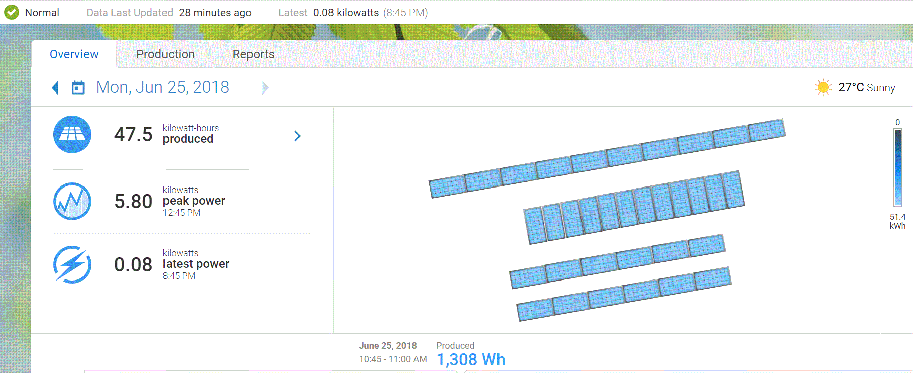

dnoble Posted June 25, 2018 Author Share Posted June 25, 2018 Many thanks for this Jeremy and Dave. I had an idea there was a risk but useful to have practical advice. The roof gets a bit of dappled shade in a portion from a nearby Ash tree, especially away from midsummer when the sun's lower. I see people have pre-empted my next question which was; What are peoples thoughts on micro inverter fitted panels. Is it worth the extra cost (or should I just coppice the tree!) Points about having to replace micro-inverters are worth thinking about (how would you know one had stopped working anyway; is there a way of monitoring the output of individual panels?) Link to comment Share on other sites More sharing options...
Jeremy Harris Posted June 25, 2018 Share Posted June 25, 2018 Microinverters often have a monitoring system built in that reports back to a data collection unit, so you can check performance and health. For the sort of shaded conditions you describe then microinverters are a good choice, but equally good, and perhaps more reliable (the jury's out on that) might be to fit panel optimisers, like the Solar Edge system. Optimisers don't have the high voltage switched mode inverters built in, so are a lot simpler internally. All they do is optimise the output from each individual panel using a maximum power point tracker (MPPT). This deals with partial shade every bit as well as a microinverter system, but means that you still run DC down to a conventional inverter. The advantage is really that the primary cause for concern in the microinverters (and big inverters), the high voltage commutation capacitors, aren't up on the roof, but remain in the main inverter. Commutation capacitor life is the primary life-limiting factor in an inverter, and is proportional to temperature - the cooler you can keep the capacitors the longer they will last. 2 Link to comment Share on other sites More sharing options...

jack Posted June 26, 2018 Share Posted June 26, 2018 2 hours ago, JSHarris said: Microinverters often have a monitoring system built in that reports back to a data collection unit, so you can check performance and health. The Enphase microinverters that we have used to allow per panel reporting (I think) but that function's been cut back. I believe installers and Enphase can still see it. You can still see which panels are producing more power than other panels in real time, based on their colour. This was last night at 8:45 - very little power being produced per panel: You'll also get an email if there appears to be a fault. We had that when it snowed earlier this year - the system was expecting the panels to produce power, and when they didn't do so, itsent me an alert. I watched over the next day or so as they individually woke back up as the snow cleared from them. Our microinverters have a 20 or 25 year warranty. Of course, this is only as good as the company that backs them, but Enphase seems to be pretty solid. There's also the issue of longevity of the system itself: what happens if in 10 or 15 years one of them stops working - will they be in a position to provide a drop-in replacement? Having a flat roof means that we can access them pretty easily, as long as the company's still around and replacements are available. As for why we went with this rather than a regular two string inverter, we have various trees shading parts of the roof at different times of the year. The company we used spent quite a bit of time standing on our roof mapping out the surrounding trees, and then modelled the output of the course of a year. The microinverters were a clear winner over the standard inverter approach. I think another thing they do is produce a bit more at the start and end of the day - from memory, it's something to do with the minimum string voltage required for the inverter to turn on in a regular system. Link to comment Share on other sites More sharing options...
