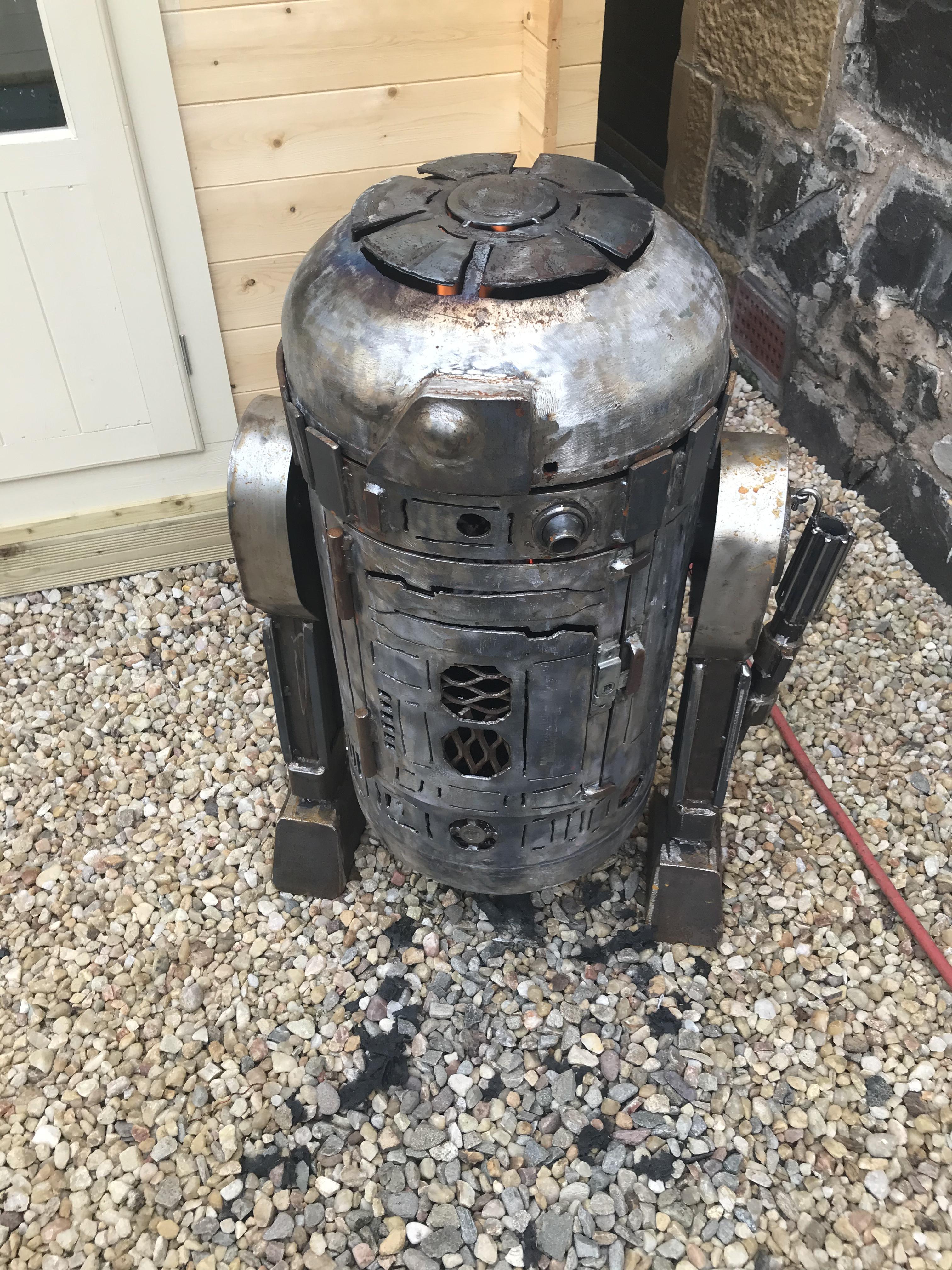

TonyT Posted November 12, 2021 Posted November 12, 2021 (edited) That flange piece could end up looking good, just got to have a bit of artistic flare. my mate made this, my wife saw it ( I’m not on social media) and she bought it it was a gas bottle Edited November 12, 2021 by TonyT 1
ProDave Posted November 12, 2021 Posted November 12, 2021 52 minutes ago, TonyT said: That flange piece could end up looking good, just got to have a bit of artistic flare. my mate made this, my wife saw it ( I’m not on social media) and she bought it it was a gas bottle Which helps to explain why Calor have a shortage of gas cylinders....... 1

zoothorn Posted November 13, 2021 Author Posted November 13, 2021 @ProDave you have one groovy wife! Are there flames I can see inside the top, I mean it cant be a mini logburner can it? Surely R2's walls are too thin

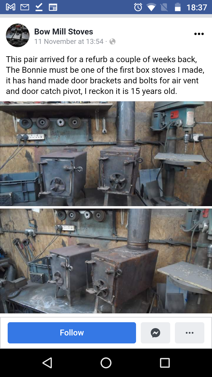

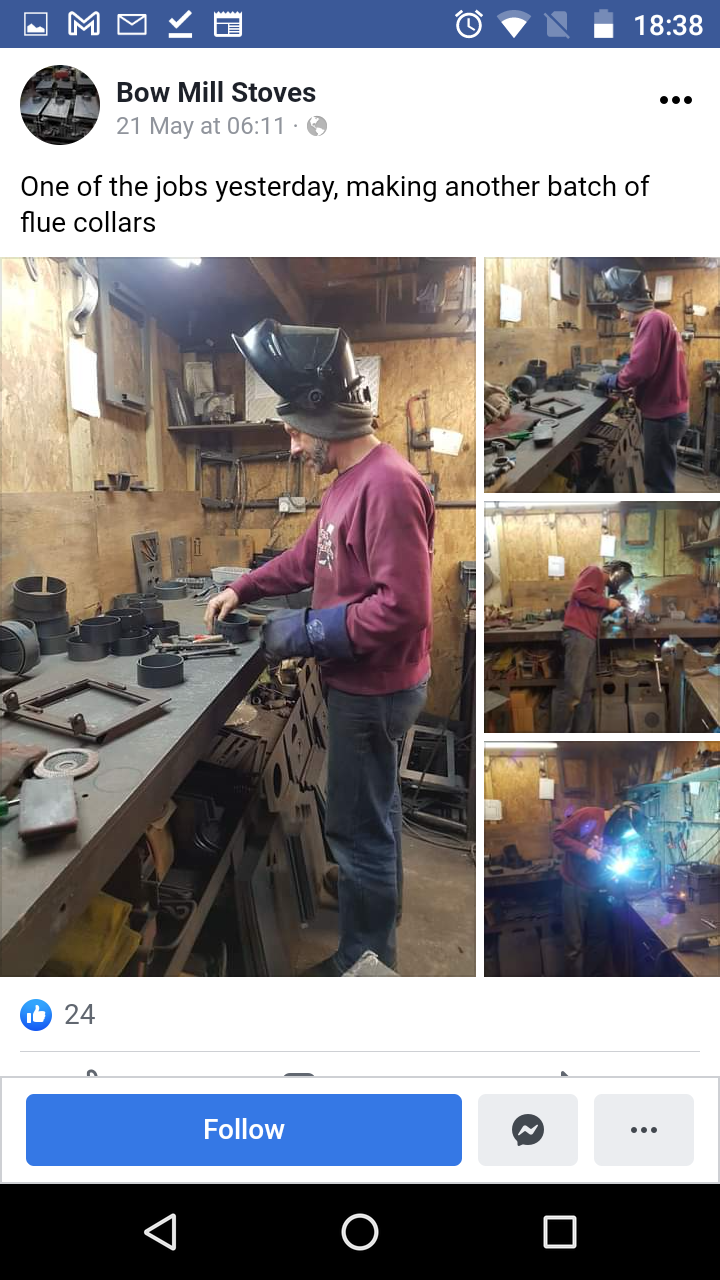

Onoff Posted November 14, 2021 Posted November 14, 2021 47 minutes ago, zoothorn said: Onoff give us your opinion on my ebay idea/ find would you.. its steel I think it looks very nice. The maker appears genuine. Saying about stoves gone back for a refurb, one of his early ones being 15 years old etc. Nice too it's made in England. https://m.facebook.com/champstoveco/?locale2=en_GB 1
zoothorn Posted November 14, 2021 Author Posted November 14, 2021 3 hours ago, Onoff said: I think it looks very nice. The maker appears genuine. Saying about stoves gone back for a refurb, one of his early ones being 15 years old etc. Nice too it's made in England. https://m.facebook.com/champstoveco/?locale2=en_GB That's what I thought too. And £25 less on there.. me no have facebook but i guess i just create an acc. The only thing is, why they're back for refurb, but hey it's not a huge £waste if this idea doesn't come off. Make the cabin look purposeful at least/ good 'sell' point. Thx z
Onoff Posted November 14, 2021 Posted November 14, 2021 42 minutes ago, zoothorn said: That's what I thought too. And £25 less on there.. me no have facebook but i guess i just create an acc. The only thing is, why they're back for refurb, but hey it's not a huge £waste if this idea doesn't come off. Make the cabin look purposeful at least/ good 'sell' point. Thx z I would imagine these things see a fair bit of use on canal boats and in caravans. I'd be happy getting 15 years service. I'm just jealous you'll have your own little escape pod to sit in next to a babbling brook with a wee dram and a good read! ? Imagine that...thick snow...bliss! I'd at least put up a battery smoke alarm in there in case you drift off in your rocking chair and have an extinguisher on the wall too.

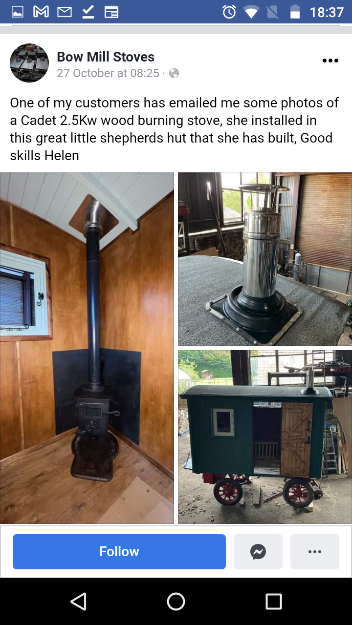

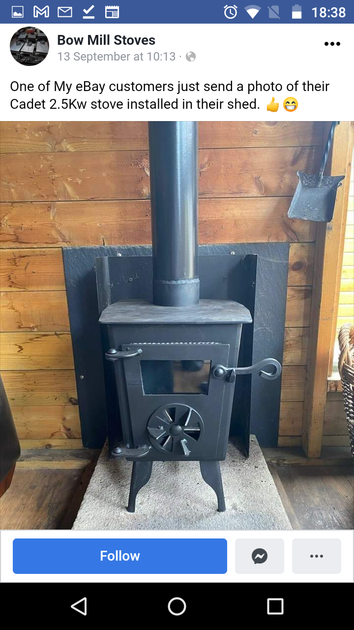

Onoff Posted November 14, 2021 Posted November 14, 2021 So you'll want a decent hearth stone for your stove to sit on and something behind to protect the wall. I'm thinking slate considering your locale? Then the "how" to do your chimney! The clever people will be along shortly!
ProDave Posted November 14, 2021 Posted November 14, 2021 Yes some nice slabs of Welsh Slate would do nicely. Flue is not difficult, use twin wall insulated flue for most of it, then you only need to keep that 50mm away from flamable materials. the roof penetration will be the hardest bit to detail, or take it out the wall at 45 degrees and up the outside. @Onoff some of us can look at a babbling burn from our living room or bedroom windows.

zoothorn Posted November 15, 2021 Author Posted November 15, 2021 15 hours ago, Onoff said: So you'll want a decent hearth stone for your stove to sit on and something behind to protect the wall. I'm thinking slate considering your locale? Then the "how" to do your chimney! The clever people will be along shortly! Hi Onoff, useful extra pics/ info thanks.. I didn't see any of this. Yup this looks good to me, should be simple enough to do the flue.. relatively speaking. Just the roof insulation (1" celotex) to be very careful o, or as Proadave suggests 45* angled out the back & up. Joined facebook to try get it on this marketplace ( never seen before/ thought it was a social media thing).. but get a mssg " not allowed to access marketplace". Bloomin annoying. Yup a decent hearth, 2 sheet metal panels behind (maybe some heatproof lining for the backs of). Welsh slate.. yes ideally, but a piece this size bloody costly. Will hsve to be a cheaper option Im afraid.
