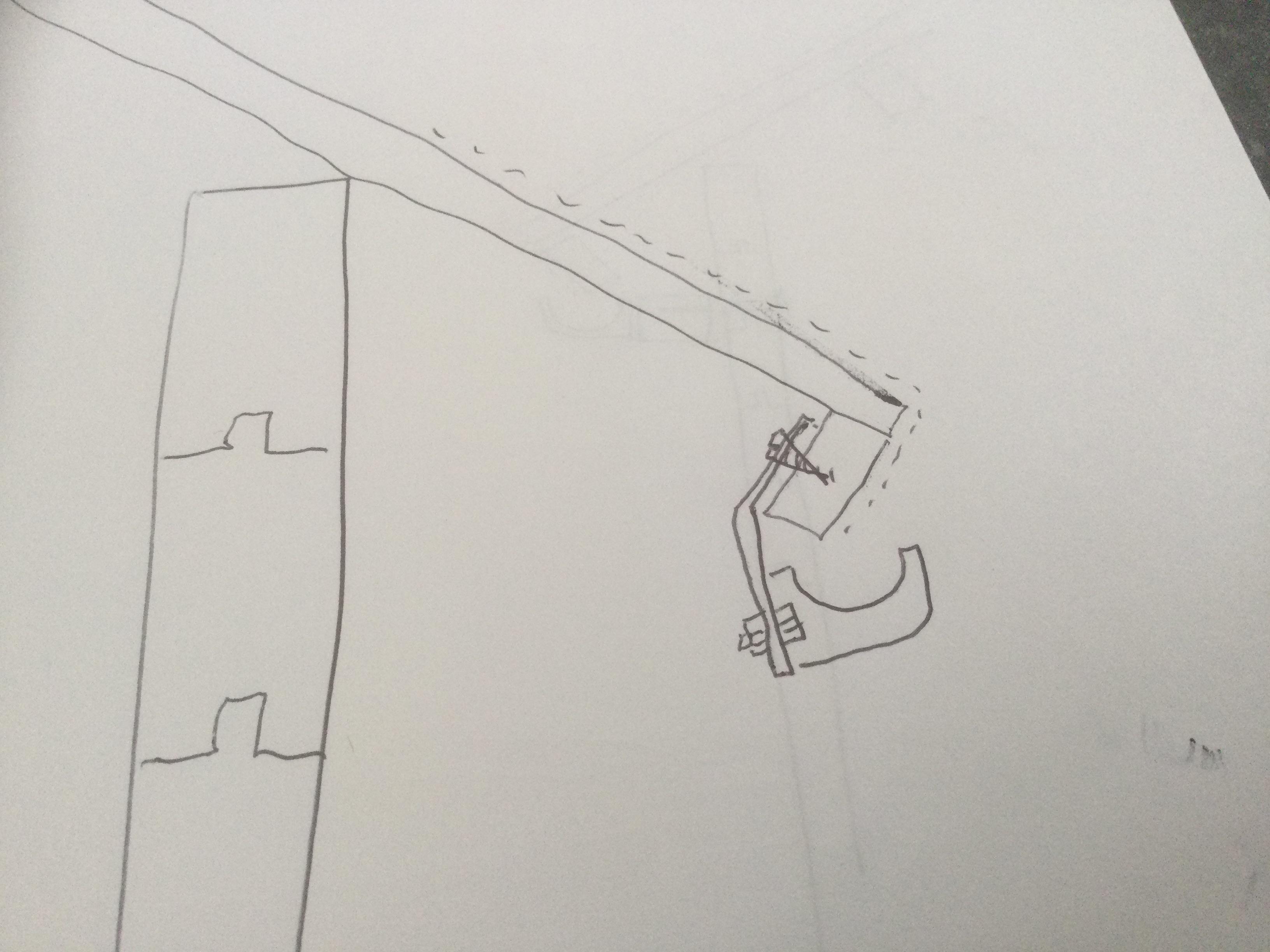

TonyT Posted May 18, 2021 Posted May 18, 2021 (edited) Use threaded screws to metal dowels. screw wood screw part into timber leaving machine thread exposed for bracket with a nut. Edited May 18, 2021 by TonyT

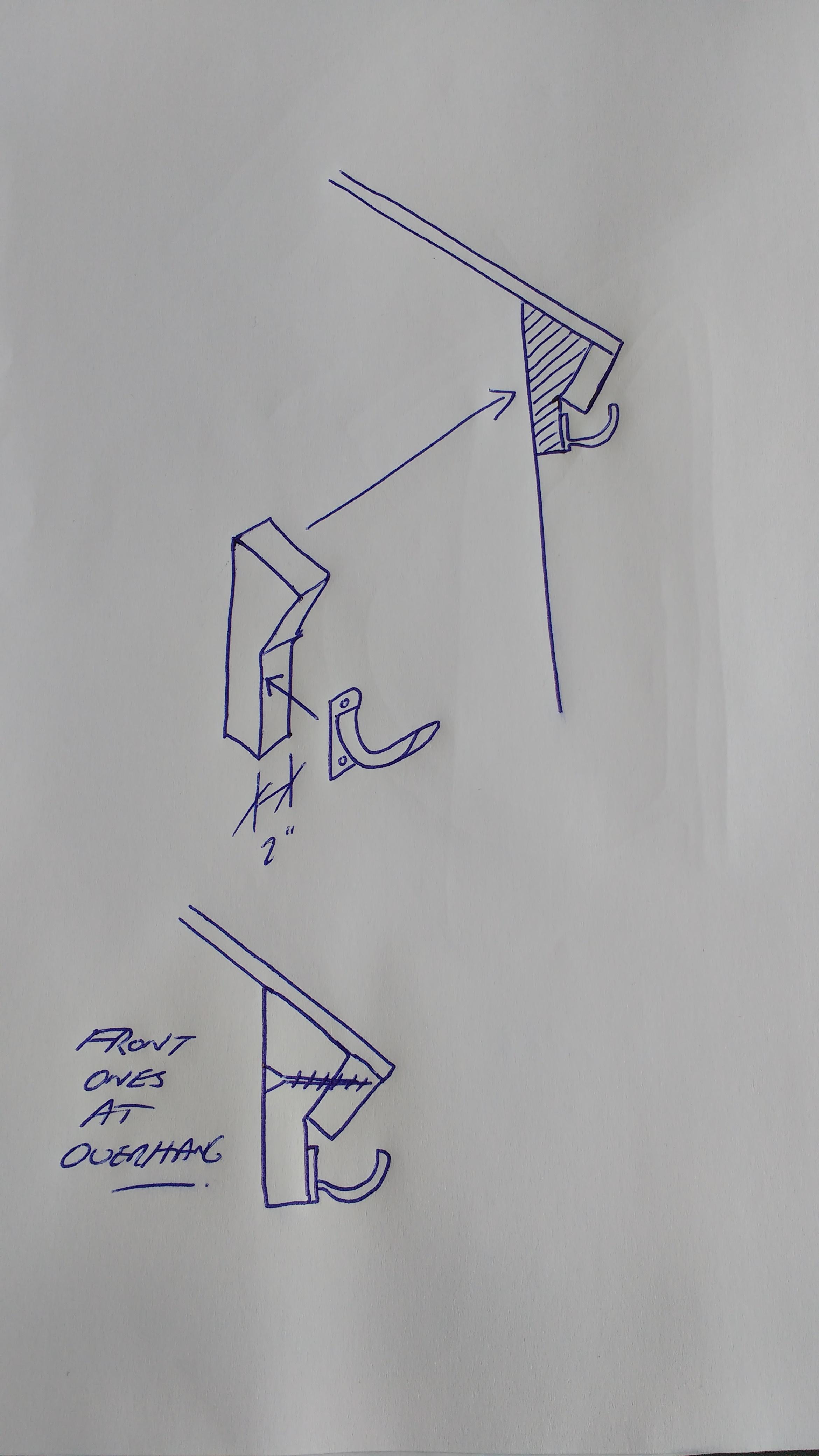

Onoff Posted May 18, 2021 Posted May 18, 2021 (edited) 27 minutes ago, TonyT said: Use threaded screws to metal dowels. screw wood screw part into timber leaving thread exposed fox bracket with a nut. Fair shout. You'll have to give him a picture though! @zoothorn, how about this, no screws for the most part, or the brackets even. Just make a pattern from card then transfer to some 2" timber. The ones against the wall should just slide wedge in there - no screws. You will need screws at the front overhang where there are no walls: Edited May 18, 2021 by Onoff
joe90 Posted May 18, 2021 Posted May 18, 2021 1 hour ago, Onoff said: At the front won't that block be fixing to thin air? No, the block is simply a spacer to get the bracket away from the wall!!
Onoff Posted May 18, 2021 Posted May 18, 2021 54 minutes ago, joe90 said: No, the block is simply a spacer to get the bracket away from the wall!! Where the end brackets going there are no walls ?
joe90 Posted May 18, 2021 Posted May 18, 2021 1 hour ago, Onoff said: Where the end brackets going there are no walls Ah, didn’t realise that?♂️

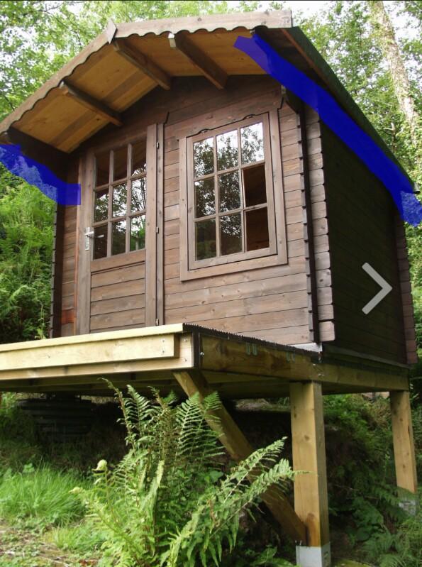

zoothorn Posted May 19, 2021 Author Posted May 19, 2021 Sorry chaps Ive been deluged with work, plus simultaneous gardening threads & 3 on a music electronics site too: I cant & cope with any of them! Great ideas/ suggestions muchos gratias. The pack it out with a block idea @Onoff is too big a span to achieve really.. the overhang is 10" you see. I like your reverse-cowgirl-inverse hook idea.. but as Joe said how would I access it. I thought of packing out the edge with a wedge, to make it vertical.. but then my gutter sits to far away-! -- I think maybe joe saying dont bother with gutters is becoming more appealing! but defo need it top LHS side, t'other side its a luxury tarty addition really, as it can drip off onto stream bank 10' below (but I'd thought of making a small platform here, to access underneath the cabin, a useful storage space: so a gutter would be of use). Hmm. JSH would know what to do. I am summononing him. thx tooting-zooter.

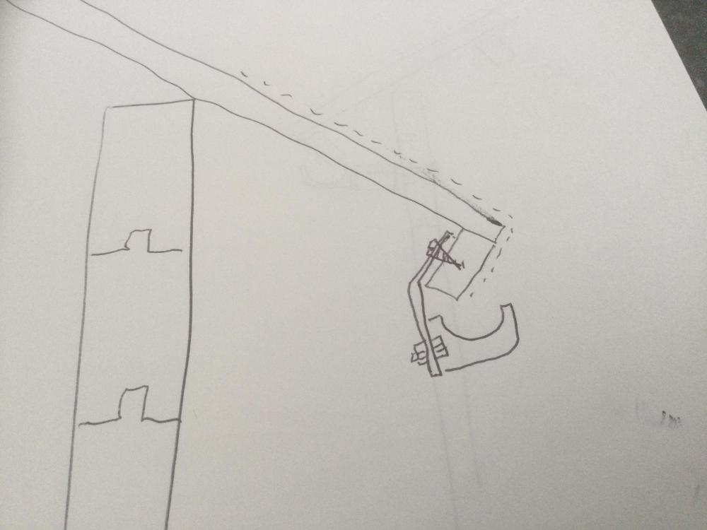

joe90 Posted May 19, 2021 Posted May 19, 2021 right with 10” overhang you can get up behind with a screwdriver so what about a short bit of bent metal strap screwed into back of rafter and bolted to gutter bracket......
Onoff Posted May 19, 2021 Posted May 19, 2021 52 minutes ago, zoothorn said: I like your reverse-cowgirl-inverse hook idea.. but as Joe said how would I access it. As @TonyT suggested: https://www.screwfix.com/p/easydrive-machine-thread-to-wood-thread-dowel-screws-m8-x-x-75mm-10-pack/7618H? You could use screws and keyhole slot the bracket for instance...coach screws too, an option. Can't be ar$ed sketching it and it'd be too much for you to contemplate...so won't!

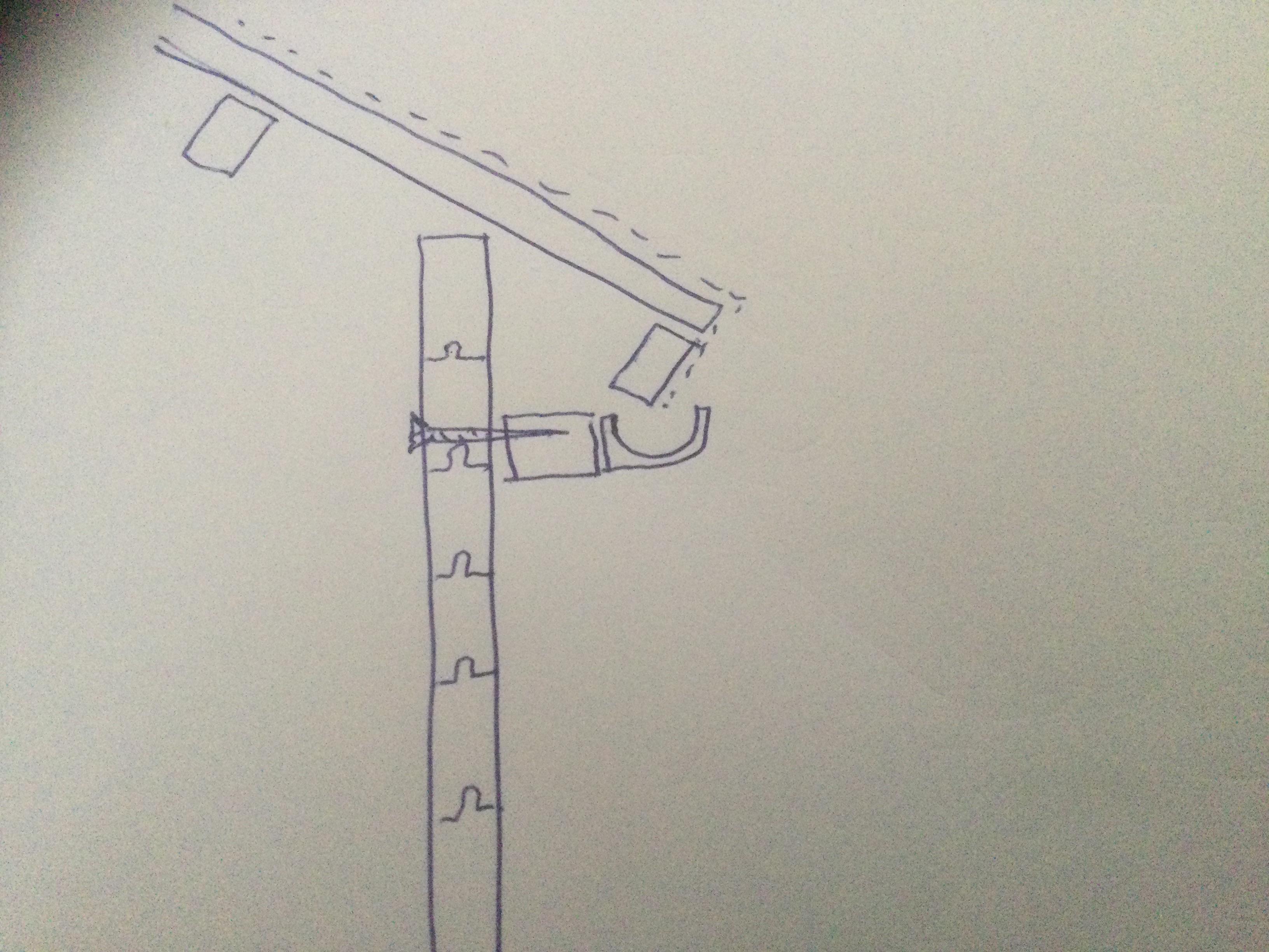

zoothorn Posted May 19, 2021 Author Posted May 19, 2021 23 hours ago, joe90 said: Ah, didn’t realise that?♂️ I think Ive worked it out-? I'll fall off me perch if so.. @Onoff 's idea adding timber.. but simpler. 4x3 timber ~10" long bits screwed under t&g roof board (so perp to gutter) shape the end to wiggle round the baton under roof lip, & cut its end at an angle- to make it vertical. Hopefully not get heavy enough to stress the t&g roof section its attatched to, if I put 3 brackets/ 3 timbers in each side. thanks chaps. zH
zoothorn Posted May 19, 2021 Author Posted May 19, 2021 @joe90 aha.. that bent metal idea seems simplest. Forget my timber chunk then.. didn't see this idea Joe, terrific cheers. @Onoff apologies I can't quite figure out the screw/ machine screw end things idea.. I can't picture it, as I've never seen these before i think. Dont worry I think joe's idea might work..? if I can find a bit of metal. any old rusty bit's ok surely if no water gets under here once gutter on. grateful- zoot

joe90 Posted May 19, 2021 Posted May 19, 2021 1 hour ago, zoothorn said: any old rusty bit's ok Just give it a coat of hamerite paint, no undercoat etc needed.
Onoff Posted May 19, 2021 Posted May 19, 2021 2 hours ago, zoothorn said: I think Ive worked it out-? I'll fall off me perch if so.. @Onoff 's idea adding timber.. but simpler. 4x3 timber ~10" long bits screwed under t&g roof board (so perp to gutter) shape the end to wiggle round the baton under roof lip, & cut its end at an angle- to make it vertical. Hopefully not get heavy enough to stress the t&g roof section its attatched to, if I put 3 brackets/ 3 timbers in each side. thanks chaps. zH It'll be fine. A good heavy snowfall one year will test your brackets! ? I'd not fix to the t&g roofing but the long edge bits as aforementioned. 1
joe90 Posted May 19, 2021 Posted May 19, 2021 Or a bit of this will do, cut to length and a bend and it’s galvanised ?. https://www.toolstation.com/heavy-duty-strap-flat/p50096
zoothorn Posted May 21, 2021 Author Posted May 21, 2021 On 19/05/2021 at 21:20, jfb said: sorry if this has been asked before but why do you want gutters? Its not like the rain is going to run down onto the front deck - its all going off to the side. well I was sort of assuming I needed them.. maybe I dont then!? I think RHS can drop off to stream bank/ ruled out this side then, so if just doing topside (LHS) I make it ~£55 to get the bits for this. If its £75 to get a 'pack' for both sides.. kinda makes sense to do both! so erm.. As usual I admit i dont know me oorse from me elbow jfb.
zoothorn Posted May 21, 2021 Author Posted May 21, 2021 On 19/05/2021 at 23:09, joe90 said: Or a bit of this will do, cut to length and a bend and it’s galvanised ?. https://www.toolstation.com/heavy-duty-strap-flat/p50096 Great find- thanks joe/ & there's a 2.5 x 200mm one on same page too for 49p! 3 per side/ sorted.
