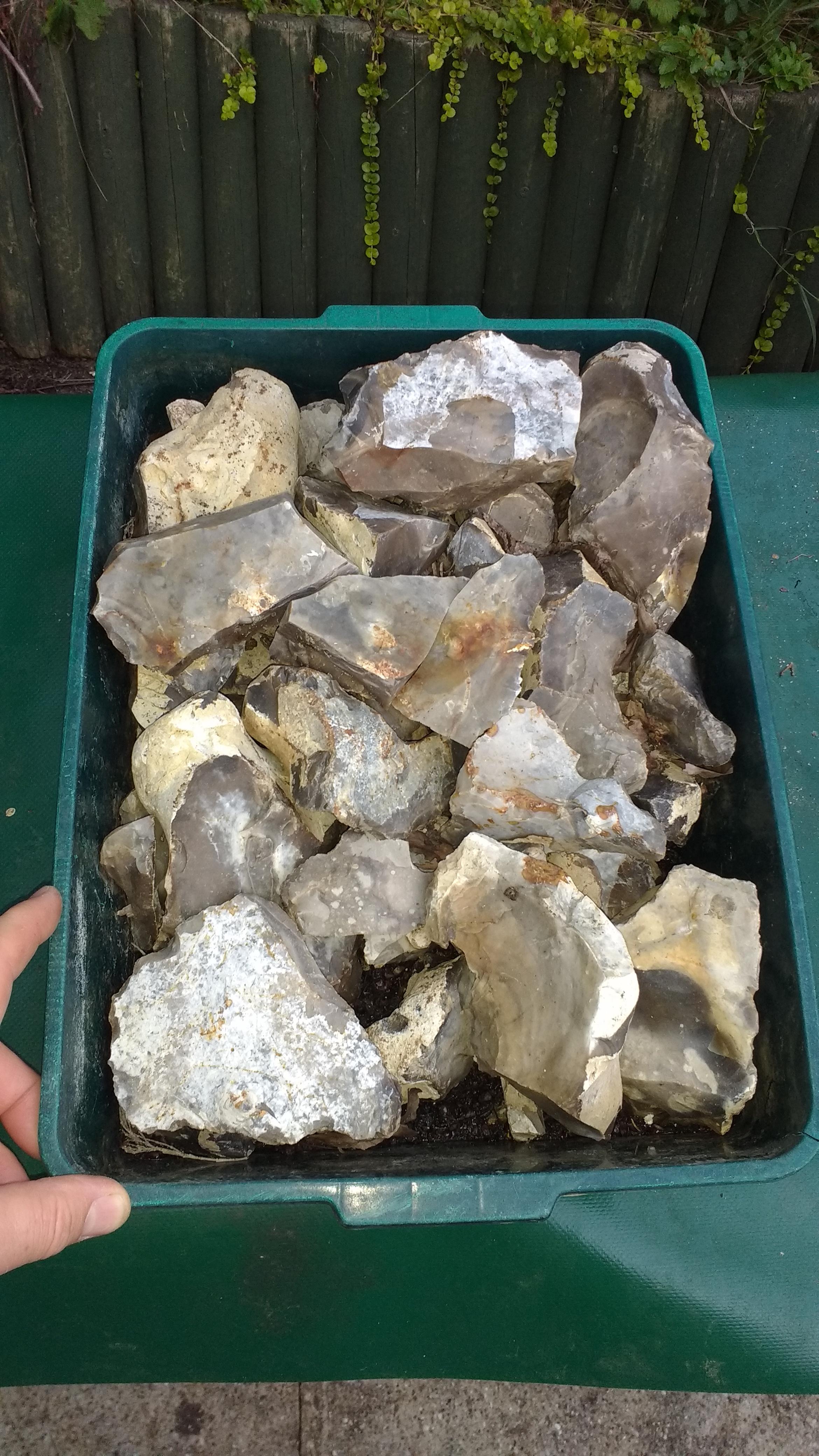

Onoff Posted August 26, 2020 Author Share Posted August 26, 2020 I may have a crack over the long weekend at making a start on the flint infilling. I've trays and trays of flints like this. I mentioned somewhere previous these were collected by SWMBOs late cousin, a keen amateur geologist who saw something we guess in every piece. They'll be know as "Martin's flints". I've still yet to decide on the mix to set them in. One question is they've sat in water in the trays for a couple of years now. During extended dry periods this might have been stagnant. Some might now have a bit of "greenery" on them. Is it worth maybe giving them a quick scrub in a mild bleach solution before setting them? Link to comment Share on other sites More sharing options...
Roundtuit Posted August 26, 2020 Share Posted August 26, 2020 Don't know about cleaning them, but just before they become a gate pillar, is there any chance some of them may have been collected because they show signs of having been worked (knapped), as in, Neolithic hand-tool style? Be a shame to accidentally loose them if they might have some historical value... Link to comment Share on other sites More sharing options...
Onoff Posted August 26, 2020 Author Share Posted August 26, 2020 3 minutes ago, Roundtuit said: Don't know about cleaning them, but just before they become a gate pillar, is there any chance some of them may have been collected because they show signs of having been worked (knapped), as in, Neolithic hand-tool style? Be a shame to accidentally loose them if they might have some historical value... Quite likely, though I don't know what I'm looking for. I'd hoped they would show clear fossils but I can't see anything obvious. Link to comment Share on other sites More sharing options...

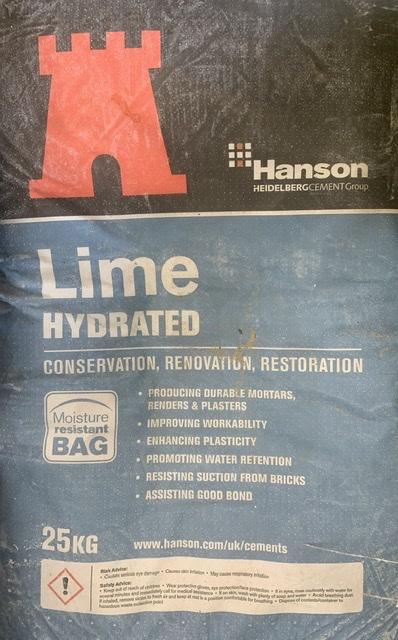

Onoff Posted August 28, 2020 Author Share Posted August 28, 2020 Someone remind me...hydrated vs hydraulic lime. Can I use hydrated in place of hydraulic as it's all I can get locally! Thanks. https://www.selcobw.com/rugby-hydrated-lime-25kg Link to comment Share on other sites More sharing options...
PeterW Posted August 28, 2020 Share Posted August 28, 2020 Hydraulic lime is for lime mortars. They only have sand and lime in them usually made from lime putty. Hydrated lime which you link to is added to mortars for workability and softens the mortar slightly. Link to comment Share on other sites More sharing options...
Onoff Posted August 28, 2020 Author Share Posted August 28, 2020 23 minutes ago, PeterW said: Hydraulic lime is for lime mortars. They only have sand and lime in them usually made from lime putty. Hydrated lime which you link to is added to mortars for workability and softens the mortar slightly. Thanks. So what do I want for the 5:1:1/2 mix? Up until now I thought hydraulic but now not sure again! ? As I understand it the lime helps with flexibility so the mortar doesn't shrink away from the flints. Link to comment Share on other sites More sharing options...
PeterW Posted August 28, 2020 Share Posted August 28, 2020 Hydrated Lime is what you want - this stuff Link to comment Share on other sites More sharing options...
Onoff Posted August 28, 2020 Author Share Posted August 28, 2020 7 minutes ago, PeterW said: Hydrated Lime is what you want - this stuff Thanks. This is what I can get locally, looks the "same"? https://www.travisperkins.co.uk/cement/blue-circle-hydralime-hydrated-lime-25kg-minimum-order-qty-of-3/p/740142 Link to comment Share on other sites More sharing options...
PeterW Posted August 28, 2020 Share Posted August 28, 2020 Yeh same stuff Link to comment Share on other sites More sharing options...
