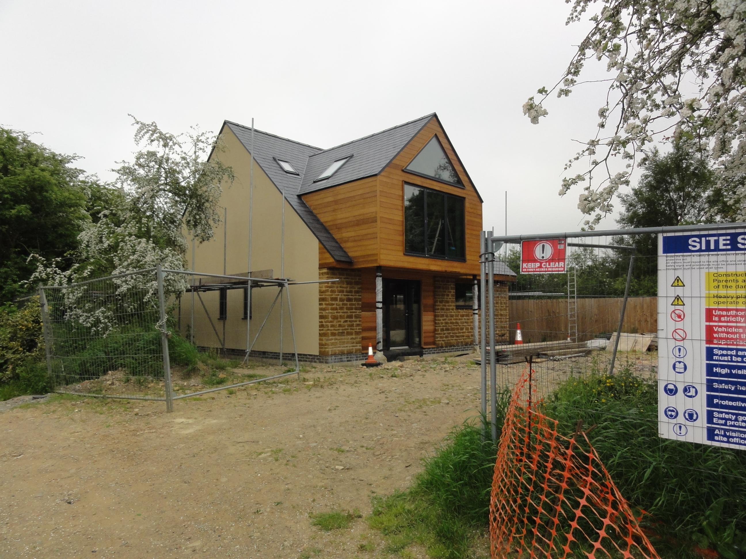

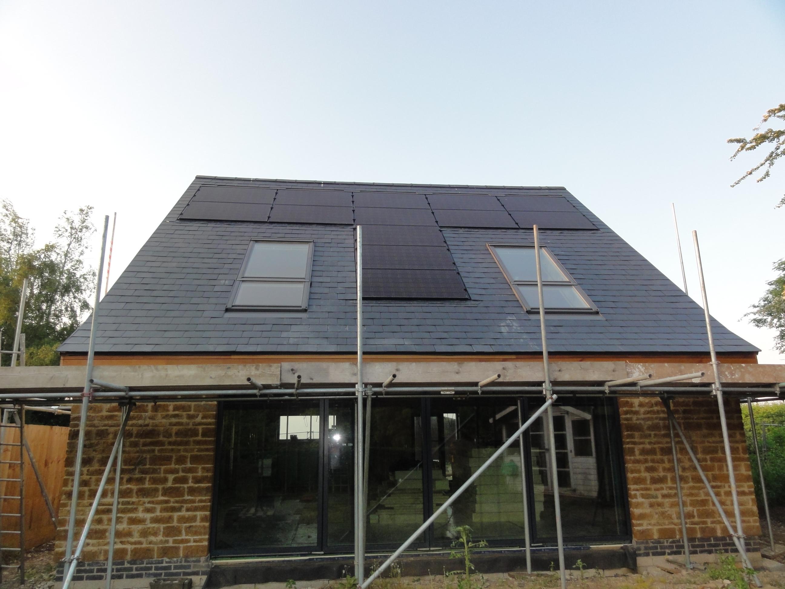

Moira Niedzwiecka Posted May 28, 2018 Posted May 28, 2018 At last, most of our scaffolding is down, 5 months later than planned. In spite of all the trauma it has been worth it. Our views are lovely and the house is looking better than I had hoped. Guttering is arriving next week & a bit of finishing to the cedar & stonework & we are nearly there. Outside anyway. 12
Nickfromwales Posted May 28, 2018 Posted May 28, 2018 Looking very nice, and super neat stonemasonry . I take it the pillars are to be wrapped in the same stone ?
Moira Niedzwiecka Posted May 28, 2018 Author Posted May 28, 2018 The support pillars are anthracite powder coated steel to match the windows. I have wrapped them in bubble wrap to protect them. We wanted them to be as discreet as possible. We would have liked the dormer to have been cantilevered but cost was prohibitive. The ironstone looks great. The location is on the side of an old victorian ironstone quarry and is in the conservation area so we had to use it. We kept it to a minimum because of cost. Our existing cottage (the new house is in the garden)is part of an ironstone terrace & most of the village is built in it. 1

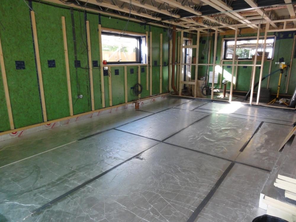

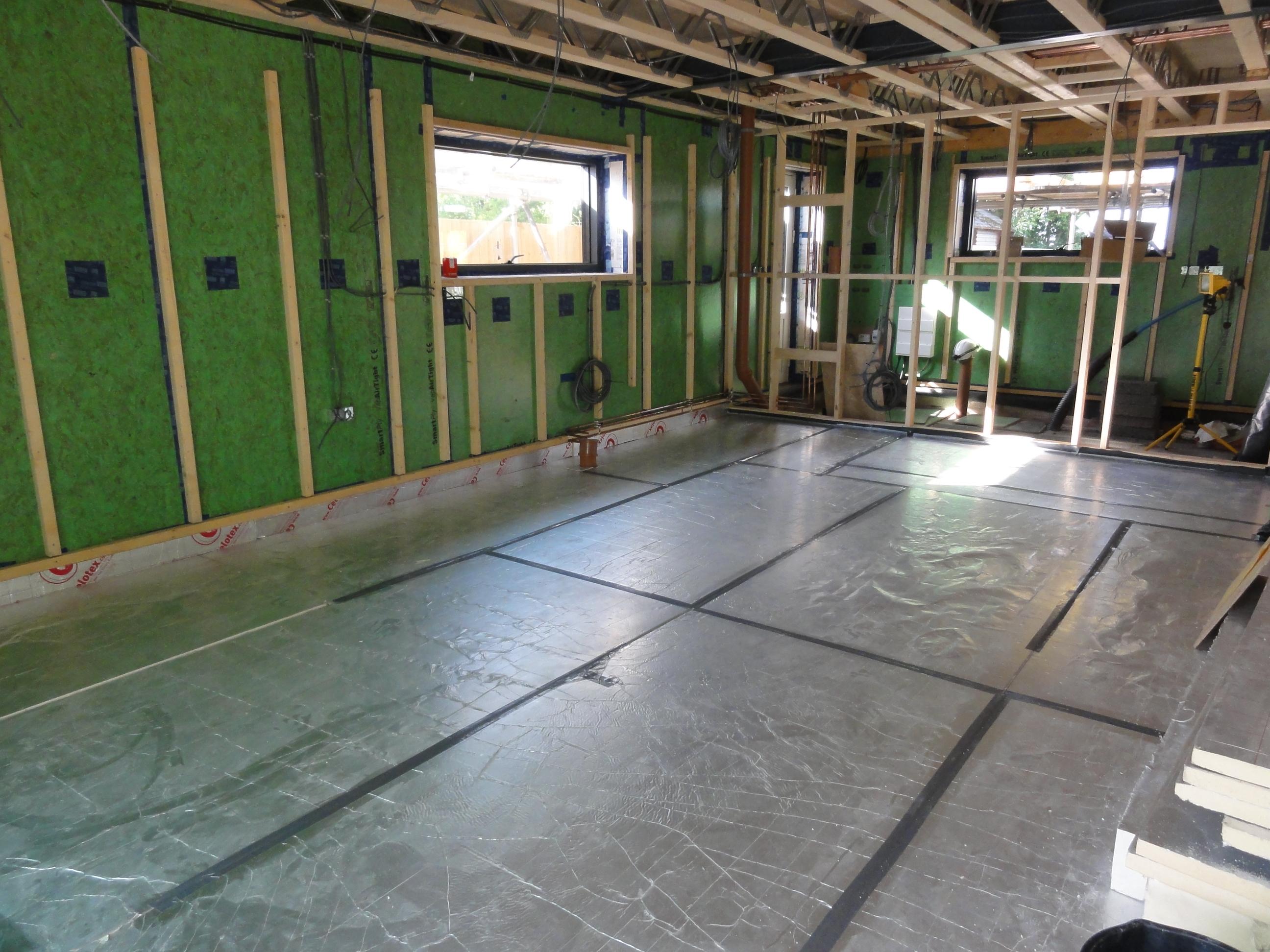

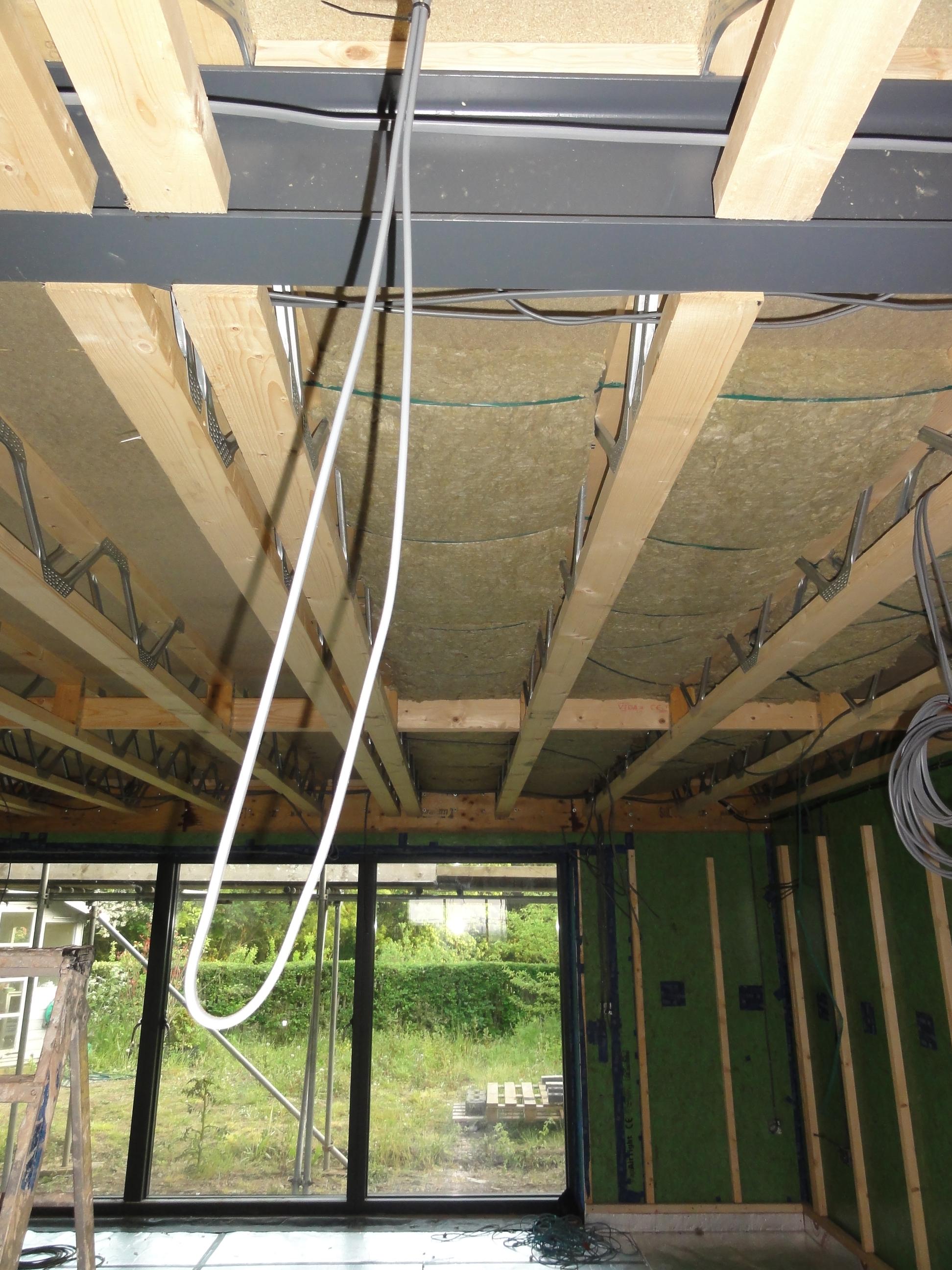

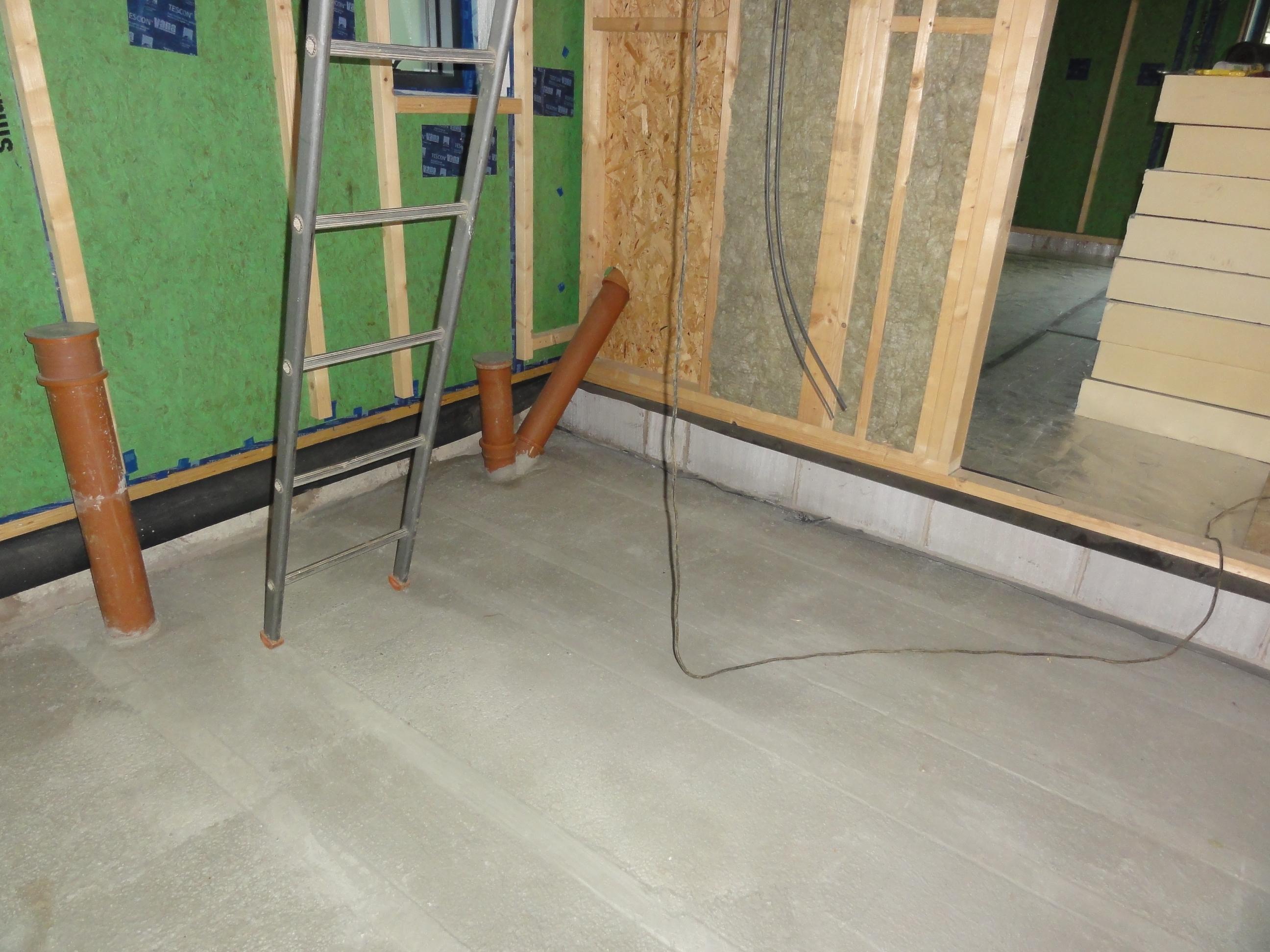

Moira Niedzwiecka Posted May 28, 2018 Author Posted May 28, 2018 (edited) Thanks Tom. We are starting to make progress inside as well now. Just finished the cement slurry grouting of the beam & block. Done the DPM & 800mm of floor insulation & 100mm perimeter insulation in the living area. Utility & hallway to do. Started the acoustic insulation in the ceiling (horrible job). MVHR arriving this week. Henry is getting on with the joinery upstairs. Most of the first fix electrics & plumbing done. Edited May 28, 2018 by Moira Niedzwiecka Add photos 2

Onoff Posted May 28, 2018 Posted May 28, 2018 Lovely clean lines on the roof etc. That triangular glass bit on the dormer I love.

Moira Niedzwiecka Posted May 29, 2018 Author Posted May 29, 2018 9 hours ago, Onoff said: Lovely clean lines on the roof etc. That triangular glass bit on the dormer I love. Roofers were a nightmare but came good in the end. Glass on the dormer was a last minute change. It was going to have the glazing bars in to match the window below. Really glad we changed it. @Ferdinand We are on the Leicestershire/Rutland border, just south of Melton Mowbray. Lot of ironstone around here. It is a lovely warm stone with dark silver threads running through it in places, but very expensive. That's why we have render on the gable walls. Tried to match the render to the lime mortar. @newhome Getting excited about the inside now But rapidly running out of money
