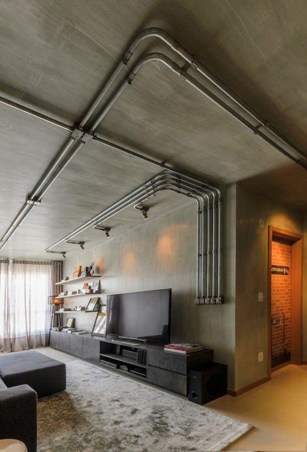

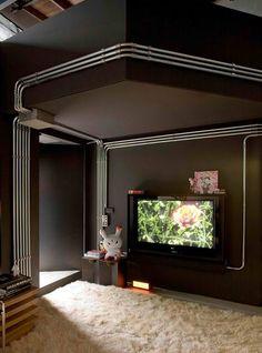

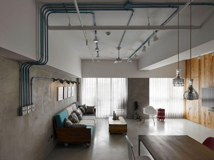

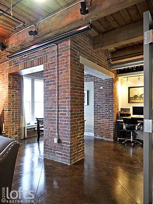

K78 Posted May 23, 2018 Share Posted May 23, 2018 (edited) 54 minutes ago, epsilonGreedy said: Our budgets and house size sound similar, I also intend to do as much internal work as possible. In my case with some extra conservation area material costs I hope will be possible to get to a weather-tight shell with a staircase, commissioned LPG boiler and a powered up mains CU for under £100k. I think it’s easily achievable tbh. Might regret that statement in a few months ? I appreciate prices of materials have gone up, but developers were selling new 4 bed detached houses in less desirable areas for £130k 15 years ago. And making a very healthy profit at the same time. I know many people will hate the look but I plan to leave my wiring and ducting exposed. I’ll do it myself and get it signed off. It’ll save me a lot in battons and plasterboard. I’ll be using ex display kitchens and bathrooms too. I’m importing my doors and windows from Eastern Europe. Not as cost effective as it was post brexit but still a big saving. Edited May 23, 2018 by K78 1 Link to comment Share on other sites More sharing options...

K78 Posted May 23, 2018 Share Posted May 23, 2018 2 minutes ago, PeterW said: I quite like the exposed stuff ..! My house will look “industrial”. One of the benefits of being single. My ex would have gone mental ? 2 Link to comment Share on other sites More sharing options...

Cpd Posted May 23, 2018 Share Posted May 23, 2018 2 hours ago, K78 said: I know many people will hate the look but I plan to leave my wiring and ducting exposed I like this...... got me thinking now ! Link to comment Share on other sites More sharing options...
