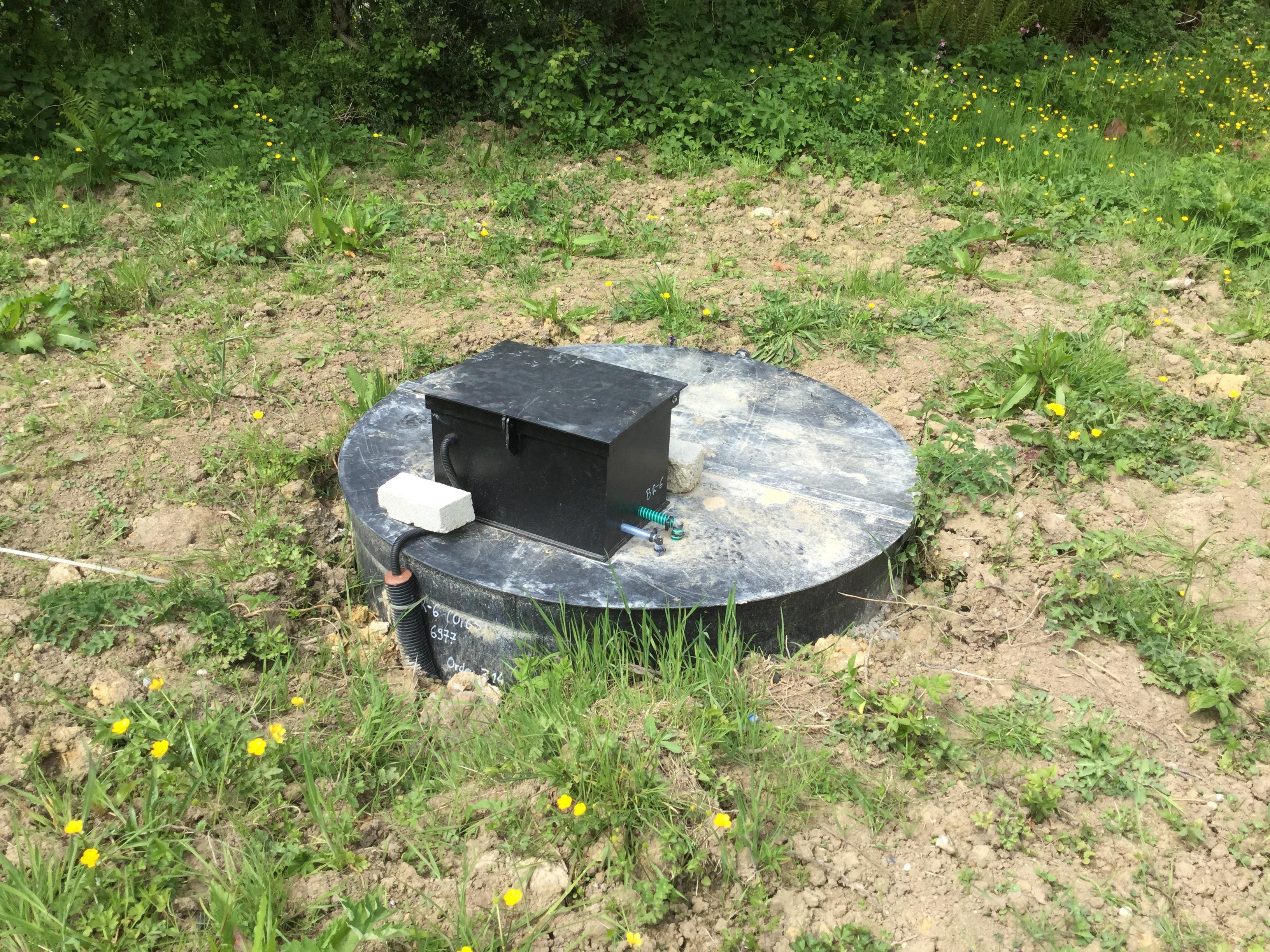

ProDave Posted May 18, 2018 Share Posted May 18, 2018 Since we are doing "show me yours" here is the Conder ASP6 The big green lid in the middle with the air vent is the chamber that holds the air blower. The small green lid off to the right is a cap that you unscrew and that's where the hose goes down to pump it out. I have already had a "complaint" Could I make that right hand cap flush with the ground please as it gets in the way when mowing the grass....... Link to comment Share on other sites More sharing options...
Stones Posted May 18, 2018 Share Posted May 18, 2018 22 minutes ago, joe90 said: Interesting as I have just installed my Vortex and err indoors said” wots that orrible box in the middle of the garden”. I just looked at it and the water level inside is about 700mm below ground level and I think I could lower the box into the lid to make it almost flush. Might muck up the warranty but would look a lot better. There is a lift out 'tray' inside the Biopure in which the air pump sits, so visually, all we have is the lid of the unit. You do however have to lift the tray out to access the internals of the unit. Having to build a housing to hide the box was something I didn't want to have to bother about hence my decision. Link to comment Share on other sites More sharing options...
Ian Posted May 18, 2018 Share Posted May 18, 2018 24 minutes ago, joe90 said: I think I could lower the box into the lid to make it almost flush. Might muck up the warranty but would look a lot better. the main risk of recessing the pump box is that it could potentially flood in a heavy rainstorm Link to comment Share on other sites More sharing options...
newhome Posted May 18, 2018 Share Posted May 18, 2018 Big planter with attractive plant in front of the thing in line of sight, and use a strimmer to address the difficulty mowing. Job done lol. 1 Link to comment Share on other sites More sharing options...
joe90 Posted May 18, 2018 Share Posted May 18, 2018 We had planned evergreen shrubs around it but if it could be recessed even better. I don’t think it would flood as the outlet is as large as the inlet, rainwater cannot enter it and there would still be 40pmm from water level to base of container. Best not to alter a good design tho ? Link to comment Share on other sites More sharing options...

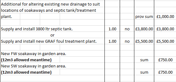

ultramods Posted January 11, 2019 Share Posted January 11, 2019 The plan for my new house was to connect to the mains foul pipe, however Scottish Water Still haven't adopted it, which means I may need to install a septic tank. I asked our ground worker to provide a quote for installing a septic tank. Can you give me feedback on the proposed costs please as the actual cost of a septic tank appears to be fairly cheap and I thought that the installation wouldn't require too much work? Link to comment Share on other sites More sharing options...
