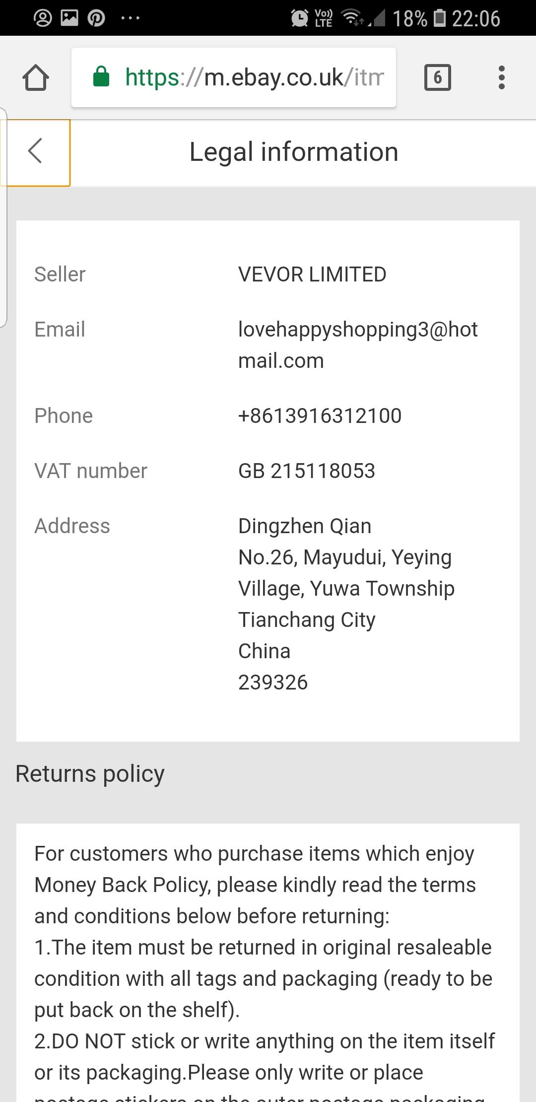

So it wasn't a question of is this the right pipe, but rather would you trust a product from Germany that's half the price of anything I can find in the UK, has all the correct approvals, but no sign of a manufacturers name that I can see in any of the photographs.
Picture 11 of 12 gives a CJ... code:
a) Chinese trade standard: CJ/T108, CJ/T159, CJ/T111
Sorry bud, I don't think I would. Pretty sure it's Chinese not European made.Screenshot_20180512-220603_Chrome.thumb.jpg.a02f71459151cc1dbf052eaa2d74202d.jpg

It looks ( end section ) identical to what I routinely use.
Its cheap enough to make me look closely at it that's for sure.
It'll only ever see <2.0bar in normal service so how bad can it actually be ?

A lot of the pipe is still manufactured in Germany and Italy.
Here’s a link to a site manufacturing pipe in China for info.
http://m.sunplastpipe.com/multilayer-pipe/astm-f-1281-standard-en-iso21003-standard-ce.html
The following suggests that they supply to companies who wish to sell with their own branding?
Markings on the pipe
Customer's logo can be stamped
If reclaiming the tax is important check whether they will supply something that HMRC will allow otherwise the cost differential is less.
And if you do order via the original link it appears that they will accept a ‘best offer’ from feedback received.
Worth an enquiry to ask for a free sample maybe?
