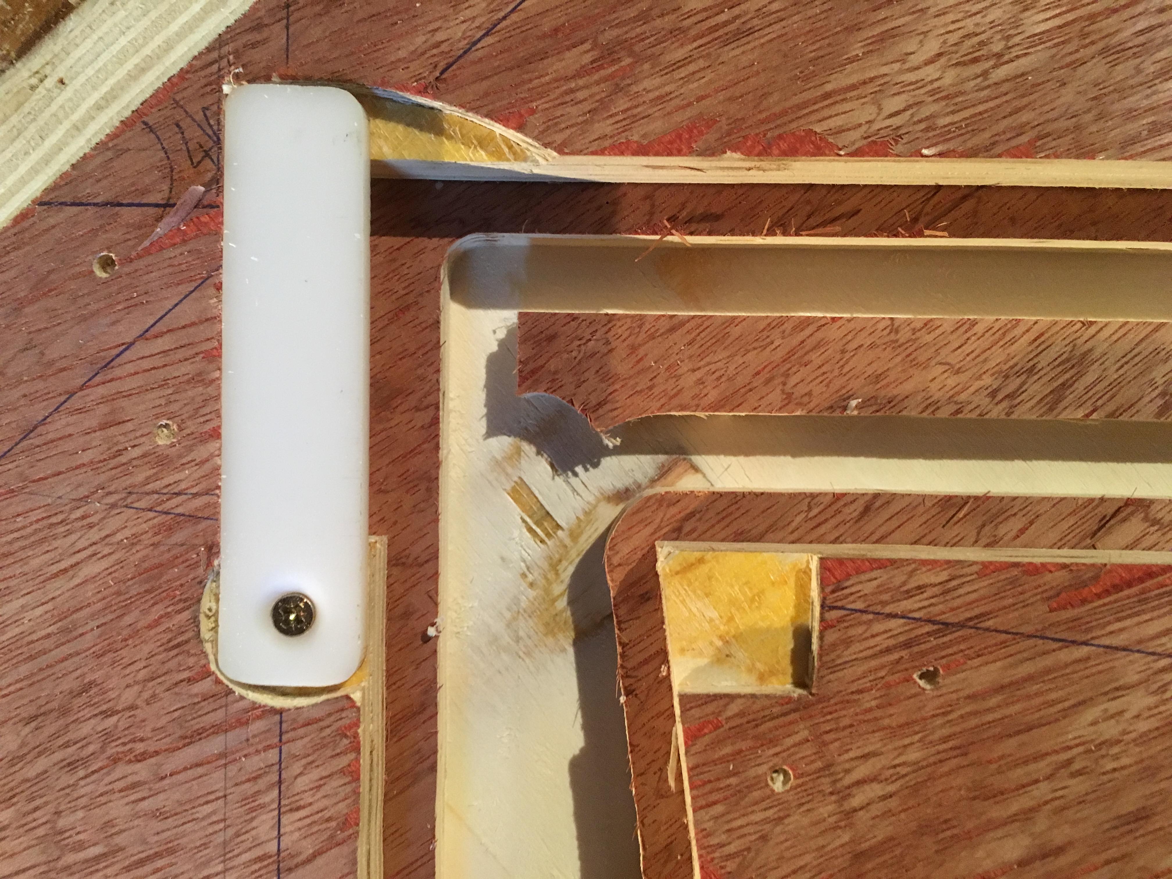

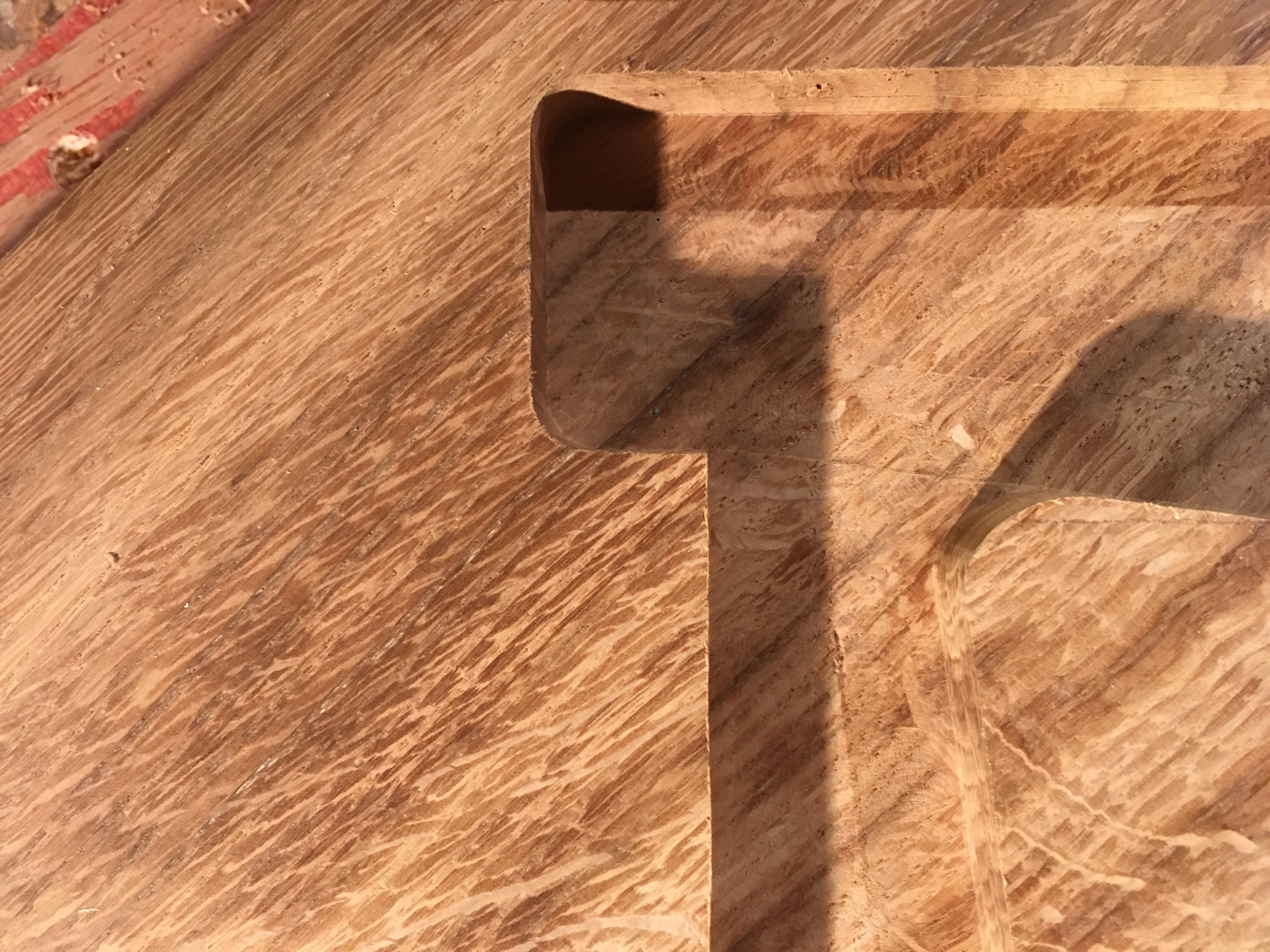

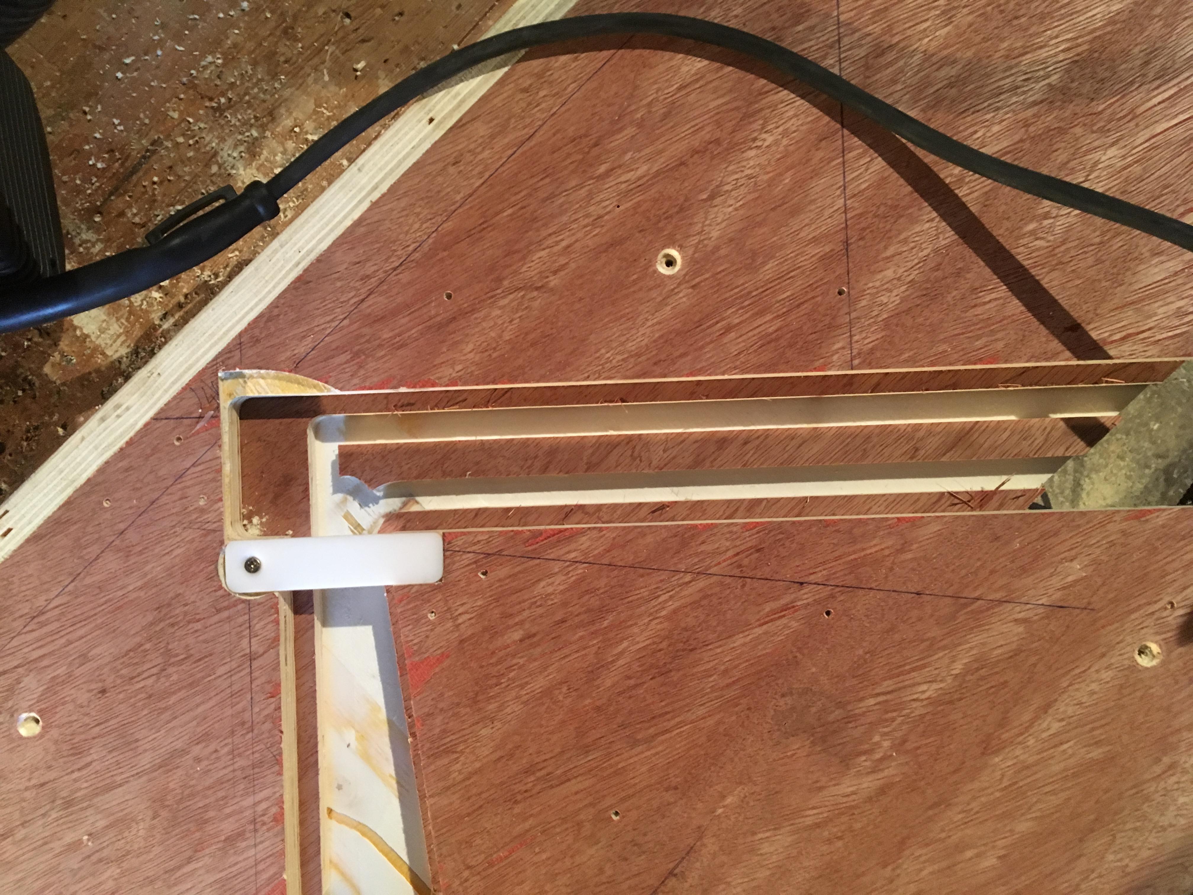

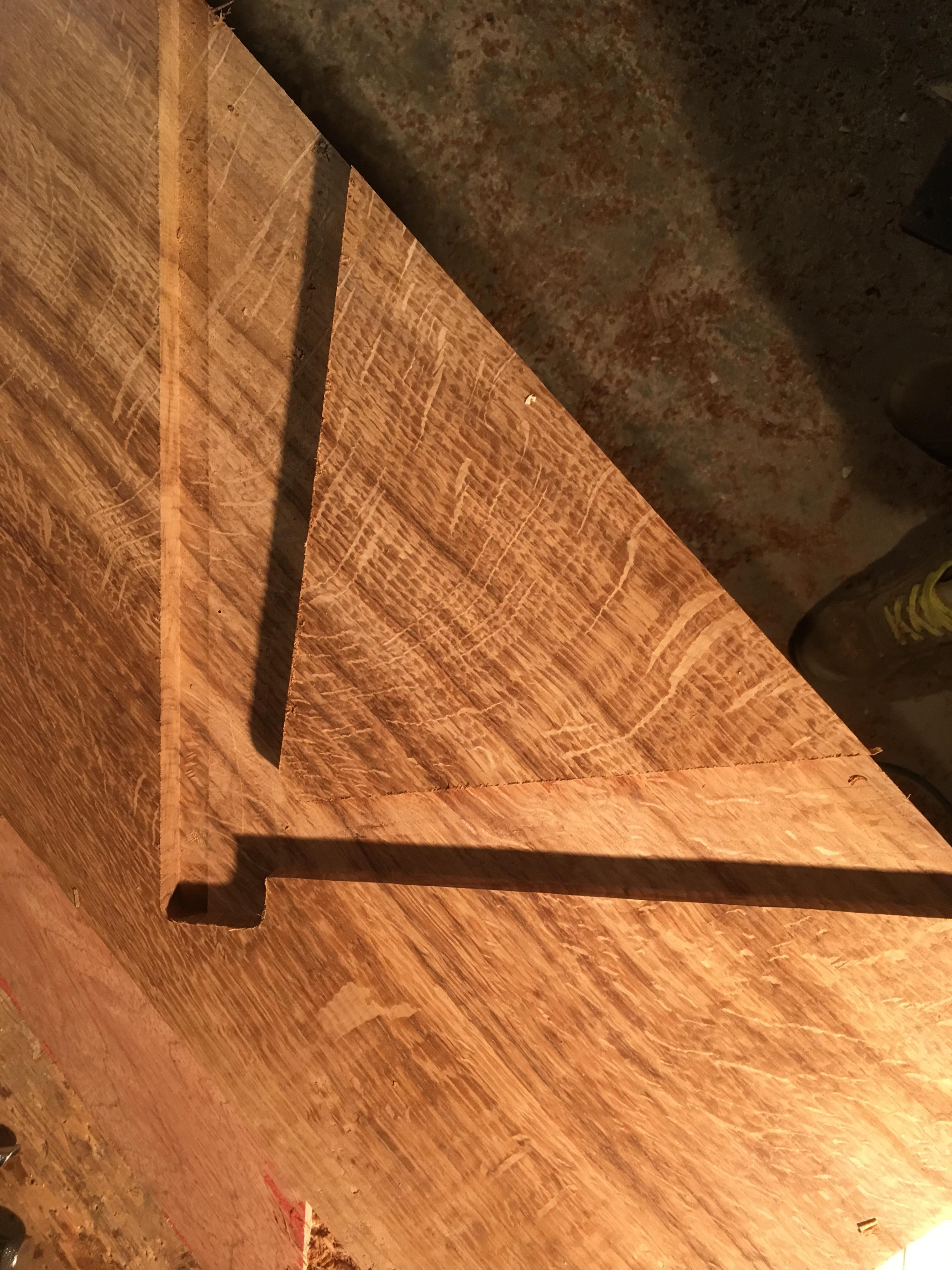

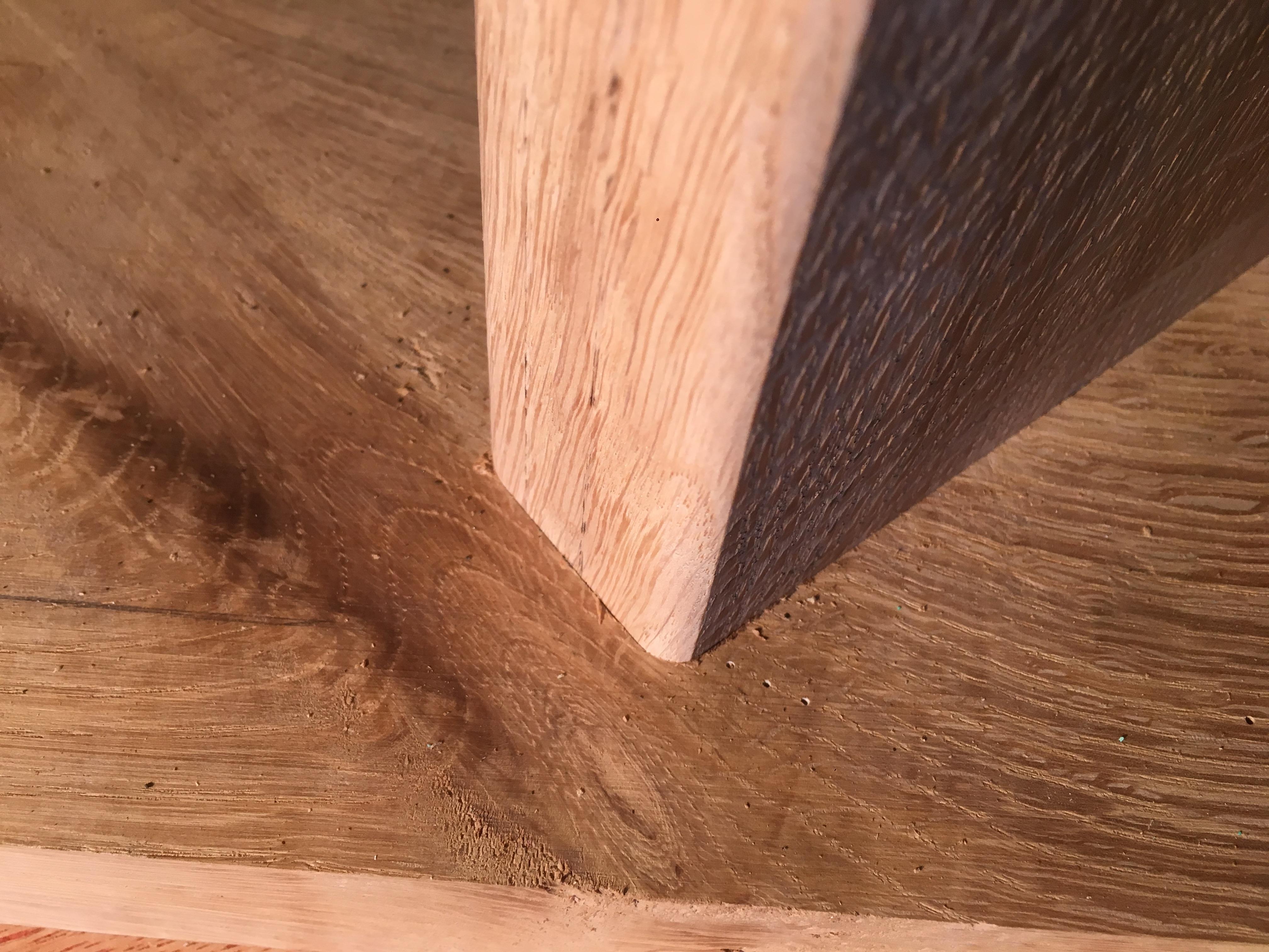

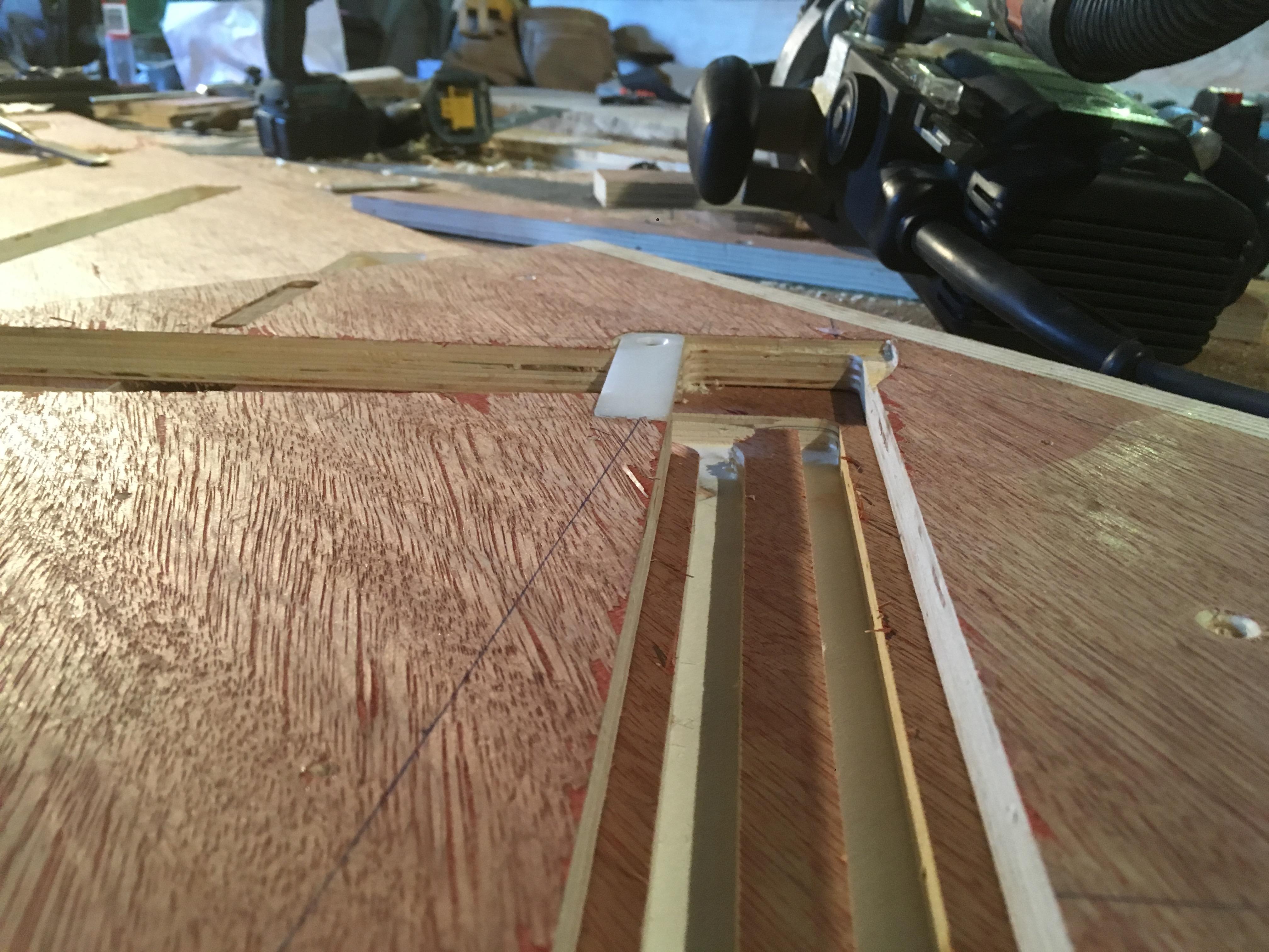

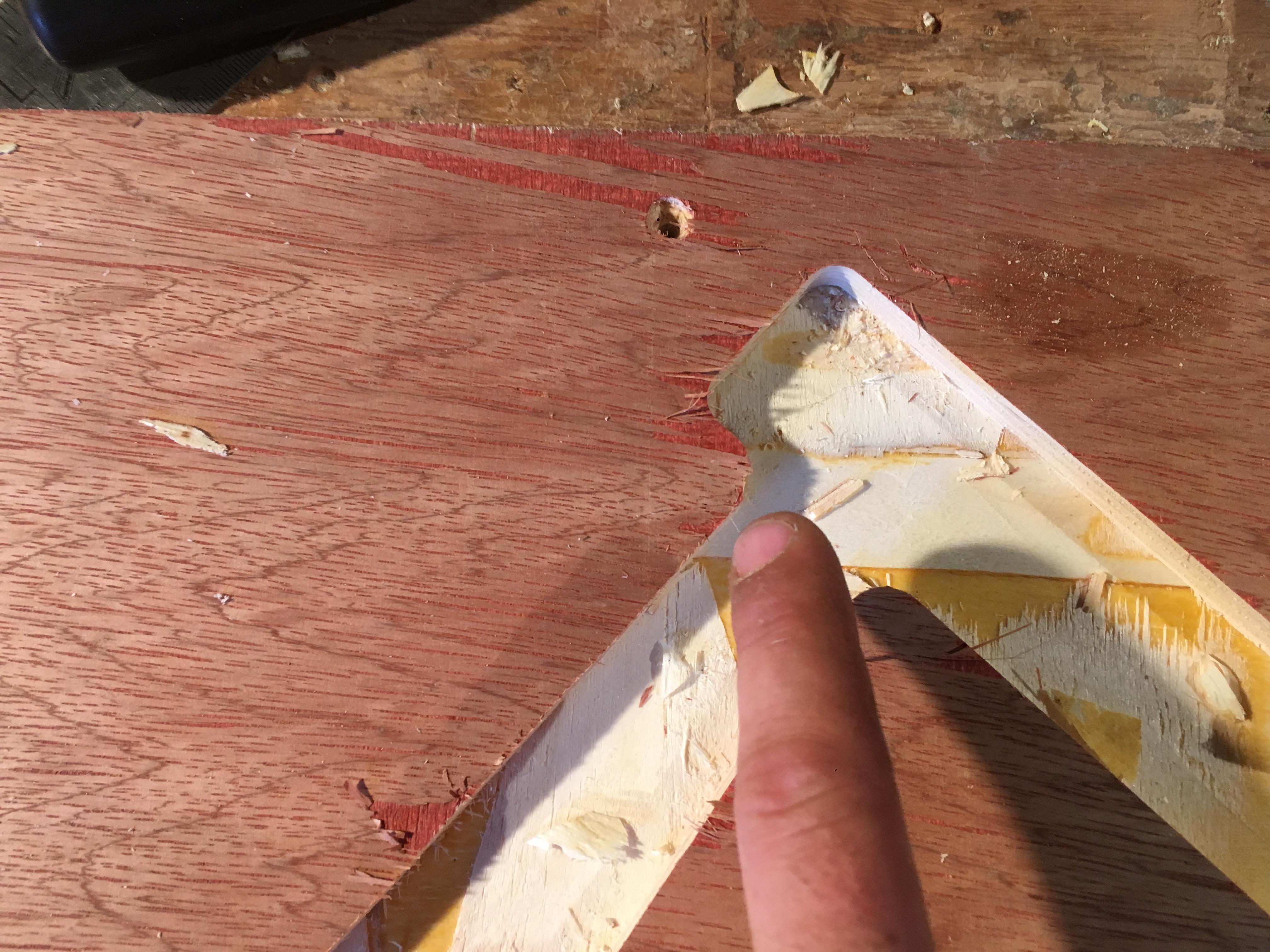

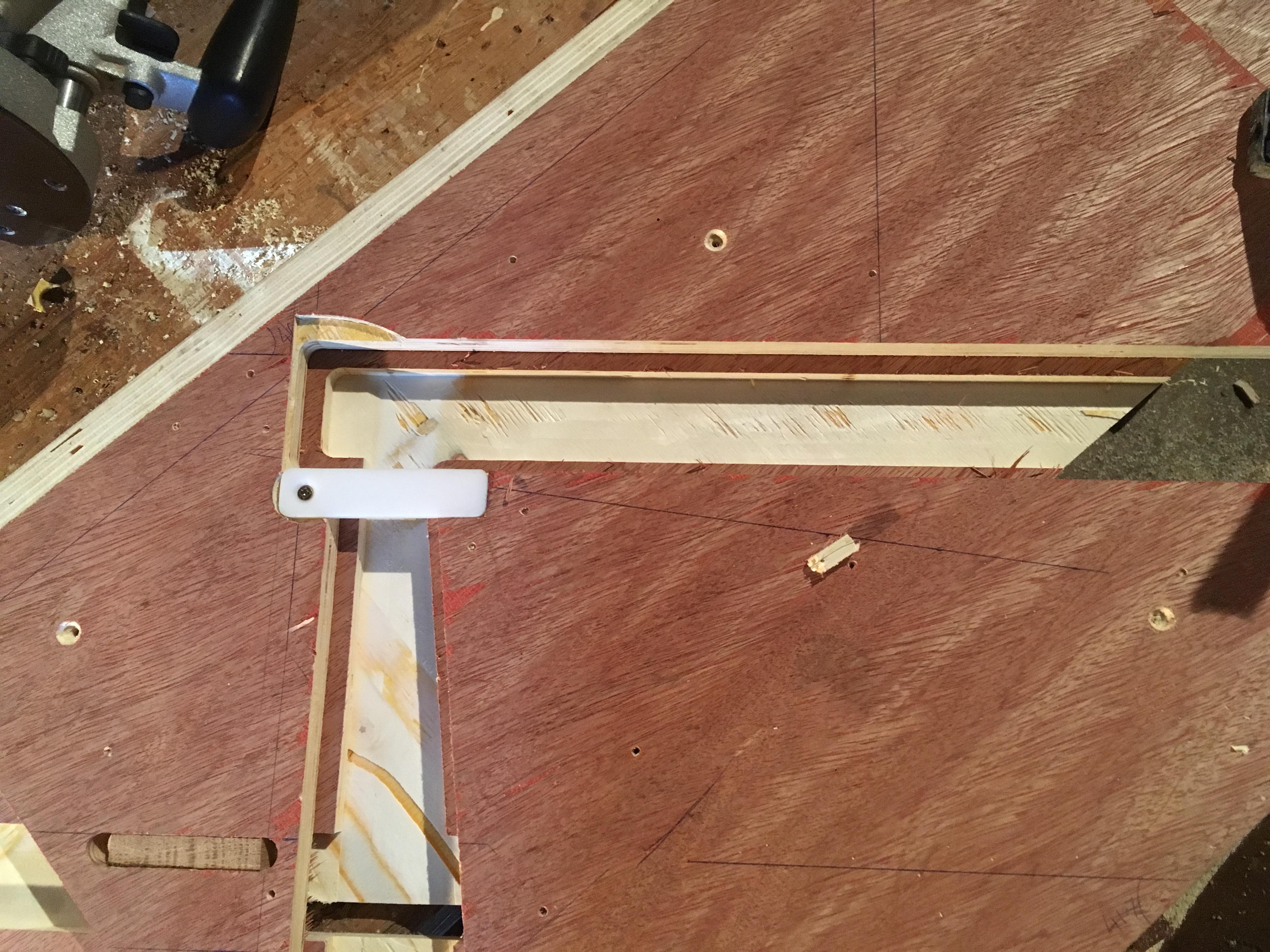

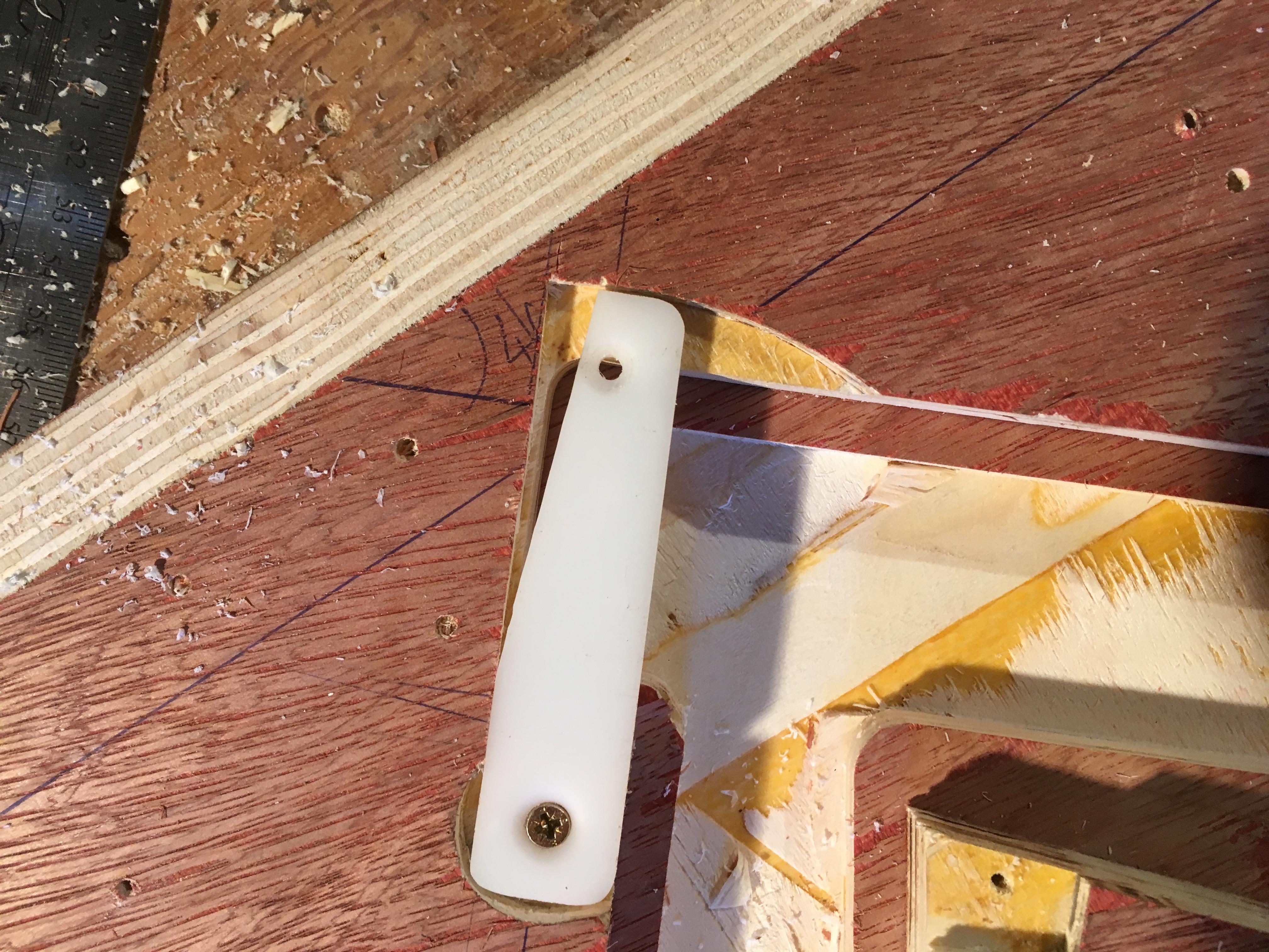

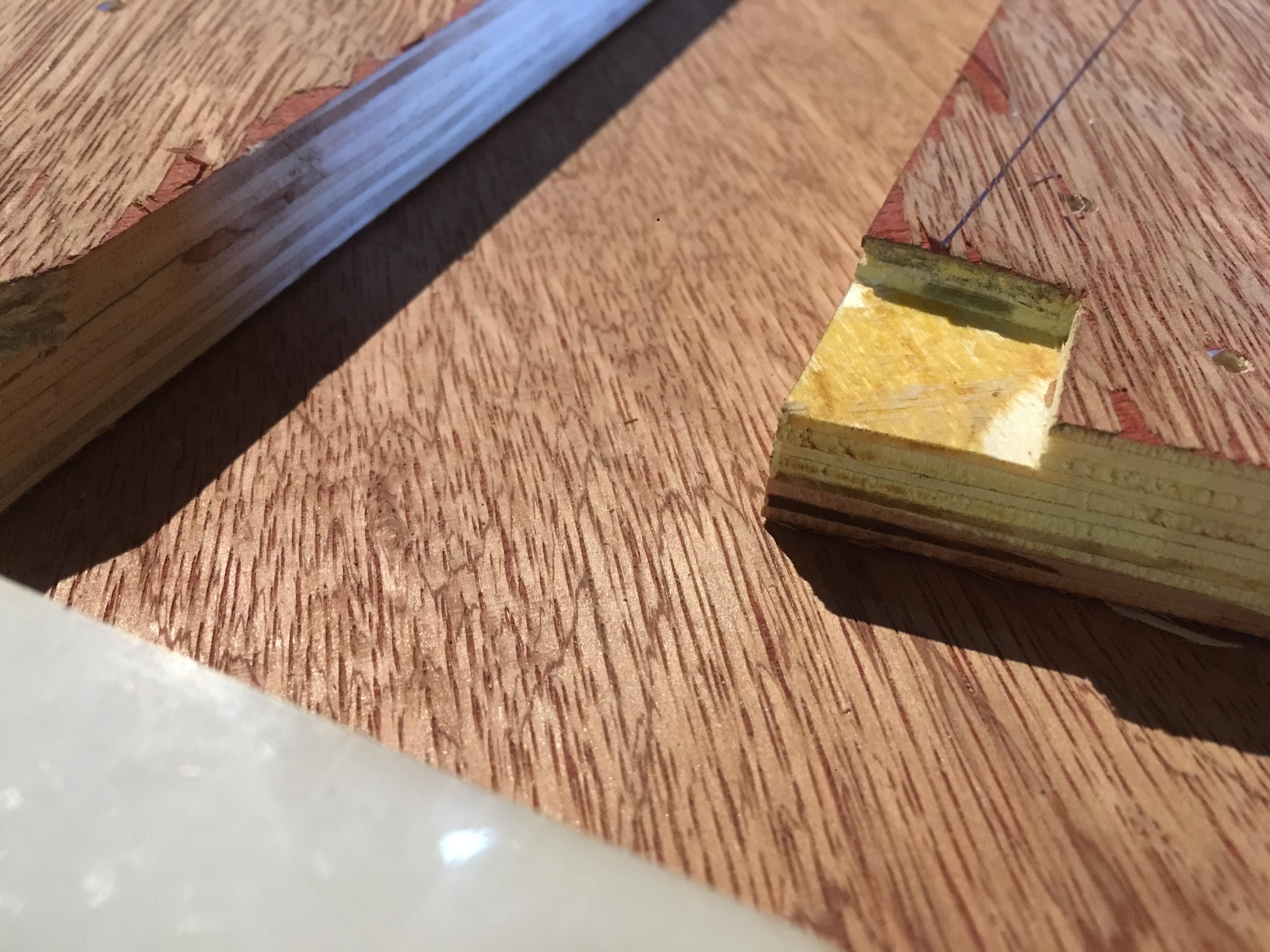

Construction Channel Posted June 16, 2018 Author Share Posted June 16, 2018 1 minute ago, Onoff said: Did you try and work it out on CAD first? i have modelled the entire staircase in SketchUp, hence the test string fitting first time, when making the jig I just assumed using the guide bush would be fine. I'm a carpenter, not a joiner so my experience of jigs is limited to pretty much worktop and hinge jigs, although I did a layout for a stair jig in college I don't remember actually cutting it or using it. the more I think about the inserts to get over the problem, the less I like them, it looks like I will be starting afresh in the morning,also i cant see the need to use the flared router bit, as long as I don't put much if any glue on the front faces it should be fine with a straight cut, Link to comment Share on other sites More sharing options...
Construction Channel Posted June 17, 2018 Author Share Posted June 17, 2018 grrr even on the instruction manual for a shop bought one it shows a rounded corner under the nosing...... page 10 https://titman.co.uk/media/import/TSTAIR-Stair-Jig-Instructions.pdf it looks like I might be making some inserts after all. Link to comment Share on other sites More sharing options...
Onoff Posted June 17, 2018 Share Posted June 17, 2018 Guess you've already come across this vid? Link to comment Share on other sites More sharing options...
Construction Channel Posted June 17, 2018 Author Share Posted June 17, 2018 11 minutes ago, Onoff said: Guess you've already come across this vid? Yeah but he isn’t using a guide bush so it means making new jigs which I am trying to avoid if I can. Link to comment Share on other sites More sharing options...

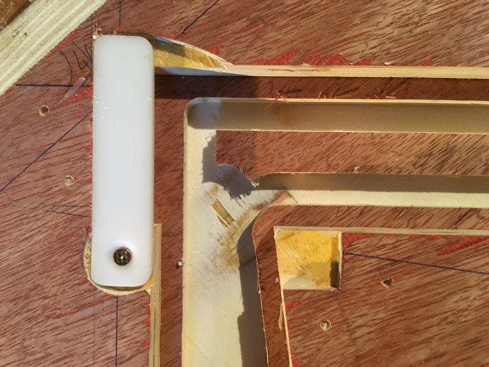

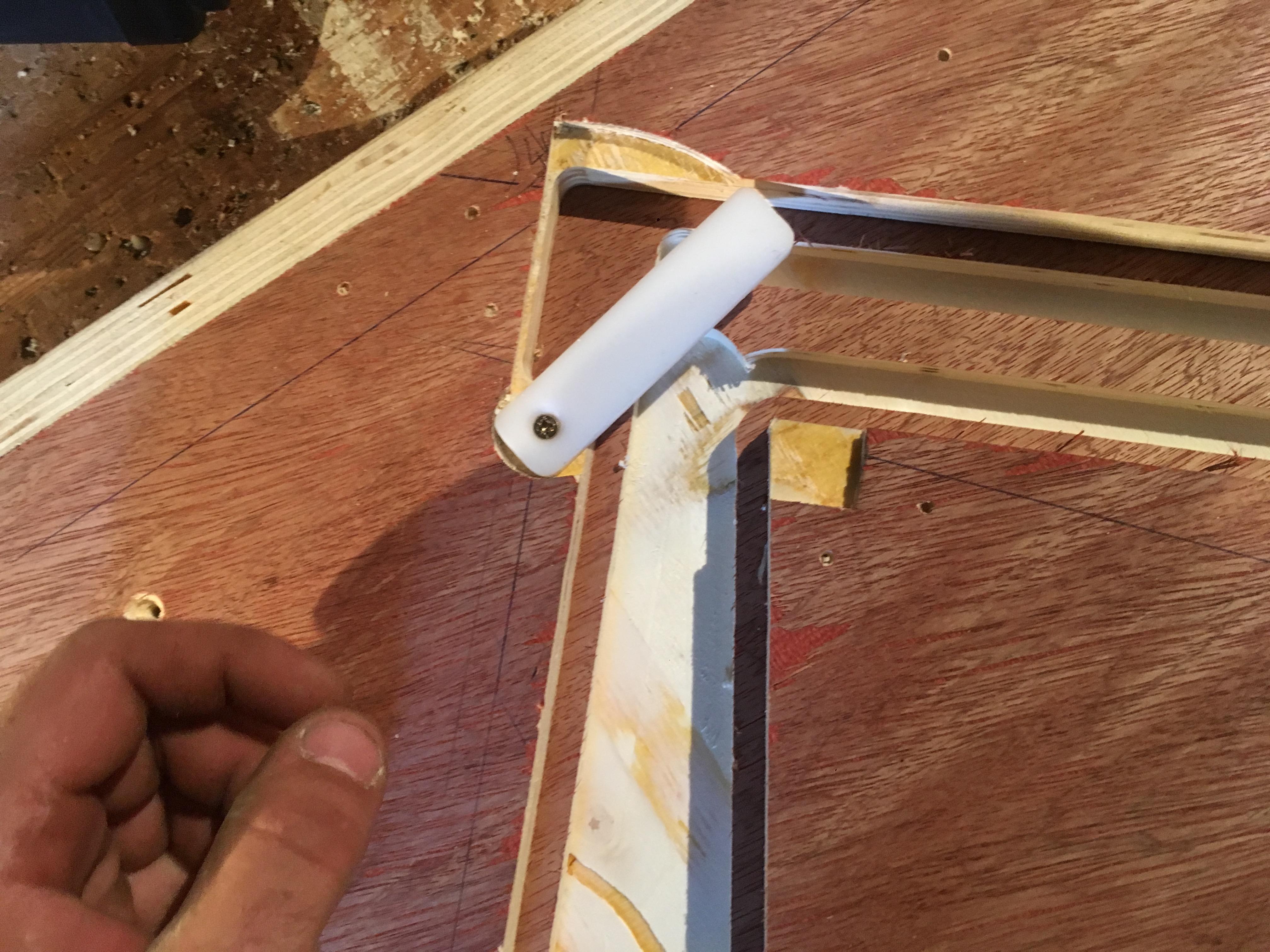

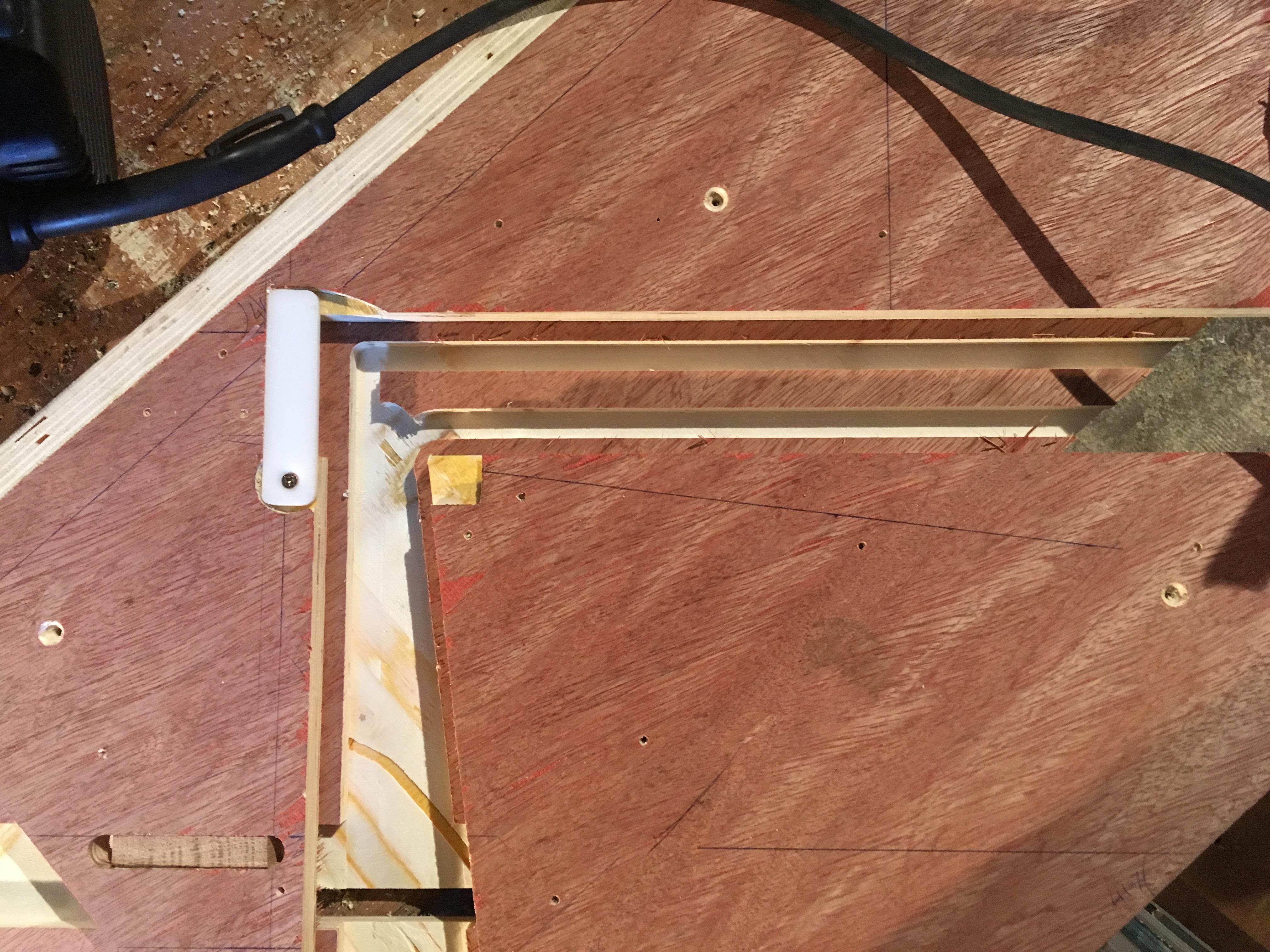

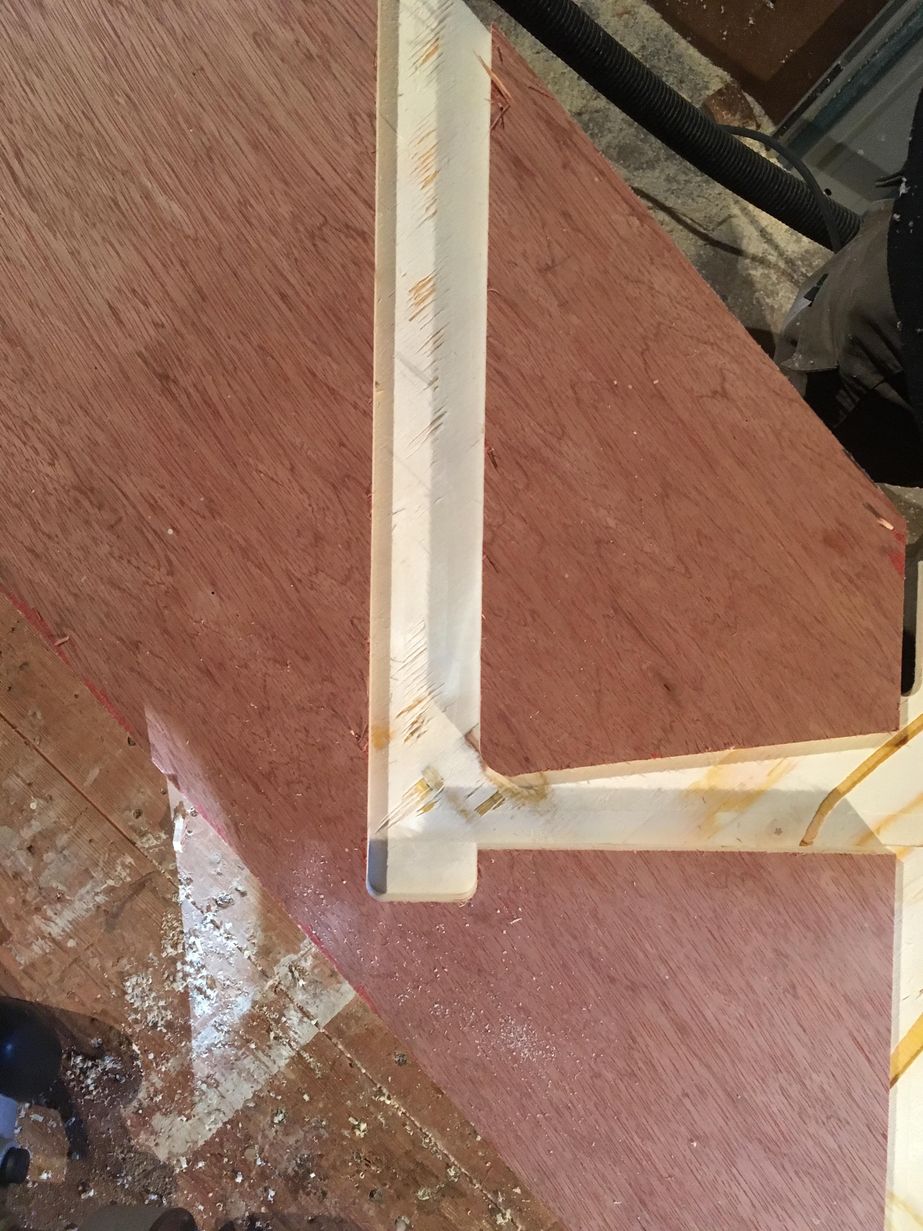

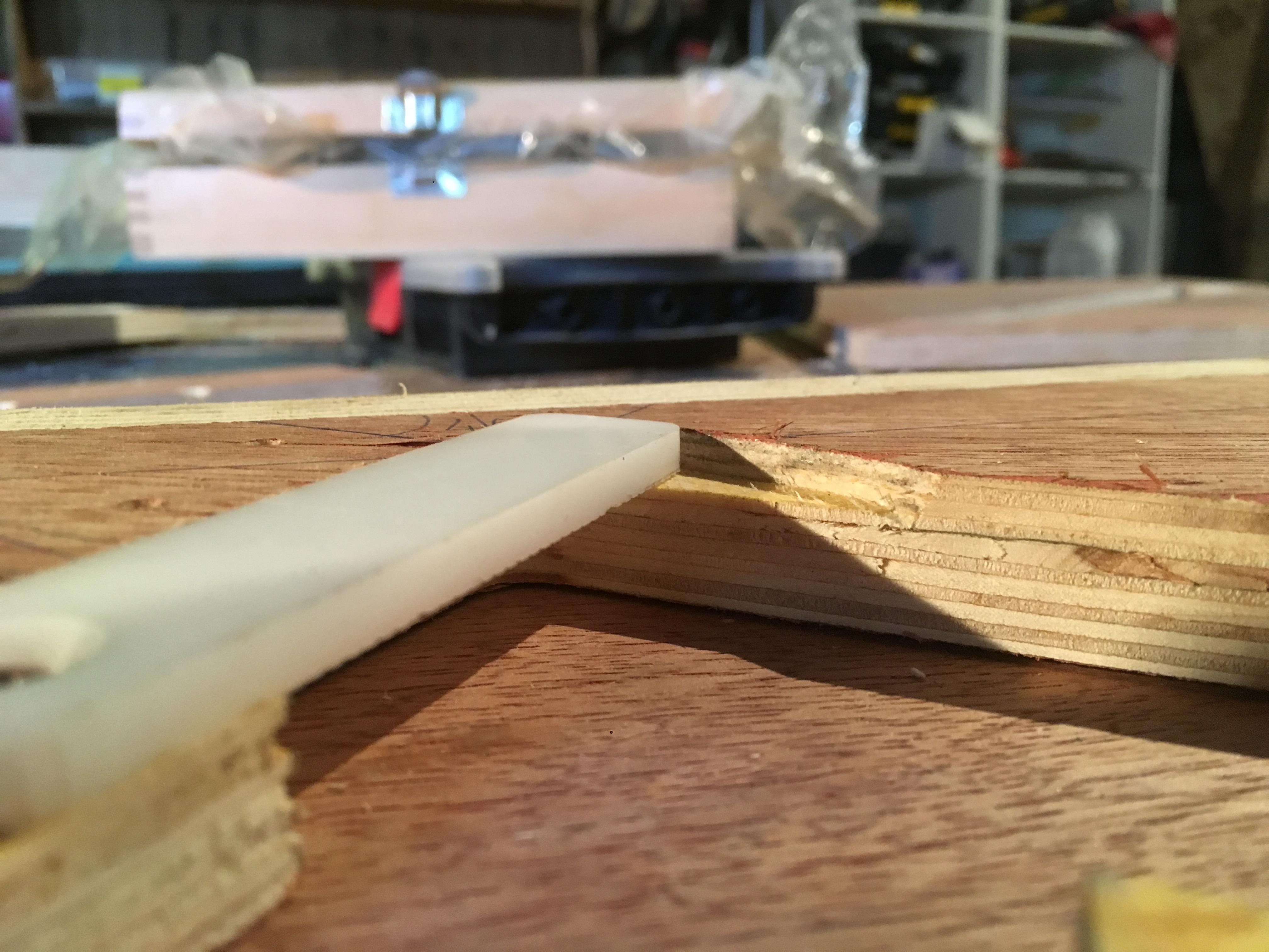

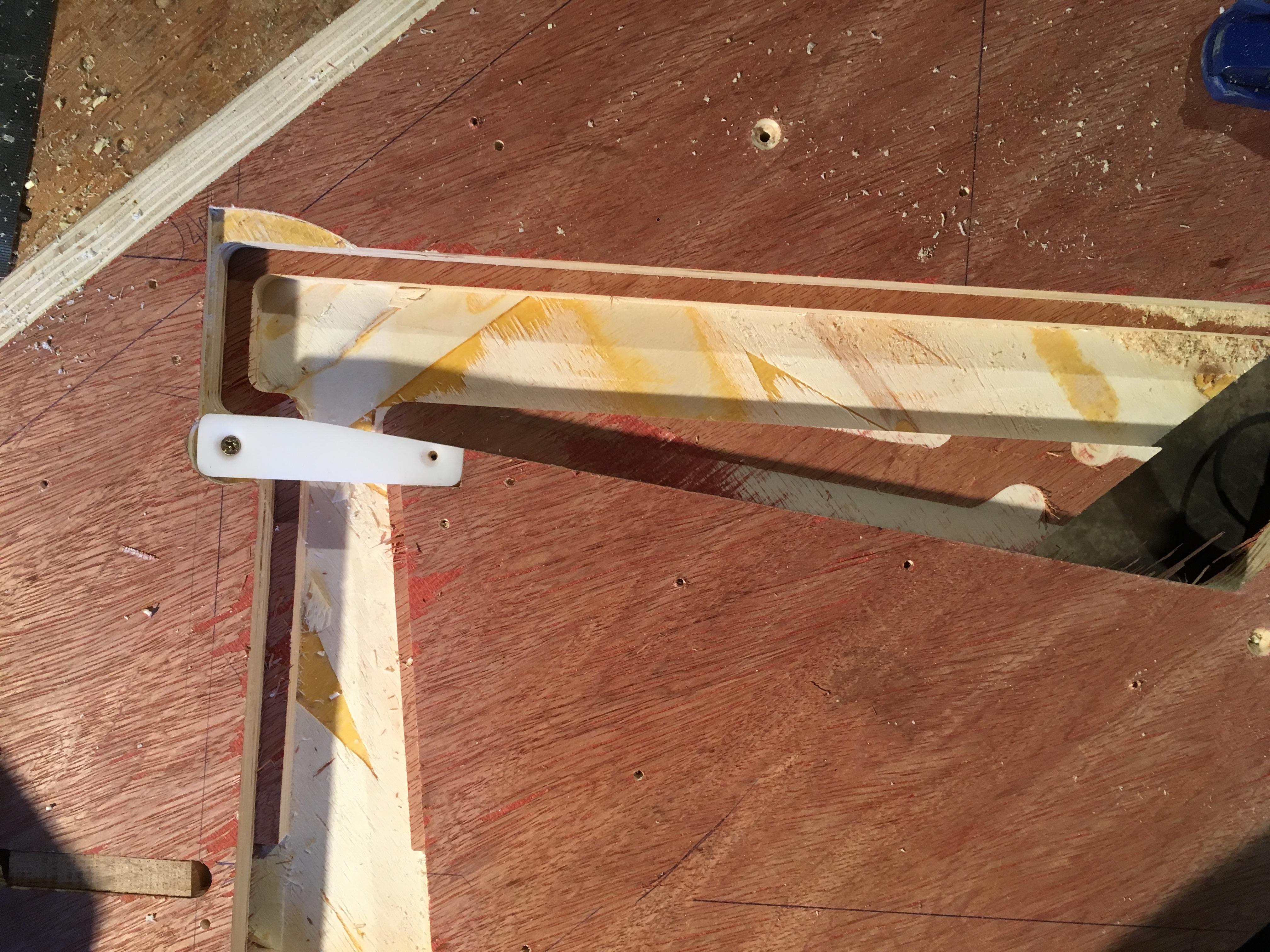

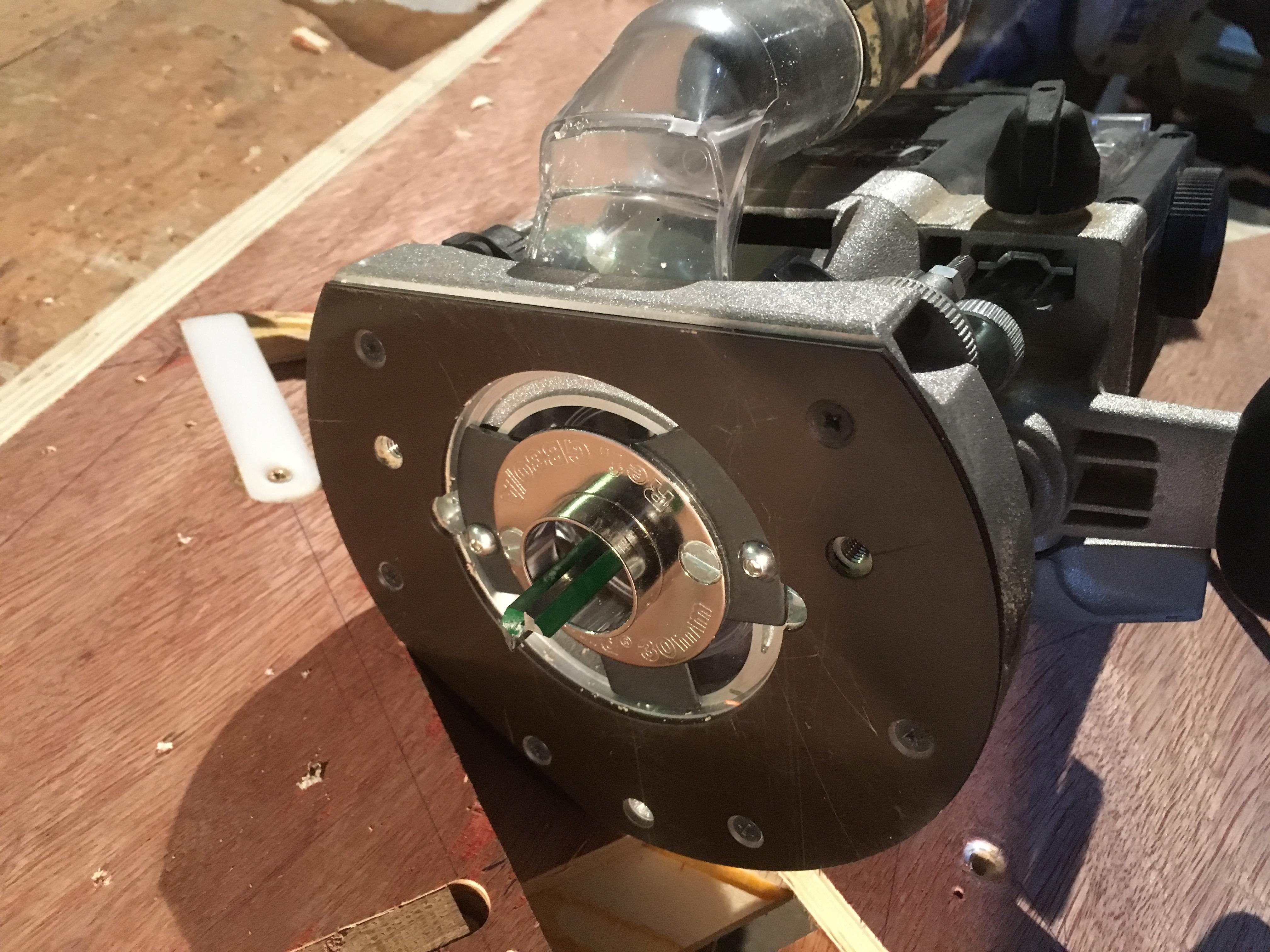

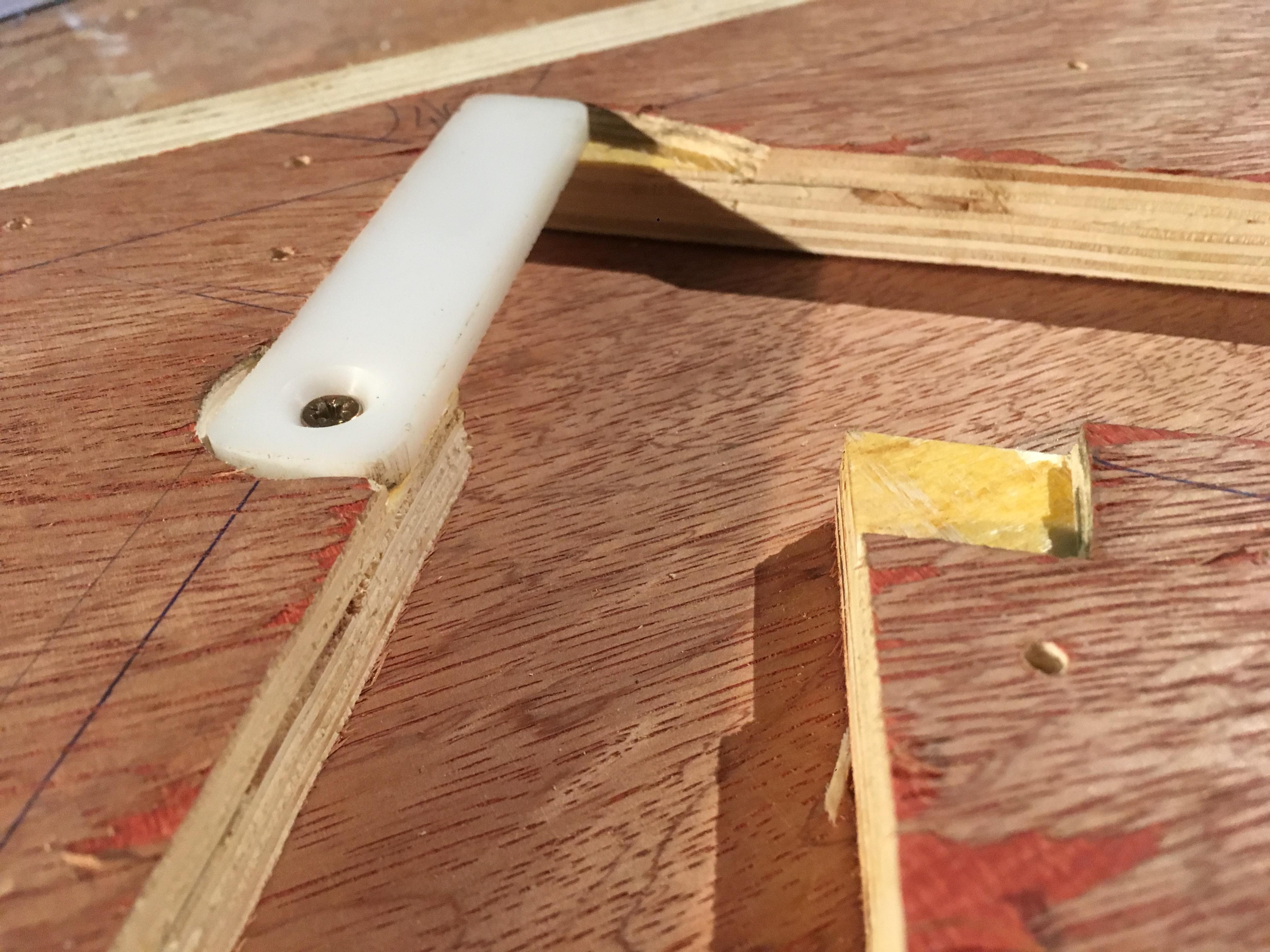

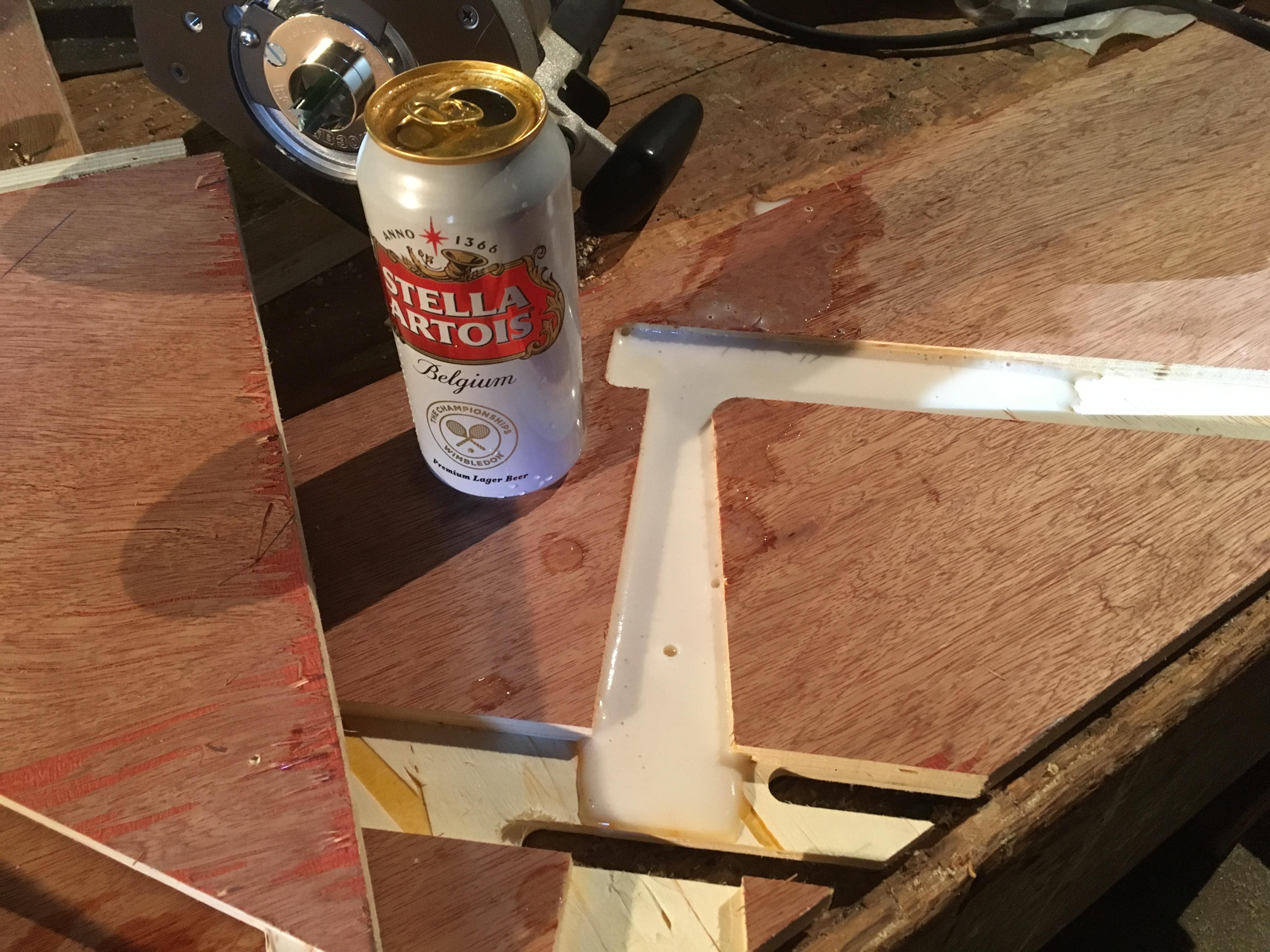

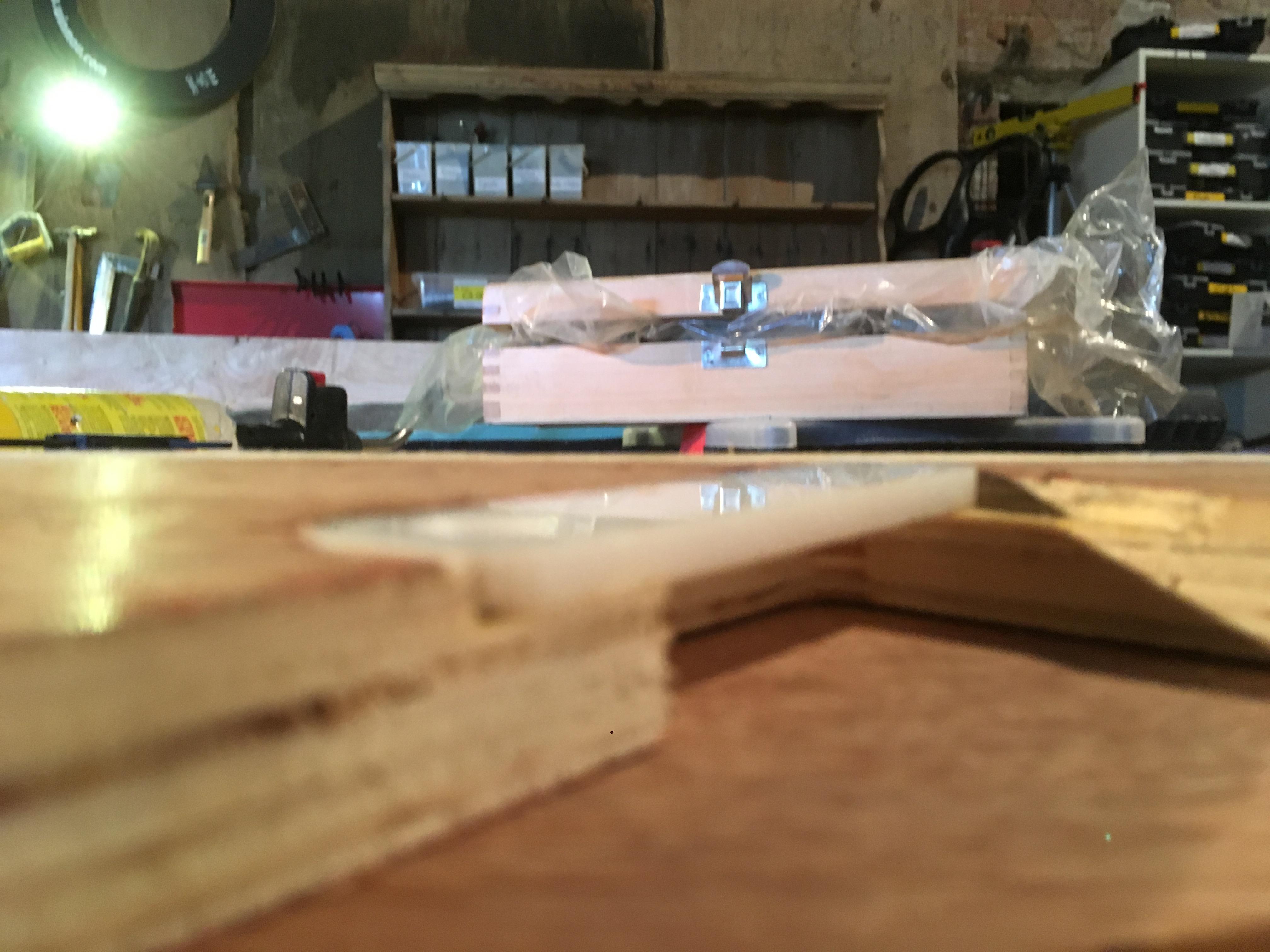

Construction Channel Posted June 18, 2018 Author Share Posted June 18, 2018 God I’m good ? so issue was this rounded corner. This is where my riser will meet the underside of my tread so I really need it to be a nice square corner, question was how to get around it without making a new jig. and this is the answer I have come up with. The clever part is that the bit of Perspex isn’t as thick as the 30mm bush so it still runs on the original jig and not my new very cunning cut outs. First cut goes goes up the left and around clockwise ( starting on the tread would risk tear out on my problem corner because the way the bit is spinning) then an I just flick it down to its secondary position and cut the rest clockwise again. now I just need to replicate the recess on the other side and this is the best jig on the market if your stair has exactly 200.8mm rise, 225mm going 42mm treads and 18mm risers Link to comment Share on other sites More sharing options...
Construction Channel Posted June 18, 2018 Author Share Posted June 18, 2018 Hang on, I haven’t taken out for the treads wedge yet.... then it will be the best one. Link to comment Share on other sites More sharing options...

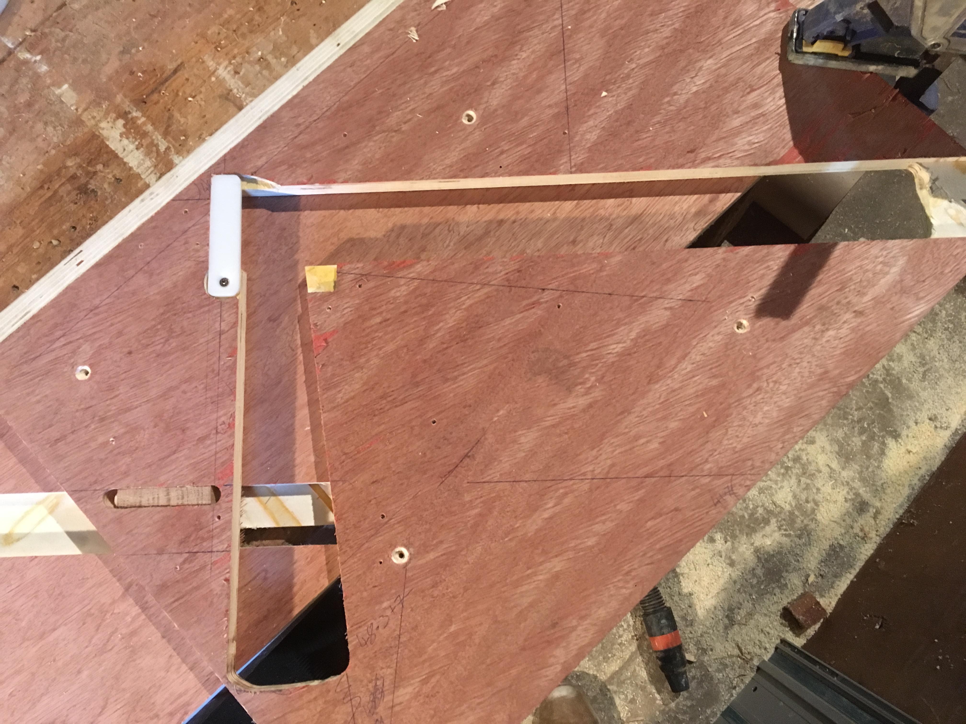

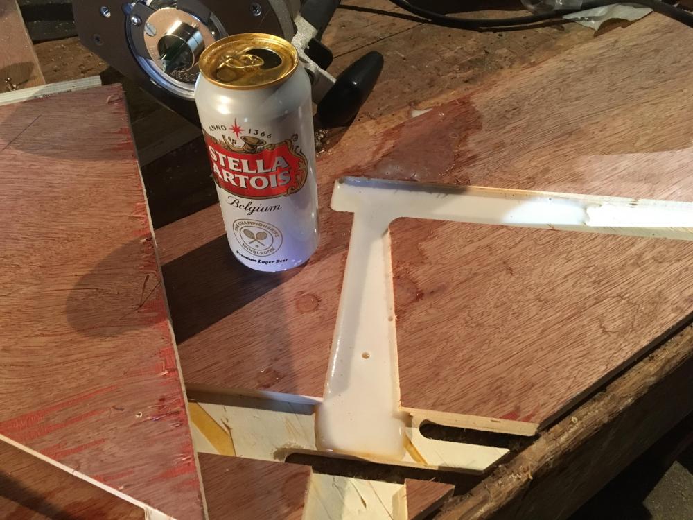

Construction Channel Posted June 18, 2018 Author Share Posted June 18, 2018 Now it could do with improvement. 2 Link to comment Share on other sites More sharing options...

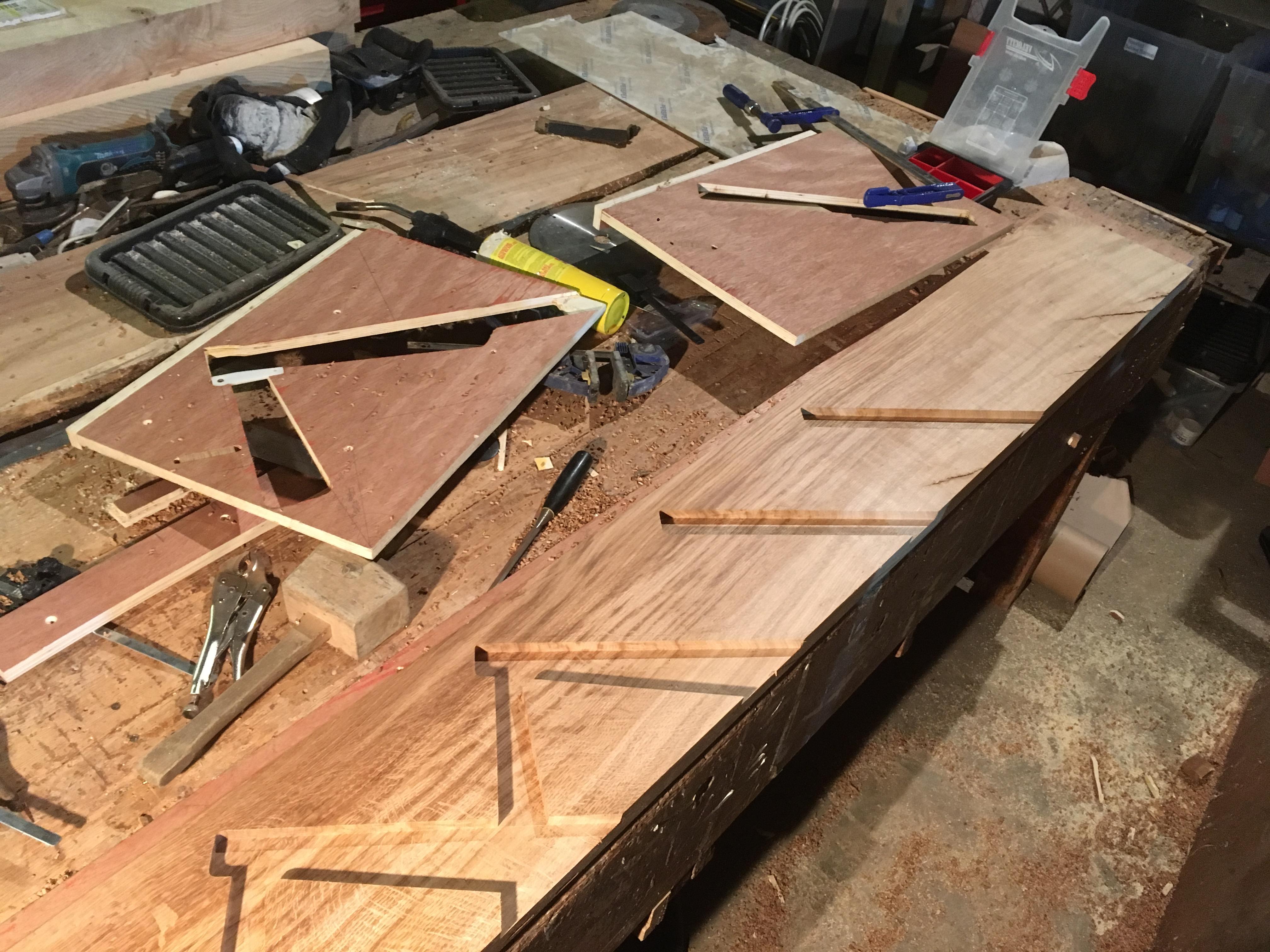

Construction Channel Posted June 19, 2018 Author Share Posted June 19, 2018 Well Iv started. The little plastic bit is fantastic. Now to choose and machine up the other side..... 4 1 Link to comment Share on other sites More sharing options...

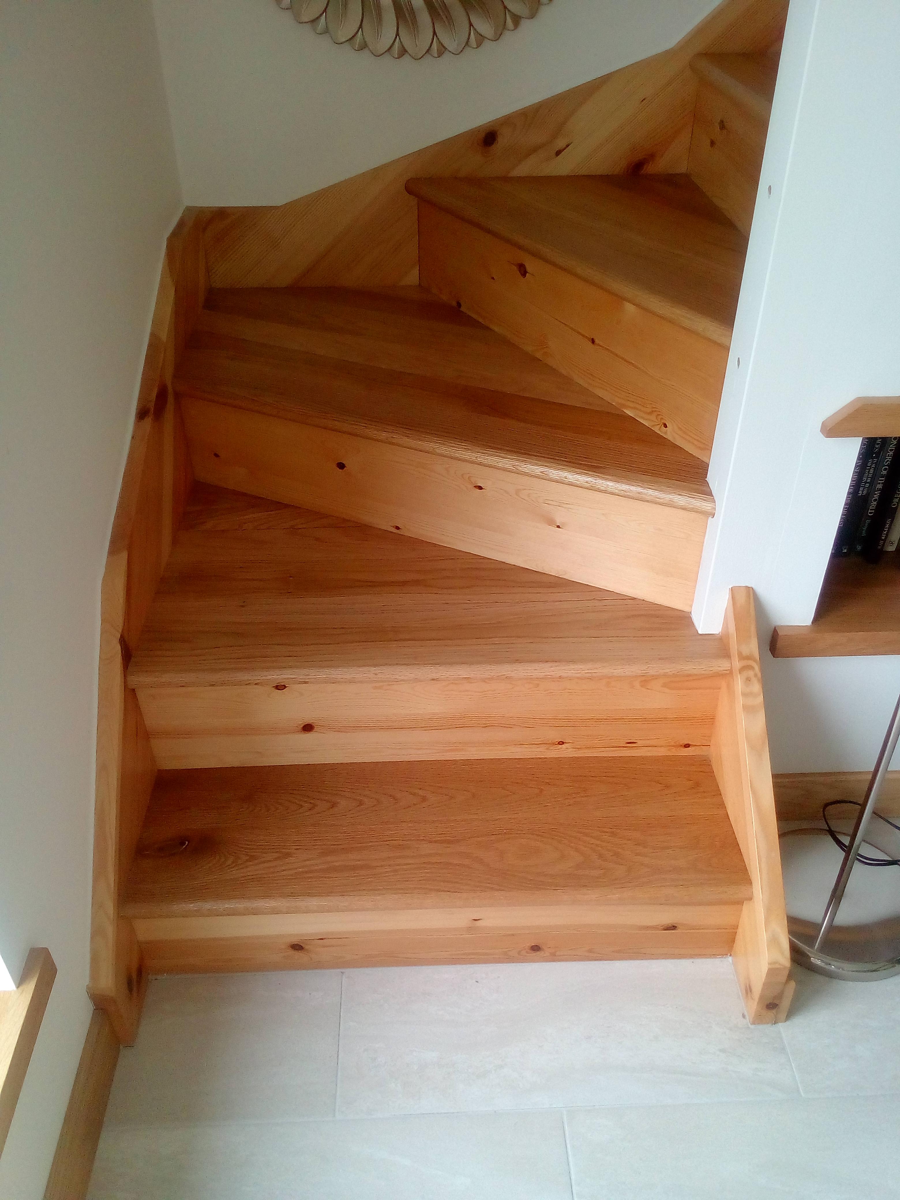

Construction Channel Posted June 23, 2018 Author Share Posted June 23, 2018 you guys have already seen most of this, but because I had to at least start making some kind of video again before I get the wedding footage here's where we currently are with the stairs in the form of a very shaky and long-winded video;) enjoy 1 Link to comment Share on other sites More sharing options...
Nickfromwales Posted June 24, 2018 Share Posted June 24, 2018 On 20/06/2018 at 10:07, Construction Channel said: the stair was always going to be a mix of woods so hopefully it will look ok. It'll look the dogs bollocks mate. 1 Link to comment Share on other sites More sharing options...
Stones Posted June 24, 2018 Share Posted June 24, 2018 We have a mixed timber stair, oiled with Osmo. Oak treads softwood stringers and risers. Looks surprisingly good. 1 Link to comment Share on other sites More sharing options...

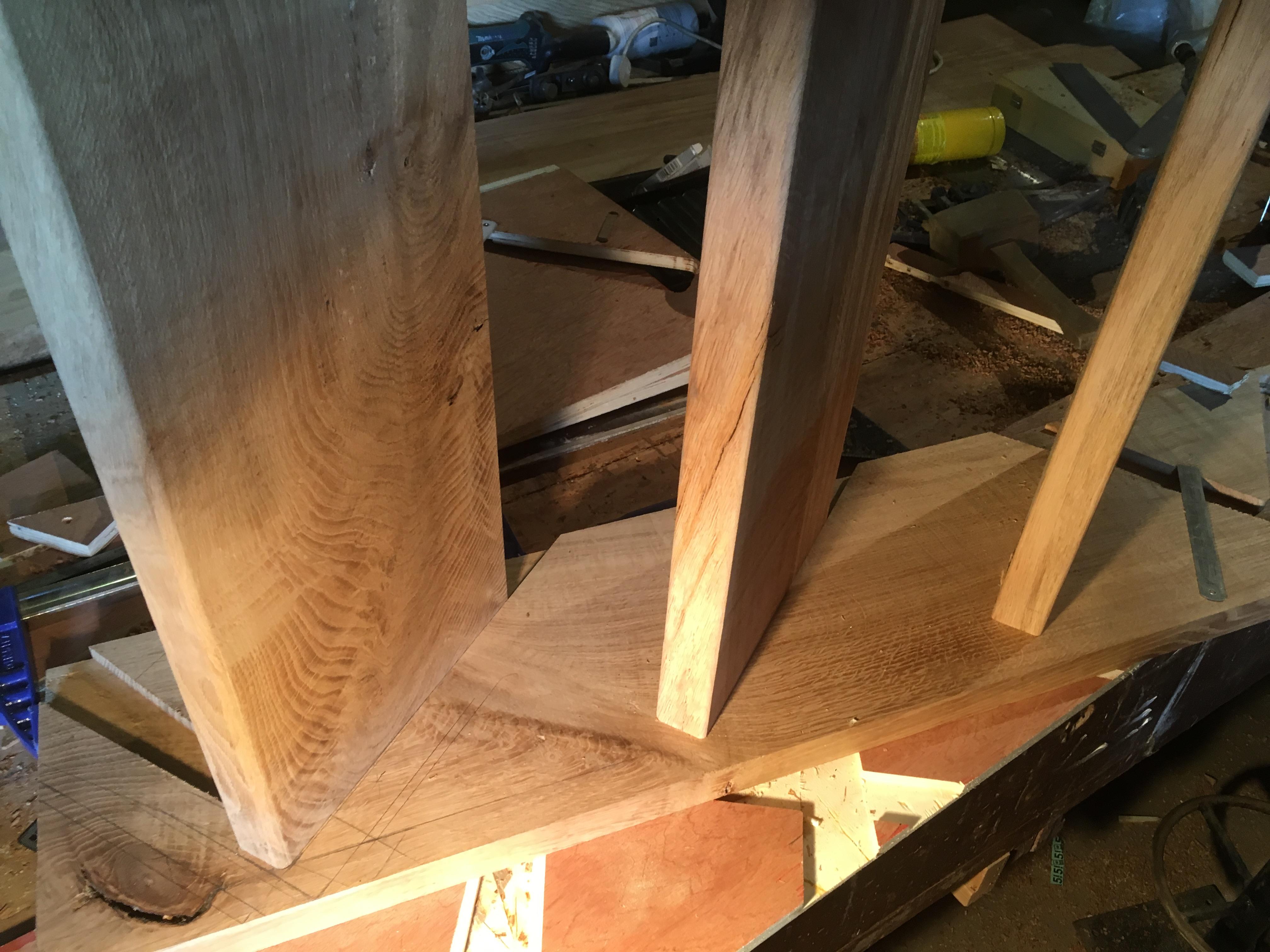

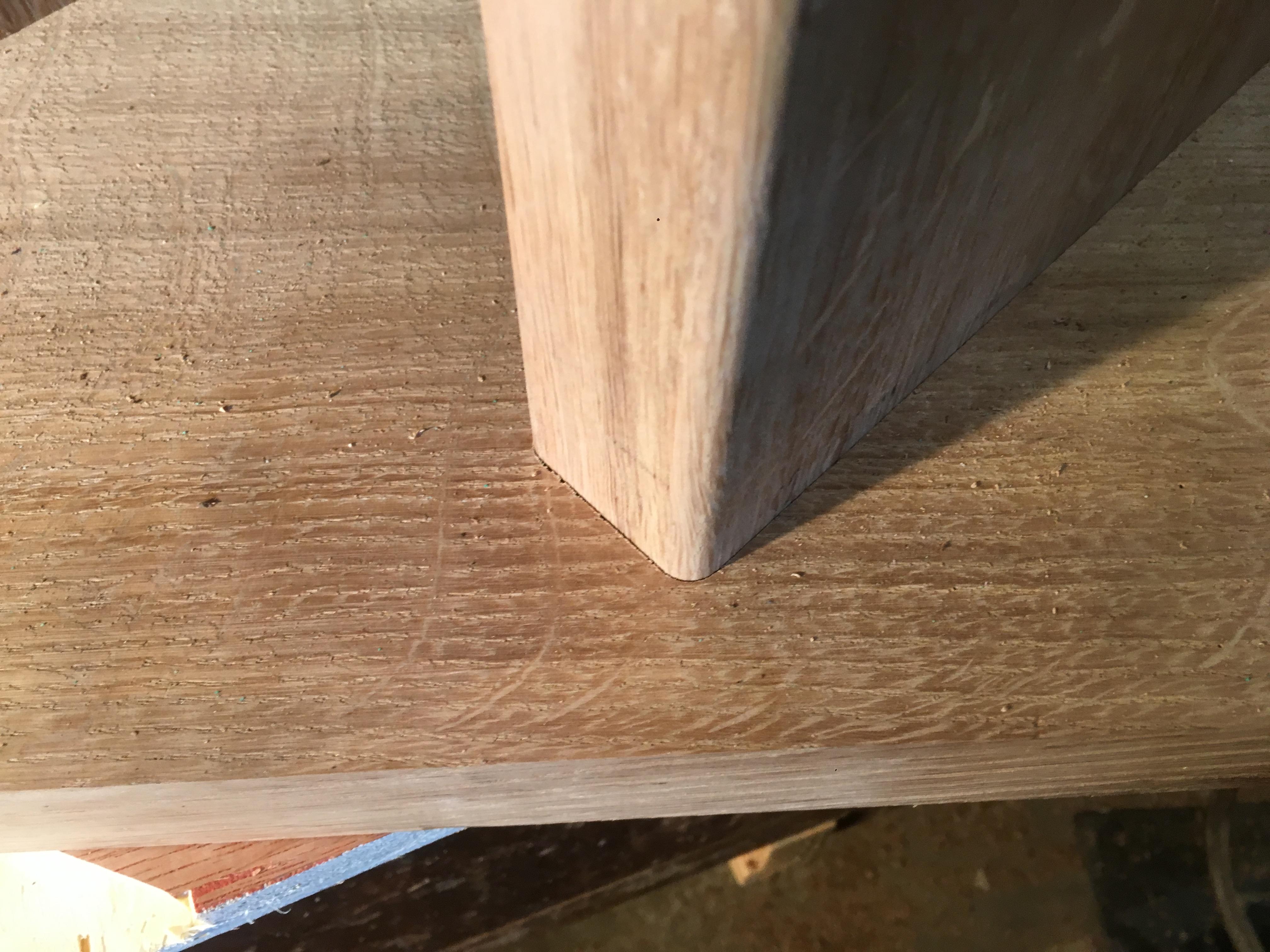

Construction Channel Posted June 24, 2018 Author Share Posted June 24, 2018 #progress. I hope they all turn out like that 9 Link to comment Share on other sites More sharing options...
