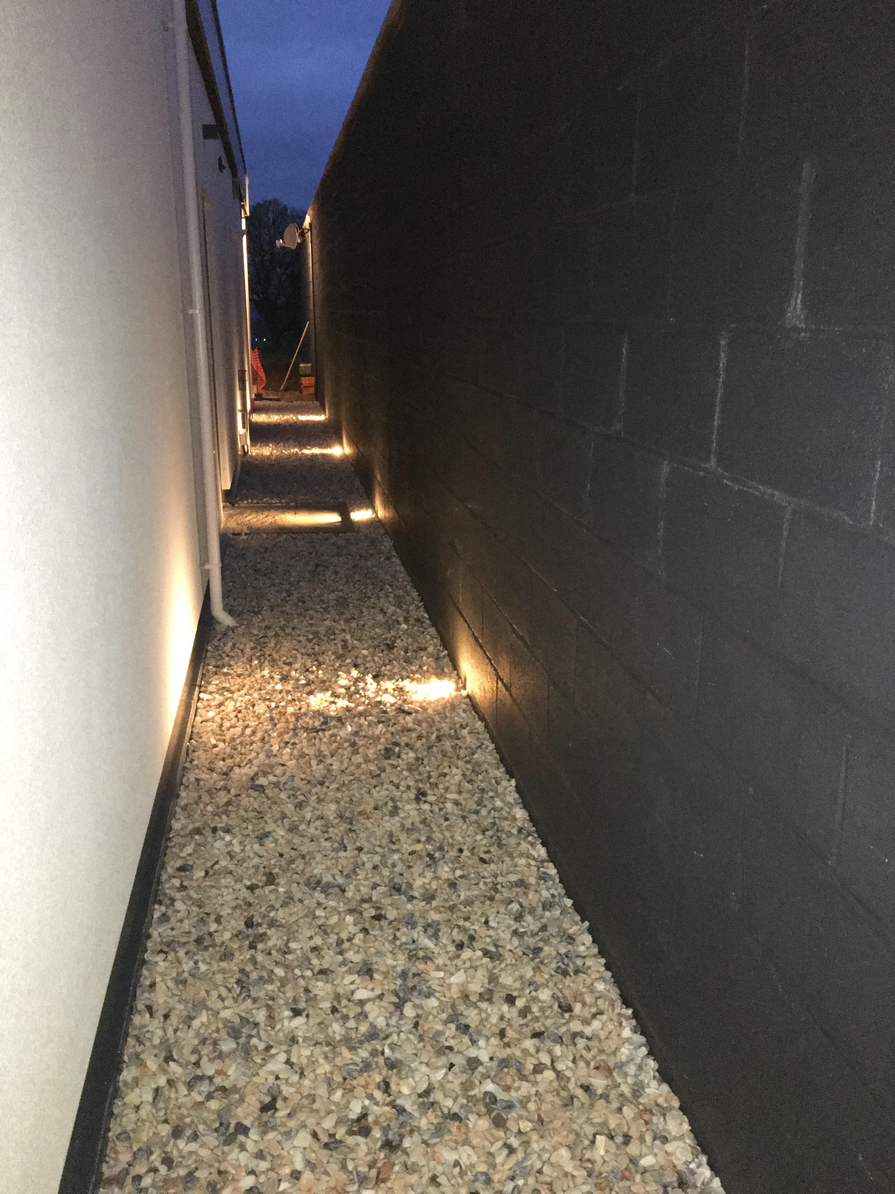

lizzie Posted May 8, 2018 Posted May 8, 2018 Originally our house was supposed to be banked into the earth wall. I didn't want that and so condition of the purchase was that we got an extra 50cm from vendor and we moved the house over a tiny bit (tight plot in that direction) we have ended up with 1200 between house and retaining wall because we took our 50cm and then built wall in the other side of that giving us the full 50 (and maybe a tiny bit more - whats a cm or twoLOL). 1200 is OK for scaff, pipes etc. I wouldn't want any narrower. I have a back door there which is handy for nipping out to the bin etc This is mine at night (low level lighting) - we gravelled floor rather than paved because there are lot of manholes and all the services running down there so easier if ever we need to get at anything. 1
Dreadnaught Posted May 8, 2018 Author Posted May 8, 2018 Thanks @lizzie. That's really helpful to visualise. I suspect the vendor thinks of his 50cm as a concession and we will have to move our property back 70 cm too to get a gap of about 120 cm. I have to weigh-up whether that is a fair deal in the wider context. Thinking…

Ferdinand Posted May 8, 2018 Posted May 8, 2018 2 hours ago, lizzie said: Originally our house was supposed to be banked into the earth wall. I didn't want that and so condition of the purchase was that we got an extra 50cm from vendor and we moved the house over a tiny bit (tight plot in that direction) we have ended up with 1200 between house and retaining wall because we took our 50cm and then built wall in the other side of that giving us the full 50 (and maybe a tiny bit more - whats a cm or twoLOL). 1200 is OK for scaff, pipes etc. I wouldn't want any narrower. I have a back door there which is handy for nipping out to the bin etc This is mine at night (low level lighting) - we gravelled floor rather than paved because there are lot of manholes and all the services running down there so easier if ever we need to get at anything. Hope nothing is deep. You would have fun digging a 1m deep hole or trench there. F

lizzie Posted May 8, 2018 Posted May 8, 2018 (edited) 39 minutes ago, Ferdinand said: Hope nothing is deep. You would have fun digging a 1m deep hole or trench there. F They hand dug the trenches to get it all in so I imagine the same would happen if it ever needed to be accessed in the future. I wouldn’t ever be personally doing any digging of course? Edited May 8, 2018 by lizzie
