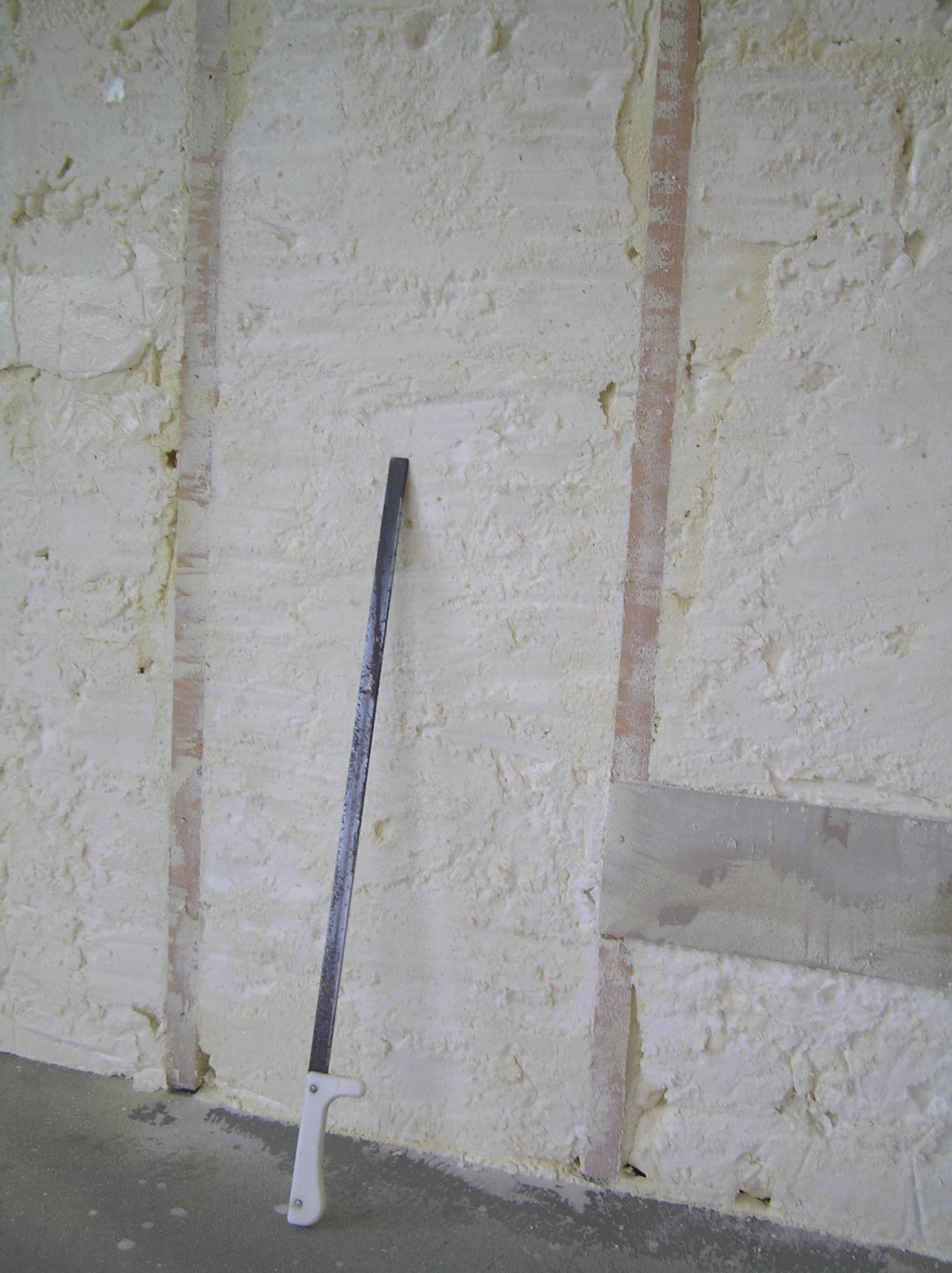

Gone West Posted May 6, 2018 Posted May 6, 2018 1 hour ago, Onoff said: Kin'Ell? Don't they make cheap power tools? Seriously I feel your pain. Out of interest, one for @PeterStarck, what's cutting icynene like "health" wise, itchy, streaming eyes, coughing? Does it smell like board type PIR and de-gas over time? It didn't cause any health problems. It degases very quickly with most smell gone after a day. It's a soft rubbery foam so there aren't hard gritty bits getting everywhere. It does cling to everything though and needs vacuuming off but that's about the worst of it. It's just the tedium of days of trimming.

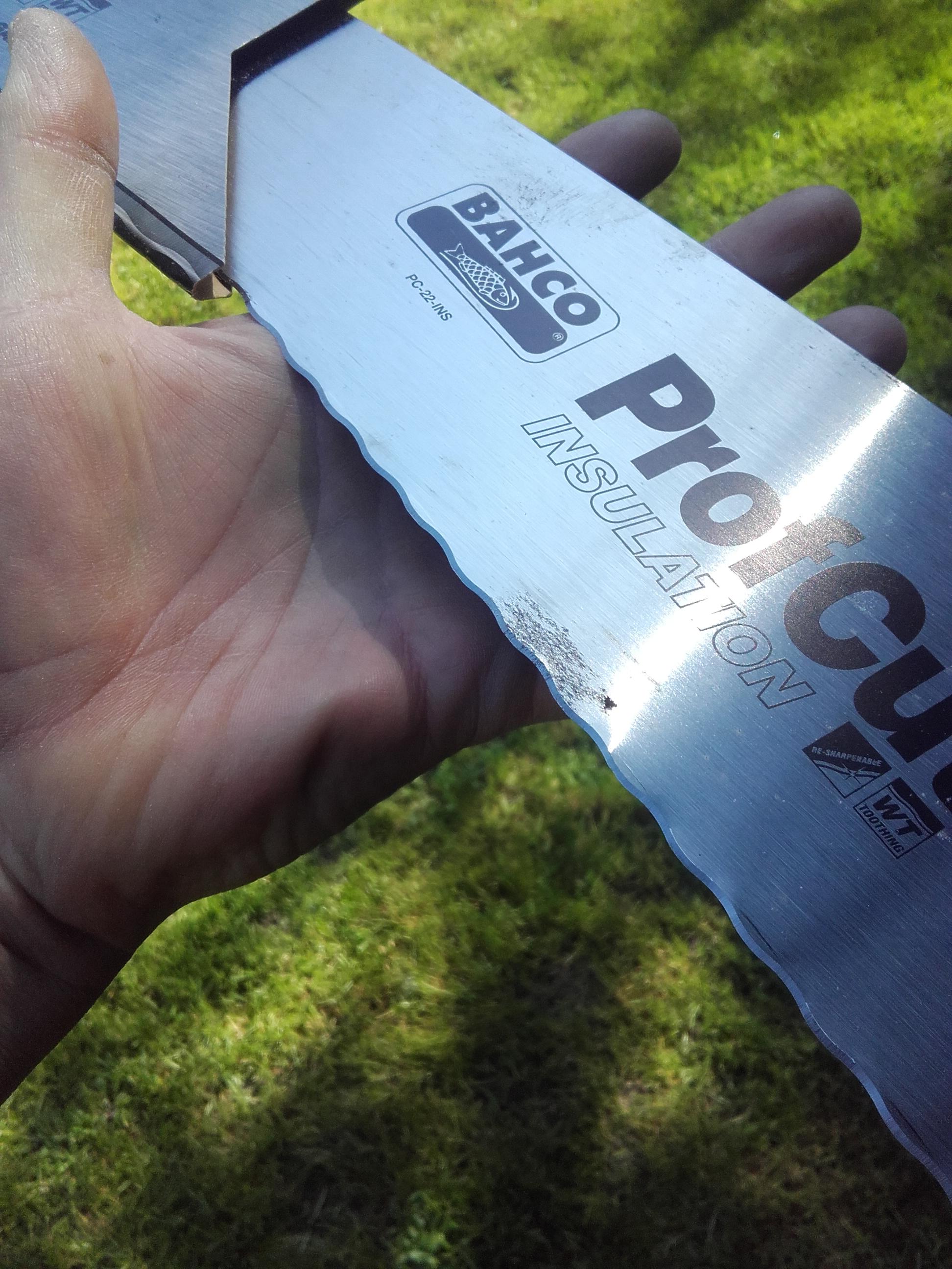

Russell griffiths Posted May 6, 2018 Posted May 6, 2018 I thought someone made a special blade for that, I think it has like a wavey edge and no teeth so not as much dust.
Onoff Posted May 6, 2018 Posted May 6, 2018 2 hours ago, Russell griffiths said: I thought someone made a special blade for that, I think it has like a wavey edge and no teeth so not as much dust. Bacho make one which I've got. Don't find it that accurate tbh.

ToughButterCup Posted May 7, 2018 Author Posted May 7, 2018 7 hours ago, Onoff said: Bacho make one which I've got. Don't find it that accurate tbh. Would that be one with a fine blade, or coarse?

Onoff Posted May 7, 2018 Posted May 7, 2018 4 hours ago, recoveringacademic said: Would that be one with a fine blade, or coarse? Neither. It's razor sharp and wavy:
