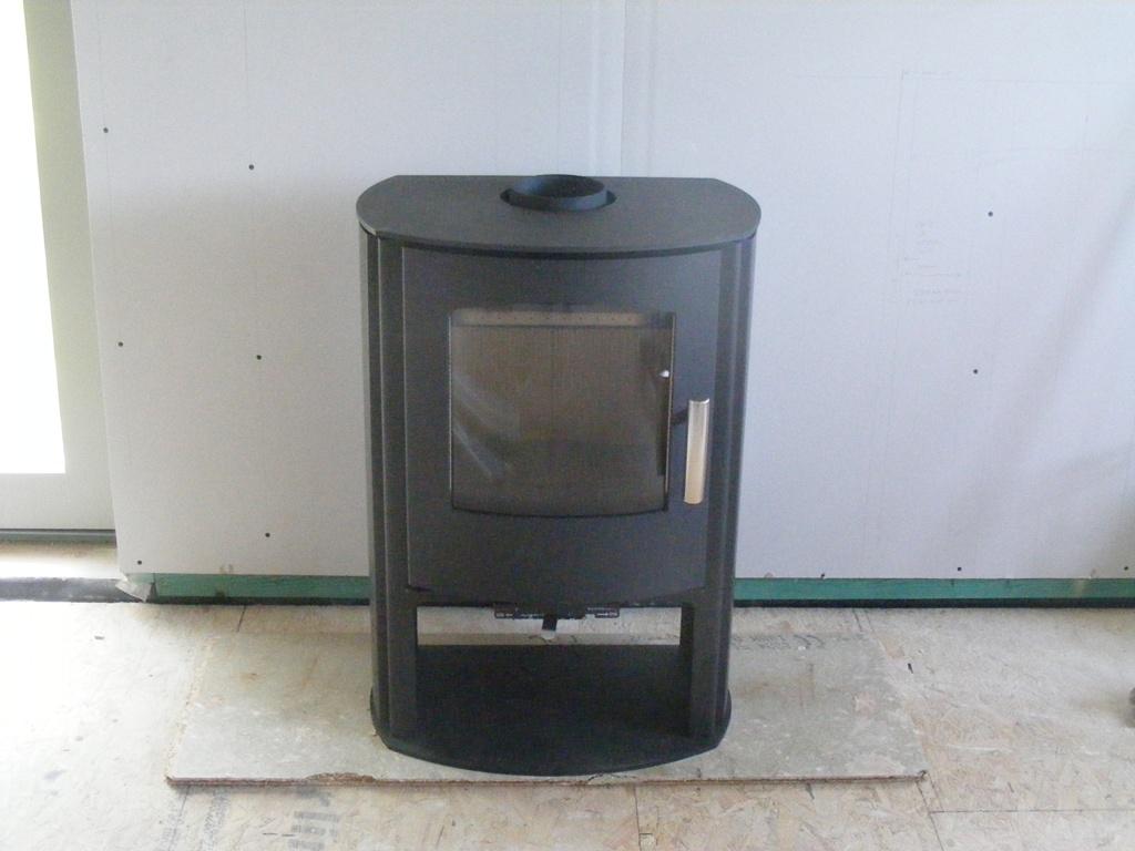

ProDave Posted May 12, 2018 Author Share Posted May 12, 2018 Well we have a stove now. Not what I expected, I was convinced we were going to buy the Springdale and yesterdays tour of all the stove shops was just to prove it was the only option. Not so. SWMBO did not like the Springdale, it was "too traditional" She did like the look of the firebox, which is basically a Springdale wrapped in a more squared off box. But the trouble with that model is although they do a version on a base, it is a solid base with no log storage. However we did find this: It's a Mendip Sroves Churchill Log store version. At a shade over 4Kw it's a larger stove than the Springdale but it does have the room sealed air intake at the bottom already built in as an 80mm diameter hose entry without having to buy a separate plenum box. Unusually for the ducted air intake stoves it will also burn smokeless coal. It's list price was £1067 and I would normally have rejected that on price, but this one was being offered as an ex display at a discount that made it not so much more than I was expecting to pay for the Springdale. It will be some time before I actually install it. Link to comment Share on other sites More sharing options...
