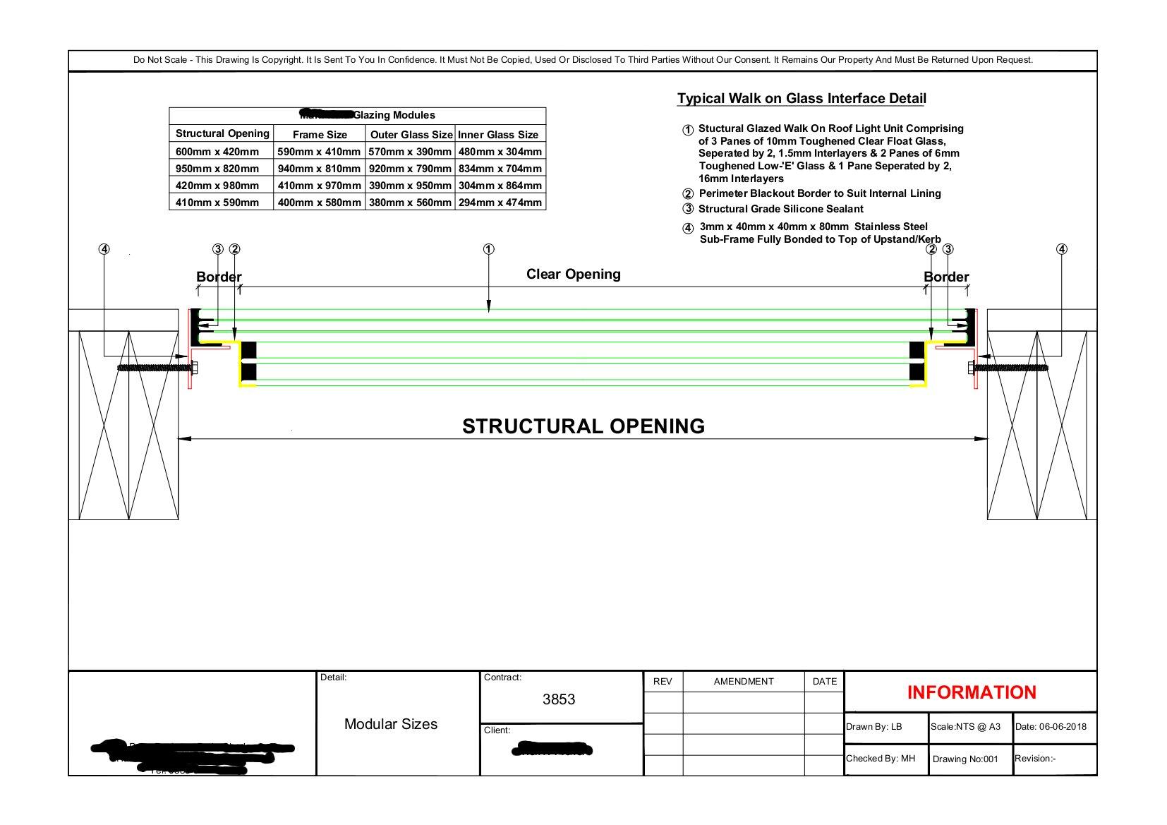

Pocster Posted June 6, 2018 Author Share Posted June 6, 2018 I don't F'ing believe this! So the *new* glazing company... I tell them 'internal' measurements / opennings over and over again so there is NO CONFUSION! They told me they don't do drawings for 'supply only' but I told them to do a drawing!!!! Just got it!. Can you guess what they've done?. Stuck the bleeding windows in the holes not over them!!!. I don't get it!. From there drawing it would bloody leak and I don't see how you'd even fix it! I did speak to them ages ago and confirmed a 'shoe box' lid ; stuck over up stands. Now they've got back too me and said "we're only going on what you supplied'. YES! and I said INTERNAL! - of course they argue that's exactly what it is !!!! Here's the drawing! ; did they really think this would work as a water tight method??? So now the units are 'bigger' so the quote was wrong!!!!! FFS! MUST BE ME! Link to comment Share on other sites More sharing options...
jamiehamy Posted June 6, 2018 Share Posted June 6, 2018 Just looks like a crap design not a mistake. Is that seriously how they fit their lights? Id give them a pass. Link to comment Share on other sites More sharing options...
Pocster Posted June 6, 2018 Author Share Posted June 6, 2018 (edited) 10 minutes ago, jamiehamy said: Just looks like a crap design not a mistake. Is that seriously how they fit their lights? Id give them a pass. Well! This is their 'design' guy. I get the impression he just looked at the dimensions and did that i.e. he HAS NOT been given the previous email correspondence from the original guy I spoke to. I've checked back and it seems all fine. I think there's been no comms i.e. opening size 500 x 600 and that's it. So he just dumps that in a hole and says "thats all you put online". That's because that's all the online order allows. BUT! I have email's confirming the 'method' ; so! . I suspect the cost will now go up as the units he will of realised are larger!!!. I'm 100% in the right now! (for once). Edited June 6, 2018 by pocster Link to comment Share on other sites More sharing options...
jamiehamy Posted June 6, 2018 Share Posted June 6, 2018 Hmm. There is nothing 'wrong' with this if it's their design. In this case, it looks like a steel subframe that gets bolted to the vertical part of the upstand, not laid on top of it. This may well be their design. I can't see them having two different methods surely? This one, I'd never go with. A larger unit will be a totally different design Skylight. Link to comment Share on other sites More sharing options...
Mr Punter Posted June 6, 2018 Share Posted June 6, 2018 Perhaps consider someone to do supply and fit? Leave it to them to measure, design, install and guarantee a robust and watertight solution. Either that OR send them a proper drawing and specification of what you require. Link to comment Share on other sites More sharing options...
Pocster Posted June 6, 2018 Author Share Posted June 6, 2018 16 minutes ago, Mr Punter said: Perhaps consider someone to do supply and fit? Leave it to them to measure, design, install and guarantee a robust and watertight solution. Either that OR send them a proper drawing and specification of what you require. I did They now admit the information wasn’t passed on to the ‘design’ guy . We are going to split the cost increase !! Link to comment Share on other sites More sharing options...
Pocster Posted June 6, 2018 Author Share Posted June 6, 2018 49 minutes ago, jamiehamy said: Hmm. There is nothing 'wrong' with this if it's their design. In this case, it looks like a steel subframe that gets bolted to the vertical part of the upstand, not laid on top of it. This may well be their design. I can't see them having two different methods surely? This one, I'd never go with. A larger unit will be a totally different design Skylight. Apparently they design whatever you want . It’s all quite strange ; because most companies *tell* you the design .... Link to comment Share on other sites More sharing options...
jamiehamy Posted June 6, 2018 Share Posted June 6, 2018 6 minutes ago, pocster said: Apparently they design whatever you want . It’s all quite strange ; because most companies *tell* you the design .... Ooft! Finger crossed. It would make me wary - let's say you'd gone with that design and it leaked - which it easily would - how could liability be apportioned? They wouldn't be able to blame non conformance to the design spec and MIs but similarly, they could say that's what you wanted made. Hmm twice! Link to comment Share on other sites More sharing options...
Pocster Posted June 6, 2018 Author Share Posted June 6, 2018 Just now, jamiehamy said: Ooft! Finger crossed. It would make me wary - let's say you'd gone with that design and it leaked - which it easily would - how could liability be apportioned? They wouldn't be able to blame non conformance to the design spec and MIs but similarly, they could say that's what you wanted made. Hmm twice! Exactly ! Apparently you only usually get drawings on supply AND install . No drawings for just supply - that’s insane !!! . Just got new drawings ; looks correct now ? 1 Link to comment Share on other sites More sharing options...
