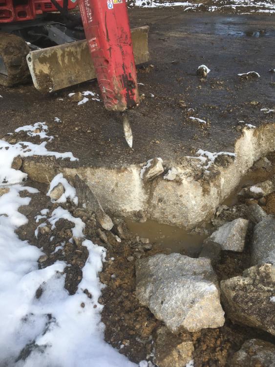

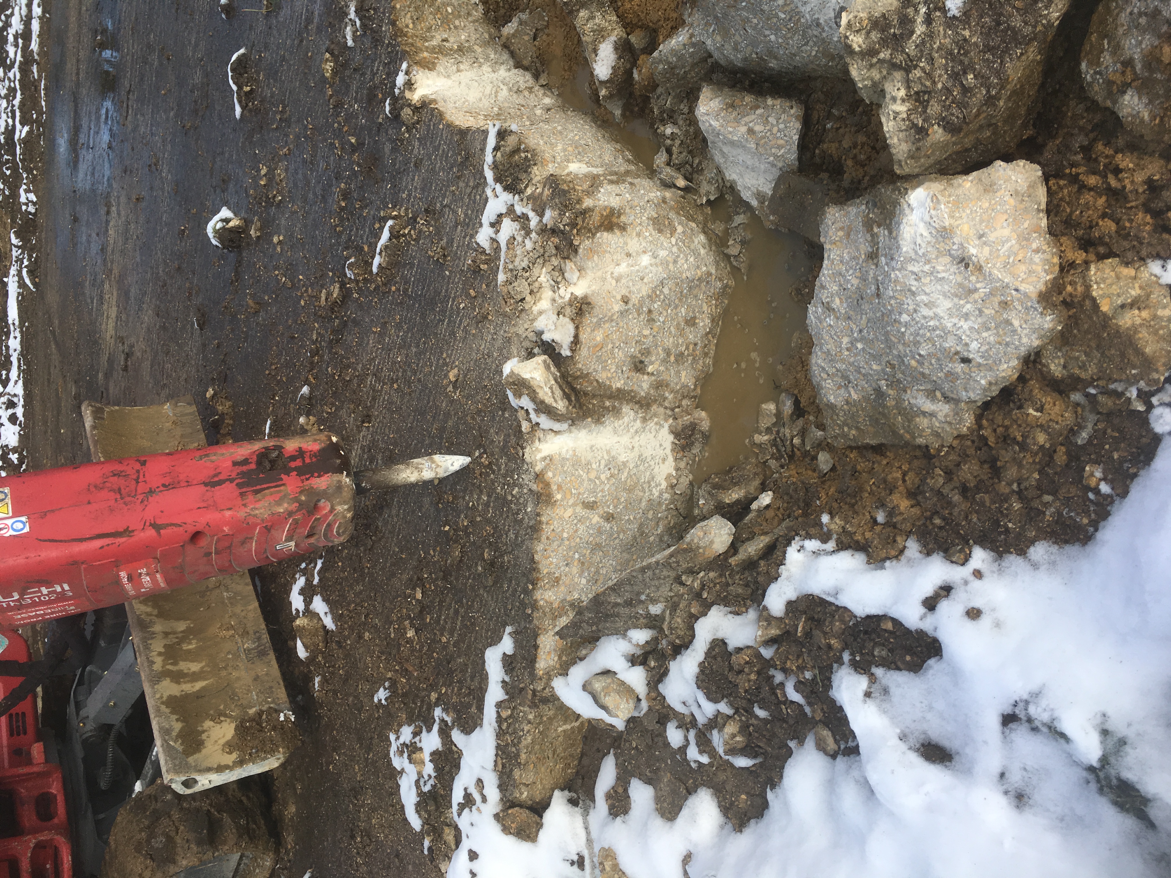

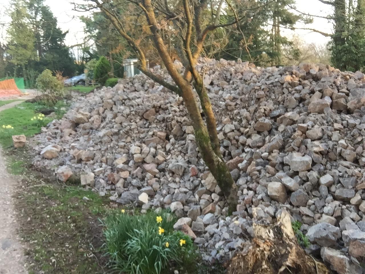

MikeSharp01 Posted April 19, 2018 Posted April 19, 2018 Although I have been away from the build for a few weeks due to to flu, work (yes I went back cos they asked me help out for a few weeks) and parties I have been back on the build for the last 5 days and have reached a harrowing conclusion. The muck away costs for a passive slab are huge! The first lorry grab lorry turned up today and took 15m3 of soil which didn't even dent the pile and we have only done about 30% of the slab area, 600mm deep. When I worked out the budget for this phase I had reasoned that the existing property, a timber cabin, would be hollow down to the soil when in fact, as we demolished it we realised that it was on a slab with some massive foundations - no idea why. These had to be broken up first, and disposed of as rubble before we could start to scrape back the clay to the required depth for the slab build up to commence. So I now think we will need between 10 and 13 lorry loads of muck away which is about 4x the budget I had worked out and will eat a second chunk from the contingency. The expansion (swell) of clay (40%) as you dig it does not help either. I noticed that the grab lorry has load cells, or similar contraption, so it knows just how much weight it has aboard and although we had the volume today we were well down on total weight. So my next job is to run up and down along the pile with the digger to compact it so that it goes back to around 100% before the grab picks it up as I don't think it will swell much in those jaws. Moral of the story is - if you are thinking of a passive slab and you need to dig down, IE you are not building it all above ground, work out the muck away costs carefully.

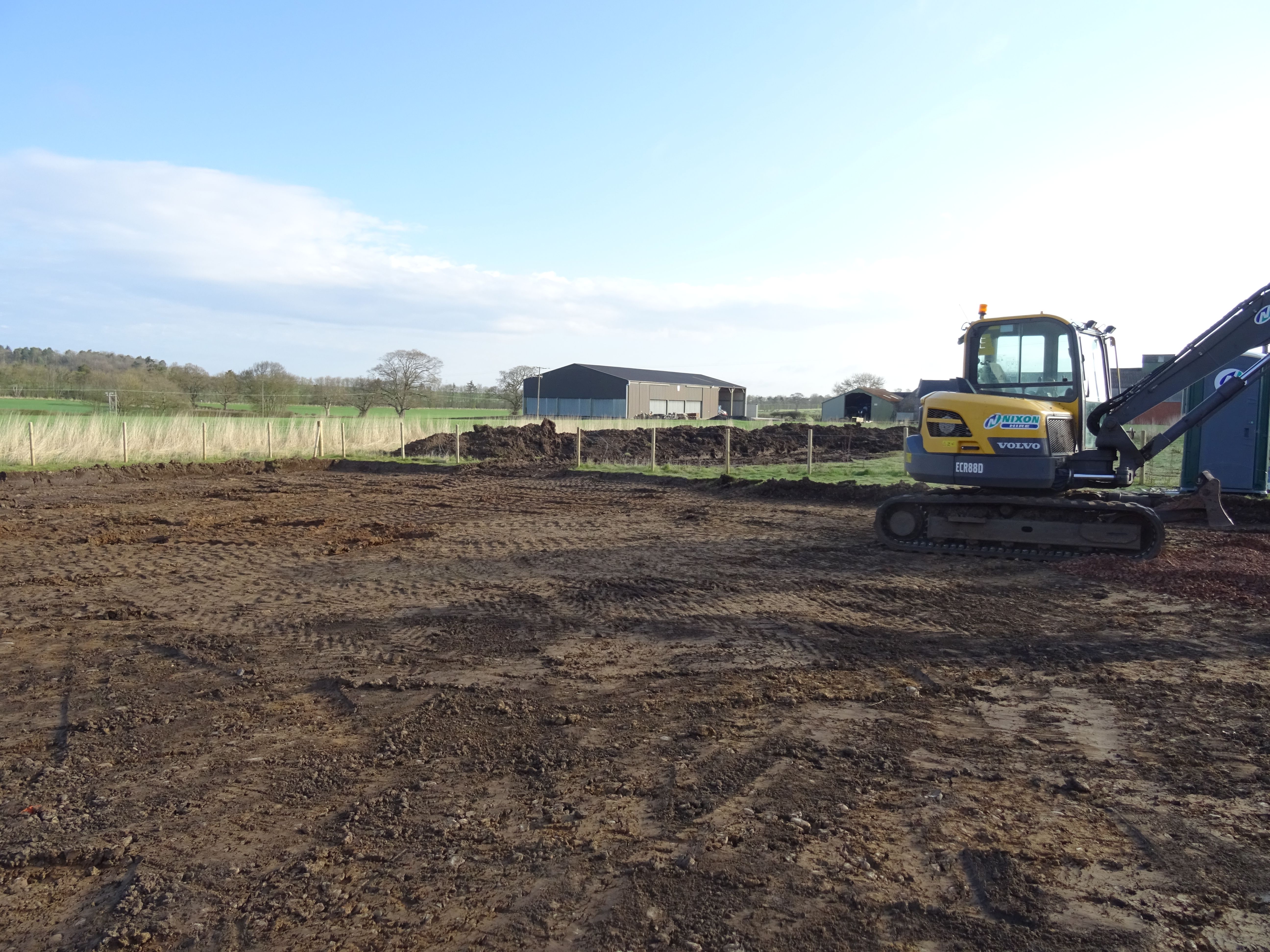

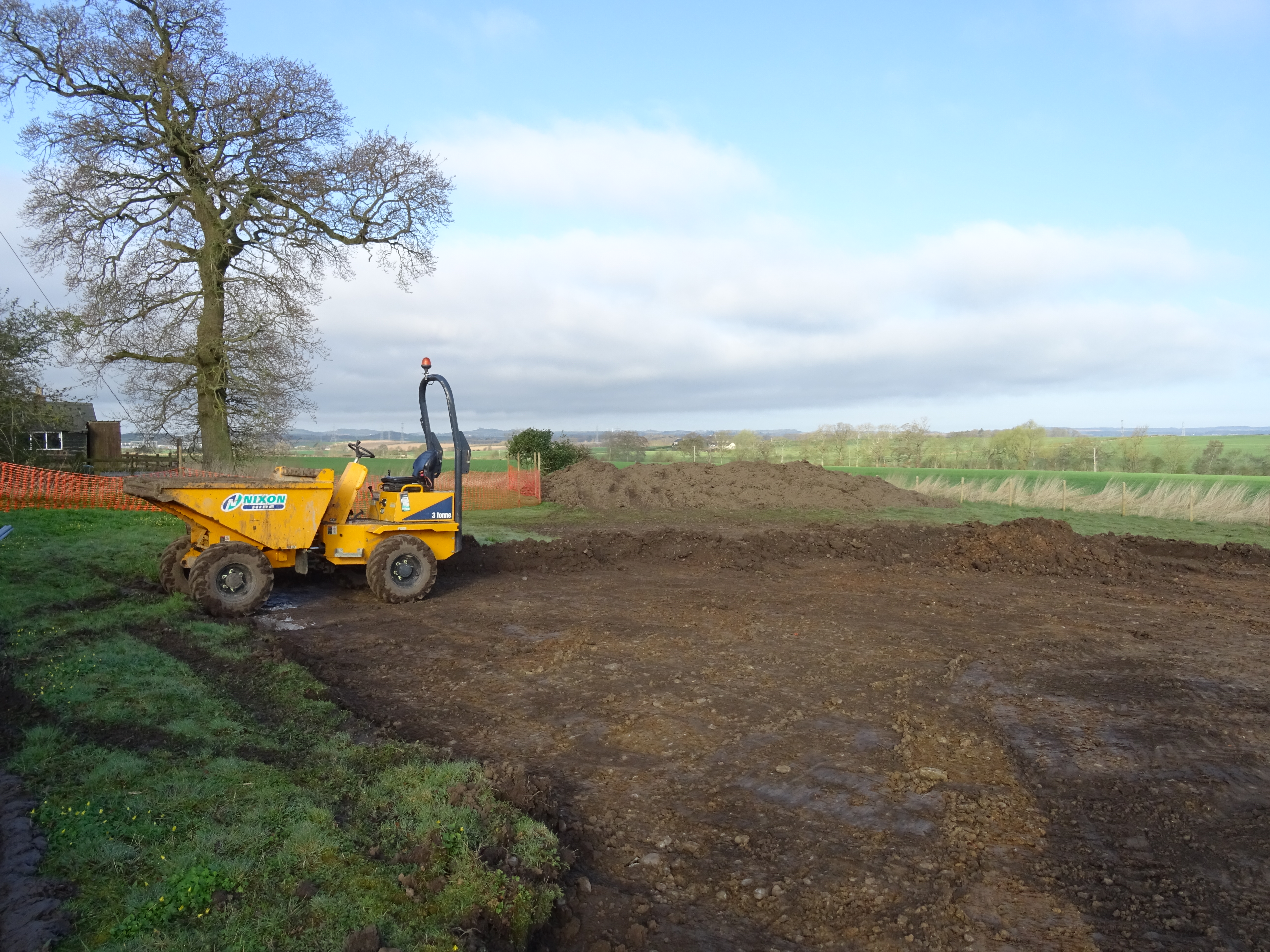

Redoctober Posted April 19, 2018 Posted April 19, 2018 We have just finished day two and are still to complete the site clearance. The vegetation was removed first but we are having to scrape down some 12 - 18 inches of top soil to get to the sub soil. This has generated so much top soil, the space we had allocated within the plot was soon filled. Thankfully and I mean thankfully, the farmer has allowed us to deposit the remaining top soil in his neighbouring field as he will no doubt find a suitable use for it. I will post photos tomorrow after I have visited the plot but this must have saved me a fortune in removal costs. As @MikeSharp01 points out, you can never budget enough for ground works!!

MikeSharp01 Posted April 19, 2018 Author Posted April 19, 2018 54 minutes ago, vivienz said: What depth are you digging to, Mike? The site slopes so at the rear of the site the dig is down 600mm at the front it is about 400mm, it is 15m long and 9m wide. So the volume, with swell, is 68m3 x 1.40 = 95m3 which is 7 x 15m3 trucks full. Then there is the soak away (1 truck) and we have to remove about 30m3 (2 Trucks) of soil from the footpath. We have already sent 3 trucks of rubble away, who ever knew how much rubble a wooden shack needed.

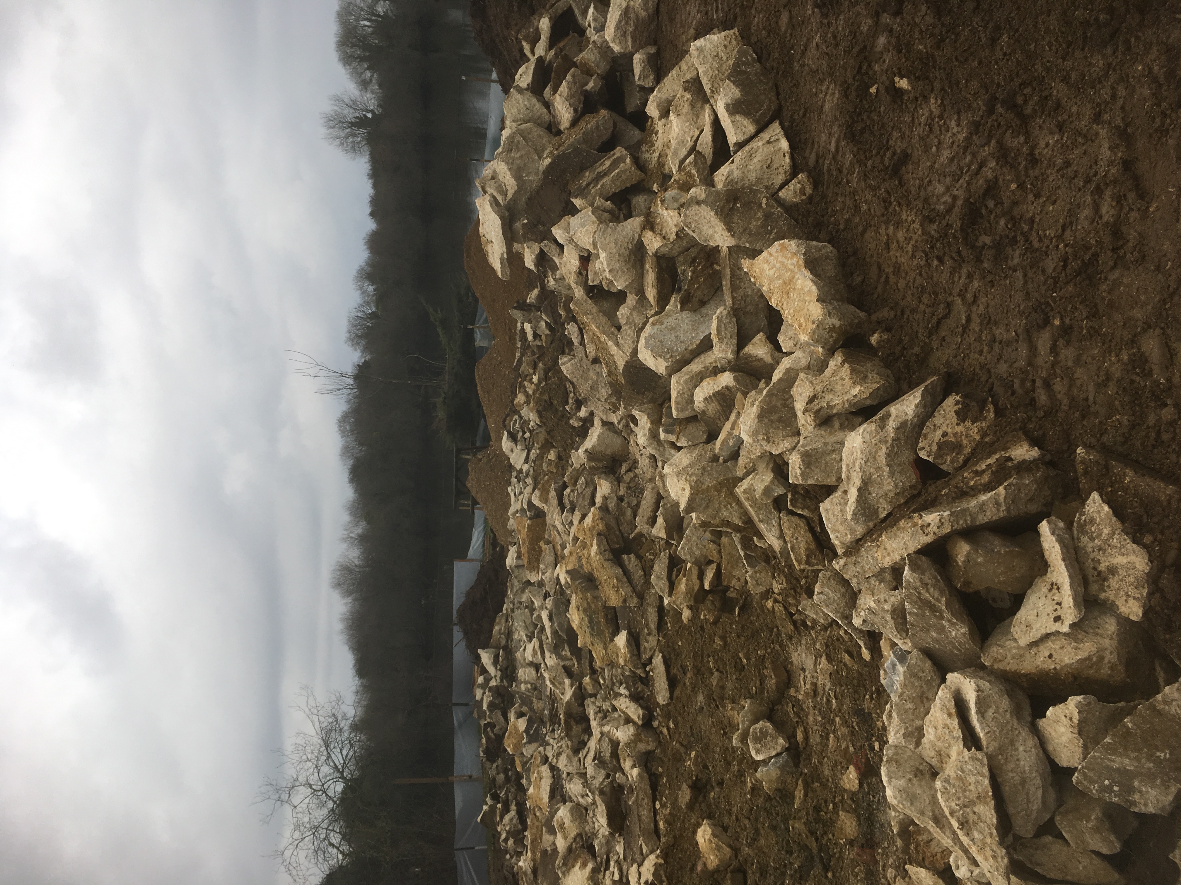

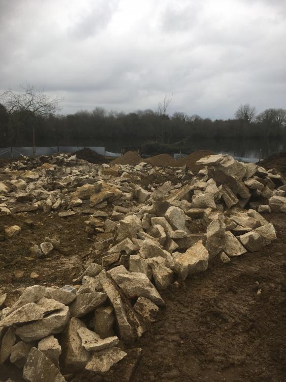

Russell griffiths Posted April 20, 2018 Posted April 20, 2018 On the topic of wooden huts ours was sitting on this lot. So after removing all that lot, I have just discovered another set of foundations which we have been told may have been from the conveyor belt on site ? so could be any sort of thickness, the last lot I removed was just over 400mm thick.

Redoctober Posted April 20, 2018 Posted April 20, 2018 15 hours ago, Redoctober said: Thankfully and I mean thankfully, the farmer has allowed us to deposit the remaining top soil in his neighbouring field as he will no doubt find a suitable use for it. As @MikeSharp01 points out, you can never budget enough for ground works!! Last push today and the site will be cleared - Now that we have started, I shall update my blog over the weekend with some more photos. 1
Russell griffiths Posted April 20, 2018 Posted April 20, 2018 That looks like good ground @Redoctober 1
