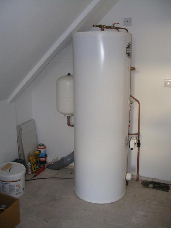

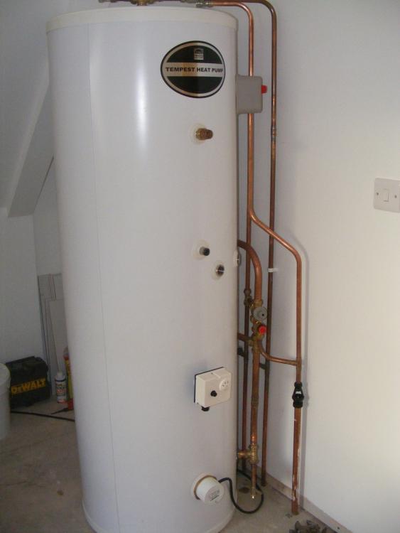

It arrived today.  A day early in fact, I had been told to expect it on Friday, so I had gone out to do a job.  I just got back late afternoon and there was the truck pulling up at the house.

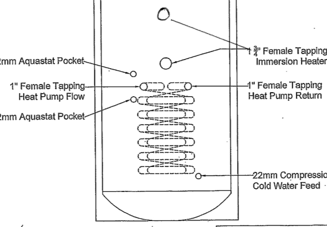

The two input coil ports are side by side. The diagram in the instructions says "heat pump flow and return"  But WHICH is flow, the left one or the right one?
 When you get the answer let me know ......
Got mine to do too ..!
Edited to add - this is the sketch which shows flow and return on mine.
