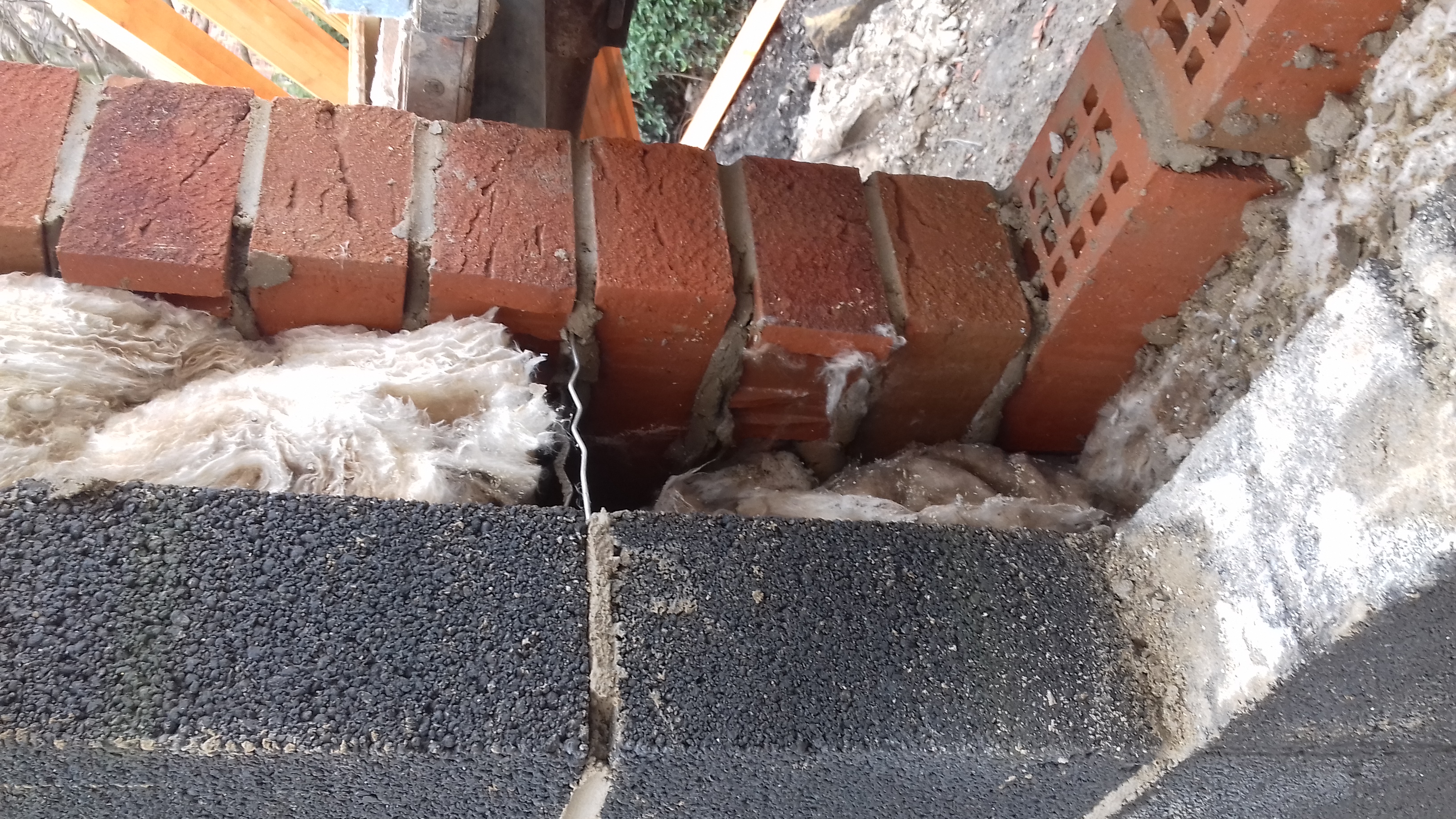

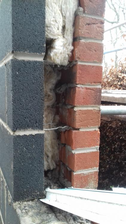

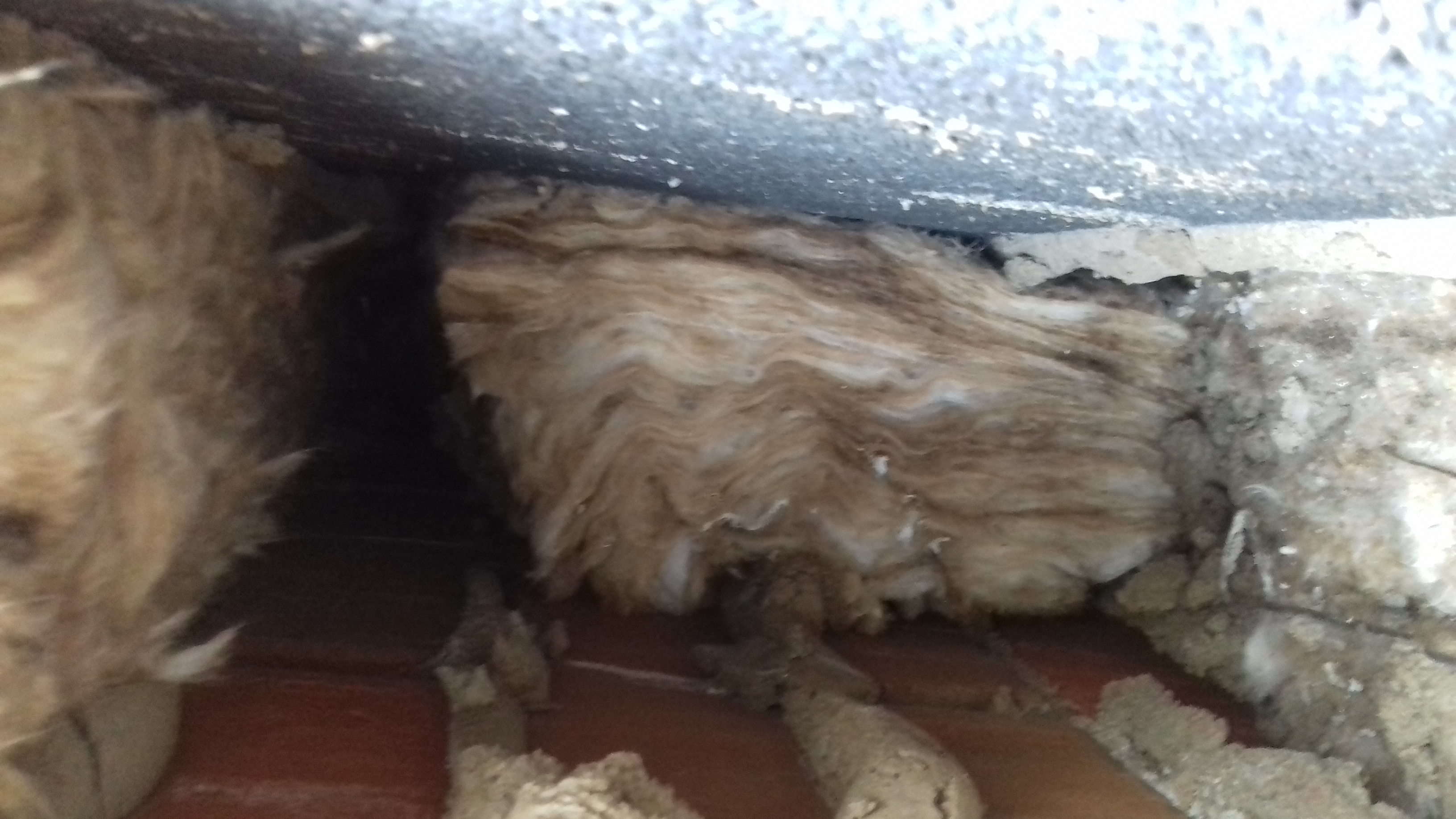

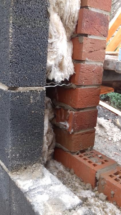

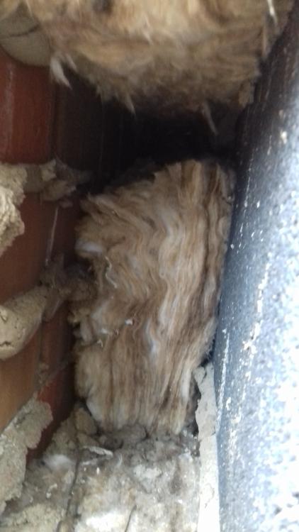

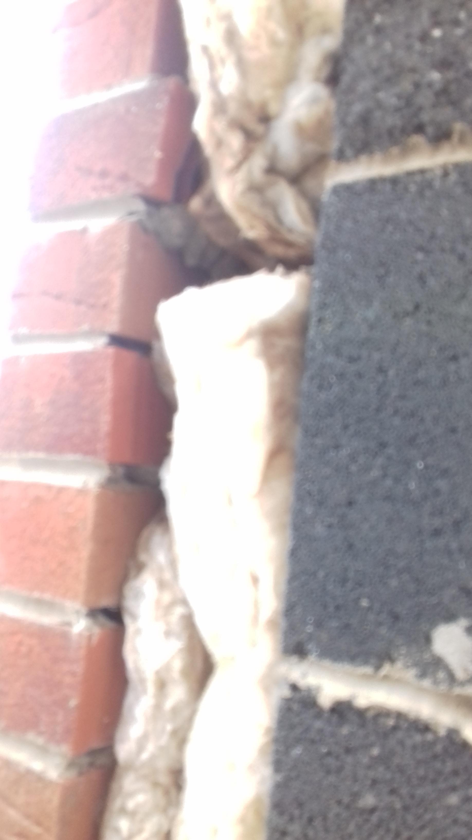

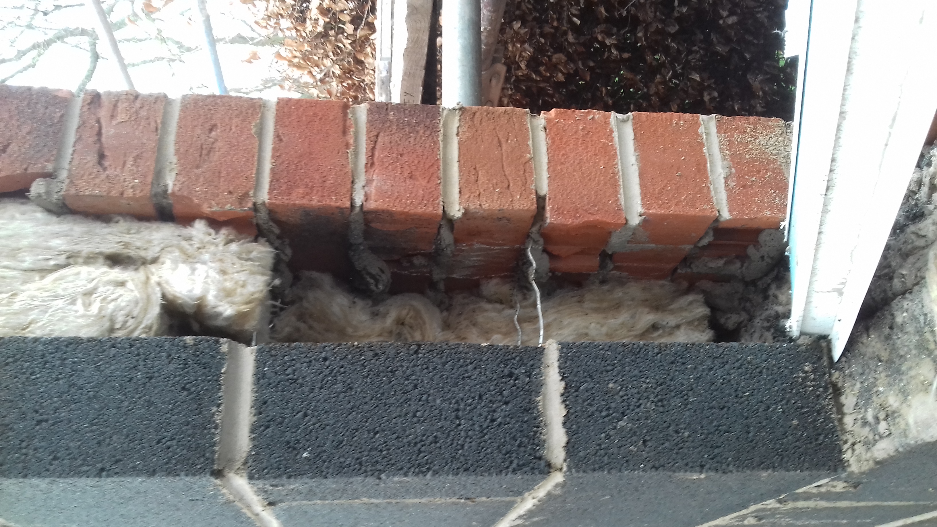

Hecateh Posted April 15, 2018 Author Share Posted April 15, 2018 Is this acceptable. The stuff that goes on top to bridge the gap was in place but not screwed in. so I pulled it out and had a look. Every window is like this, with bits missing Link to comment Share on other sites More sharing options...

Construction Channel Posted April 15, 2018 Share Posted April 15, 2018 1 minute ago, Hecateh said: Is this acceptable? Every window is like this with gaps. The bridging material has been pushed into place, not yet fastened in, I noticed earlier that there were gaps so I pulled some of the bridge (don't know what it is called) and this is how it is on every window The bridging bit is called the cavity closure just so you know. And AFAIC no that’s not acceptable BUT you will find that is general practice for brick layers. Insulation is just a hinderance to them. if they did it properly brick and block could be a good way to build, unfortunately most of the time they don’t. All hail the chippies Link to comment Share on other sites More sharing options...
Hecateh Posted April 15, 2018 Author Share Posted April 15, 2018 4 minutes ago, Construction Channel said: The bridging bit is called the cavity closure just so you know. And AFAIC no that’s not acceptable BUT you will find that is general practice for brick layers. Insulation is just a hinderance to them. if they did it properly brick and block could be a good way to build, unfortunately most of the time they don’t. All hail the chippies Is it something that building control would be interested in I think I need to call him anyway to let him know that I am taking over project management Link to comment Share on other sites More sharing options...

Construction Channel Posted April 15, 2018 Share Posted April 15, 2018 12 minutes ago, Hecateh said: Is it something that building control would be interested in I think I need to call him anyway to let him know that I am taking over project management Yes, but you have got to be weary here about being a “grass” which won’t help preceding. Tell bb you noticed it was not very well filled on one so you investigated the others. Then let him fill them properly. Telling the BCO first will not help bring another prices down. 1 Link to comment Share on other sites More sharing options...
Ferdinand Posted April 15, 2018 Share Posted April 15, 2018 (edited) 25 minutes ago, Hecateh said: Is it something that building control would be interested in I think I need to call him anyway to let him know that I am taking over project management This is one for the new PM to demonstrate authority in a manner which will be gentle but firm and resolute !!! Edited April 15, 2018 by Ferdinand 1 Link to comment Share on other sites More sharing options...
Hecateh Posted April 15, 2018 Author Share Posted April 15, 2018 24 minutes ago, Construction Channel said: Yes, but you have got to be weary here about being a “grass” which won’t help preceding. Tell bb you noticed it was not very well filled on one so you investigated the others. Then let him fill them properly. Telling the BCO first will not help bring another prices down. Nope - telling building control will be a last resort. Just wanted to know before I bring it up. 1 Link to comment Share on other sites More sharing options...
PeterW Posted April 15, 2018 Share Posted April 15, 2018 Studwork is way over if it’s timber, as is the plastering. Just paid £6k for 470sqm of board and skim walls and sloping ceilings with another 65sqm or flat ceilings on a 168sqm house so that price is well over. Get the sparky direct. Oh, and get those cavities refilled, 10 minute job to do it properly ! 1 Link to comment Share on other sites More sharing options...
Declan52 Posted April 15, 2018 Share Posted April 15, 2018 1 hour ago, Hecateh said: Is this acceptable. The stuff that goes on top to bridge the gap was in place but not screwed in. so I pulled it out and had a look. Every window is like this, with bits missing Nope that's not gd one bit. The brickie is meant to use his trowel to scoop up the motar that gets squeezed out when you lay the bricks and blocks and use this over and over again. Them cavities are full of motar droppings as well. Then the massive gaps between different layers of insulation are ok if you want cold spots all over your wall. You may get him to remove the rest of the closers and sort that mess out before your Windows go in. 1 Link to comment Share on other sites More sharing options...
