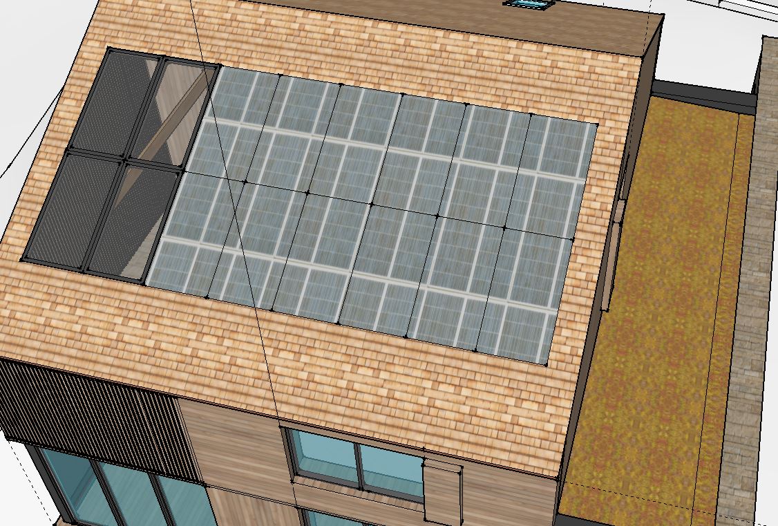

ToughButterCup Posted April 5, 2018 Author Posted April 5, 2018 27 minutes ago, Russell griffiths said: [...] work out the area the panels would go in, then cover this section of roof with GRP, making an upstand and bonding in aluminium box section for the panels to fix to [...] Well, @Russell griffiths, it's the start of a thought process, almost exactly like the one I was brewing. The spec for the under-panel area differs from the rest of the roof . Under the panels = Fleece backed self-adhesive single ply roofing system(Alwitra Evalon VSK) or equivalent. To 15mm Promat Supalux sheathing Elsewhere = Shingles treated with Non-Com fire retardant. Fix with stainless steel annular ring shank nails. Fixed to 25x50mm treated SW slating battens & counter battens on breathable felt, Klober Permo Forte or similar, to 15mm Promat Supalux sheathing. Well how does that work then? Have a look at this screen grab The proposal is that in the area under the PV panels, fleece-backed Klober Permo Forte is stuck to the sheathing...... Seems to me to be in need of a bit more thought. I mean how on earth is rainwater going to be dealt with once it has run down the panels? So the Permo Forte will need to be continued down to the guttering. Ok. But how far to the left and right of the panels? And how do we deal with the panels where they butt up to the roof light? Making a proper tray for the panels to sit in and on seems to me to be a sensible way forward. And a waterproofing medium which is the same for the whole roof, under the panels or not. How that tray (container) can be attached to the roof in a manner which keeps the thermal characteristics of the roof intact (or suffer interstitial condensation) is one thing. How to keep it there so it doesn't get blown away in the wind is another. And then, how do I keep the roof dry? So far, this fixing system seems to be close to what's needed in terms of keeping the roof insulated from the fixings. Lets see what the company has to say and a quick peek at how much it might cost. Got a feeling it isn't going to be cheap.
Jeremy Harris Posted April 5, 2018 Posted April 5, 2018 Two things are needed behind in-roof panels, and are essential. The first is that there needs to be a membrane that's breathable yet allows any moisture that may get on to it (from driven snow and ice melt, for example to flo down to the gutter and not get through to the underlying structure. The second is equally critical, there MUST be a ventilation path up behind the panels to the ventilated ridge. The panels will get very hot and this ventilation is needed to reduce the temperature and get reasonable performance in hot weather. The ventilation also allows the membrane to both dry off and allow vapour to permeate out through it, as designed, For this reason we counter battened over the sarking, in line with every rafter (on 400mm centres, then draped the breathable membrane over the counter battens, so there was a ventilation space under it, then battened the whole roof at the specified slate nail pitch (with the lower row spaced closer), and then the in-roof plastic mounts were just screwed to the battens. With either the Easy Roof or GSE system there are no fixings other than screw to the existing battens plus some wider boards fitted where required that are the same thickness as the battens. There's no difference between the membrane under the panels and that under the rest of the roof: I think the idea of covering the area where the panels are to go with sheet and then GRP or EPDM would work as a temporary measure, but might cost a fair bit. Is there a way to buy just the panels now, and fit them, then get the inverter and house wiring done later, when funds allow? Probably worth asking around if anyone consider a two-stage process like this, and perhaps be OK with you fitting the mounting frames to the roof, as there is very little skill involved in doing this, the hardest part is making sure that all the mounting frames are fitted dead square and inline.
ToughButterCup Posted April 5, 2018 Author Posted April 5, 2018 5 minutes ago, JSHarris said: [...] For this reason we counter battened over the sarking, in line with every rafter (on 400mm centres, then draped the breathable membrane over the counter battens, so there was a ventilation space under it, then battened the whole roof at the specified slate nail pitch (with the lower row spaced closer), and then the in-roof plastic mounts were just screwed to the battens. [...] The architect was thinking about the difference 25mm would make to the way the house looks (not having counter-battens under the panels) Stuff that. (For all the reasons you outline above) 8 minutes ago, JSHarris said: [...] Is there a way to buy just the panels now, and fit them, then get the inverter and house wiring done later, when funds allow? [...] The common-sense way forward. Thanks very much indeed J. Right: got it clear in what's left of my frazzled brain. Nearly Friday night. 'S a bit of a marathon innit? Seem to be hitting 'The Wall' these days. If I cant take a joke, shouldn'a started should I?
