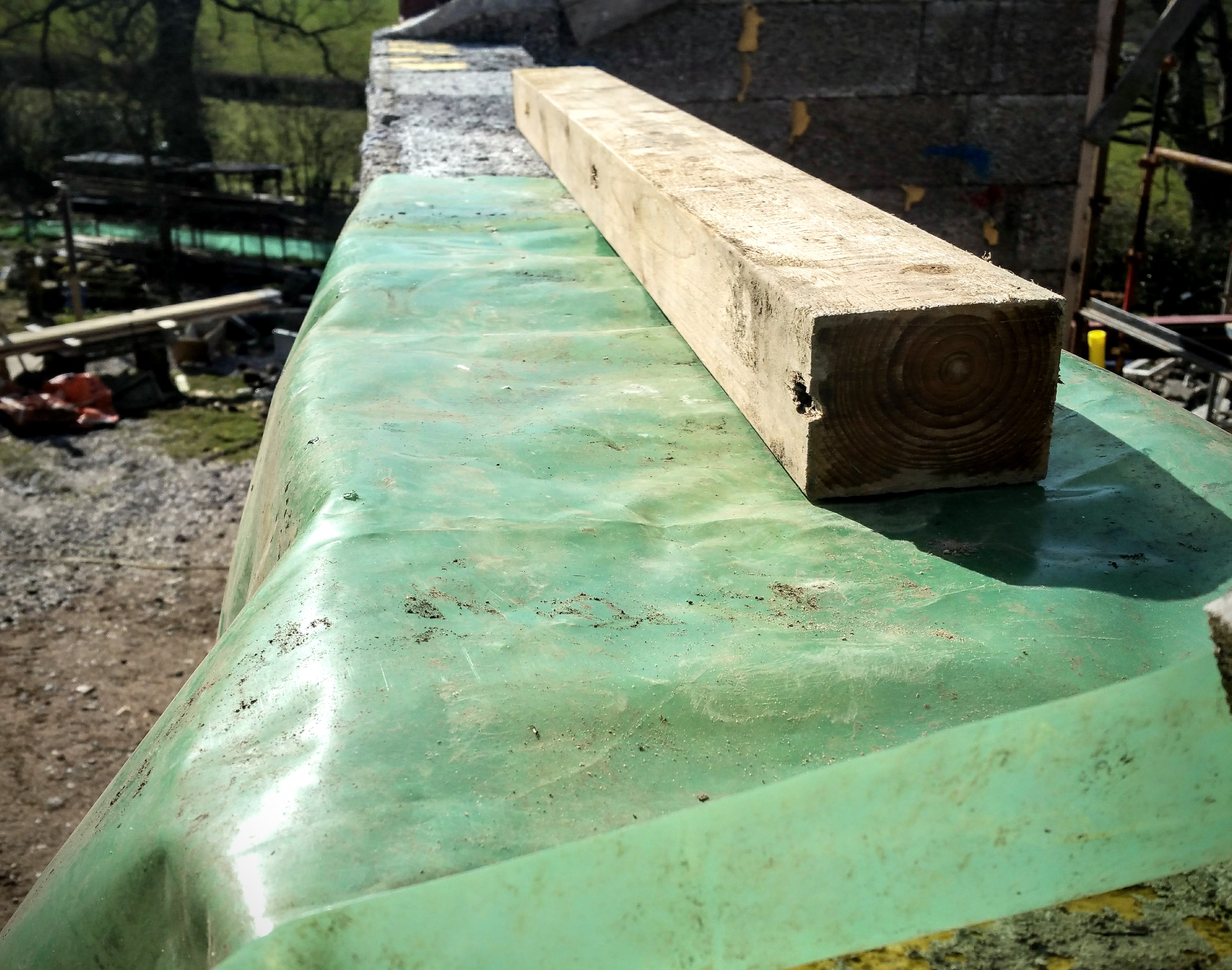

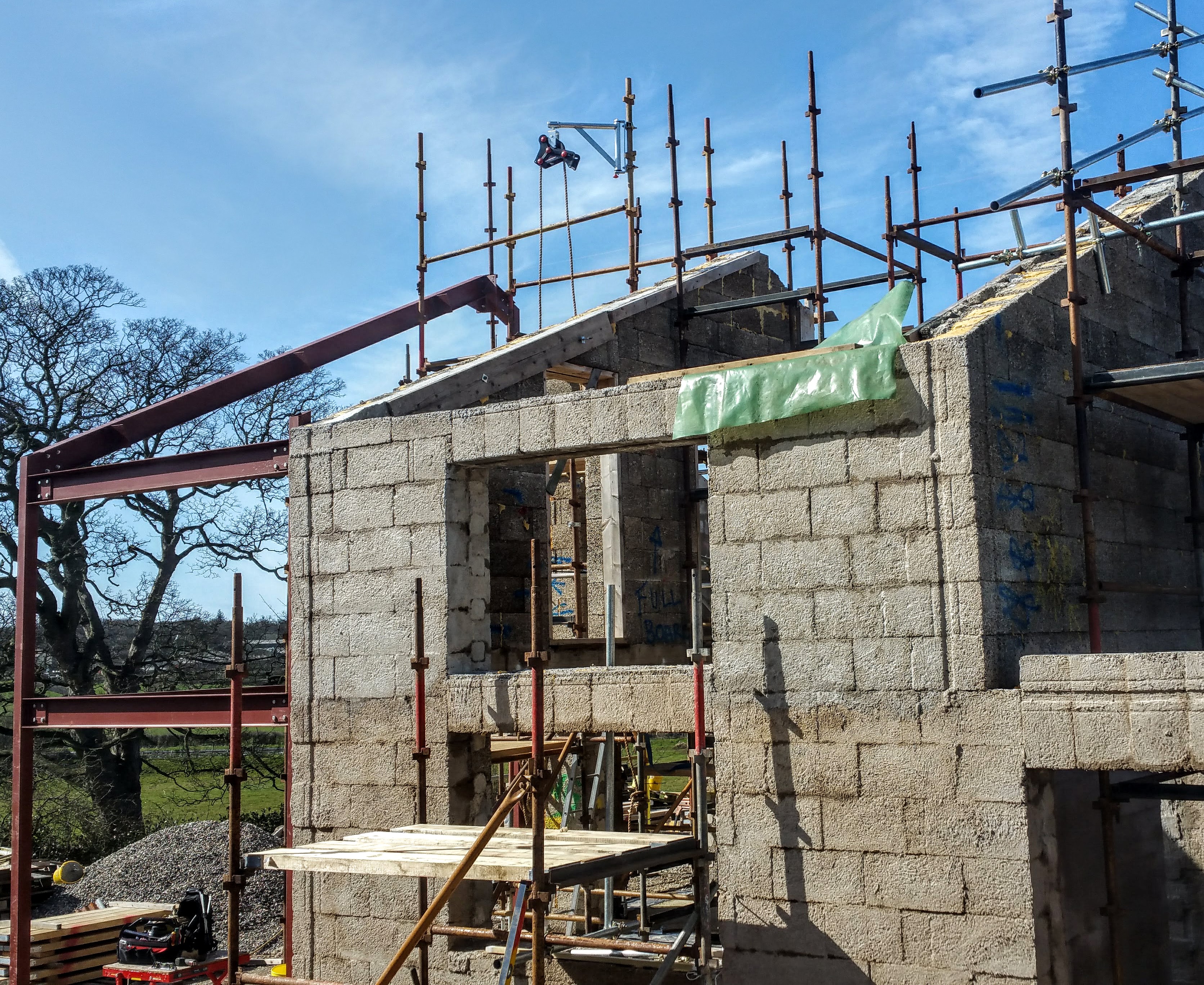

ToughButterCup Posted April 5, 2018 Author Posted April 5, 2018 I'm bumping this because I have a piccy or two for ya. I have mocked up my Tony Tray thus : taking a sparrow's view along the wallplate.... and from the outside it looks like this My chippy (very nice man, very very nice man) hasn't seen a Tony's Tray before (well that makes two of us). And as I suspect there are more than just two of us I thought I'd write this post. This is the original article which for members considering Durisol will be of interest. (scroll down to 'wall plate' ) It illustrates the concept of wrapping the ends of the rafters in polythene. I wish the author had done a before and after shot..... The chippy's question was: Do we seat the wallplate and plastic sit on top of a layer of mortar as usual to ensure the wallplate is level? Of course I didn't know (what do you expect?) My instinct says yes because there's no point in a wonky wall plate is there? The architect says the wall plate must be anchored to the concrete core. Quite how isn't specified. This where I found the idea Do we bed the wall plate and plastic on mortar? How do we fasten the wall plate to the concrete core? Top- down, or with wall straps? Or both? (PS, the forest of KwikStage standards were erected by yours truly, now past master and lone scaffolder - got the bruises to prove it)
bissoejosh Posted April 5, 2018 Posted April 5, 2018 Watching with interest as this is my job next week on our first floor joist wall plate. I was planning (until someone says otherwise) to use mortar & straps for the wall plate, then airtight membrane over the top of the plate but under the joists which sit on top thus making the wall plate 'outside' as such. Perhaps I should be doing the same as you and have the membrane beneath the wall plate. Curious to see the thoughts of others...
Construction Channel Posted April 5, 2018 Posted April 5, 2018 I would say you have got to bed the plates ( for our BCO you definitely would,) having never done it I can only speculate but I reckon I would bed both down, mortar / plastic/mortar/ wood leave that to go off, then screw it down, you probably could get away with just straps but i don't like the idea of it, normally we would use concrete screws but as you are looking for airtightness it might be better to use a nylon plug (the big grey ones) as that will expand a bit and fill any voids, you will definitely need straps for regs but it brings a whoole new issue of whether to VCL before or after the straps, before means, you can have a continuous VCL going up the wall and out over the rafters but you get all the fixing holes to contend with (probably how id do it then tape over the while strap) after means, you don't get any fixing holes but there will be a joint in the VCL at plate height you will need to tape and a strap in the way that you would need to seal around somehow. have you decided on the airtight layer for the walls yet as that may have an impact on the decision,

RichS Posted April 6, 2018 Posted April 6, 2018 I always assumed that the air tight membrane would go underneath the rafters and then lap down and be sealed onto the internal wall face. Doing it this way it wouldn't go anywhere near the wall plate. Am I missing something??
bissoejosh Posted April 6, 2018 Posted April 6, 2018 I agree with @RichS. This is normally only an issue for floor joists at 1st floor level where they have to protrude outside of the airtight layer. @recoveringacademic on your build the parge coat / plaster is your airtight layer I think? This would therefore be on the inside face all the way up the wall to rafter level meaning the roofing airtight membrane can sit under the rafter and be bedded into the wall face as suggested above. This would all be inside of the wall plate I think.
ToughButterCup Posted April 6, 2018 Author Posted April 6, 2018 22 minutes ago, bissoejosh said: [...] @recoveringacademic on your build the parge coat / plaster is your airtight layer I think? This would therefore be on the inside face all the way up the wall to rafter level meaning the roofing airtight membrane can sit under the rafter and be bedded into the wall face as suggested above. This would all be inside of the wall plate I think. Exactly. But in this process is, for me, just-in-time-learning. I really do not know what I am doing - but I do understand the reasoning behind it. I am also parging the outside of the building as you can see above. A la @Nickfromwales belt and braces job.... The strong cross-light in the photo emphasises the outline of the blocks. 37 minutes ago, bissoejosh said: [...] meaning the roofing airtight membrane can sit under the rafter and be bedded into the wall face as suggested above. [...] So easily said. But. Quite how I am going to get a sand and cement parge coat to stick to the plastic inside the wall I don't know. It was drafty here yesterday, so I couldn't photograph the membrane on the inside of the wall (It was flapping about). I'll try and take a photo today to illustrate the point. (And I thought I was retired, this is just like being back at work, but in this case the only line manager is an accurate cost-to-completion spreadsheet)
