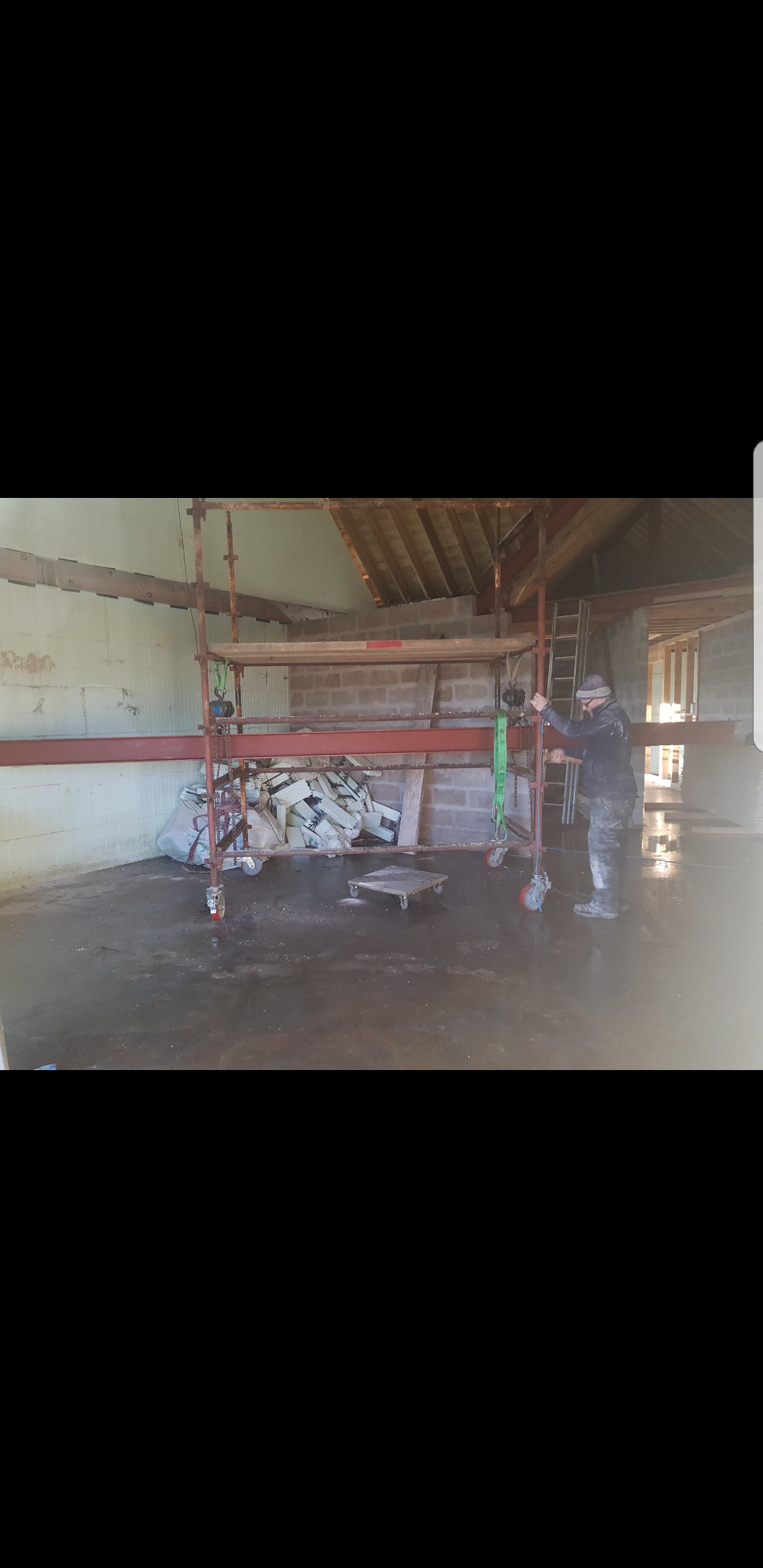

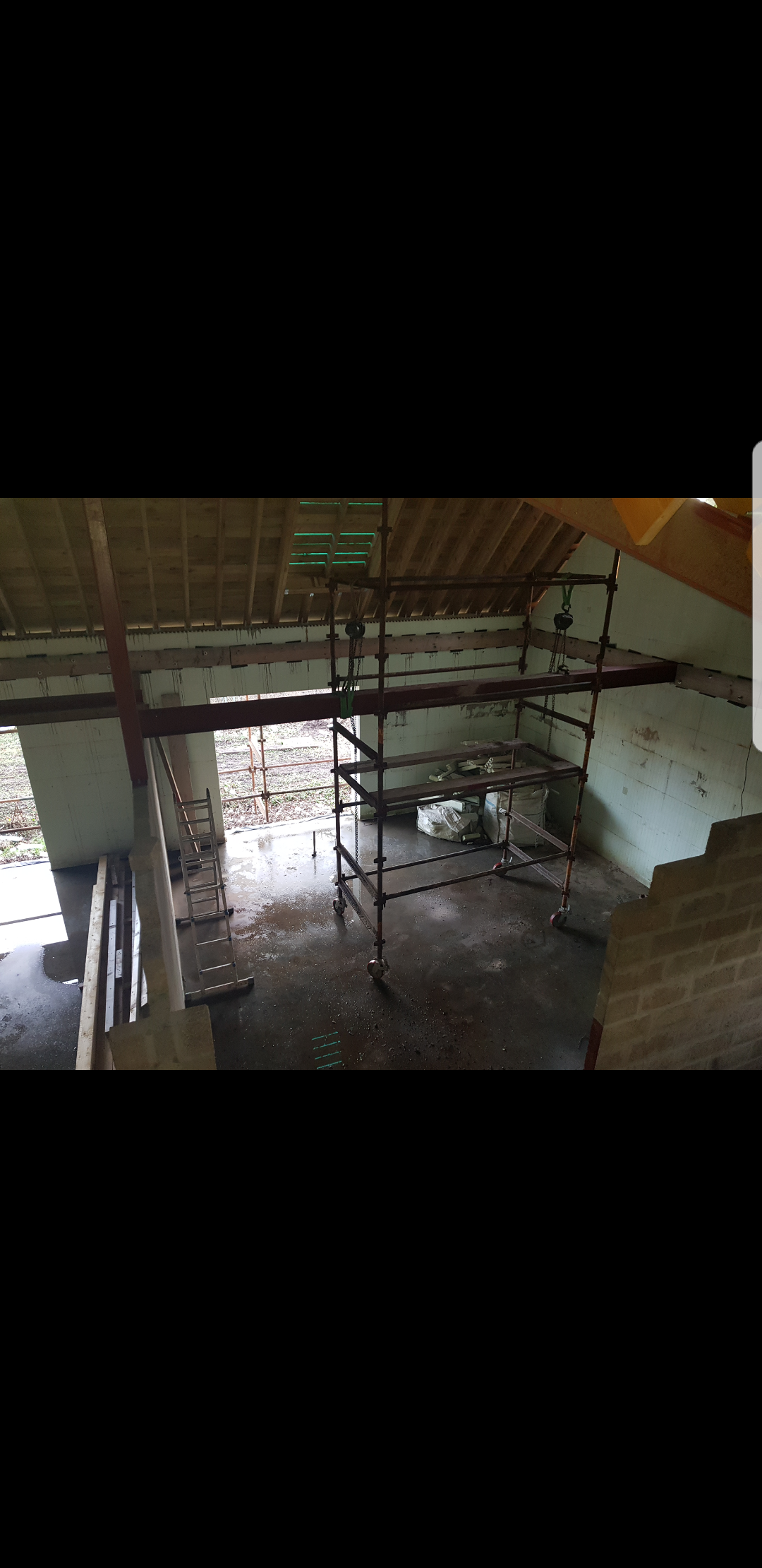

Alexphd1 Posted March 4, 2018 Posted March 4, 2018 Kwik stage on wheels= very handy? get the heavy duty wheels. We had it double height at one point. Also used it move beams and jack up beams to 9ft. Now on the look out for short transoms 2ft8 so we can wheel it through door ways
ToughButterCup Posted March 4, 2018 Author Posted March 4, 2018 9 minutes ago, Alexphd1 said: Kwik stage on wheels= very handy? get the heavy duty wheels. We had it double height at one point. Also used it move beams and jack up beams to 9ft. Now on the look out for short transoms 2ft8 so we can wheel it through door ways [..] Right, that does it. On order first thing tomorrow. Jacking up beams = go on, tell me more..... How did you rises that beam? You've got me hooked now, really hooked Short trannies? Is there such a thing? Where? How? Who?

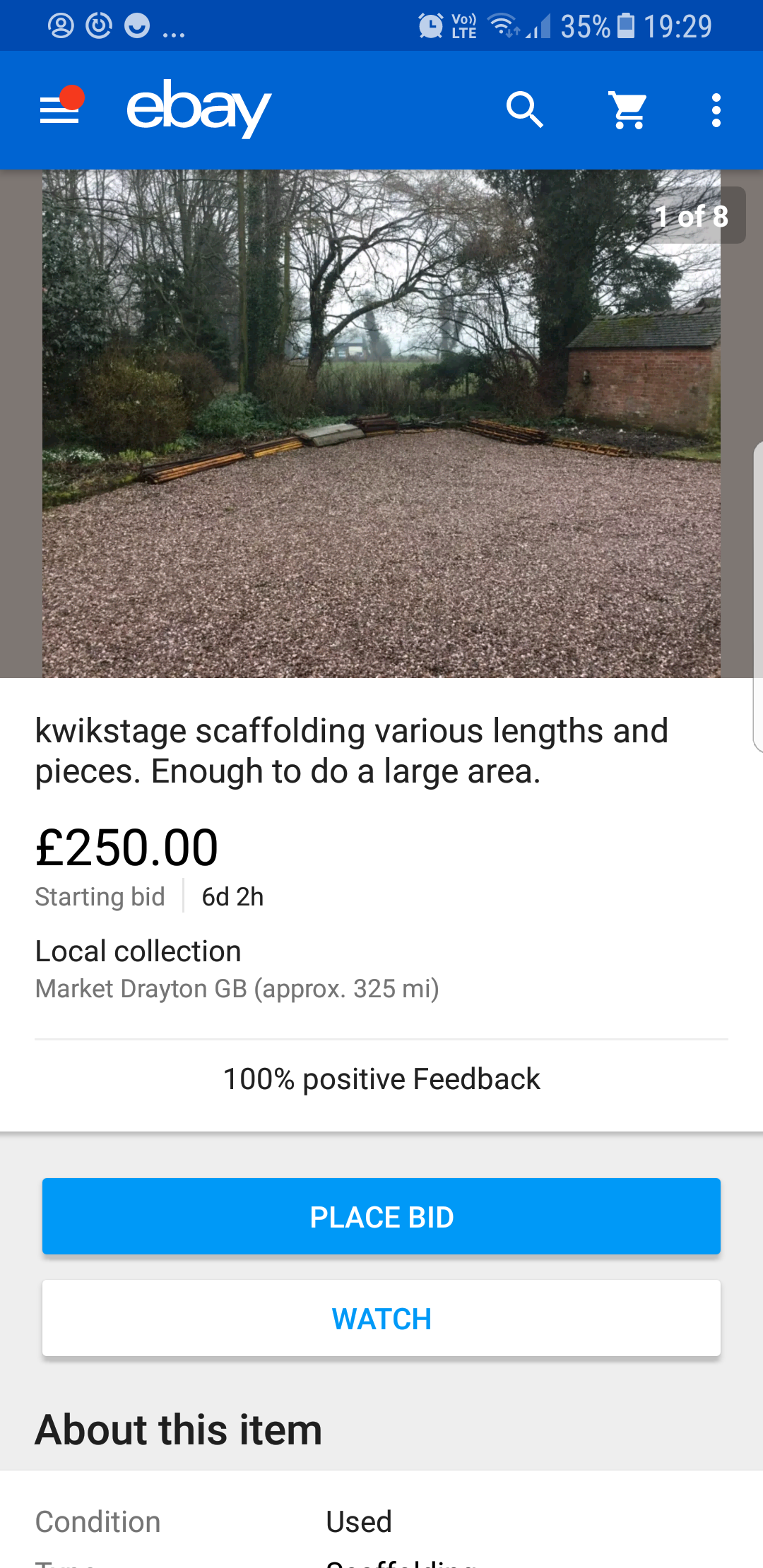

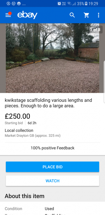

Alexphd1 Posted March 4, 2018 Posted March 4, 2018 Just came across this. Maybe somebody might pick up a bargain
