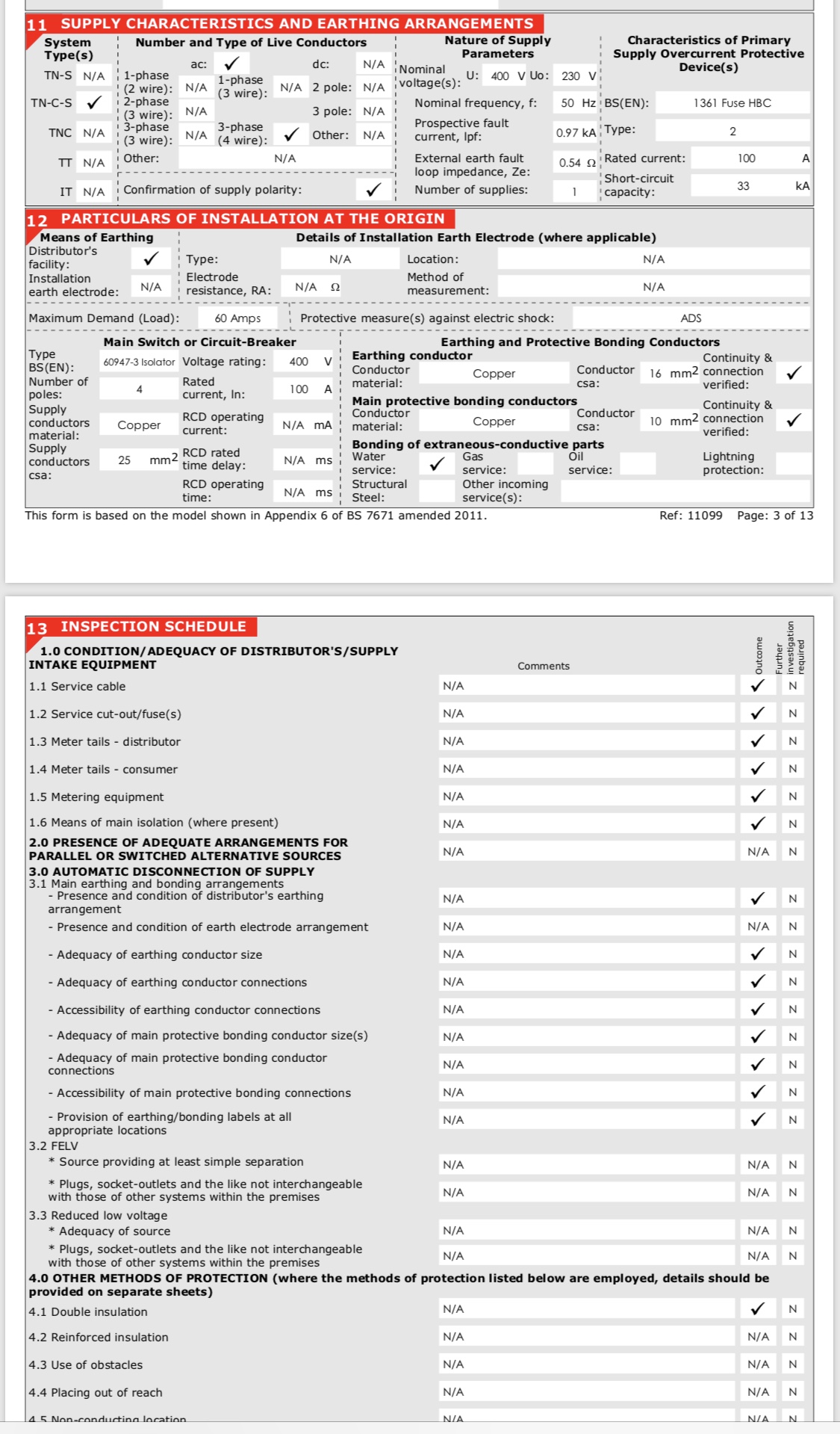

newhome Posted February 21, 2018 Author Share Posted February 21, 2018 Here’s the bit from the electrical test if useful. Link to comment Share on other sites More sharing options...

ProDave Posted February 21, 2018 Share Posted February 21, 2018 2 hours ago, newhome said: Here’s the bit from the electrical test if useful. That confirms a 3 phase supply. Can you post some more pages, specifically there will be a couple of pages "schedule of test results" Link to comment Share on other sites More sharing options...

newhome Posted February 21, 2018 Author Share Posted February 21, 2018 (edited) Here is the full electrical test. There were a few things to address that were done and signed off later. Will add later as struggling to remove my address from the phone! Edited February 21, 2018 by newhome Link to comment Share on other sites More sharing options...
