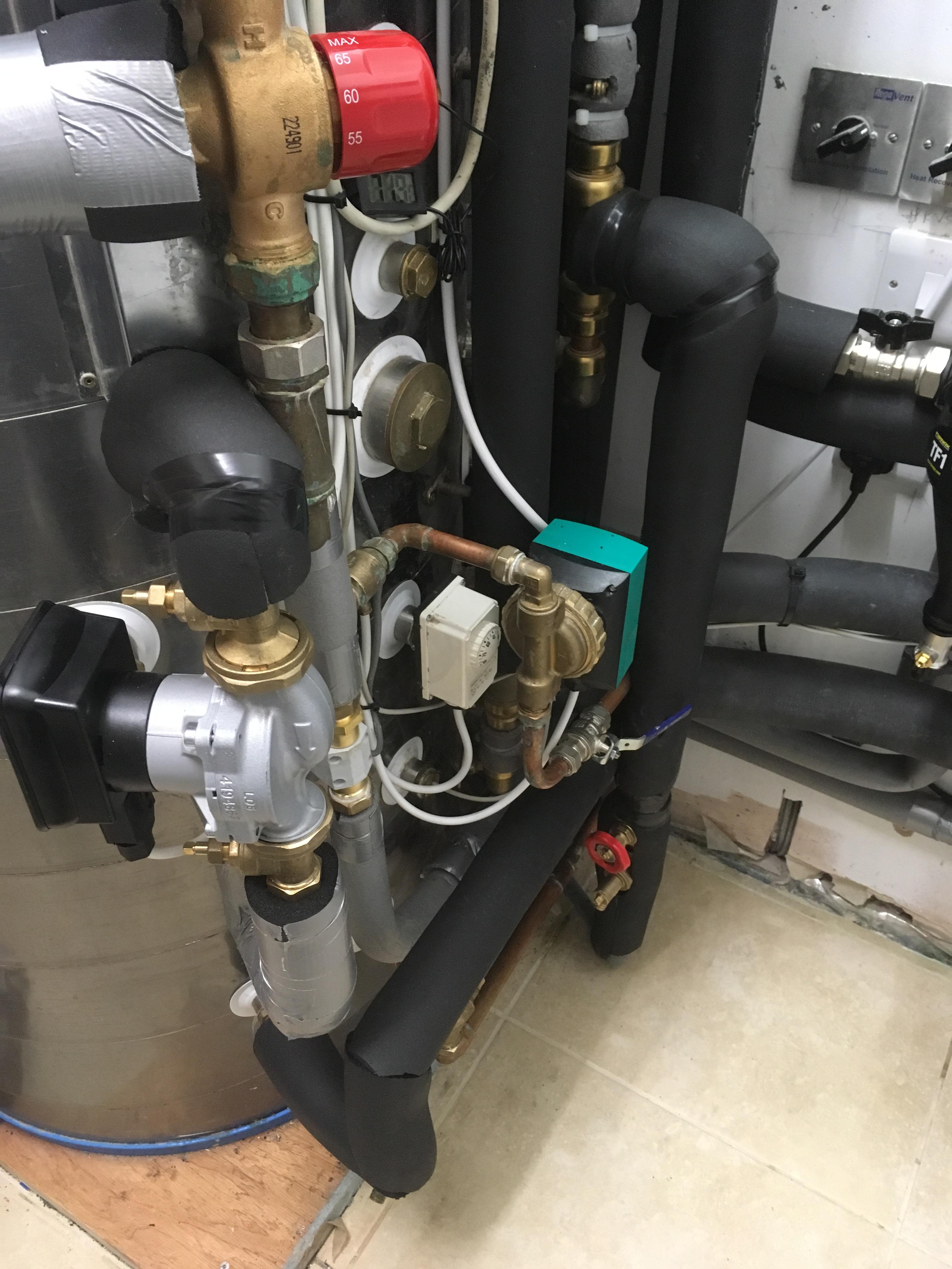

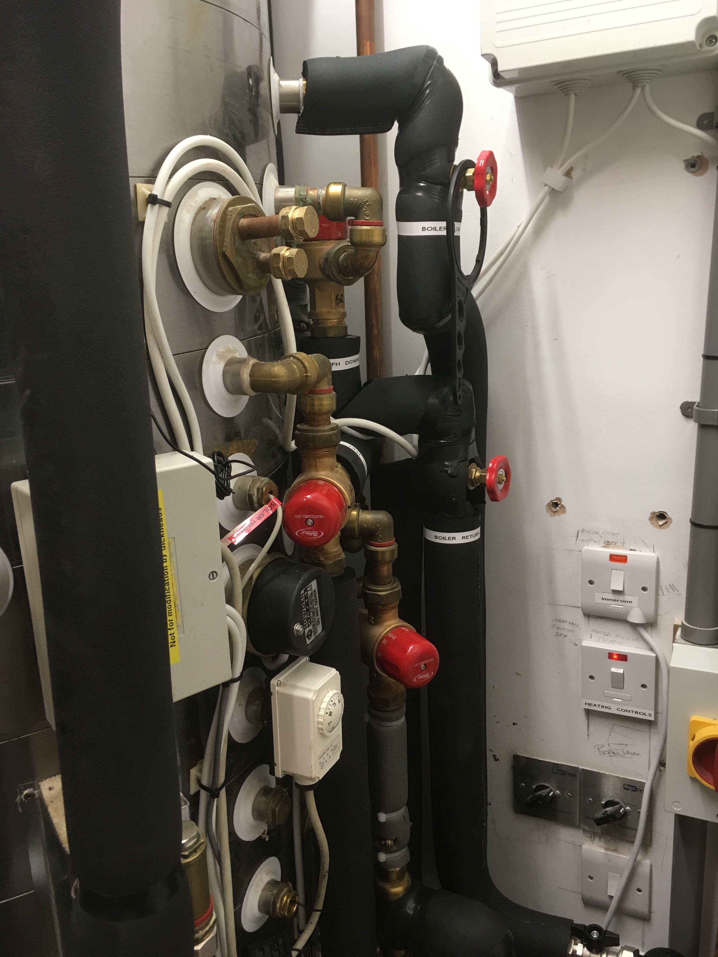

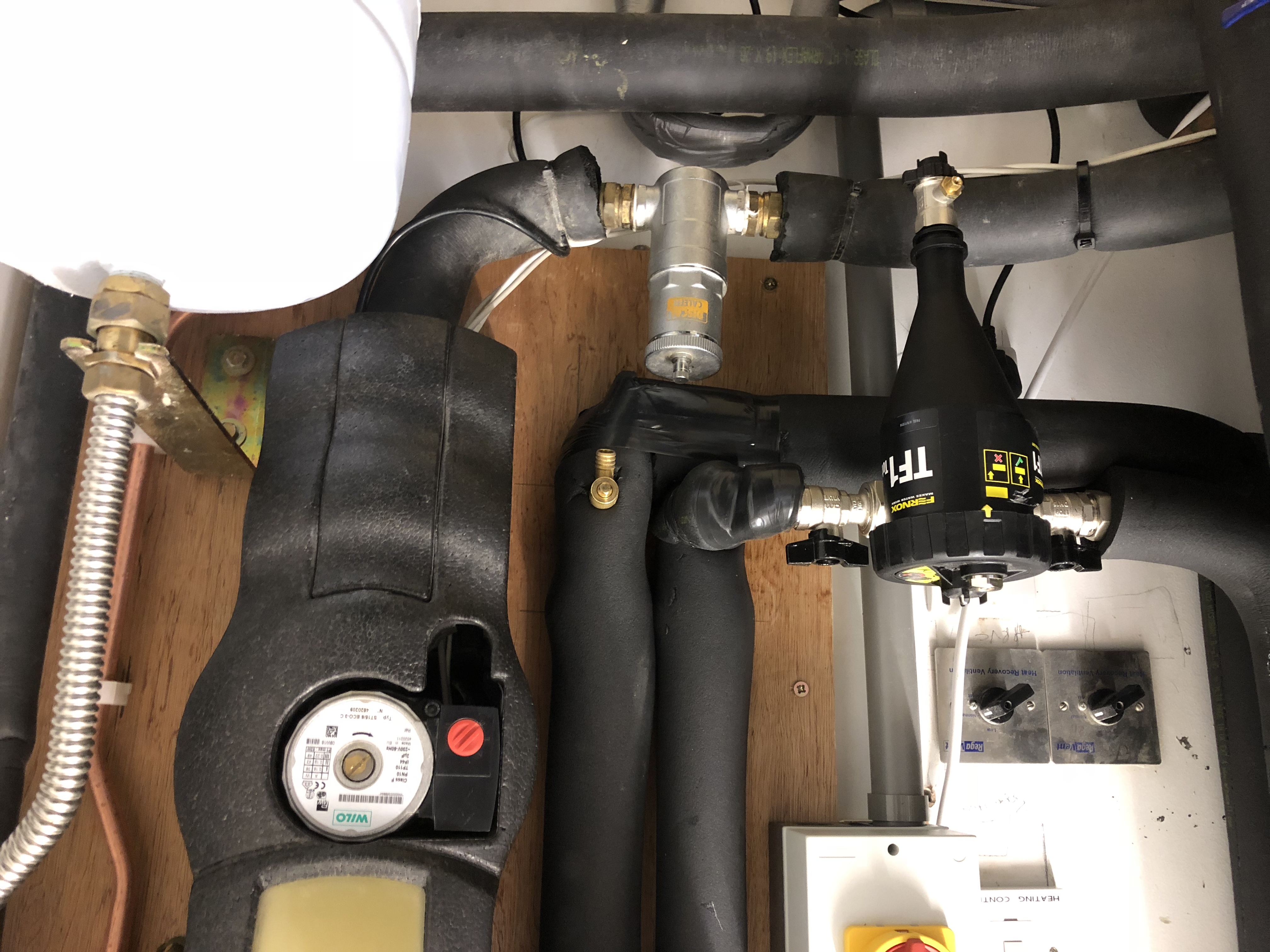

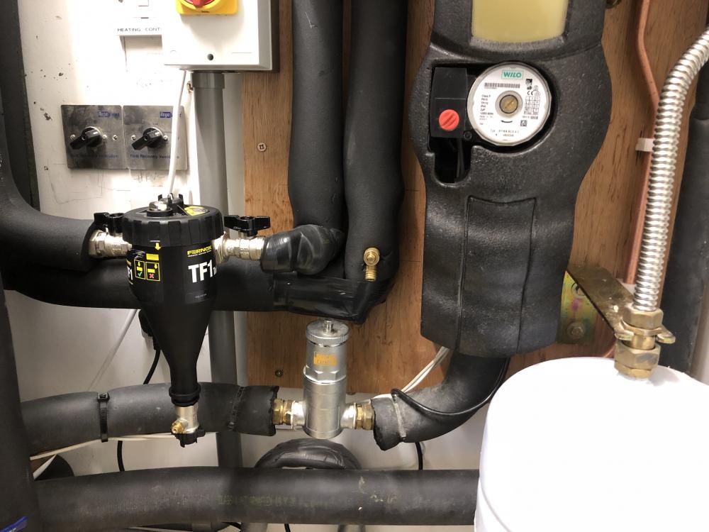

newhome Posted April 9, 2018 Author Posted April 9, 2018 1 hour ago, Onoff said: Can't wait for the precis on on this road trip! (Though a lot of the technicalities may escape me! ) Will be leaving the technical speak to@Nickfromwales and @PeterW From my perspective: heating working in all rooms - tick! solar working - tick! rooms heating rapidly (as opposed to taking 24-36 hours to increase the temp by about 3 degrees) - tick! enough hot water to fill a bath / shower - (even the big bath) tick! extension connected up - tick! able to run hot water without the heating being on - tick! TS not emptying itself of hot water within about 30 mins without the boiler being on constantly - tick! Plus everything has been labelled to within an inch of its life. A magnaclean filter has been fitted, various new pumps etc have been installed. I have a new outside tap, the loo in bed 4 now works and various other things have been done, including them sorting through the endless pile of shite here helping me understand what I should keep vs things to throw away. Massive massive thanks to @PeterW and @Nickfromwales, and @PeterW‘s mini-me Will (who consumed his body weight in Tunnock’s tea cakes). I can’t believe that Nick and Peter have never met before as they seemed like guys who had worked together for years. These guys put in more hours to fix the things here than I could have imagined possible, fuelled by bacon, beer and coffee, and some good humour, with lots of banter. 7am and they are already up swapping some things over when they didn’t finish until gone midnight last night. And Will is going to come up again to finish the other bits and pieces here when I will finally be able to say that my build is completely finished. It’s been a pretty long haul after everything that happened here. Buildhub rocks! I could never have imagined when I initially posted about my vat claim 2 months ago that it would also be the key to sorting my heating woes and other unfinished bits and pieces. 14 2

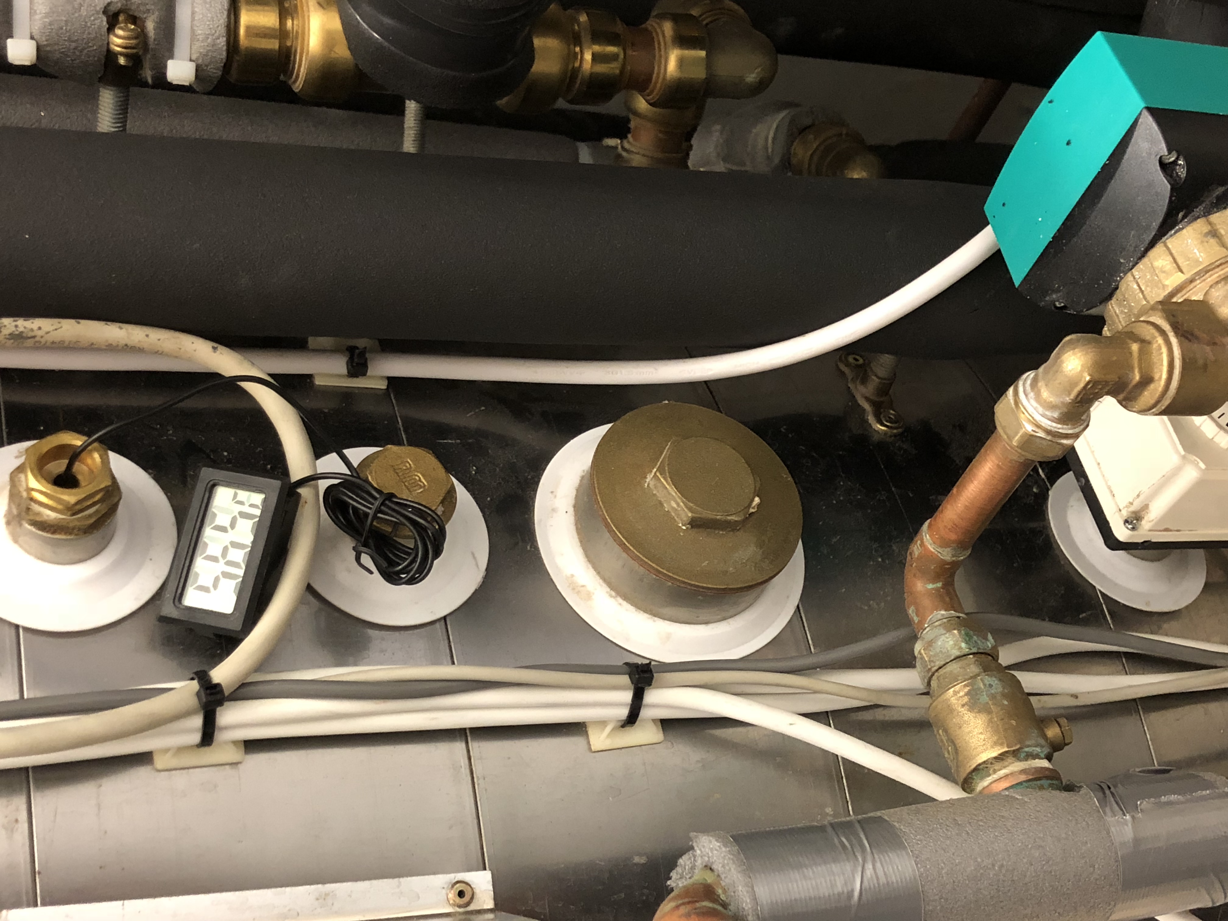

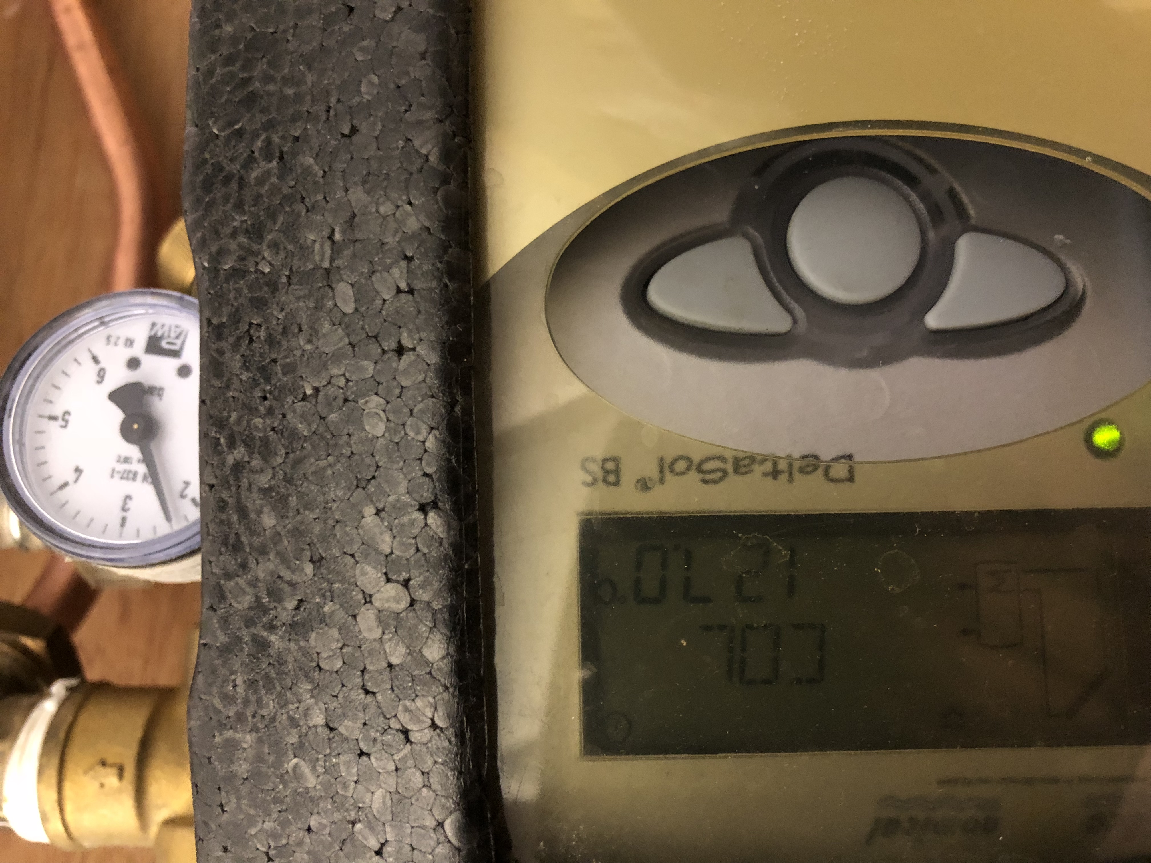

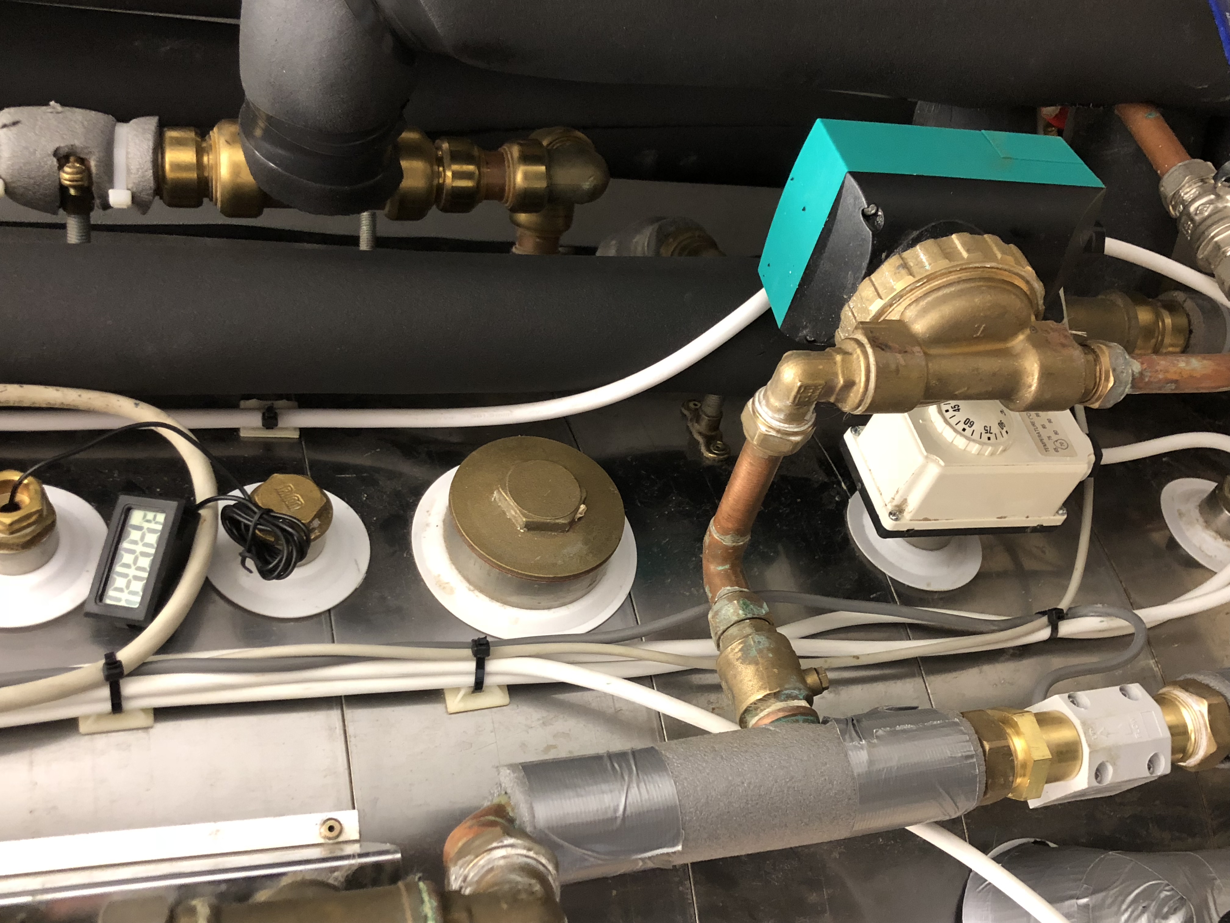

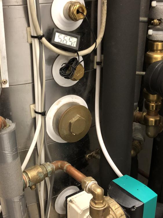

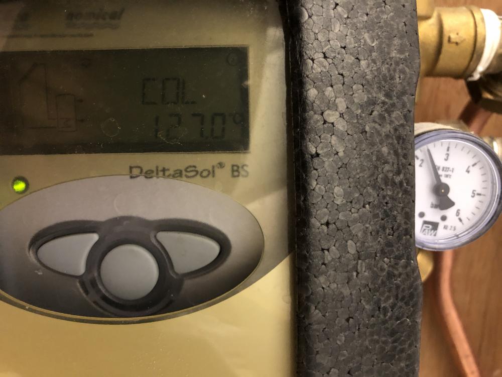

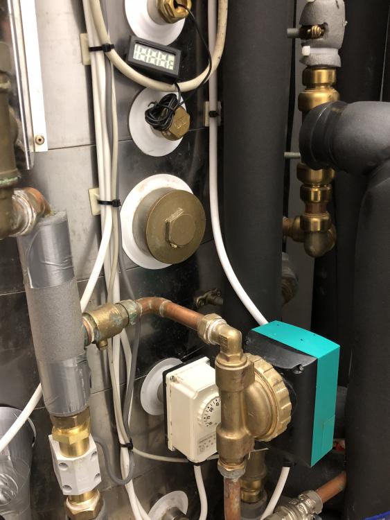

newhome Posted April 9, 2018 Author Posted April 9, 2018 (edited) 3 hours ago, PeterW said: Solar thermal is up to 33c already ... 127c now. I’m still not totally sure how it works . So the column is 127c, the silver Wilo pump on the Deltasol is 58c, the Discal air vent (I think it is) is 30c, the little eBay stat on the lower half of the tank shows 56.5 and the bottom cylinder stat is set to 45. So what determines how much heat goes into the TS from the ST and how does it get there? Edited April 9, 2018 by newhome
Jeremy Harris Posted April 9, 2018 Posted April 9, 2018 Looks like the collector has stagnated at 127 deg C because the ST pump has turned off, and the ST pump has probably turned off because the stat has turned it off. My guess is that the stat that's set to 45 deg C may be the one that is controlling the ST, in which case it's satisfied, as the bottom of the tank is well over the 45 deg set point. It's not unusual to see pretty high collector temperatures in the ST system when it's turned off. Between 120 deg C and 140 deg C is about the normal max range in this condition, IIRC. When the experts have returned and recovered they will, I'm sure, be able to confirm or otherwise if this is the case. 1
