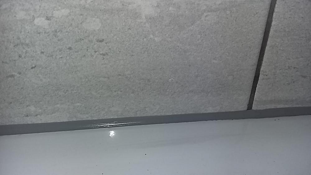

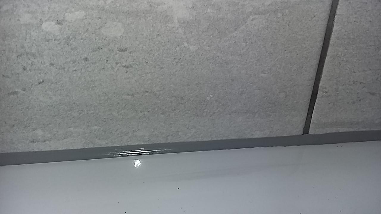

bassanclan Posted February 9, 2019 Posted February 9, 2019 No taping on the above, just wiped where I veered off course. When you use tape you generally get a ridge when you pull the tape off which you either have to smooth back (in which case why bother with the tape) or the ridge is where water and therefore mould collect. As you're not doing it every day, but quite a bit to seal you might be better of using a fugi tool. Have a look at you tube for some videos, I've not tried it with ct1 as it's so bloody sticky, but it makes trowelling silicone sealant easy.

scottishjohn Posted February 9, 2019 Posted February 9, 2019 (edited) you have not cut the nozzle correctly --far too big and wrong shape .thats the problem try cutting some of your other spare nozzles into different shapes and much smaller -try them on waste bit of board --no tape --just get the bead right size before wasting anymore on the real job- tape should not be sealed over by choice -its just going to give hard thick edge of sealer when you remove it. its a safety edge so you can smear it in right shape and excess goes on to tape, but there should be no measurable thickness on tape right close to sealer ,so when removed you don,t end up with an edge shape should have finished before getting to tape ideally . If you want to keep working it ,wet your finger or use ice cube like i said before,if you don,t it will skin too quick +pull Edited February 9, 2019 by scottishjohn
Construction Channel Posted February 9, 2019 Posted February 9, 2019 1 hour ago, Onoff said: Well that came out like crap after trying to tool it. Wiped it all off in the end. What type of gun have you got? Looks like you've been pumping a lot which would suggest a cheap one to me. Try moving faster ( I know it's easy for me to say) but it will leave you with less ripples amd generally give you less excess to deal with. Mastiking is a bitch at the best of times ( behind taps are the worst). You need to work quick and tool it as soon as possible. Try again but maybe start on a nice short straight run, not around a curved toilet ? 1

scottishjohn Posted February 9, 2019 Posted February 9, 2019 use at least a quarter as much next time and spread it out , its just practice
