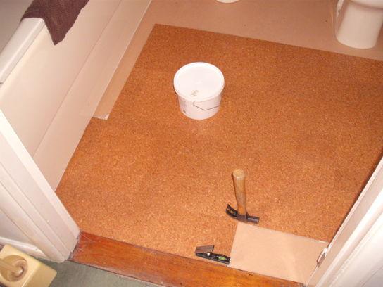

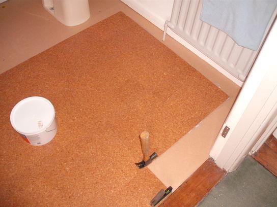

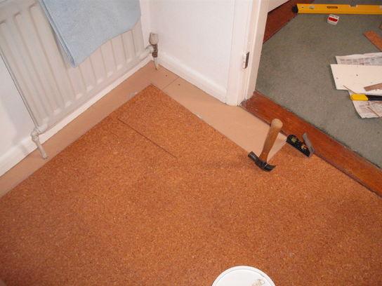

Ed Davies Posted October 12, 2018 Share Posted October 12, 2018 (edited) That's fine if the tiles and floor are reasonably parallel which we'd hope they are here, but in general it's not very accurate if they're not because the tile will be sitting at an angle to where it eventually winds up. E.g., bathroom in my old house where I got to choose whether to make the cork tiles parallel to the bath and door “cill” (what's the word?) or to the opposite walls. I chose the bath and door. Also, the one-tile-back-and-measure-tile-width approach works when the cut isn't straight, like round the edge of the door here. Edited October 12, 2018 by Ed Davies Link to comment Share on other sites More sharing options...
