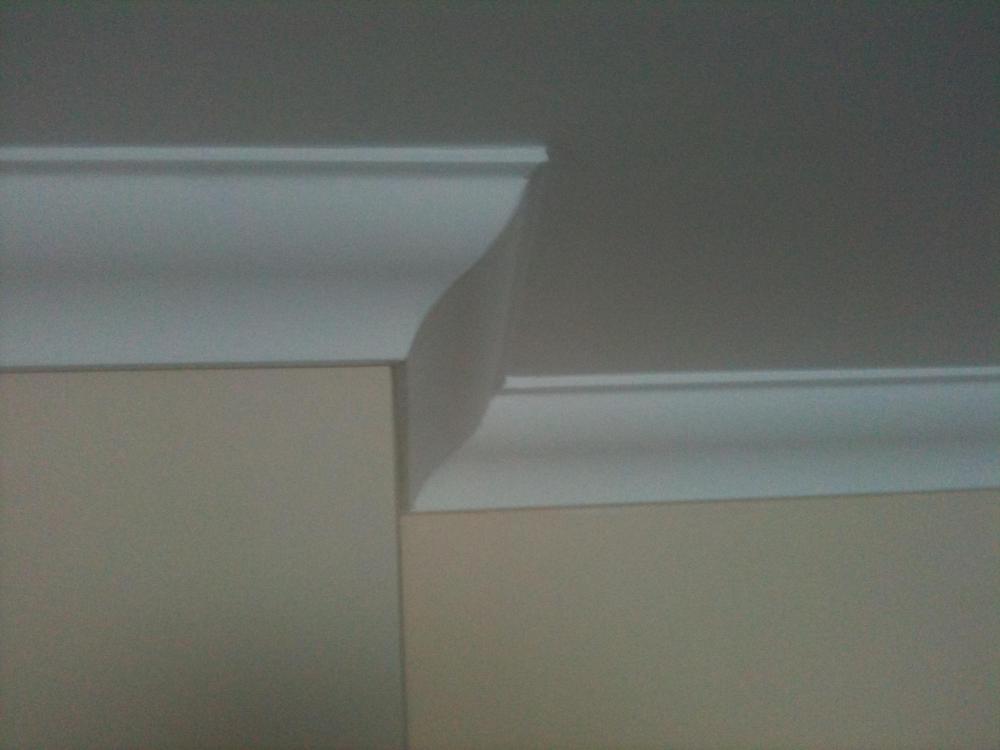

@Onoff I'd 100% put a cornice not a standard cove in there. See Gyprocs 135mm S profile for eg. You could go for a smaller one, but that S profile looks the dogs bollocks when up. Its a bastard to cut and mitre, as its IIRC 92mm out and 88mm up so doesn't sit in a generic mitre box, but the results are great.
Another option is a 60mm Upvc D-section.

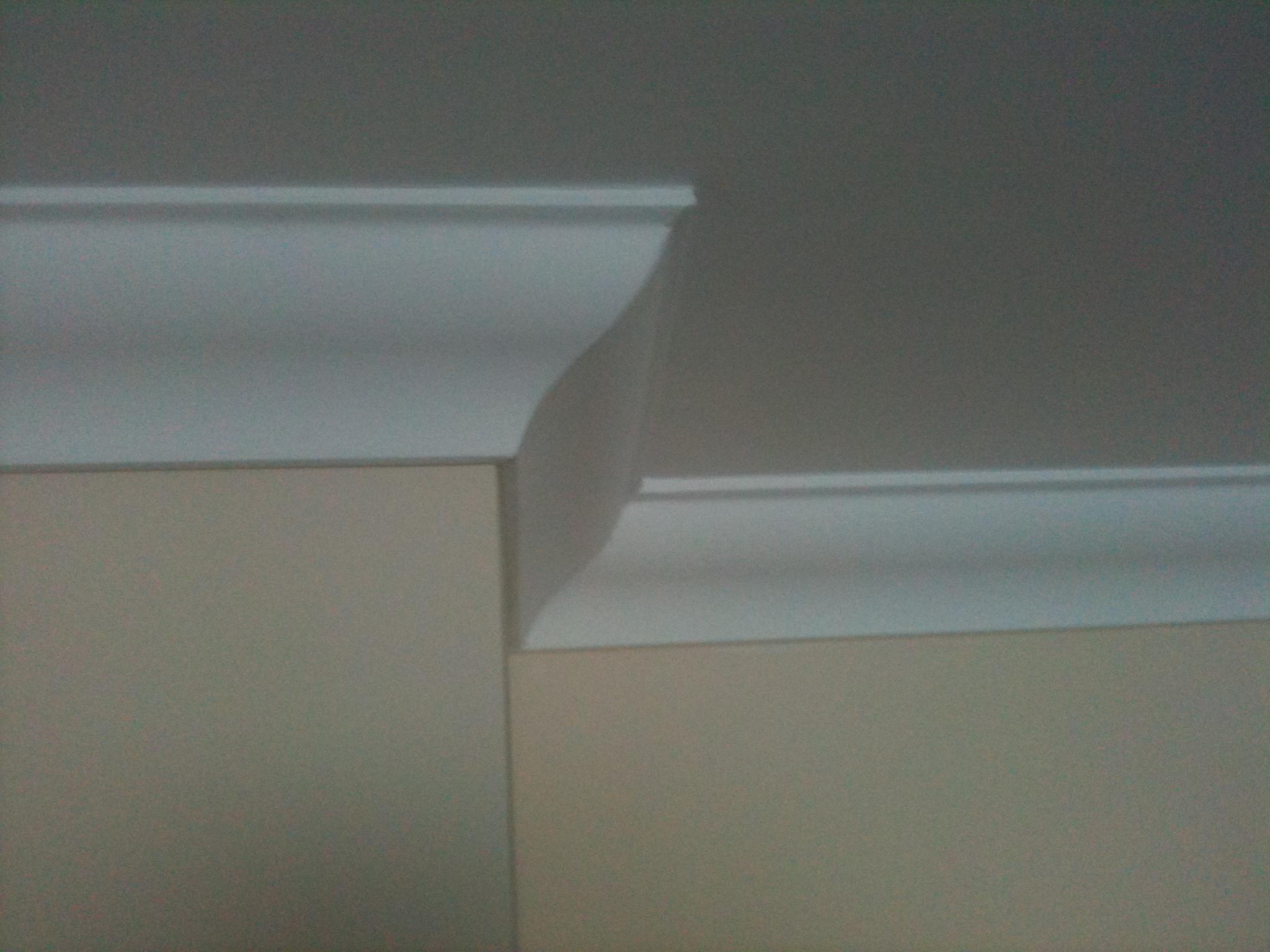

Ta. Tbh I should have waited until you were back from the Maldives  before I started tiling! :)
Was wondering about white, 40mm D line.....should fit straight in the gap:
https://www.tlc-direct.co.uk/Products/DL2D4020
