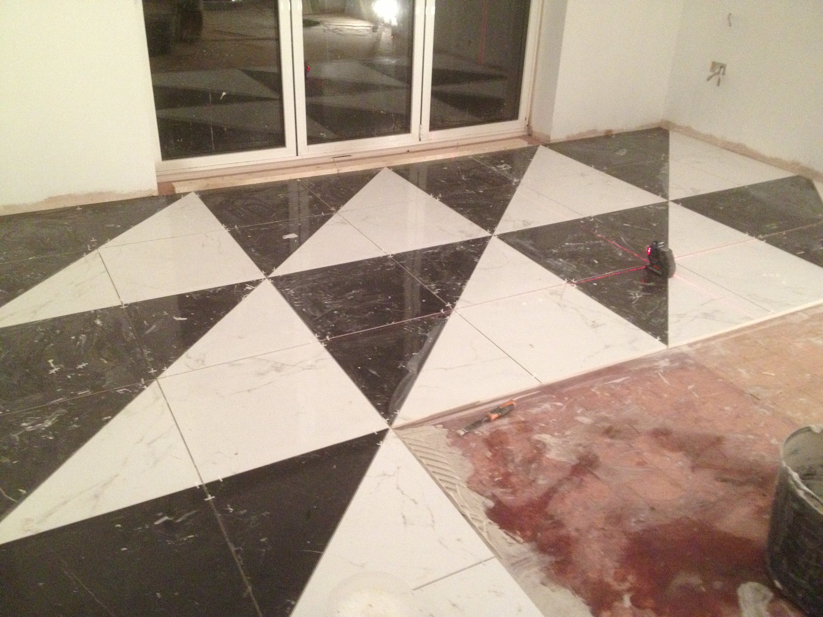

Onoff Posted March 14, 2018 Author Posted March 14, 2018 I can't believe nobody spotted the deliberate mistake when I posted up this photo of the model previous! Anyway...Union Jack cuts in 330x330x8mm ceramic floor tiles. On a loser? Possible? I can probably get some water jet cutting done.
Onoff Posted March 16, 2018 Author Posted March 16, 2018 @Nickfromwales, when you have your tiles water jet cut do you do a CAD drawing or a fag packet sketch and someone else draws it up as a DXF etc? Is it that the tile has to be positioned on the cutting bed to a set datum point as in can they cut to say a line drawn on the tile? Going back to my days doing drawings for the "magic eye" cutter!

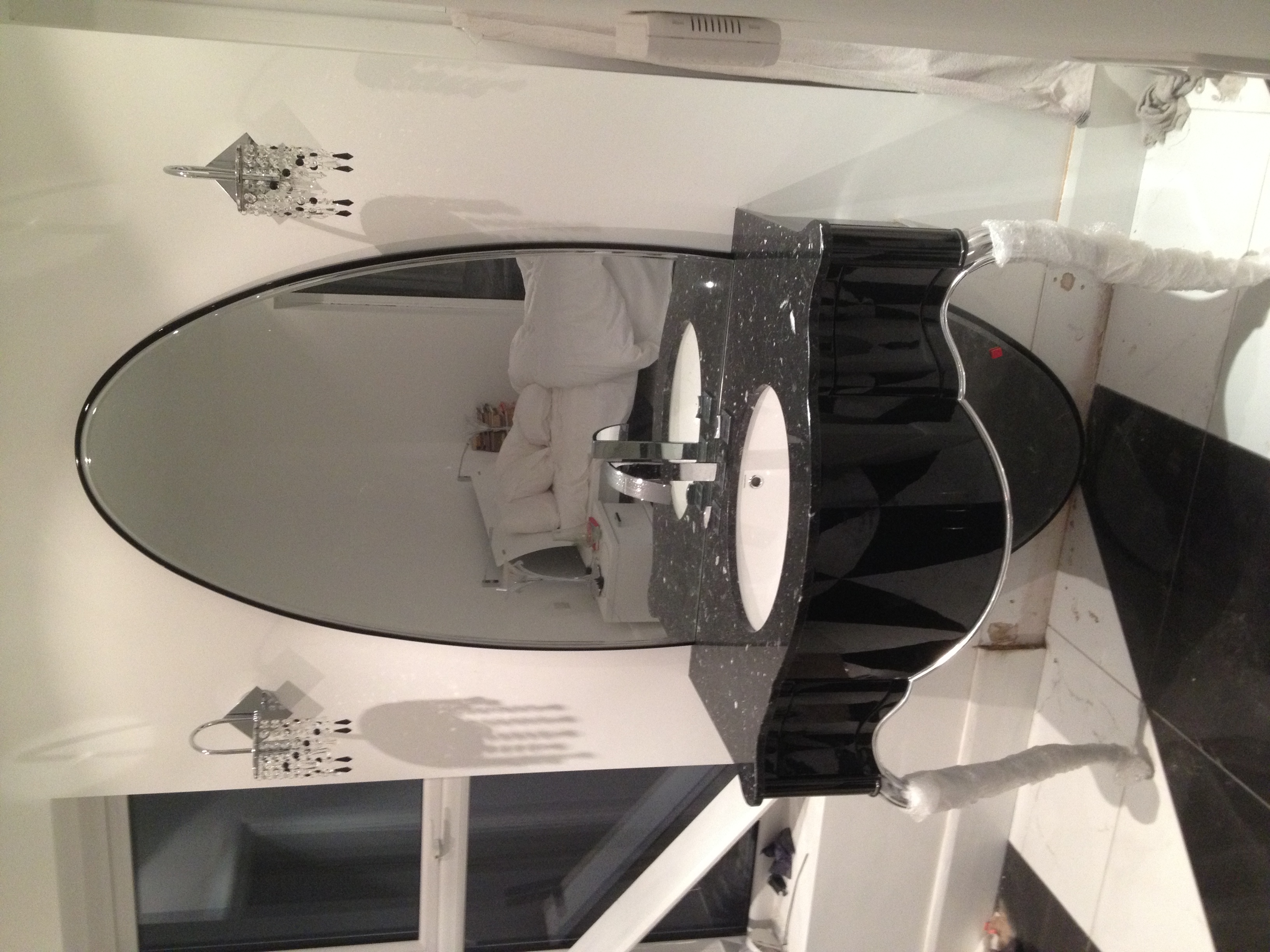

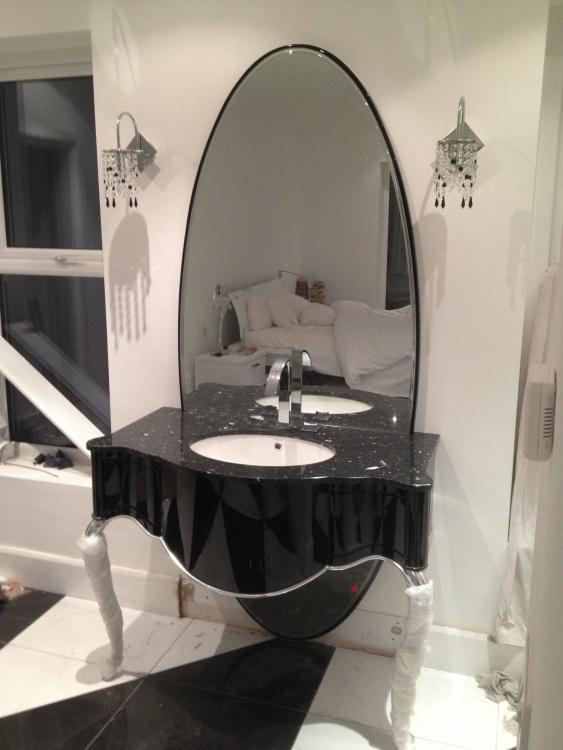

Nickfromwales Posted March 16, 2018 Posted March 16, 2018 I give the tiles with tile pencil lines drawn on them where necessary and a handful of beer tokens and he works the magic. I don't ask how, just how much. I'm a bathroom fitter, he's a CNC machinist in charge of nearly a £1m worth of huge water jet. He even oscillated the jet to give me a replaceted 3mm grout line when two triangles came back together to make a full tile. The dogs bollocks. Beer applied = Tiles cut. Tres bien. PS nowt wrong with back of a fag packet......haven't lost a patient yet. I don't own a scientific calculator btw .
Onoff Posted March 16, 2018 Author Posted March 16, 2018 17 minutes ago, Nickfromwales said: He even oscillated the jet to give me a replaceted 3mm grout line when two triangles came back together to make a full tile. Like they do when engraving i.e. not going all the way through! Shouldn't such a line be properly broken to give falls in two planes? Bit worried about my proposed layout that the clouded intersection is going to give rise to a rather sharp, pointy tile that's also weak: (The b&w grid in the background is just something from the youngest's transposition cypher homework NOT mosaics! )
Nickfromwales Posted March 16, 2018 Posted March 16, 2018 (edited) Not a groove jetted in These were 600x600mm porcelain. The lady of the house had a 'vision' of black and white, so black and white it went. Porcelanosa sold the dream, then handed me a nightmare. The black and white chequers are 1200x1200mm and each is made up of a full tile of each colour plus 4 halves. If you jet the tiles in half then bring two together then you get a 599x599 quare as the jet takes roughly 1mm of material out during the 'cut'. Problem is you then have no grout gap between the black and white triangles where the black meets white. Solution is to ask the water jet guru to oscillate the jet side to side as it's cutting. Then you can choose 1.5-2mm off each cut which then gives you 3-4mm for grout. This was an open plan bedroom. A curved wall in the corner where you walked into the shower and poop area, and this vanity on one wall of the bedroom, just off. Oh oh and just to piss me right off, there was a mix of black and white grout. Try that for fast access to the loony bin . Edited March 16, 2018 by Nickfromwales Some random picture which isn't mine popped in there ! 2 1
Onoff Posted March 16, 2018 Author Posted March 16, 2018 Not knocking the technical prowess and thought gone into it but that looks f****** 'orrible! Had the woman no taste? Did she have you do the ducks on the wall as well? 4
Nickfromwales Posted March 17, 2018 Posted March 17, 2018 "The customer is always right". I don't go to design people's houses for them, I got do what I'm asked, and to do it well. As you say, technically, it was a nightmare, but as far as execution went, 'twas splederific. . And yes, f'kin orrible .
newhome Posted March 17, 2018 Posted March 17, 2018 2 hours ago, Nickfromwales said: Oh oh and just to piss me right off, there was a mix of black and white grout. Try that for fast access to the loony bin . Jeezo! I know we all have different tastes but FML that vanity unit is a monstrosity. And the lights!!!
