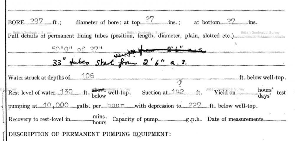

Randomiser Posted March 20, 2020 Share Posted March 20, 2020 On 01/10/2019 at 08:18, Jeremy Harris said: 10,000 gallons per hour is massive, the most you are allowed to extract without needing an abstraction licence is 20,000 litres per day, so that has around 54 times the maximum abstraction capacity of a private borehole with no licence. It's also a big borehole, around three times the normal diameter. A normal domestic borehole would be drilled at around 200mm/8" and then be fitted with a 112mm/4" PVC liner, with a slotted section at the base to allow water in. Our borehole is 53m deep (174 ft), has a standing water level that's about 4.5m below the top, and which dropped to 11m below the top when test pumped at 1,500 litres per hour for 2 days. We use around 400 litres per day, for just the two of us. Our borehole cost (after correcting for the cock-ups) around £9,000, including the cost of the pump, filtration, pressure vessels etc. Really interesting thread I stumbled on here, thanks to all that shared knowledge and experience. You seem a bit of an expert Jeremy I wondered if you had any insight in to what the cost to depth ratio is. So if a 50m borehole is say roughly £10,000, would a 100m borehole be around £20,000 or would it be a lot more as the cost of going deeper rises significantly? Link to comment Share on other sites More sharing options...

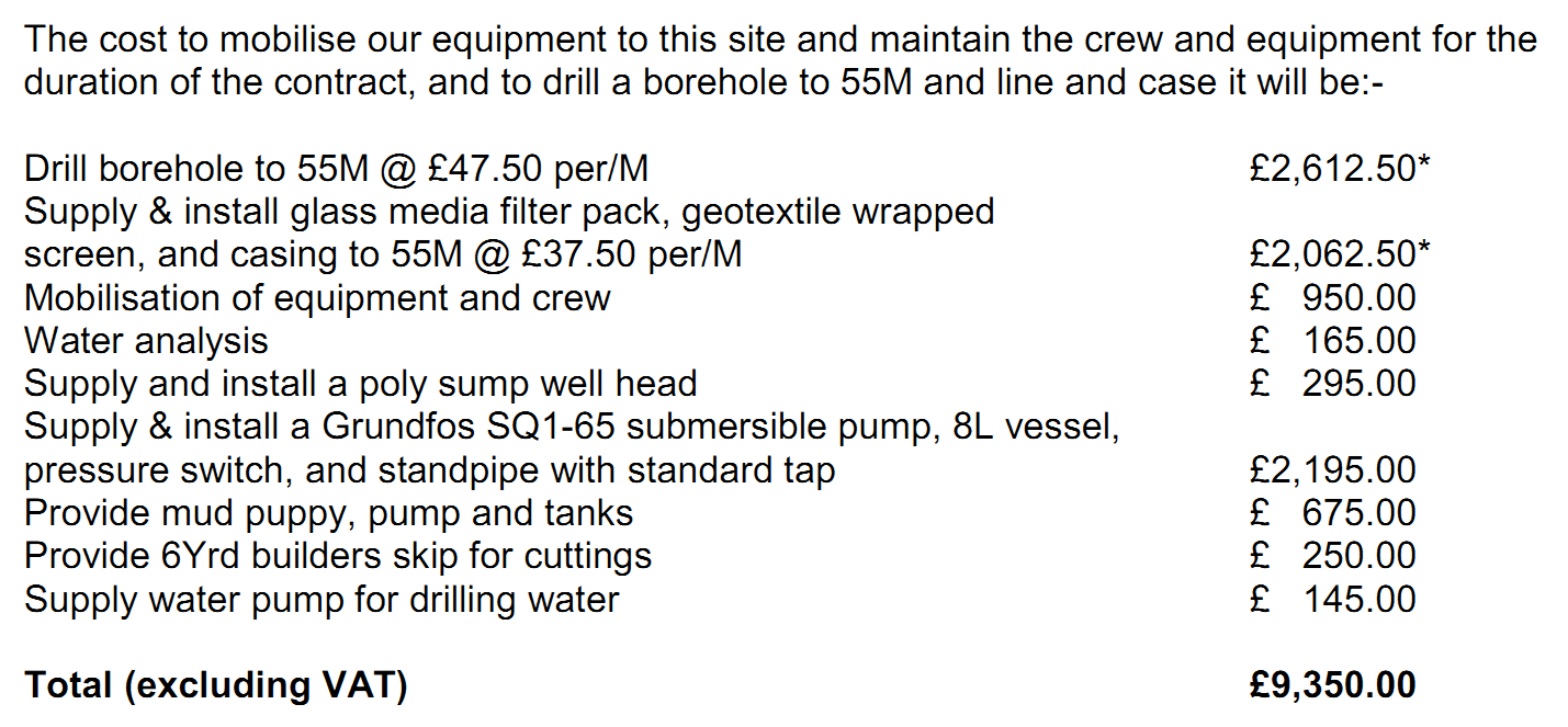

Jeremy Harris Posted March 20, 2020 Share Posted March 20, 2020 2 hours ago, Randomiser said: Really interesting thread I stumbled on here, thanks to all that shared knowledge and experience. You seem a bit of an expert Jeremy I wondered if you had any insight in to what the cost to depth ratio is. So if a 50m borehole is say roughly £10,000, would a 100m borehole be around £20,000 or would it be a lot more as the cost of going deeper rises significantly? Sadly any knowledge I've acquired is a consequence of being badly let down! I knew nothing about boreholes or water treatment until ours turned into a long-running saga, that delayed our build for a long time. Finding the problems and then fixing things led to me getting advice from a really helpful chap in the USA, somewhere where lots of people have their own borehole supply (more common than municipal supplies in many areas). When it comes to cost, there are big variations from one area to another, and for drilling through different types of ground. There's a pretty big upfront fixed cost, to mobilise the drill rig, compressor, settling tanks, waste skip, bowser etc to the site and set it up, then there's usually a fixed drilling and lining cost to a minimum depth, plus an additional per metre cost above that. The per metre cost is based on the time it takes to drill, plus the cost of the casing, and varies a bit with the geology. Finally there is the cost of test pumping, installing the pump etc, and the required pressure tank, controls, filtering equipment etc. The prices I have are a bit old, as our borehole was drilled in 6 or 7 years ago now, but were initially: We ended up having some problems and so there was a reduction in the price we finally paid because of those. The above prices, as well as being a bit out of date, related to drilling in our area, through highly compacted gault clay, with the greensand aquifer about 40m down, then a layer of hard Purbeck stone under that. The drill hit the Purbeck at about 50m down, and nearly stopped dead. In error they carried on drilling through it, after changing the drill bit, and it was really slow going. They didn't think they'd hit water, so after half a day when they'd only drilled about 3m or so I called a halt, as we knew from the hydrogeology that there wasn't any water underneath the Purbeck. As it happens, they had drilled right through the greensand aquifer without noticing, and one of the drillers came back the next day to double check, as he wasn't 100% sure that the hole was dry. We test pumped it and found that the yield was way more than we needed; we could pump at 1500 litres/hour and the borehole kept up with it, and we only need about 400 litres/day. 1 Link to comment Share on other sites More sharing options...
SteamyTea Posted March 20, 2020 Share Posted March 20, 2020 1 hour ago, Jeremy Harris said: we could pump at 1500 litres/hour and the borehole kept up with it, and we only need about 400 litres/day. Out of interest, do you meter how much water you actually use? I am still half minded to get a borehole, though my largest expense is the sewage, and that would be the same as no room to fit a treatment plant. Link to comment Share on other sites More sharing options...
Jeremy Harris Posted March 20, 2020 Share Posted March 20, 2020 7 minutes ago, SteamyTea said: Out of interest, do you meter how much water you actually use? I am still half minded to get a borehole, though my largest expense is the sewage, and that would be the same as no room to fit a treatment plant. Not really, no. I do keep a very rough tally of how many times a day the pump comes on (just because it is easy to see on the electricity use data) and I know that it pumps around 250 litres every time it comes on (recharging the pressure vessels). From that I estimated that we use roughly 400 litres per day, more than half of that being showers. Link to comment Share on other sites More sharing options...
SteamyTea Posted March 20, 2020 Share Posted March 20, 2020 1 hour ago, Jeremy Harris said: I do keep a very rough tally of how many times a day the pump comes on (just because it is easy to see on the electricity use data) and I know that it pumps around 250 litres every time it comes on (recharging the pressure vessels). From that I estimated that we use roughly 400 litres per day, more than half of that being showers. That's good enough for me. If I did get a borehole I would be using it for everything except drinking water, with my bathing being the biggest usage. My water has gone up in price, but my electricity has gone down in price again. Link to comment Share on other sites More sharing options...

Ferdinand Posted December 29, 2020 Share Posted December 29, 2020 34 minutes ago, patp said: I imagine it is licenced as they had it dug by proper contractors. As for drying up it is gushing at a rate of knots that causes people to stop and point at it as it exits our property. It never slows down let alone dry up. Somewhere there is a national map of all the boreholes. Is this it? https://www.bgs.ac.uk/information-hub/borehole-records/ F Link to comment Share on other sites More sharing options...
Onoff Posted December 29, 2020 Author Share Posted December 29, 2020 3 minutes ago, Ferdinand said: Somewhere there is a national map of all the boreholes. Is this it? https://www.bgs.ac.uk/information-hub/borehole-records/ F Same site I think as this link @Jeremy HarrisHarris put up: http://mapapps.bgs.ac.uk/geologyofbritain/home.html Link to comment Share on other sites More sharing options...
Gone West Posted December 29, 2020 Share Posted December 29, 2020 36 minutes ago, Onoff said: Same site I think as this link @Jeremy HarrisHarris put up: http://mapapps.bgs.ac.uk/geologyofbritain/home.html Yes that's the site where I entered the data for our borehole. Link to comment Share on other sites More sharing options...
Onoff Posted December 29, 2020 Author Share Posted December 29, 2020 17 minutes ago, PeterStarck said: Yes that's the site where I entered the data for our borehole. I found two historic bore holes 100m or so either side of my house. Bodes well if was ever to want one I guess as both those and I are all on the same line at the bottom of the valley. Link to comment Share on other sites More sharing options...
Gone West Posted December 29, 2020 Share Posted December 29, 2020 52 minutes ago, Onoff said: I found two historic bore holes 100m or so either side of my house. Bodes well if was ever to want one I guess as both those and I are all on the same line at the bottom of the valley. I should think so. Although ours was an accident, it has proved to be useful for watering the garden in the summers. We have two wells just up and down the lane from us but they are only 2m to 3m deep but ours is 47m deep. Link to comment Share on other sites More sharing options...
