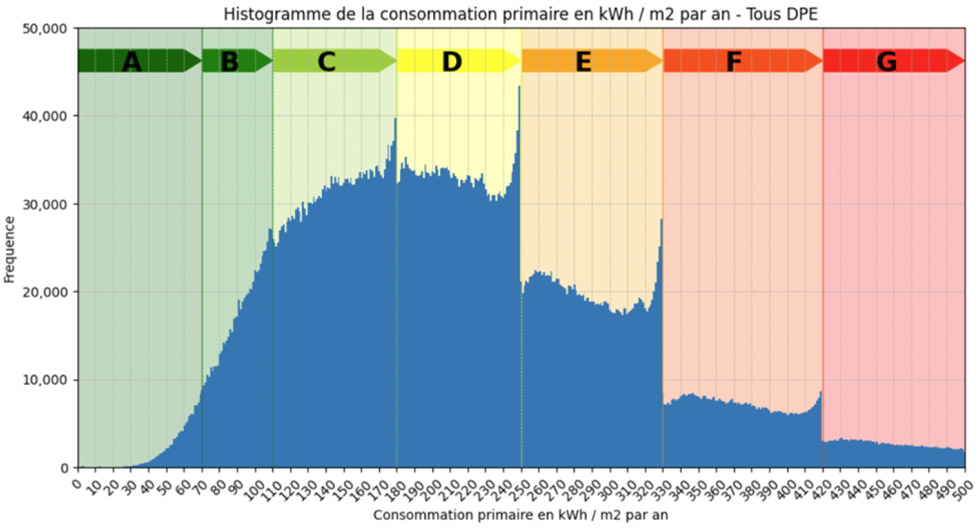

In France - where EPCs significantly affect property values & saleability - EPCs now have a legally enforceable status throughout their 10-year validity - the same status as asbestos reports and the like.
That is, if an EPC is proven to be wrong, a buyer / lessor can take action against the seller / landlord for the cost of improvements to reach the EPC rating / extra central heating costs incurred + interest / loss of value / loss of enjoyment / potentially the annulation of the sale or lease. The seller / landlord can also take similar action against assessor (unless they provided false information, in which case there are very severe penalties). The assessor may also incur a fine of €1,500 fine in case of error, or €45,000 & up to 3 years prison for falsification. Of course you can't get an EPC for £35 in France.
Previously, French properties were often falsely bumped up into the next EPC band, as per the chart below. Presumably this won't happen (much) going forwards.
             chart from an analysis by KRNO: étude KRNO sur la fiabilité du DPE, 28 novembre 2024
