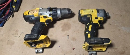

Square Feet Posted May 9 Posted May 9 I sold my soul to DeWalt some years ago and I haven't regretted it. The batteries last forever and stay charged even if you don't use them for a couple of years. The tools are very robust and well made and purr along like a sewing machine. You can pick up second hand tools and they will still work fine, even if the outside shows them to have had a hard life. They hold their value well for selling on later if you find you no longer need them. Some of the more simple tools like torches and sanders you can get aftermarket versions of that will work fine with the DeWalt batteries. As others have said - pick a good brand and stick with them. 1

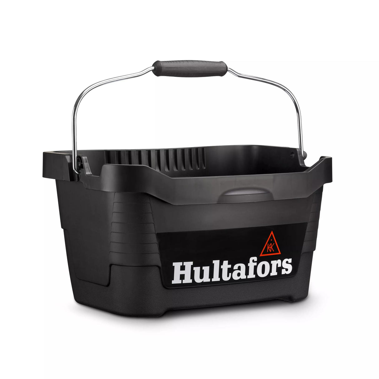

SimonD Posted May 10 Posted May 10 21 minutes ago, saveasteading said: Does anyone know a source of good storage boxes? You are going to gasp in horror, but this is my absolute favourite tool storage box (now bear in mind they're being used almost on a daily basis). It's something that does just work. https://hultafors.com/en-gb/products/tool-bucket It's been so popular, they now sell a tool organiser to go in the bucket. I have 6 of these buckets 😲 I've even had customer say what a good idea as their other trades are coming in and out with loads of boxes. For example, one of mine just has the drill/driver/screwdrivers with bit sets and a drill roll, the other with have the sds & multi-tool etc. While I'm working away I'll have an empty one where I throw bits of rubbish as I go, including pipe off cuts, old screws etc. and then it's brilliant for the odd emergency when I'm removing old pipework where I can grab the bucket to collect the always expected run out of water from said pipework. 3
