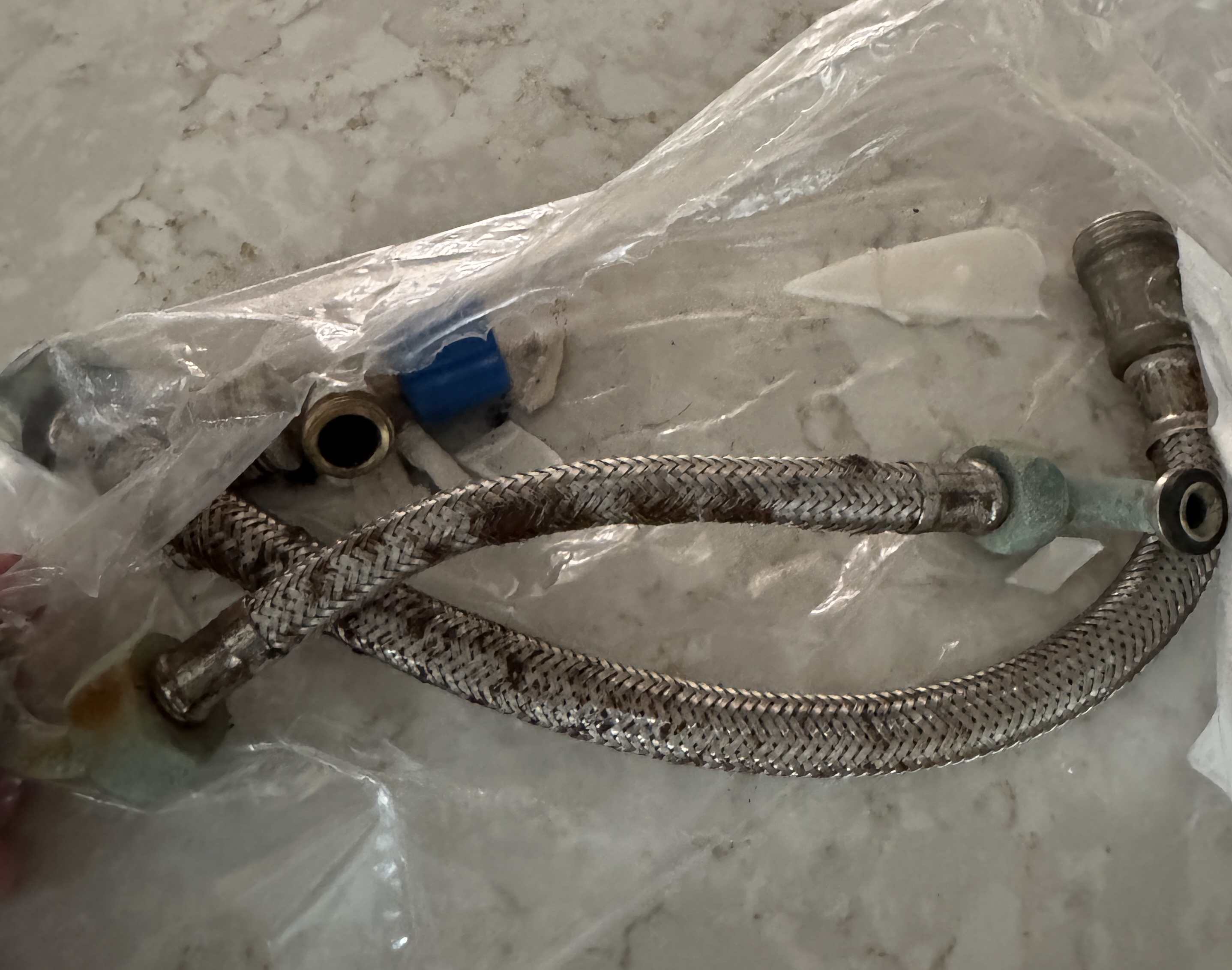

We just had the fourth one fail. One of the four failures causes quite a bit of water damage, the others all failed draining into the cistern.
I bought a load of replacement pipes and plan to check them more often to see if they look like failing.
Some of them seem to rust quite badly.
My suspicion is that the incoming water is quite cold and they are all sealed inside unheated spaces. This causes water to constantly condense on the outside of the pipes and they rust then fail. The local water supply is also very acidic.
When you Google flexipipes you get some research from Austrlai that says they are the number one cause of household flooding and account for 20% of all cases of water damage.
The one in the bathroom connected to our pool has failed twice. I believe it is because the humidity is higher in this room so more water condenses on the pipes. There is no chlorine. Yesterday it was the flea connector to the mains inside the wall. I managed to replace it with a lot of effort without having to cut the wall open, I did cut the top of the cistern away inside the wall. My arms are pretty scratched up!
I found a nylon tap connector and have used this as a replacement as hopefully it is unlikely to rust.

Picture of the two pipes I replaced -

It’s the hose that fails.
The stainless steel rusts and breaks then the pipe pops.
If I look at the pipes the rust seems to be mainly on one side which fits in with my belief it is caused by water condensing on the outside of the pipe.

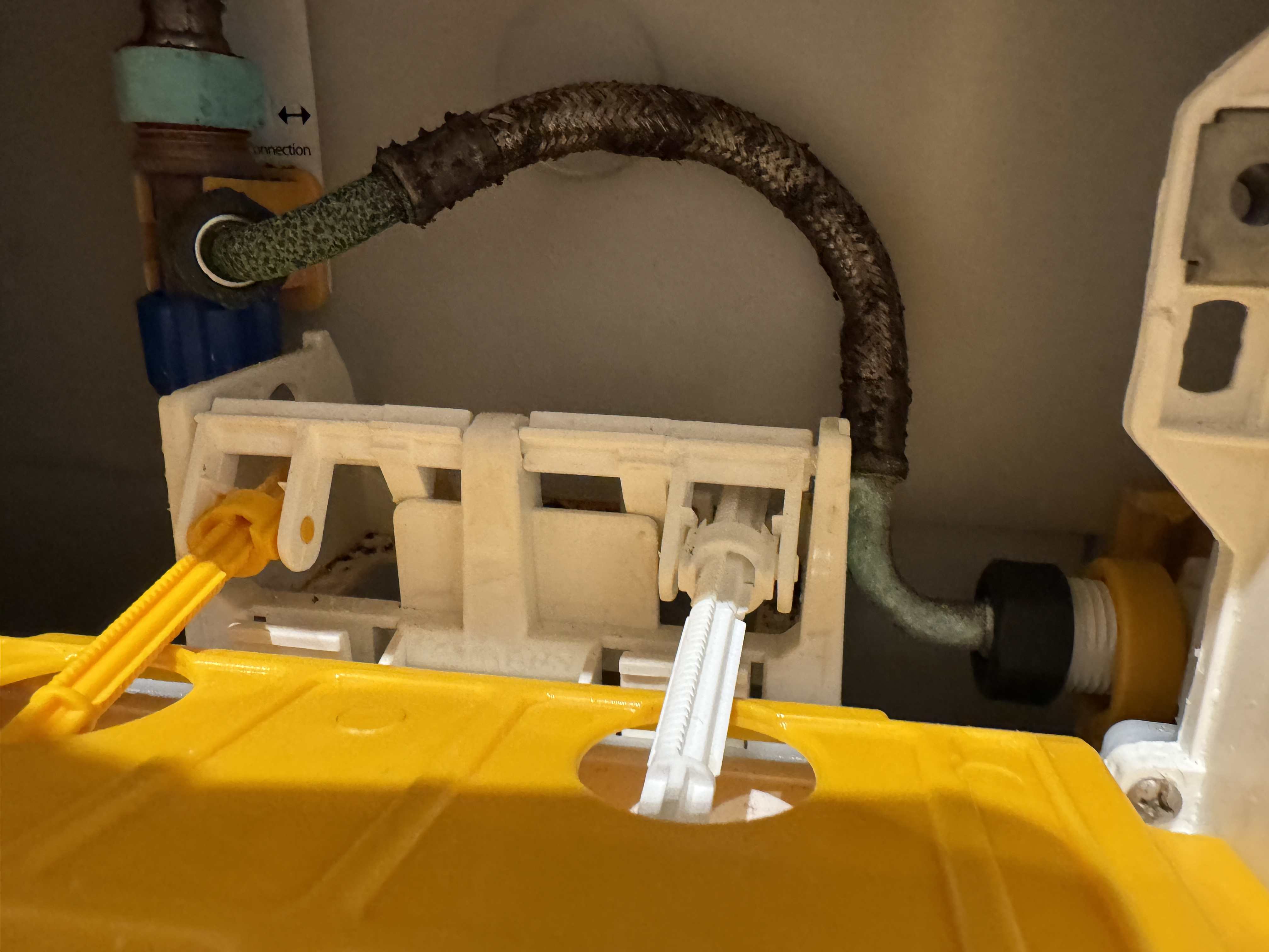

The main problem seems to be the ones inside the cisterns. They are not under water just at the top of the cistern. All concealed cisterns seem to use a similar connector.

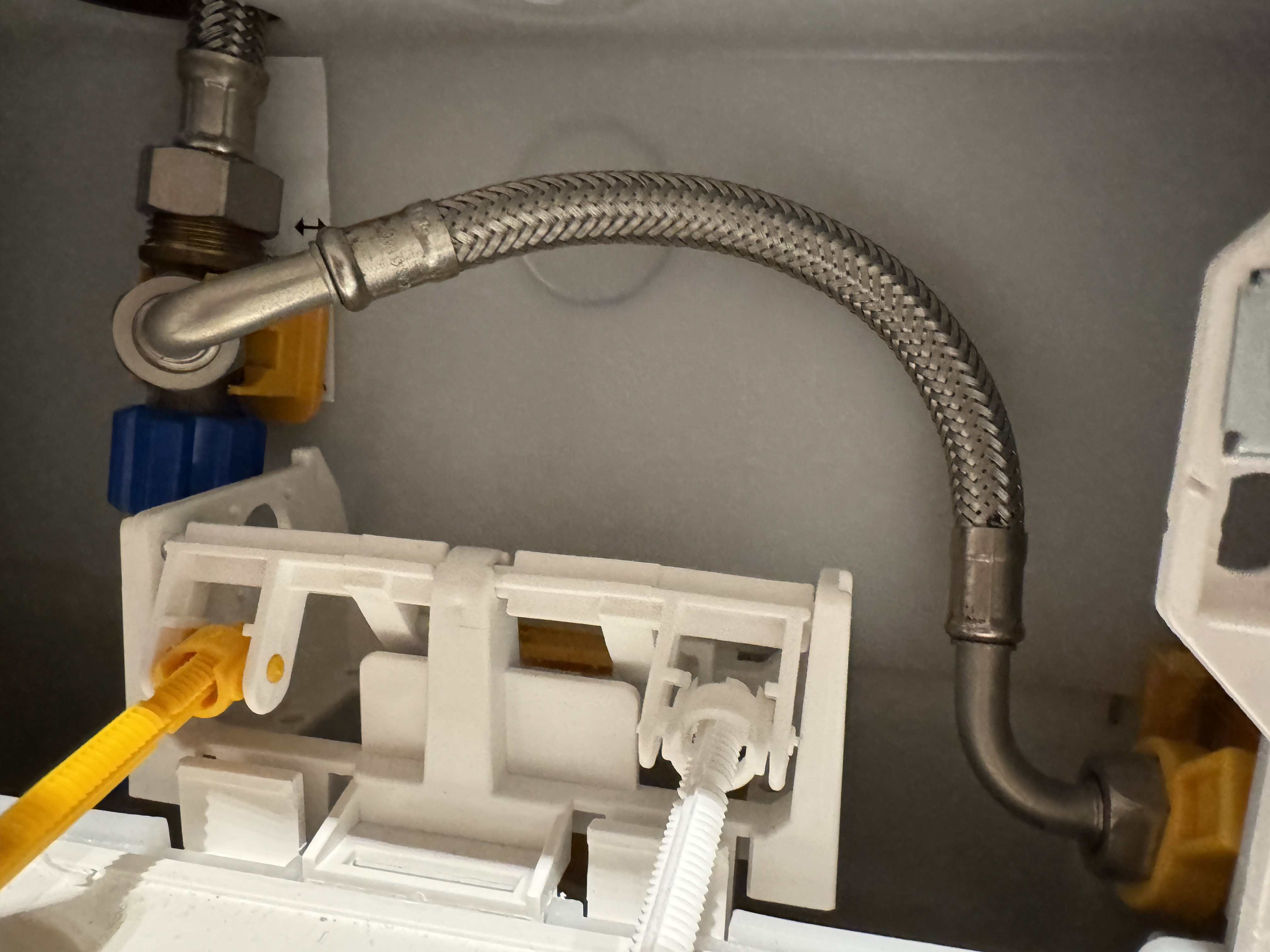

I just started to go and check the other bathrooms.
The first picture, the cistern is on an outside wall and the second one on an inside wall. I thought my theory that the outside wall spaces are cooler and water is more likely to condense on the pipes was proved.

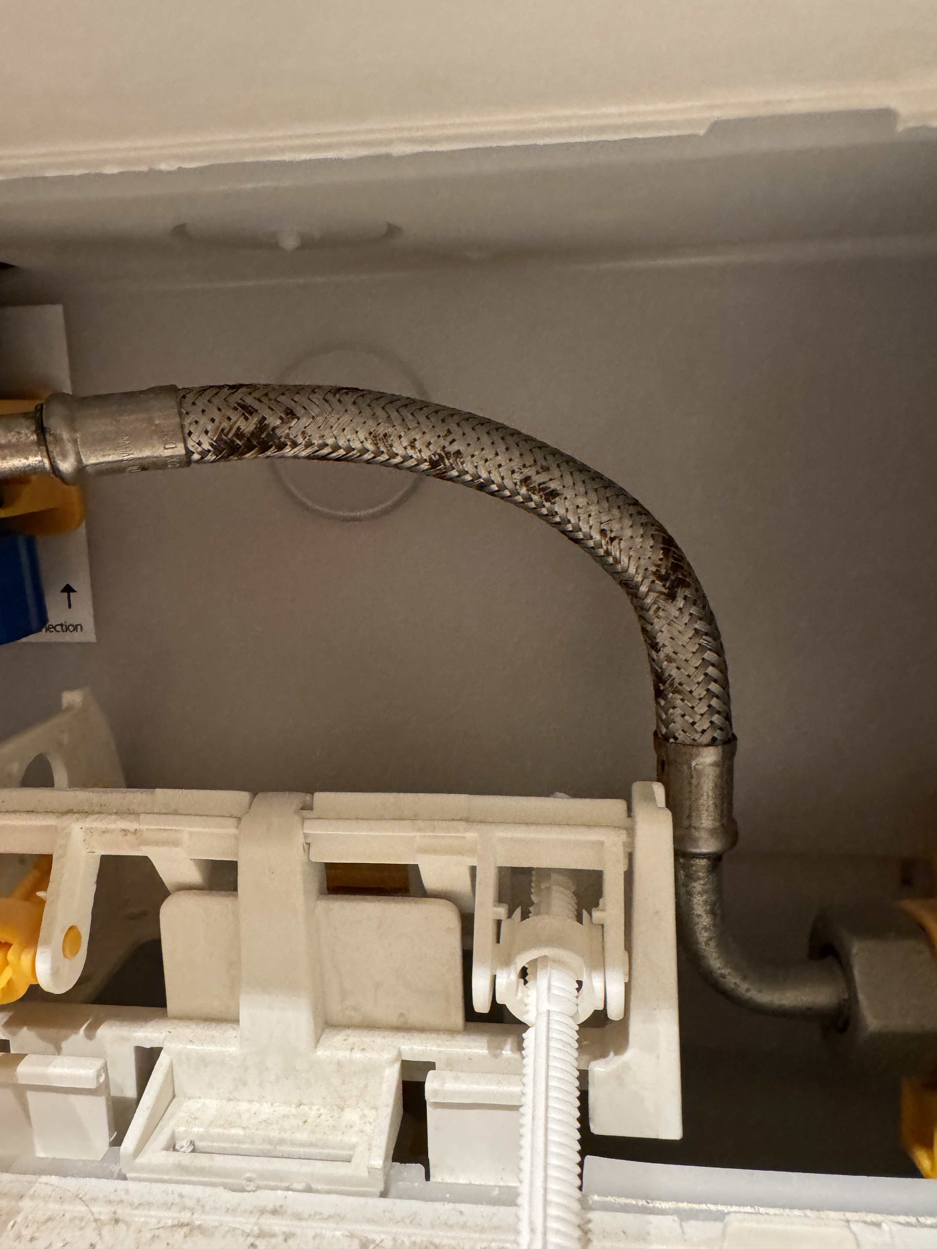

The third picture is a bathroom right next to the second one. Both on inside walls, both basically the same room and the mirror image of each other. The difference is dramatic and frankly hard to understand.
The third one will be getting replaced tomorrow.
Even though this seems crazy, the cleaner likes to use Toilet Duck, it only goes in the bowl, nowhere near the cistern. But the rooms with issues are the ones that are used more so get cleaned more often. Could it be that Toilet Duck left in the cistern is producing fumes that are damaging the pipework, or travelling a little bit back up the flush pipe. A pattern might be clearer once I have checked them all.
