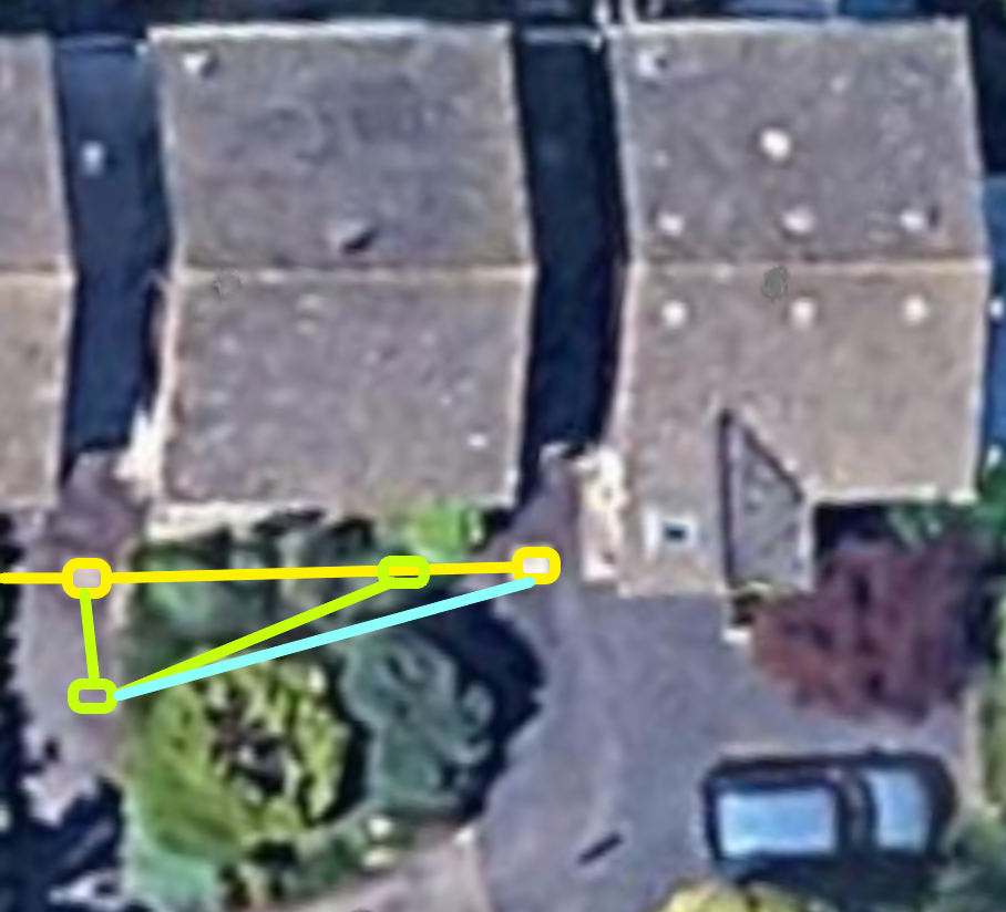

Gabriel the Toad Posted July 12 Posted July 12 Thanks for the continuing discussion - it's very interesting.Ā Ā This idea of the sewer diversion sounds great. But I understand the comment about needing "ICs" - inspection chambers? - at direction changes to mean a new manhole at each? That sounds expensive, so am wondering if the number can be reduced.Ā Ā I attach a Google maps image, showing my house (left) and neighbour (with the same extension that I want, already built!) on right.Ā Ā The yellow line represents the existing sewer, which starts at a manhole on my neighbour's drive, and flows right to left to a manhole on mine, then beyond.Ā Ā The green line is an idea for the diversion which would require just two new manholes (and modifications to my existing one too I guess). Ā Is that acceptable or are the changes in direction too sharp, are there any regulations about that?Ā Ā The blue line option would remove the need for another, but would require cooperation from my neighbour, and I'm not sure if it offers any real advantages.Ā Ā The flow down the sewer from next door must be fairly minimal - it only serves a downstairs WC and basin - would this, combined with the additional bends, make blockages any more likely?Ā Ā Can anyone make a rough guess at what such a sewer-diversion project might cost?Ā Ā Ā Ā
saveasteading Posted July 12 Posted July 12 21 minutes ago, Gabriel the Toad said: rough guess The big detour would cost more. ICs are plastic and about £150, plus concrete, gravel and labour. Needed whatever you do. Another matter is the gradient. Assuming that the drain was designed efficiently, by taking it a longer route you are flattening the slope and it might not work.  Say £1,000 diy. Double or Treble that for a good contractor. Add fees for the licence but building control will cover that with the building work.  I'd still be digging to find that pipe. But first feasibility on budget and permissions. 2
Nickfromwales Posted July 12 Posted July 12 6 hours ago, saveasteading said: Assuming that the drain was designed efficiently, by taking it a longer route you are flattening the slope and it might not work. I very much doubt that will be an issue here at all, and I'd say go with the green option and stay off your neighbours property / asset. Ā Perfectly simple and a 'good' solution, so KISS. 1
Gabriel the Toad Posted July 28 Posted July 28 I've started talking to a few builders now, and one to-day was initially very keen on moving the sewer.Ā Ā But then when he saw it was shared with the neighbours' houses (it runs along the front of a row of four houses, of which mine is the second, serving all of them) he went right off the idea, saying it wouldn't be possible to move it.Ā Ā Is that the case? Am waiting to see what the other builders say now...Ā
