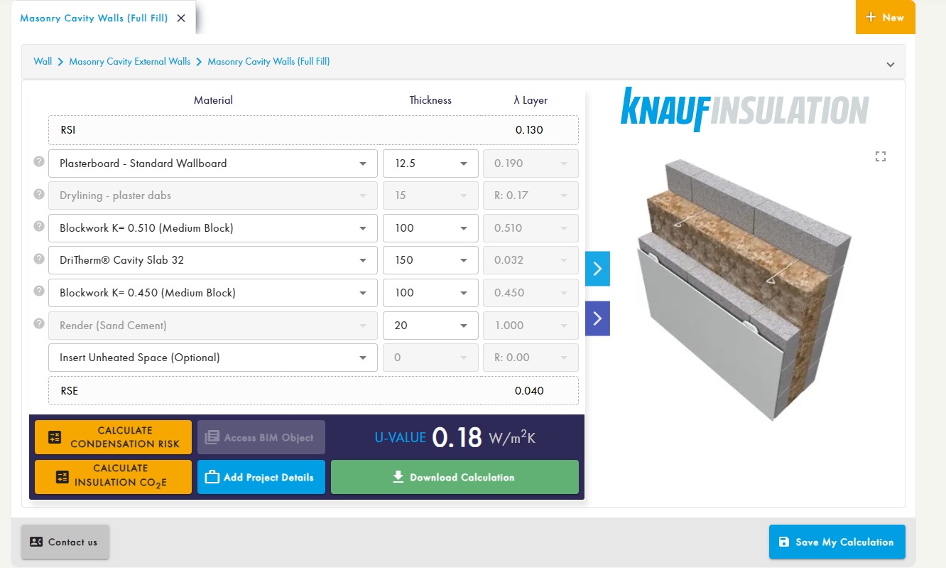

I have put the numbers into the knauf calc and I end up at 0.19.  The other issue is that I am using timber clad and not render.
Change that to medium blocks inside and outside and you get to 0.18. That's a nice calculator actually by Knauf. It is fairly optimistic with the values it's allowing for the airspace behind the plasterboard though but it'll get you through regs which I'm getting the impression is the aim.
Hemelite blocks are a small bit cheaper too.
Superglass is a bit cheaper again than Knauf.
£51.37 inc VAT per m2 for the blocks and insulation.

Posted
Thanks @Iceverge!  That is perfect and you have listed suitable materials that come in cheaper than my estimators quote too 🙂  If we had a bigger budget then I'd look to improve the U value further, but if I don't keep costs down, we'll have to sell when we have finished the build.

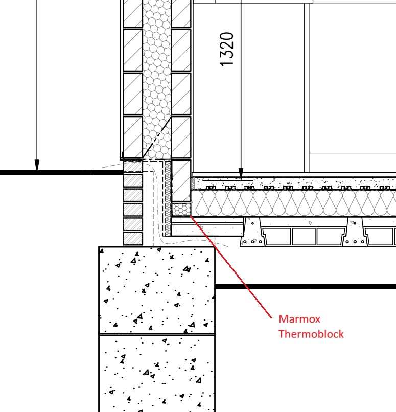

Posted
6 hours ago, MikeGrahamT21 said:
If you are wanting to go high performance, something like Marmox Thermoblocks can be used at the wall/floor level to prevent thermal bridging, much better than aircrete, but for the rest of the construction go with dense blocks, they're robust, don't crack easily, no silly rules for wet plastering, and also keep the temperature balanced out over the year (thermal mass! yes i said it!)
That's exactly what I have planned for my build.  I also have a couple of dense block internal walls which will sit on Thermoblocks.  One of these will be built from blocks laid flat, so it will be 220mm thick & will have 220mm Thermoblocks beneath.  The idea is, if there's any money left, I can hang a floating staircase from this wall.  & I'll have super THERMAL MASS - there, I said it too.  Now we'll both be in trouble when @SteamyTea reads this thread.
Here's my detail.  Yes, I know my Arch Tec has drawn the air brick at the same level as my patio, with virtually no insulation below DPC level & the periscope sitting in the middle of the cavity instead of up against the outer leaf.  I have already told him off.  He really is rubbish. & I engaged him in May, & I'm still waiting for my second draft drawings.

Posted
4 hours ago, Tony L said:
Here's my detail.
Good first go.
A few comments:
1/ Your cavity tray is only one course above finished ground. BC will and I will pull you up on that.
2/ The insulation shown as a triangle just below the cavity tray is unbuildable as detailed . You are concentrating on the technicalities rather than balancing this with what is buildable,  the cost and how you are going to make sure that what you are paying for actually happens on site. Don't blame yourself.. as unless you do this as a day job and have a feeling of build cost there is no way of you knowing this.
3/ You have a wide cavity. Why not thicken the perimeter insulation up to 100 or more thickness. Have a look at how MBC do an insulated raft slab and pinch their ideas. Then you can omit the Marmox block unless you want to spend money. You could be pragmatic and use the same money in a better way and in the round still achieve what you are looking to do.

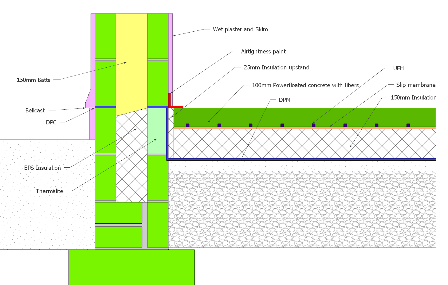

Posted (edited)
14 hours ago, flanagaj said:
I am interested in this.  If you are having a ground bearing slab, is it worth running a single course of insulated block either below DPC or above DPC.
What benefits does this provide?
Ran this through a few times in THERM when doing ours.
It is worth doing a layer of aircrete in line with your floor insulation. You also need to have continuous insulation outside it. They must be kept dry as they loose most of their insulative qualities otherwise . I would make sure the cavity extends at least 1 block below the Aircrete to make sure there is no water ponding there.
This detail would perform very well and is fairly cheap.
We filled the whole cavity with EPS beads (ok for use below DPC) so it was a simpler detail to construct.
