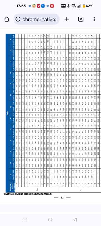

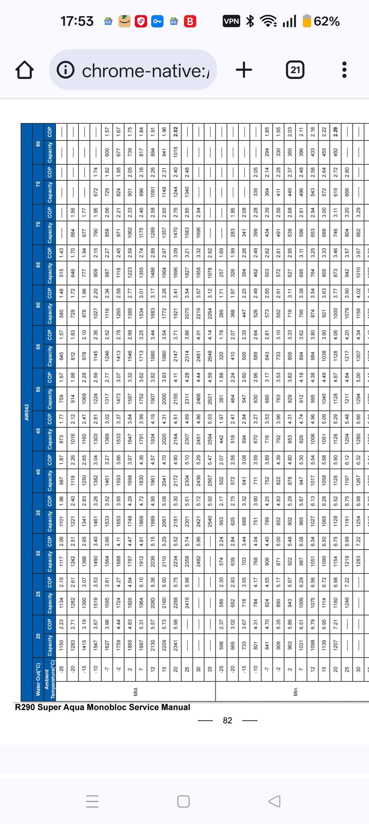

JohnMo Posted yesterday at 12:37 Posted yesterday at 12:37 15 minutes ago, PhilT said: Out of interest why are you doing this? I can't see how this would save any significant amounts of money given your bill was already very low. What about recovery times - how often do you get power cuts and for how long? Impact on hot water heating time? Impact on defrost recovery time, headroom for other unexpected issues etc? Couple of motivations. First just bought a hot tub, and want to heat by heat pump, so need a 6kW heat pump. Which I have and it's too big for our house, main due to poor modulation with output being about 4kW, again a heat demand of 3.5kW at -9. Due to cycling my overall SCoP is around 4. Even though when actually running the CoP is closer to 5 to 6. The new 4kW has a min modulation of 1kW at 12 degs, so will run continuously when needed, without any or very little cycling. Expect to see an uplift to a scop of 5. So a 20 to 25% reduction in the heating costs. Coming from less cycling and ability to run cooler flow temps, as a result of not having to compensate for cycling. Plus we need a heat source the hot tub, so a better heat pump for house covers both. Unexpected issues we have covered by log stove, power cuts have battery and if that runs flat, a generator, that can power whole house including heat pump. Have an immersion for DHW heating on really cold days, but heat pump can do 4kW at -10 at 36 degrees flow and we have a heat demand of about 3.5kW for the odd day at that level.

MikeSharp01 Posted 22 hours ago Posted 22 hours ago 5 hours ago, JohnMo said: The new 4kW has a min modulation of 1kW at 12 degs Which model is that?
JohnMo Posted 22 hours ago Posted 22 hours ago Hiaer R290 monobloc 4kW. Snip from the data book - even does 80 Deg flow if you ever needed it
