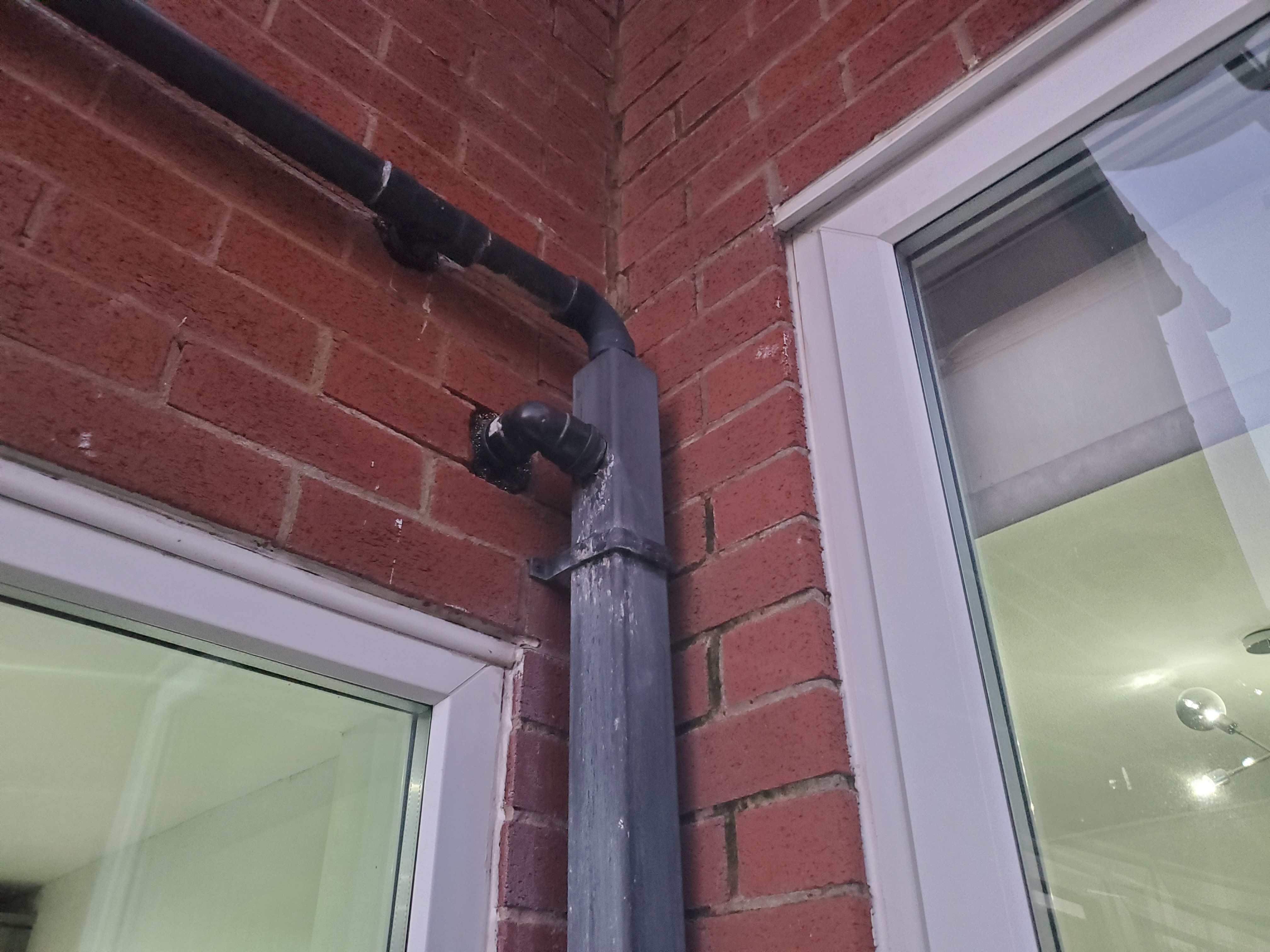

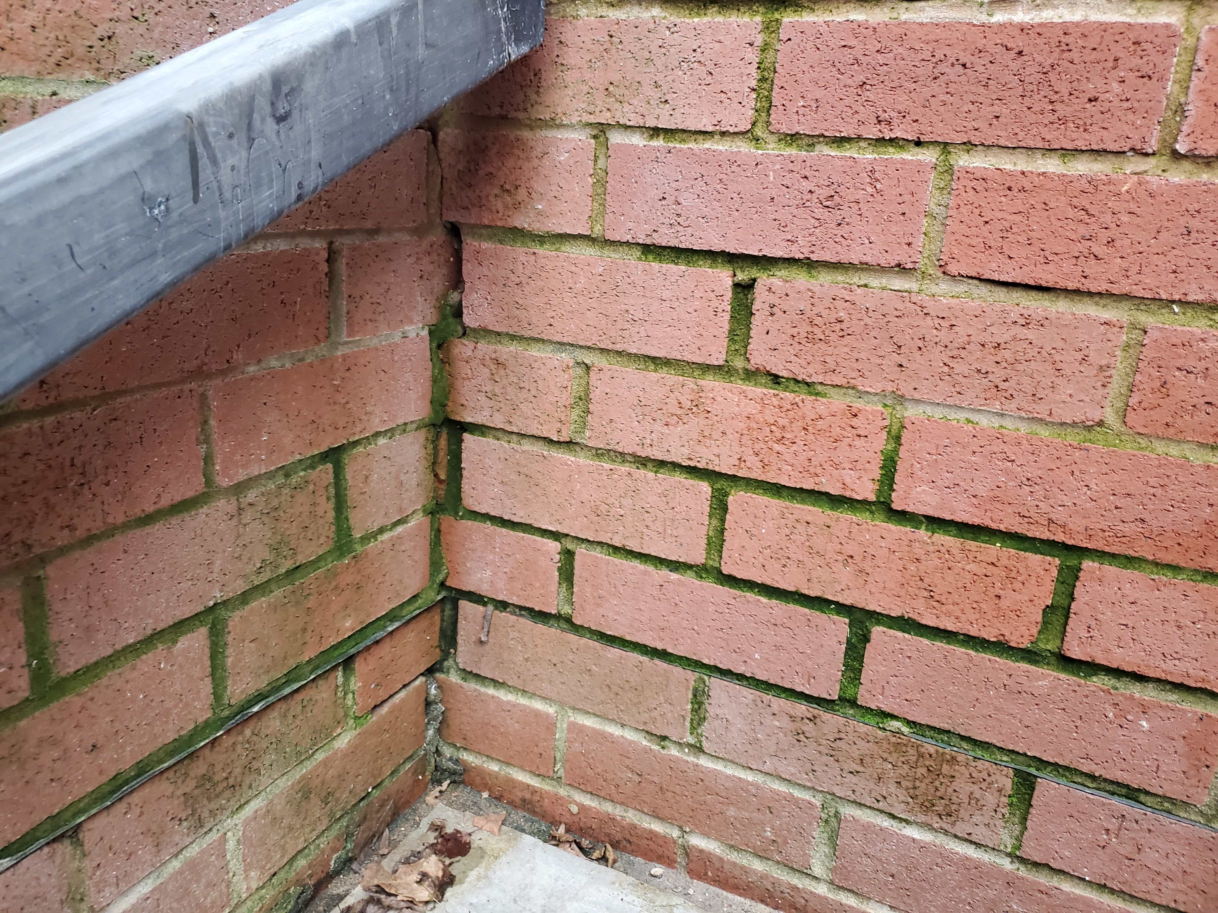

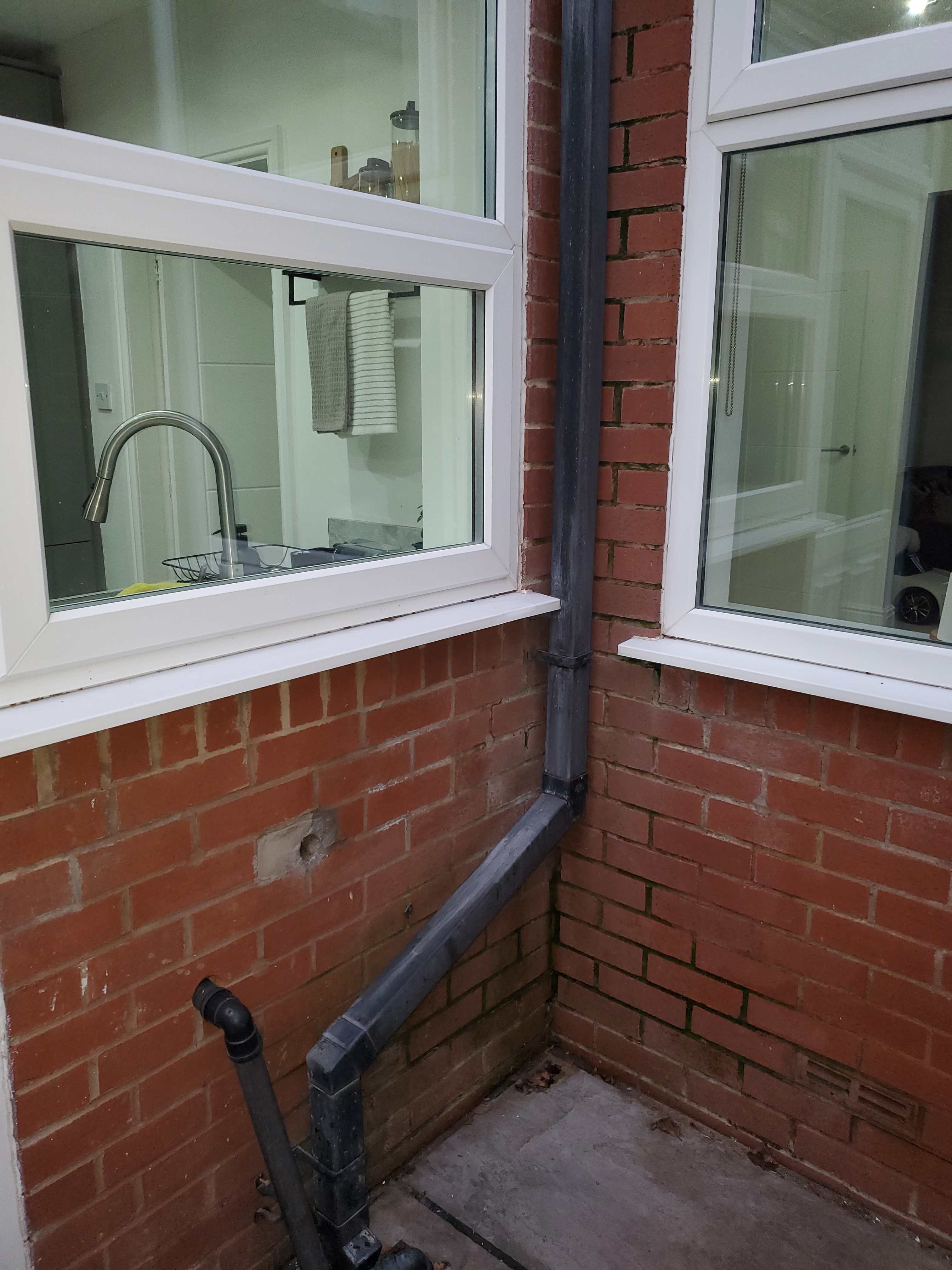

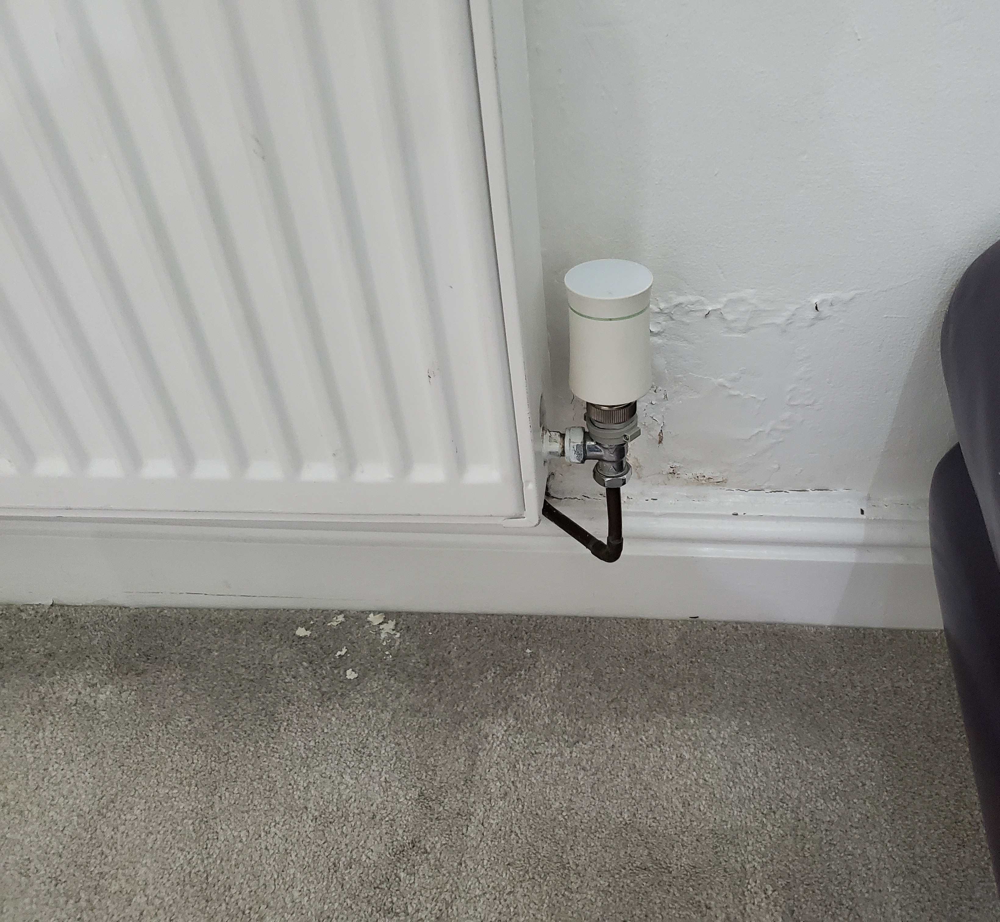

Pappa Posted 17 hours ago Posted 17 hours ago Hi guys. I've got a square patch of damp in my lounge that has just come about in the last month. Directly behind it is a brick wall that runs adjacent or away from this wall. Please note the paint peeling under the radiator. The external photo is directly behind this location. The DPC looks to be in good condition outside, although there is a rusty nail in the mortar line which has always been there. This brick wall was constructed in the last 20 years, before I bought the house. Relative humidity is consistently less than 60 percent in this room so I don't think it's condensation. Thanks in advance
Russell griffiths Posted 17 hours ago Posted 17 hours ago What’s that black plastic pipe. zoom the picture out. 1
saveasteading Posted 17 hours ago Posted 17 hours ago I think this is straight forward. see the green moss and algae on the wall? it is from water running from above. or simply rain hammering into that corner and not running off. also there appear to be gaps in the mortar. it is above the dpc and getting through to the inside where exactly is the internal dampness in comparison to this external photo? id have the wall cleaned and repointed. Plus check for water running out of gutters or flashings. You need to stand in the rain to se this properly. You may need to clean out or repair a gutter. 1
saveasteading Posted 17 hours ago Posted 17 hours ago the photo is helpful. I suspect a leak from the lower downpipe joints. Notice how the green is spreading out from that. 2
Pappa Posted 17 hours ago Author Posted 17 hours ago Thanks I thought so too The square patch on the interior is at the external corner or inside the external corner. The paint peels on the floor from behind the radiator correlates to the external picture approximately half way between the vent and the adjacent brick wall
Russell griffiths Posted 17 hours ago Posted 17 hours ago 16 minutes ago, Pappa said: Rainwater pipe from roof. That’s your problem fix that and let the wall dry out, then re point it in the spring. 1
Nickfromwales Posted 17 hours ago Posted 17 hours ago Driving rain is pissing in through all the missing pointing. Leave until after April and then sort it. Is the down pipe blocked or do you have any leaking joints? If so fix that immediately. 1
Marvin Posted 16 hours ago Posted 16 hours ago And fill the old waste pipe hole before you get rats! And around the new waste pipe And any other hole that vermin can enter. 1
saveasteading Posted 16 hours ago Posted 16 hours ago I'd scrape the loose paint off to help it dry inwards and also to monitor it. You might find the the plaster beneath shows dampness, and I would mark that in pencil and be delighted to notice that it isn't spreading and may be reducing. Will you be doing diy ? Anyway you can brush off the green stuff now, as that is holding water. this is one of those queries where we can all feel good at sorting an issue so please repot back for better or worse. 1
Pappa Posted 9 hours ago Author Posted 9 hours ago Thanks guys. Would you advise doing the pointing before spring if there is X days / hours of dry weather forecasted? How many hours/days would you recommend? How much mortar do I need to rake out and refill? If you could point me in the direction of a useful guide or video that highlights best practice that would be appreciated. Thanks again
Russell griffiths Posted 1 hour ago Posted 1 hour ago 8 hours ago, Pappa said: Thanks guys. Would you advise doing the pointing before spring if there is X days / hours of dry weather forecasted? How many hours/days would you recommend? How much mortar do I need to rake out and refill? If you could point me in the direction of a useful guide or video that highlights best practice that would be appreciated. Thanks again You need to consider the temperature for pointing, needs to be 5 degrees and rising for the duration that it will take to dry. fix the problem of water hitting the wall first and the pointing can be done in April.
saveasteading Posted 1 hour ago Posted 1 hour ago You might simply be able to push up the elbow to stop the leak. I'd repair the bigger holes ASAP. A pointing tool is a good investment and disguises my amateur work.
