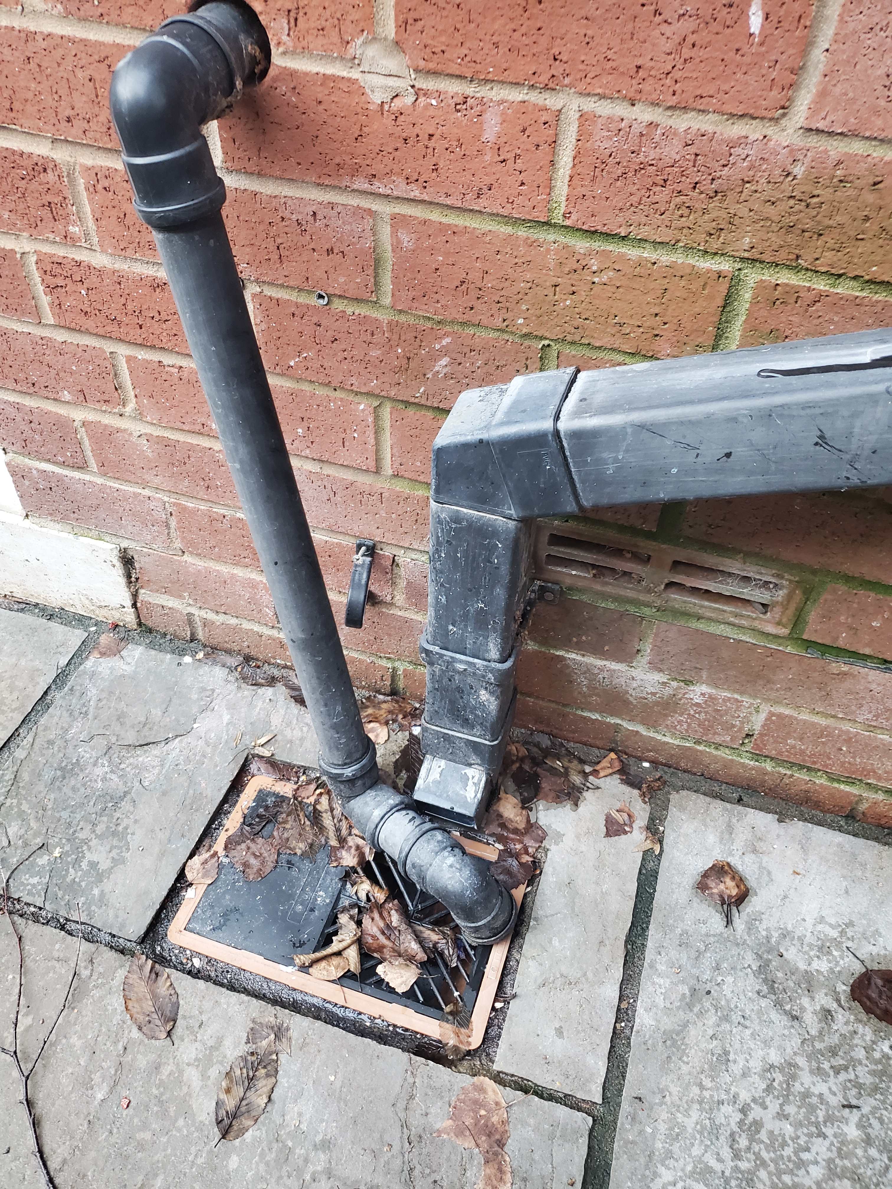

I will CT1 the botched junction to make a tight seal.
Horizontal pipes have the proper angle, so does the floor.
The attached photo is what is causing leaves to wash up in to the corner. It's not aimed directly into the drain.
How do I remedy this?

Thanks guys
The leaves aren't that problematic.
It's the fact that the pipes don't drain fully into the hole.
Some of the water is splashing onto the slabs, in turn that is what is washing the trivial number of leaves into the damp external corner.
I'm wondering if the round pipe on the left (from kitchen basin) should go directly into the square pipe coming from upstairs bathroom/washing machine.
I would then need to manipulate the square pipe so it exits directly into the drain as opposed to some of the waste flowing onto the slabs.
Thanks again

Understood. The square shoe isn't quite long enough and the round pipe misses slightly.
If you can rotate the round one at any of the joints to be over the grille, that should sort it.
For the square you need the tiniest length of pipe.
Temporarily cut a detergent bottle to make a channel and slide it under,  but leave the bottom on to make it flow the right way onto the grille.

Thanks.
The round one doesn't quite bend to fit in the grill as things are.
I can chop and change to make it fit, however I'm wondering if I should just drill a circular hole at the top of the square pipe to put the round pipe in to or would that be deemed a cowboy job?
I want to do a proper job first time so it's done for good.
Cheers.
it would be consistent with what is there already, but not really proper. It would be quite easy to redirect the round pipe to the grille with use of a hacksaw and a new connecting piece.
Many thanks.
I'll try to do it properly first time round.
Should I be cutting into the grill so that the pipes definitively exit into the drain and not onto the slabs?

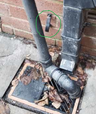

I note there is a pipe clip (circled green below) on the wall for that round waste pipe. If you put the round pipe back in the clip does the end of the pipe end up over the grill again? If so, there is your solution. If not, then you need to replace the bends at the bottom of the pipe . Shouldn't need to cut the grill, but it wont do any harm if you do.
