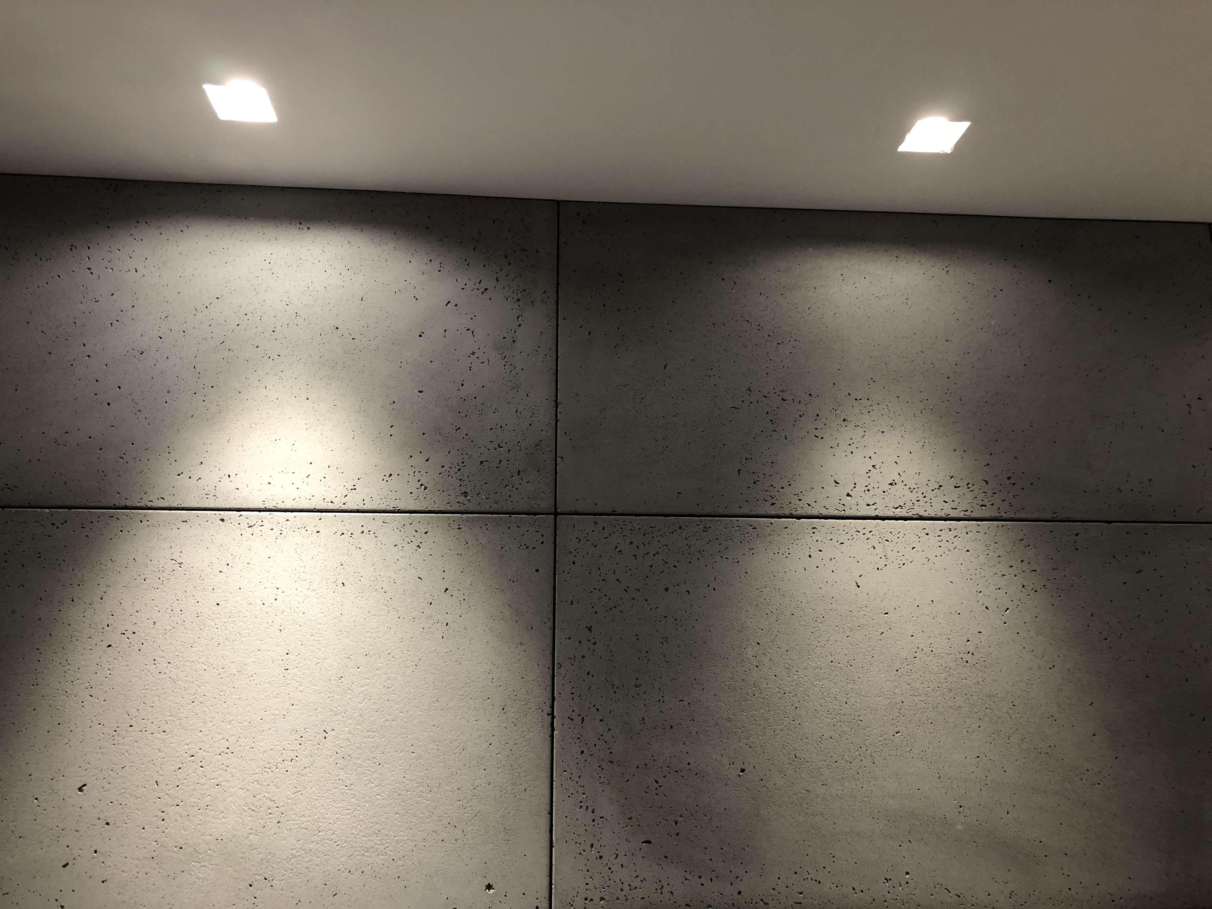

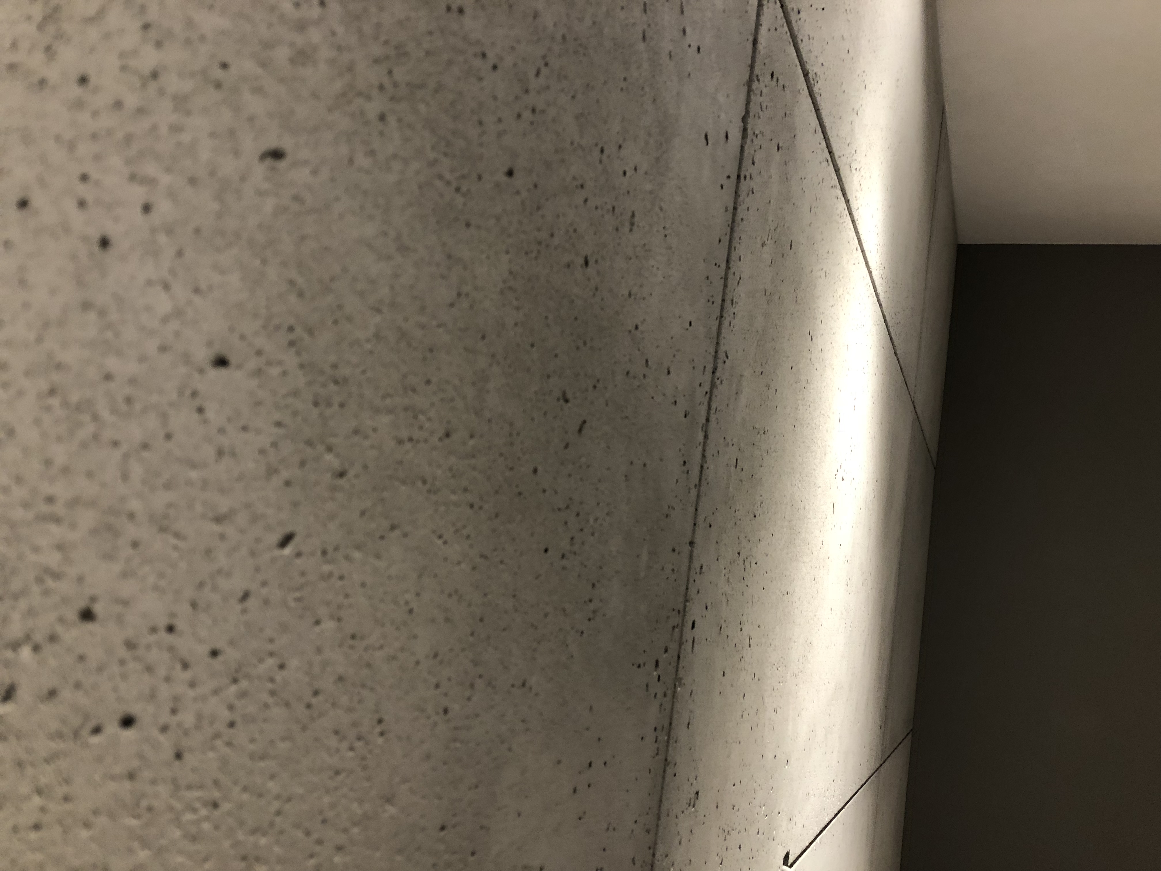

Trw144 Posted January 20, 2018 Share Posted January 20, 2018 This is above my bed - we used large format concrete tiles. I would take a better picture but I m still in my bed! 1 Link to comment Share on other sites More sharing options...
Tom Posted January 20, 2018 Author Share Posted January 20, 2018 Best place to be at this hour. I'm working nights so I plan to be horizontal in approximately 1.5 hours. Can I ask what your wall structure is and how the tiles are fixed to it? Link to comment Share on other sites More sharing options...
Russell griffiths Posted January 20, 2018 Share Posted January 20, 2018 As far as other finishes are concerned you can have any finish you want ,the icf is just the structure just like timber frame you can fix plasterboard on battens, tile, timber boards,timber sheets, have a look at a website called Houzz thousands of ideas. Link to comment Share on other sites More sharing options...
Trw144 Posted January 20, 2018 Share Posted January 20, 2018 41 minutes ago, Tom said: Best place to be at this hour. I'm working nights so I plan to be horizontal in approximately 1.5 hours. Can I ask what your wall structure is and how the tiles are fixed to it? Its a timber frame construction, with tile board (wedi board) fixed to the battens, and then these concrete tiles fixed using tile adhesive. Here s a slightly better pic 1 Link to comment Share on other sites More sharing options...

Trw144 Posted January 20, 2018 Share Posted January 20, 2018 These people are who we sourced our panels from - they do some nice bits... http://www.3dartfactory.co.uk/decorative-concrete-2/ 1 1 Link to comment Share on other sites More sharing options...
Tom Posted January 20, 2018 Author Share Posted January 20, 2018 Really liking those tiles TRW, definitely one for the mood board. Thanks for the link too. Luckylad - with regards services I was thinking metal clad boxes and surface-mounted trunking to fit with the industrial look. Likewise leaving it unpainted. Perhaps more scope with different cladding for the internal partitions rather than having to find a way around fitting to the ICF? Link to comment Share on other sites More sharing options...

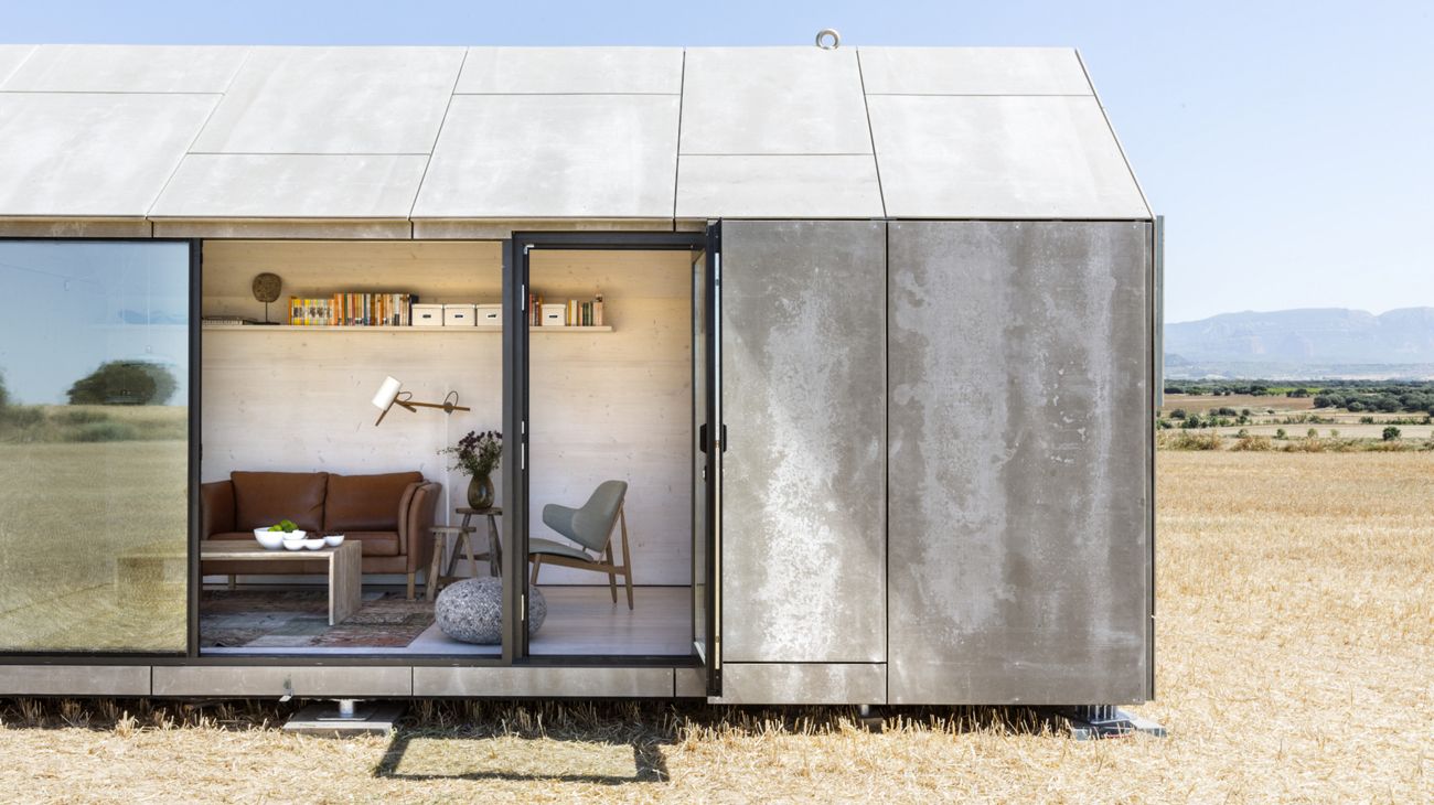

bissoejosh Posted January 29, 2018 Share Posted January 29, 2018 We're hoping to have some concrete effect finishes inside, in particular on a 3/4 height wall separating our kitchen / dining from our lounge. I've seen the wall panels/tiles mentioned above but recently I've spotted another potential option which others might be interested in. The picture below is of a portable building (made in Spain by Abaton, and v.nice in my opinion) but it was the external finish which grabbed my attention - according to the documentation it is 'grey cement wood board' Looks like pre cast concrete from a distance at least and might be a lightweight option for wall decoration etc. I've not really seen anything similar in the UK but perhaps others have... 1 Link to comment Share on other sites More sharing options...
jack Posted January 29, 2018 Share Posted January 29, 2018 I'd consider buying a piece of cement board and experimenting with distressing it, including spraying/splashing parts of it with water, tinted washes, chemicals (particularly acids), or whatever. Try sealing the result with matt/gloss lacquers to see how that changes things. We had a couple of big offcuts lying around outside for several months and they developed an interesting patina! Link to comment Share on other sites More sharing options...
jack Posted January 29, 2018 Share Posted January 29, 2018 2 hours ago, bissoejosh said: The picture below is of a portable building (made in Spain by Abaton, and v.nice in my opinion) but it was the external finish which grabbed my attention - according to the documentation it is 'grey cement wood board' Looks like pre cast concrete from a distance at least and might be a lightweight option for wall decoration etc. I've not really seen anything similar in the UK but perhaps others have... I think this is just what we'd call "cement board", which is wood fibres in a cementitious binder. The stuff we left outside developed a similar patina over several months. Link to comment Share on other sites More sharing options...
bissoejosh Posted January 30, 2018 Share Posted January 30, 2018 On 1/29/2018 at 13:08, jack said: I think this is just what we'd call "cement board", which is wood fibres in a cementitious binder. The stuff we left outside developed a similar patina over several months. I think you're right, Versapanel looks like a very similar concept 1 Link to comment Share on other sites More sharing options...
