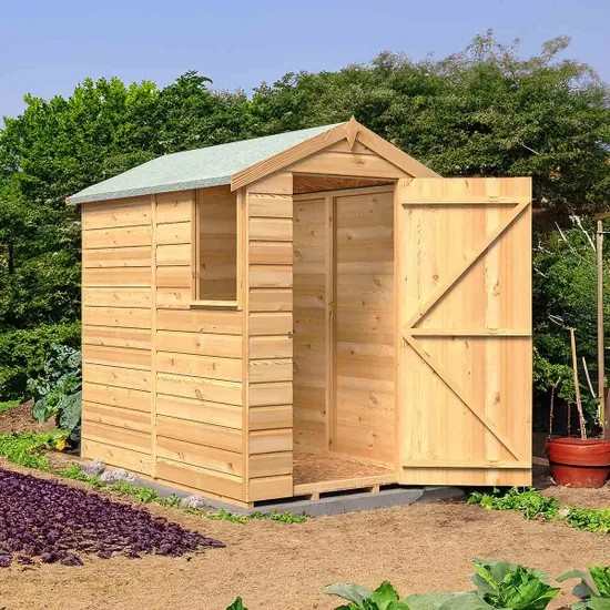

flanagaj Posted Sunday at 19:10 Posted Sunday at 19:10 I am planning on having a shed, like the one below outside the entrance of our static caravan. It will house the washing machine and tumble drier and enable me to change out of dirty clothes before going into the static. My concern is how best to insulate it as I'm concerned about pipes freezing?
Conor Posted Sunday at 19:30 Posted Sunday at 19:30 Something like 50mm eps glued to the inside would probably be enough. And lag the pipes. 1
-rick- Posted Sunday at 19:39 Posted Sunday at 19:39 You'll have electric in there so can put a tiny thermostatic tubular heater in there on a low setting keep as insurance for the really cold days (wont be enough without the insulation though). 1
flanagaj Posted Sunday at 19:55 Author Posted Sunday at 19:55 23 minutes ago, Conor said: Something like 50mm eps glued to the inside would probably be enough. And lag the pipes. Do I need to use a vapour barrier and if so, is it installed on top of the insulation or between the word and insulation?
JohnMo Posted Sunday at 20:44 Posted Sunday at 20:44 I would add vapour barrier, to the inside. To keep room moisture away from insulation and the wood. 1
Redbeard Posted Sunday at 20:45 Posted Sunday at 20:45 On top of (always on the 'warm side'). Whether you need one or not is a moot point. Remember to insulate on all 6 'sides'. If it were me I would insulate over the floor too then glue some 9, 12 or 18mm ply/OSB over. Why try to avoid heat loss throughout and leave a 'hole' in the floor?! Consider the solidity of what you use for the floor insulation. You don't want a washing machine on fast spin to go 'walking'. TBH I would not be starting from where you are - I'd be building a post-and-beam shed 'bespoke', but I am aware you have a lot of things to do just now. 1
flanagaj Posted Sunday at 23:08 Author Posted Sunday at 23:08 2 hours ago, Redbeard said: On top of (always on the 'warm side'). Whether you need one or not is a moot point. Remember to insulate on all 6 'sides'. If it were me I would insulate over the floor too then glue some 9, 12 or 18mm ply/OSB over. Why try to avoid heat loss throughout and leave a 'hole' in the floor?! Consider the solidity of what you use for the floor insulation. You don't want a washing machine on fast spin to go 'walking'. TBH I would not be starting from where you are - I'd be building a post-and-beam shed 'bespoke', but I am aware you have a lot of things to do just now. We've got until the end of the month before we've got to be in the static. Sods law that it's set to rain for the next two weeks.
sgt_woulds Posted 17 hours ago Posted 17 hours ago We used one of those plastic ketter maxi stores for our laundry room. We could just fit both machines side by side with 70mm of insulation glued on all round (inc doors + 100mm on the floor with 12mm OSB over) with a tubular heater (at the back near the incoming water pipes) to deal with frost. I also injected spray foam into every cavity and crevise. I didn't bother with a vcl as the whole set up was impossible to make airtight (plus we popped the top up when the machines were running), but for your shed I would ali-tape the PIR board joints to keep moisture away from he wood. Our 'temporary' solution was used for 4 years... Biggest issue was with the supply and drainage outside the shed; even with heavy lagging, the drainage pipe could freeze up, so I wired in a 12v pizza heating wire under the pipe insulation. Everything inside was fine, but the bottom of the machines got a bit rusty, so an extract fan is probably more important than keeping the heat in. I got both machines, and all of the insulation free from the side of the road. Total cost was £199 for the shed and £6 for a replacement bearing get the tumble drier working, and £10 for the tubular heater heater. 🙂 1
SteamyTea Posted 14 hours ago Posted 14 hours ago Realistically how often do pipes freeze in Hampshire? As this is a temporary building, just cover the walls with mineral wool and, as @JohnMo suggests, a VLC on the inside. If it gets really cold, a ten quid, 400W electric fan heater from eBay. 1
