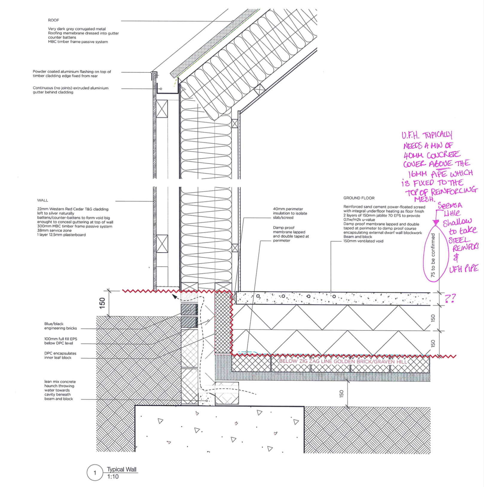

Visti Posted January 12, 2018 Share Posted January 12, 2018 How thick of a screed layer did you install to fit the UFH? We've planned for 75mm but have been warned that this may be insufficient by MBC. So are considering an increase to 100mm. Current composition (above EPS) is: up to 24mm reinforcing mesh (2x12mm diameter steel) 16mm UFH piping 35mm concrete cover Key question is whether the 35mm is enough? and what margins of error should we accept? ~/-5mm? Link to comment Share on other sites More sharing options...

Visti Posted January 12, 2018 Author Share Posted January 12, 2018 It is indeed Peter, though it's a suspended Beam & Block rather than a slab. Composition below. I should note that the power-floated screed will be the finished floor. Nothing is going on top of that. Quote Ground Floor: - Reinforced Sand-Cement power-floated screed with integral underfloor heating as floor finish. - 2 layers of 150mm jablite 70 EPS @ 0.11w/m2k - DPM lapped & double taped @ perimiter - Beam & Block - 150mm ventilated void Link to comment Share on other sites More sharing options...
Ian Posted January 12, 2018 Share Posted January 12, 2018 @Visti A couple of points: - in the situation you’ve described s/c screed is normally a minimum depth of 50mm so you’d need that much over the top of the pipes. - check that the beams of your beam & block floor aren’t pre-cambered. If they are then this will affect your set-out and screed thickness calculations. - you’ve said that you’ll be power floating the sand cement screed but I didn’t know you could do this. I’ve only ever seen concrete floors being power floated. Link to comment Share on other sites More sharing options...
Ian Posted January 12, 2018 Share Posted January 12, 2018 (edited) 2 hours ago, Visti said: Current composition (above EPS) is: up to 24mm reinforcing mesh (2x12mm diameter steel) 16mm UFH piping 35mm concrete cover Key question is whether the 35mm is enough? and what margins of error should we accept? ~/-5mm? You’ve forgotten that the rebar will need to be held off the top of your EPS layer on small plastic or concrete spacers Edited January 12, 2018 by Ian Link to comment Share on other sites More sharing options...
PeterW Posted January 12, 2018 Share Posted January 12, 2018 So.... I would ditch the EPS and go 150mm of PIR which gives you 0.1 on the uValue. Then it’s 100mm of concrete on top - Agila or similar flowing / self compacting and that gives you 35mm chairs for the mesh, 16mm pipes and 50mm over. Quick and cheap. Link to comment Share on other sites More sharing options...
AliG Posted January 12, 2018 Share Posted January 12, 2018 (edited) Generally for liquid screed the minimum coverage of UFH pipes is 40-50mm so you are looking at a minimum depth of around 60mm screed, some people will say 55, some say 65. For sand cement you are looking at around 75mm minimum depth. However this is an unusual floor build up, why is the screed reinforced? The beam and block floor should be load bearing. Are there load bearing interior walls sitting on the screed with the insulation below them rather than all the way down to the beam and block? Otherwise I do not see why it would be reinforced. I must admit I am not sure the thickness of the screed once it is reinforced, but I could imagine it being nearer 100mm. If so I would just make theEPS thinner. The lost insulation value would be negligible. PIR will be much more expensive. I can't imagine that they have reinforced the screed for no reason as obviously a thinner screed and no rebar would be a lot cheaper. Edited January 12, 2018 by AliG Link to comment Share on other sites More sharing options...
Visti Posted January 12, 2018 Author Share Posted January 12, 2018 6 hours ago, AliG said: However this is an unusual floor build up, why is the screed reinforced? The beam and block floor should be load bearing. Are there load bearing interior walls sitting on the screed with the insulation below them rather than all the way down to the beam and block? Otherwise I do not see why it would be reinforced. The reason is exactly what you suspected; we have internal lead bearing walls that'll be resting on the screed. 9 hours ago, Ian said: - check that the beams of your beam & block floor aren’t pre-cambered. If they are then this will affect your set-out and screed thickness calculations. That's a good point and not one I'd known/considered. I'll ensure to bring it up with the engineer! 7 hours ago, PeterW said: So.... I would ditch the EPS and go 150mm of PIR which gives you 0.1 on the uValue. Then it’s 100mm of concrete on top - Agila or similar flowing / self compacting and that gives you 35mm chairs for the mesh, 16mm pipes and 50mm over. Quick and cheap. The best PIR I can find is Kingspans Kooltherm K103, which is at 0.018 W/mK. That's a u-value of 0.12 @ 150mm for £43/m2 (2x75mm) Two layers of 150mm Jablite EPS at 0.035 W/mK gives an equivalent u-value of 0.117 but for only £19/m2. As we're not struggera 150mm, we'll stick with the EPS. Also, there also appears o be a nationwide PI0mmR shortage. Anyone clued up on that?! I think we'll be going with 100mm thickness overall. To be safe and account for the spacers too. That'll give us 5-10mm of 'headroom'. Link to comment Share on other sites More sharing options...

Oz07 Posted January 13, 2018 Share Posted January 13, 2018 9 hours ago, Visti said: The reason is exactly what you suspected; we have internal lead bearing walls that'll be resting on the screed. That's a good point and not one I'd known/considered. I'll ensure to bring it up with the engineer! The best PIR I can find is Kingspans Kooltherm K103, which is at 0.018 W/mK. That's a u-value of 0.12 @ 150mm for £43/m2 (2x75mm) Two layers of 150mm Jablite EPS at 0.035 W/mK gives an equivalent u-value of 0.117 but for only £19/m2. As we're not struggera 150mm, we'll stick with the EPS. Also, there also appears o be a nationwide PI0mmR shortage. Anyone clued up on that?! I think we'll be going with 100mm thickness overall. To be safe and account for the spacers too. That'll give us 5-10mm of 'headroom'. Big fire in European factory apparently. Strange how there's a massive shortage but they've got as much as you want if you pay more! Suppose it's economics Link to comment Share on other sites More sharing options...

RandAbuild Posted January 23, 2018 Share Posted January 23, 2018 Our floor is a min 70mm structural (no mesh) concrete screed laid quite wet, so it finds it's own level, and with UFH pipework. This is over 100mm EPS on top of a Hanson Jetfloor (beam & insulated block). The screed is perfect for laying tiles or engineered wood and has a lower mass than 100mm concrete would, so the UFH is more responsive. I'm not keen on polished concrete for all the reasons above. Keep it simple and minimise risk. With less than 40mm cover above the pipework, there's a danger some of it springs up above the finished level of the concrete, which you definitely don't want if you're powerfloating! Link to comment Share on other sites More sharing options...
