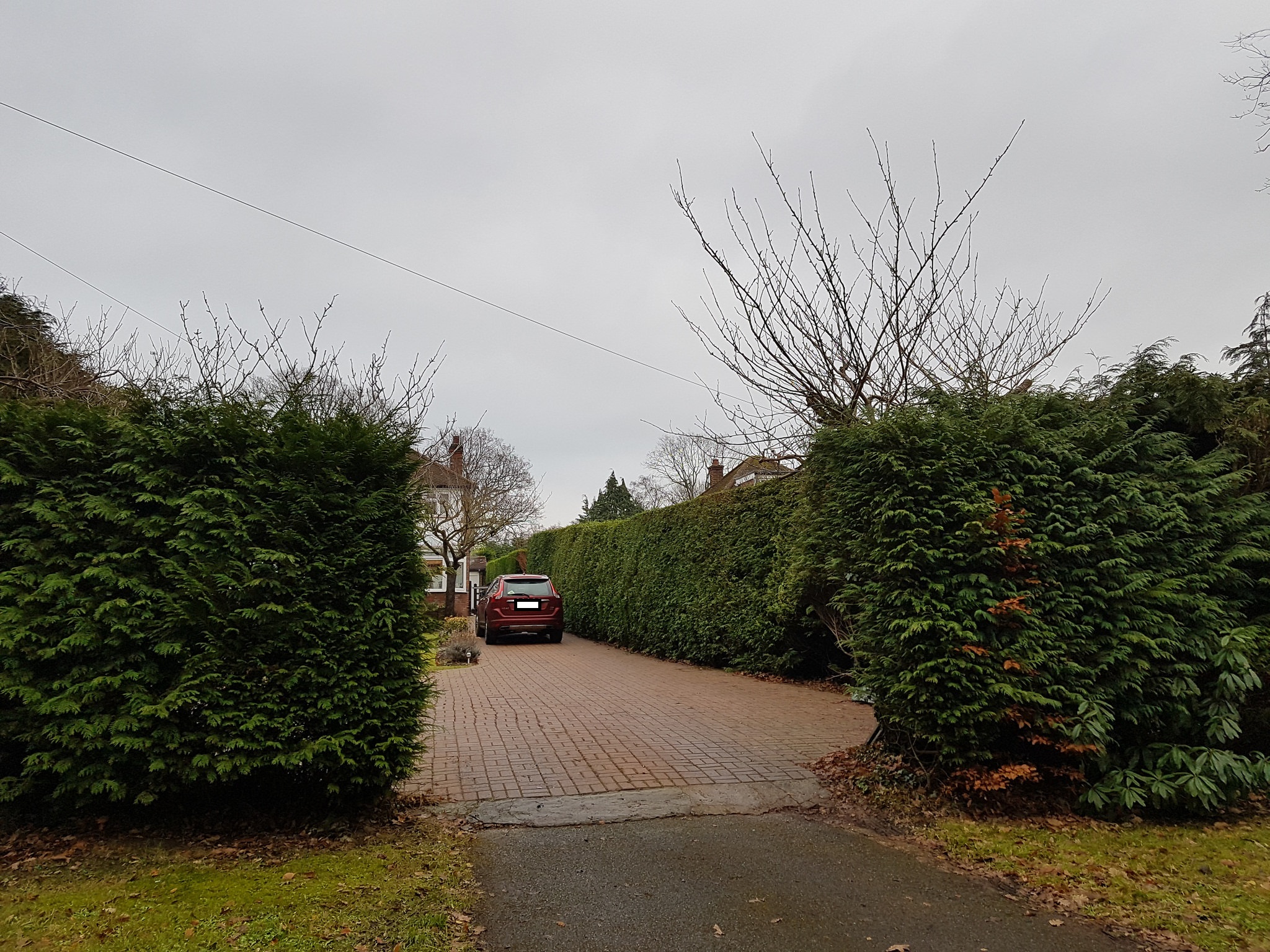

Posted

Posted
@JSHarris
Yes, our architect has suggested we submit to this requirement, but we have spent quite a lot on this already and I hoped we could avoid spending more. Clearly wrong in hindsight.
My problem with this street view is how to show that it is impossible to see much from the pavement. Of course the bird's eye view can be nice (or maybe not in our case) but general public can only see anything from the ground level. Apart from taking photos like the one attached I couldn't figure out what to give them!

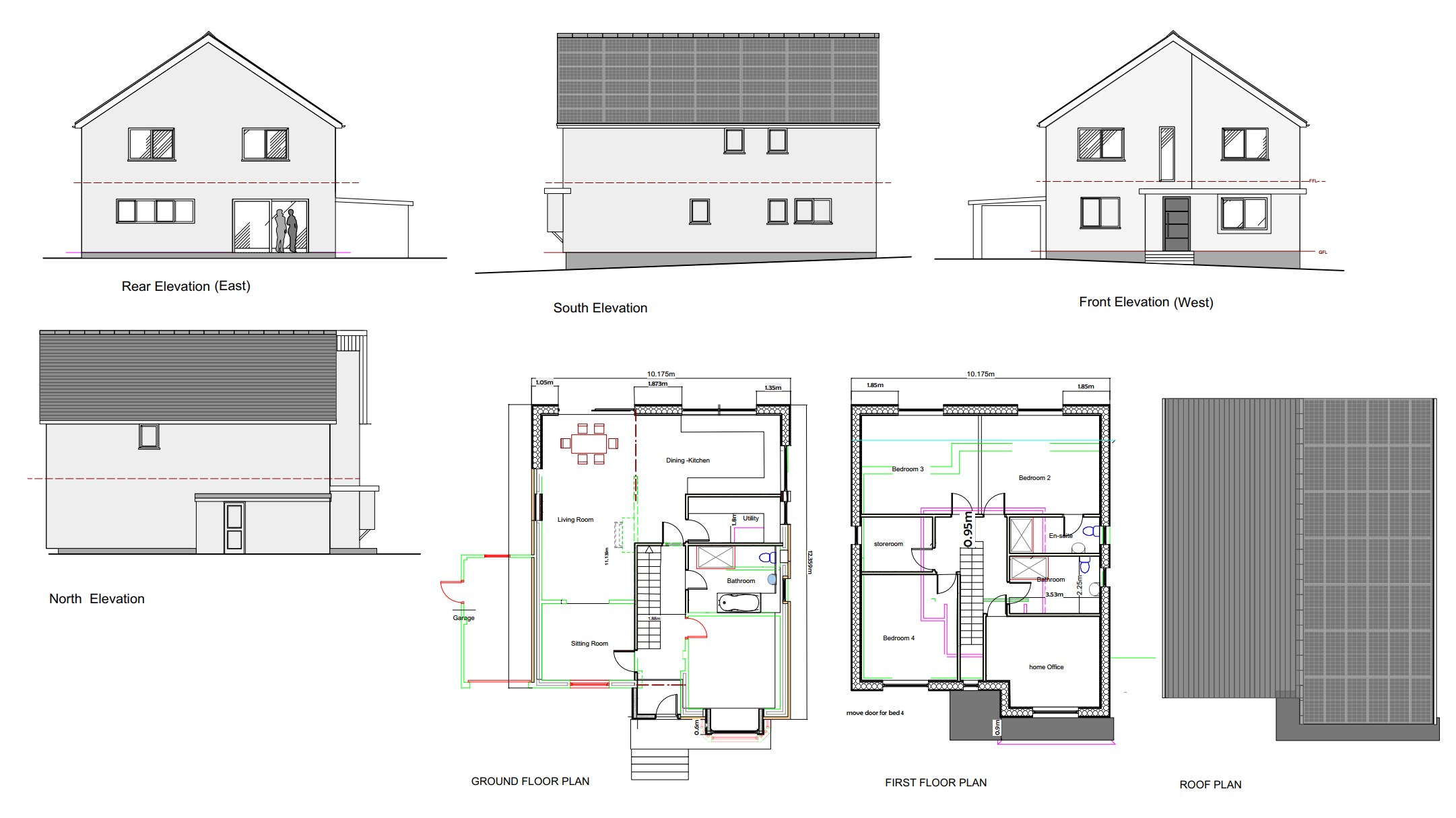

Posted
All I did was to provide two line drawings and a photo of our house model to address the "street scene" points that had been raised.  Here are links to the drawings, first the two drawings that compare the previously approved planning application for our site with our proposal, as a front elevation view, as a neighbour had previously raised an objection (not to our application, but previous ones) about any first floor gable end window overlooking their garden.  This also showed the apparent reduced "mass" of our proposal (even though the house in our proposal was around 30% bigger internally!):
7 - Elevation Comparison - Revision 1.pdf
Window sight line.pdf
Next they wanted to see how our proposal looked in section, relative to the house behind and further up the hill (I think this is a part of the problem some people have in being able to understand 3D from a 2D plan):
5 - Site Section.pdf
Also, because they had previously been an issue with earlier, refused, applications over the area of the plot that the house occupied, and as I wanted to build a bigger house, but with a smaller footprint, I did this comparison drawing:
6 - Site Plan Comparison.pdf
Finally, because it was clear from earlier correspondence that some of the consultees just couldn't read a drawing, I made a scale model, to show how the proposed house would be set deep down into the plot:

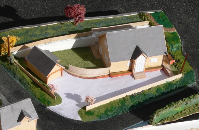

Posted
Thank you, Jeremy.
Of course I remember the model you've made. This was my concern exactly: view from above can be scary, but from the front it actually is not, well, not much worse than the other houses.
