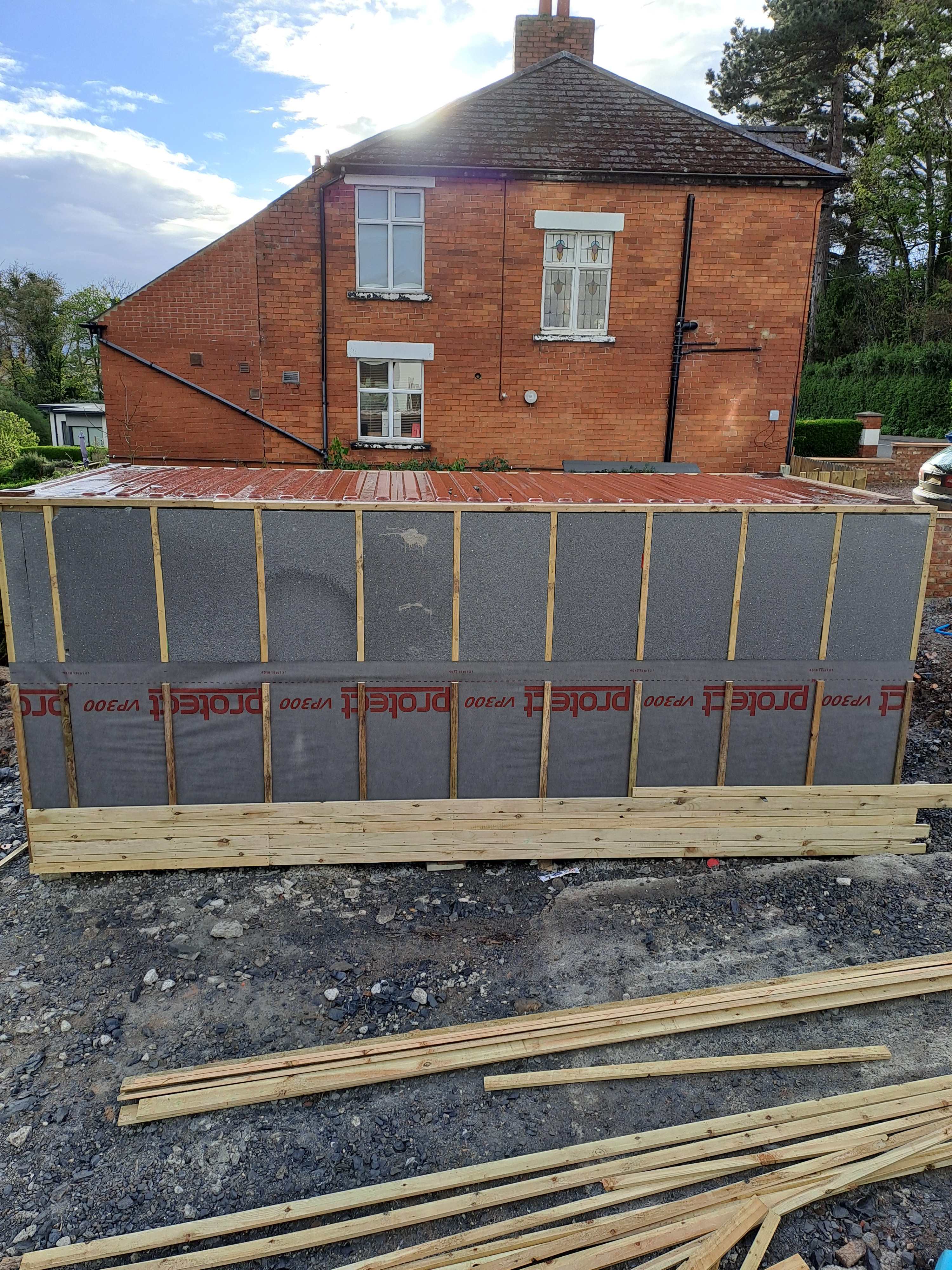

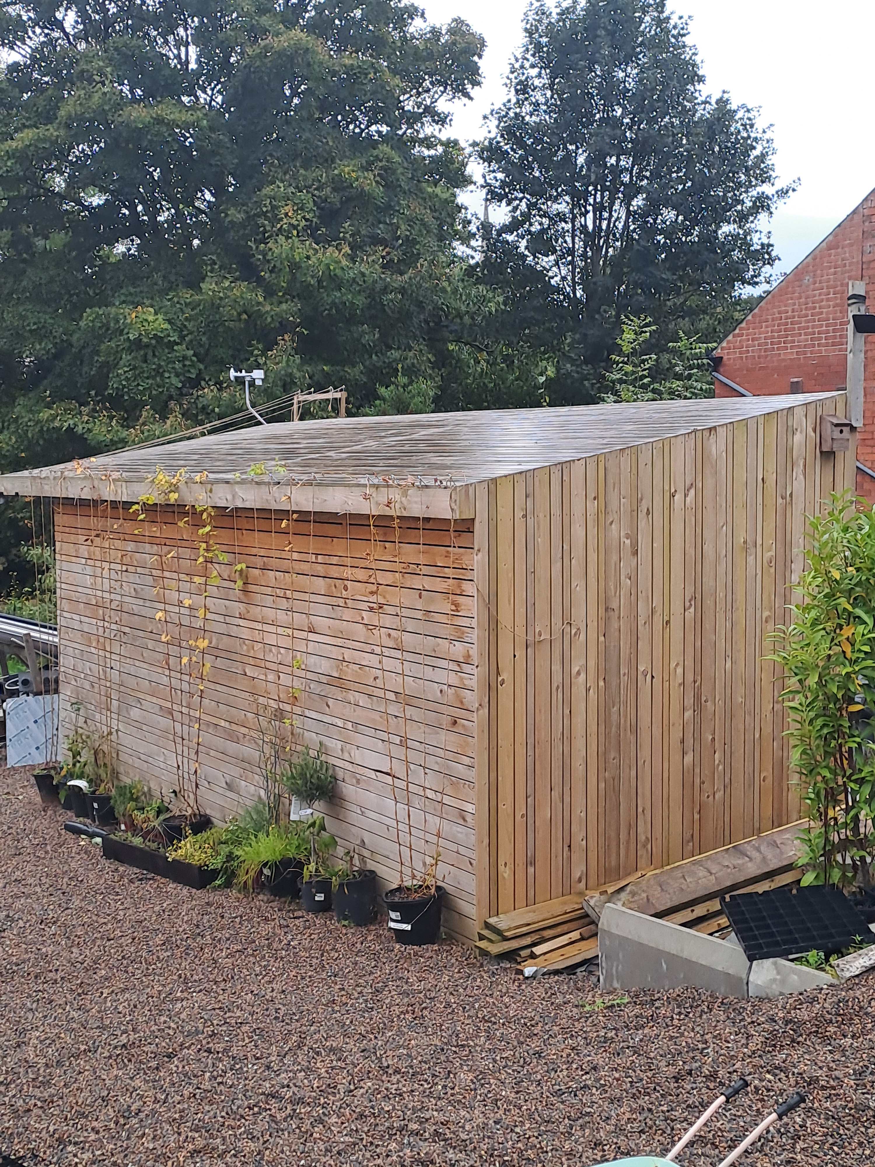

This is ours. Stud frame, hung with bolts on the lifting points, 100mm EPS, wrapped in roofing felt, and clad using ripped fencing boards. About £2k. Wish I'd just bought a shed instead. Not worth the expense and time.
  • Like 2
