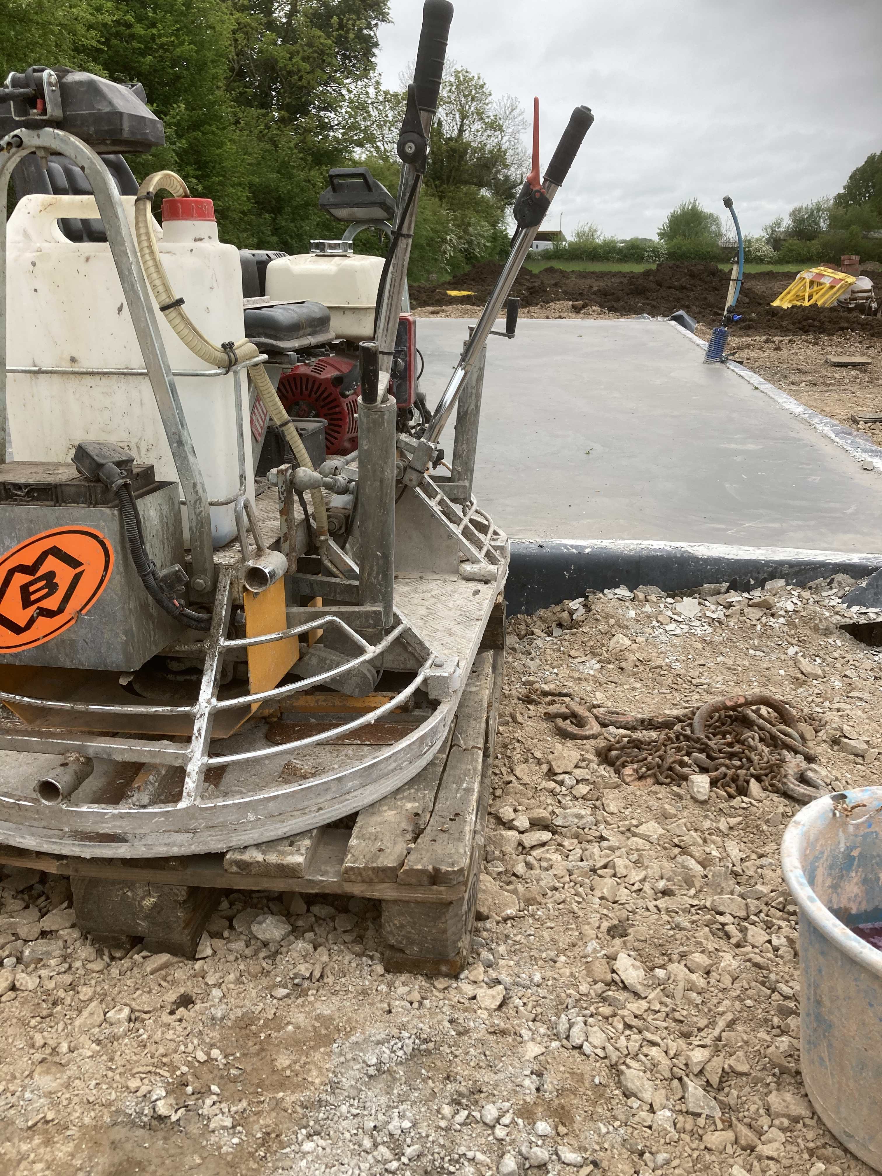

nod Posted September 7 Posted September 7 I borrowed a sit on power float for our garage floor Quite easy the following morning 1
Oz07 Posted September 7 Posted September 7 You'd have to osb the lot I reckon for decent protection. Probably could source some second hand boards from an old hoarding job. I think the finish would be ok but you'd still need some kind of sealer on it surely? @nod what time of year was your floor done? We've troweled up a garage floor before the next day morning but it was like Jan/Feb, this was after pouring at around 9am too. I don't think you'd get away with it in summer

nod Posted September 7 Posted September 7 1 hour ago, Oz07 said: You'd have to osb the lot I reckon for decent protection. Probably could source some second hand boards from an old hoarding job. I think the finish would be ok but you'd still need some kind of sealer on it surely? @nod what time of year was your floor done? We've troweled up a garage floor before the next day morning but it was like Jan/Feb, this was after pouring at around 9am too. I don't think you'd get away with it in summer August to September from memory Troweled it Then hit it the following morning with the ride on float

BadgerBodger Posted September 7 Posted September 7 So I’ve overseen a reasonable amount of power floated floor finishes and @-rick- has it figured. We use dry shake and a curing agent/sealer. We don’t protect the floors after and build entire power plants atop. There is some damage but not a huge amount considering we drive 120t cranes and 185ft cherry picker on it for 18 months. If I were doing it in my house (which i likely wouldn’t because of my partners taste but also it’s an f*ing hard surface with no texture underfoot) I’d do as above and use some proplex 3mm. OSB at a stretch. But it is repairable and there are a plethora of products to do so. Commercial concrete floor layers are definately your best bet. Probably think weekends. 2

nod Posted September 7 Posted September 7 1 hour ago, flanagaj said: Unfortunately, I just would not feel comfortable doing that job myself. If you can hire a sit on Its a real easy job My mate drove out to Scandinavia to collect his So I’m guessing there’s not lots of these about 1
