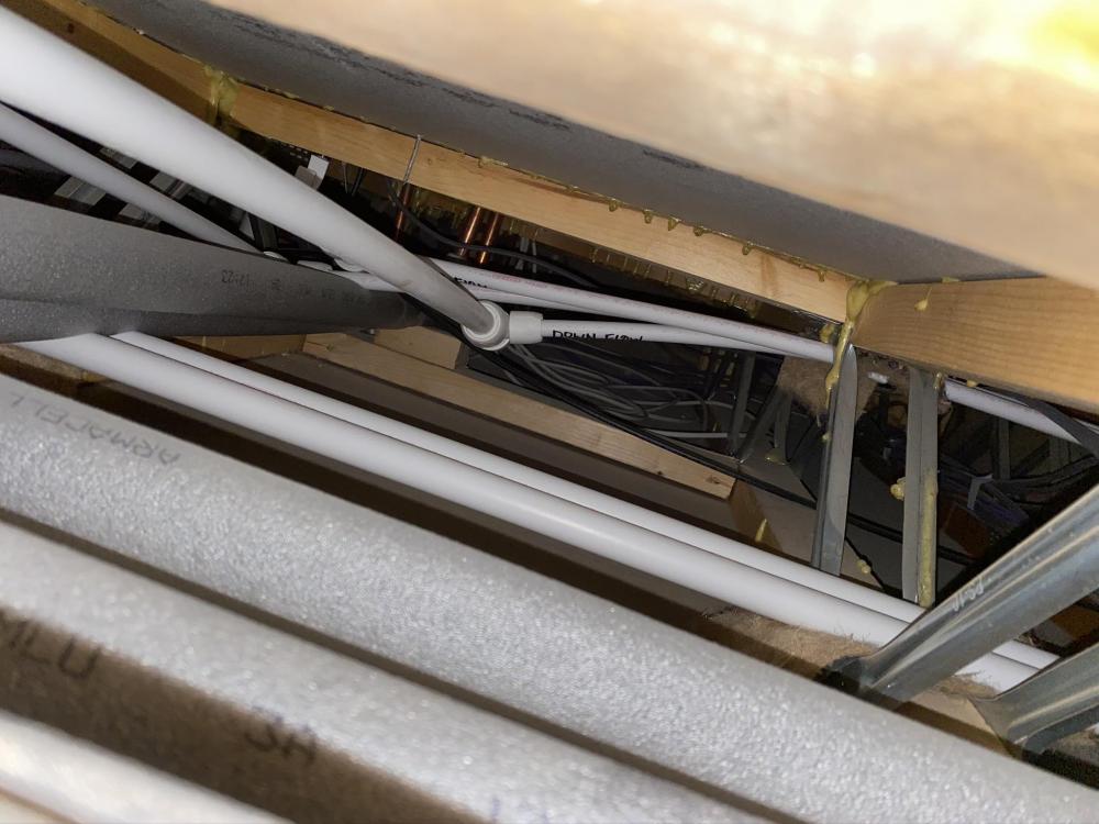

PeterW Posted February 9, 2021 Posted February 9, 2021 On 09/02/2021 at 10:48, Adsibob said: And there I was thinking copper pipes are better than plastic. I've specified copper pipes and brass fittings. Expand Why..?? Hep20 is quicker and cheaper and needs less joins and is much easier to install. It also has less impact on flow and pressure reduction. 1
joe90 Posted February 9, 2021 Posted February 9, 2021 On 09/02/2021 at 15:25, PeterW said: Why..?? Hep20 is quicker and cheaper and needs less joins and is much easier to install. It also has less impact on flow and pressure reduction. Expand +1, I was a late convert but my new build is all hep20, no joins, all single runs with no restrictive 90’ bends, hot and cold manifold, dead easy. A no brainier IMO.
