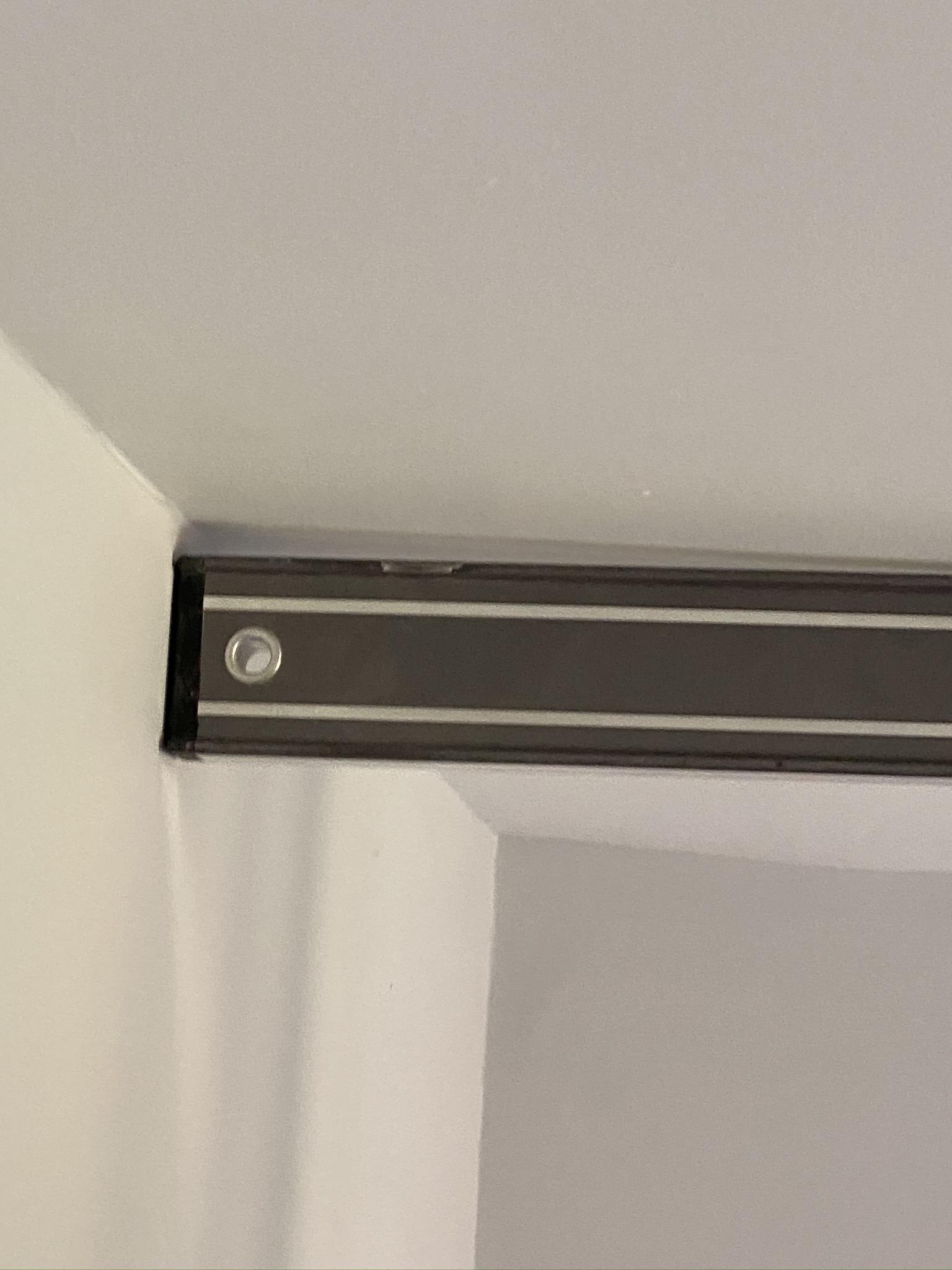

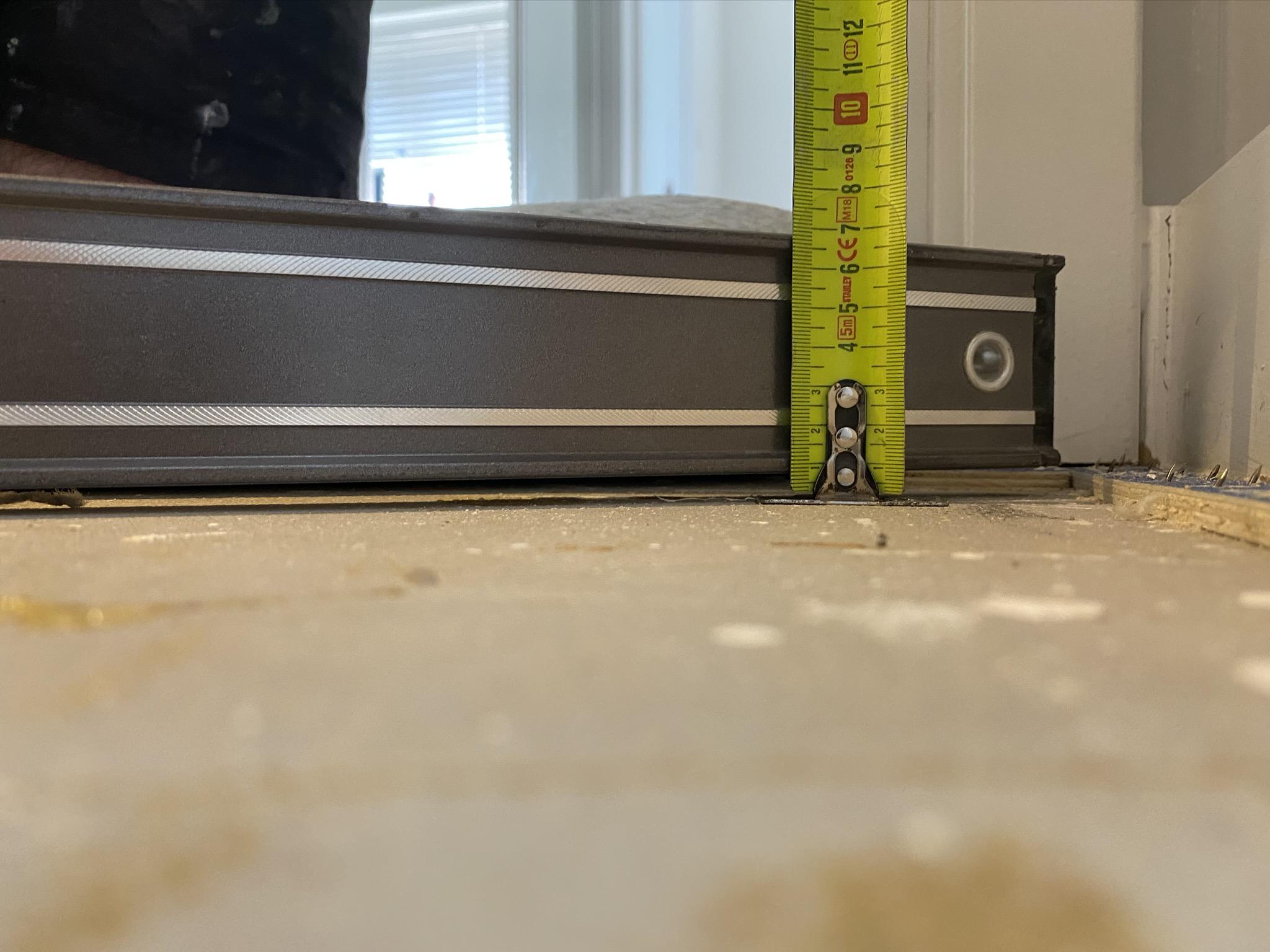

Gary Davies Posted May 21, 2020 Posted May 21, 2020 Hi All, Sorry to hijack this old convo. I am having an absolute nightmare with a new build home the flooring making awful cracking/clicking noises and just cant get the builder to resolve. Please see pics/videos below. Cheers IMG_9379.mp4 IMG_9363.mp4
ProDave Posted May 21, 2020 Posted May 21, 2020 If that's the strongback in picture 2, it does not appear to be connected to the joists.
Gary Davies Posted May 21, 2020 Posted May 21, 2020 Hi Dave, Yes i believe so the builders cut hatches isn't it supposed to be fixed upright and against the top of the joist! I think the flooring or ceiling needs removing to inspect in full! A carpenter had a quick look on the landing and the flooring is unlevel by around 10mm using a 6ft level. The ceiling below is the even worse!. Thanks Gary

PeterW Posted May 21, 2020 Posted May 21, 2020 Noggins will not fix this - sounds like the strongback has been missed from the floor joists (assuming metal web) or the joists themselves are not installed correctly. I would be taking ceilings down, not floors up, as the floors should be glued or bonded to the joists as they form part of the structure.
Gary Davies Posted May 21, 2020 Posted May 21, 2020 Hi Peter, Yes metal web posi joists the builders cut hatches in the flooring which has created more creaking and clicking noises. The flooring is moving quite badly upstairs and bounces when not even jumping shakes the wardrobe and drawers etc. (I'm not saying it should be solid and not flex!) One carpenter has quoted to lift the floors and when i asked how he would do that he said cut around the stud walls!! I know the floorboards don't look fitted correct some appear to not have the glue and looks like they used ring nails which some have missed the joists below! His suggesting the following Take up floorboards Replace and fit with correct glue Take down ceiling Clip up loose pipes Raise Joist Re board and plaster Thanks

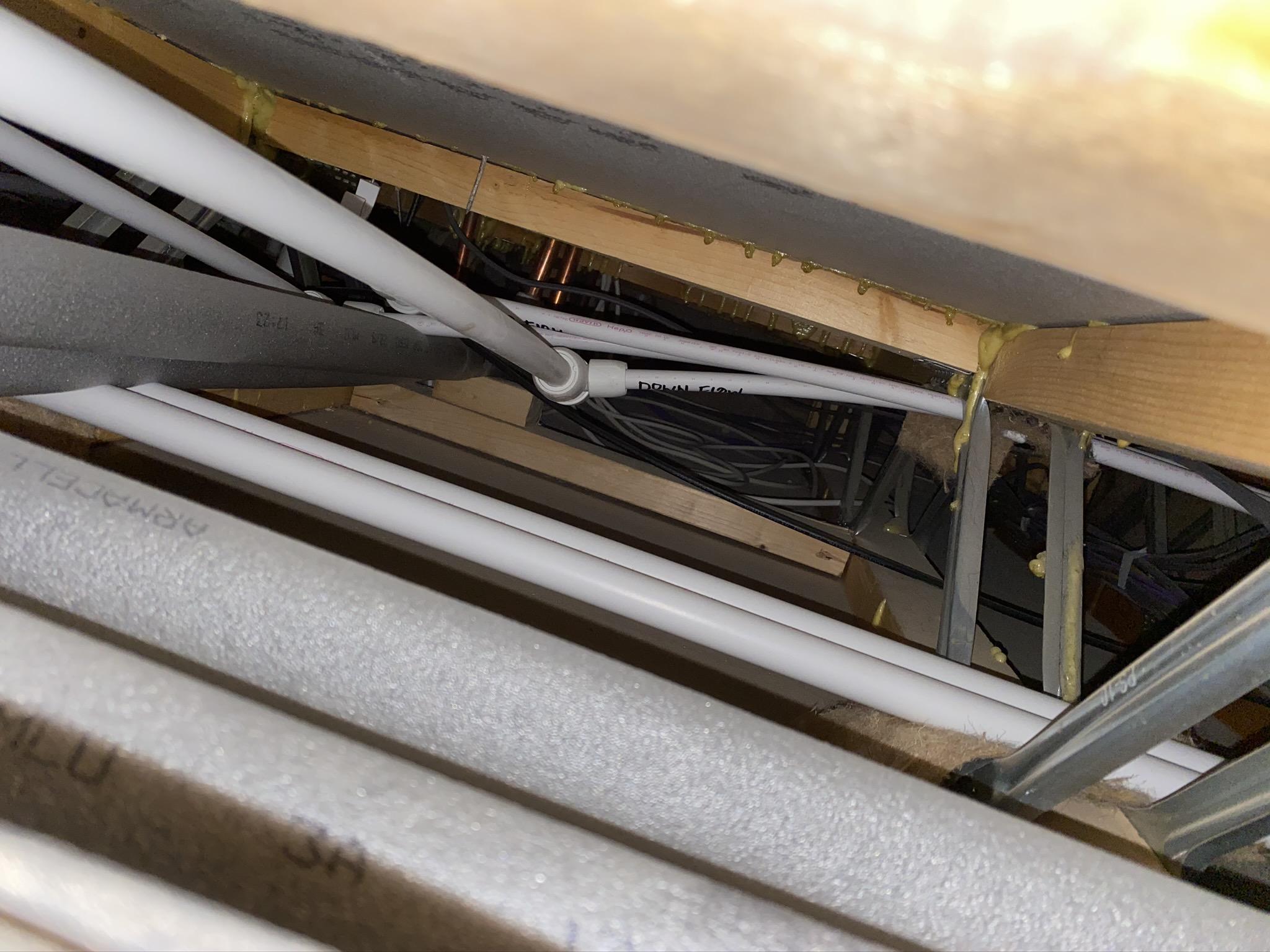

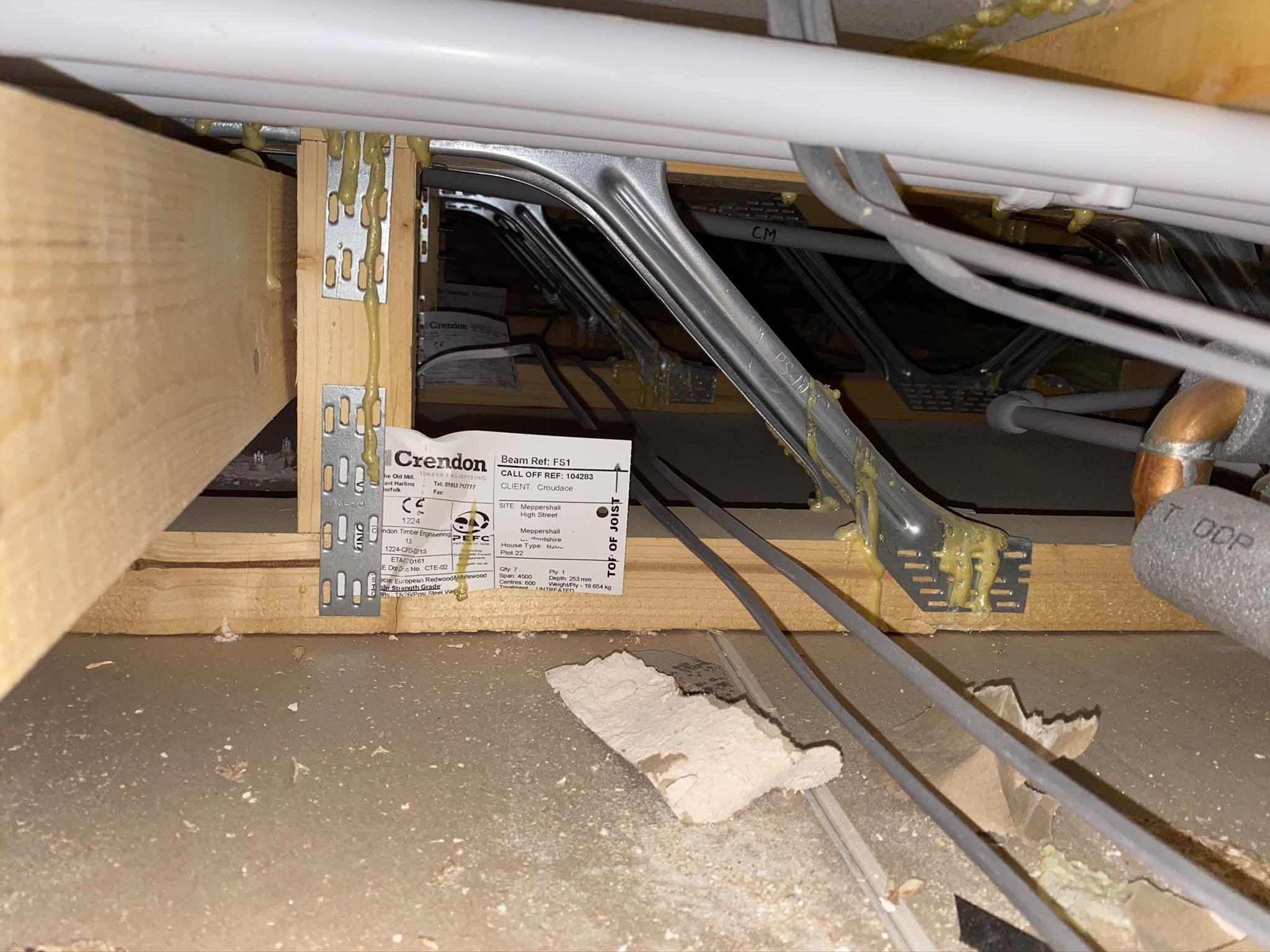

ToughButterCup Posted May 21, 2020 Posted May 21, 2020 1 hour ago, Gary Davies said: ... not 100% sure if the joists are secured correctly at the ends is the best way to check this to get the ceilings down? Unfortunately , yes. You might get away with cutting an inspection hole for a random sample of joists , making a generalised judgement about how adequately they are fastened and then making good as necessary. In the preceding posts, I smell aggro. It might be as well to get an independent surveyor (RICS ?) to write a proper report, and then present that to whoever needs to see it. It'll take away all the you-said-she-said-thats-not-needed nonsense that you appear to be facing. And get the surveyors fee added to the bill.
epsilonGreedy Posted May 21, 2020 Posted May 21, 2020 (edited) 3 hours ago, Gary Davies said: One carpenter has quoted to lift the floors and when i asked how he would do that he said cut around the stud walls!! I know the floorboards don't look fitted correct some appear to not have the glue and looks like they used ring nails which some have missed the joists below! Pulling up the D4 foam glued floorboards would damage the joists, don't do this. Glue plus nails is standard practice, a few nails that missed the joists is fairly typical providing 95% found their target. The absence of sound proofing material between the floors looks like a significant transgression of building standards. My advice would be to: Find a surveyor who is experienced at NHBC disputes. He will help clarify what build anomalies are acceptable and what you should pursue e.g. whinging about a few off target ring nails will undermine the credibility of your claim with NHBC. If the surveyor thinks the problems are substantial get a plasterer to quote for pulling down and reinstating the ceiling. With the ceiling down you can spend a week cataloging the noise sources and then the surveyor can produce a fix list. Edited May 21, 2020 by epsilonGreedy
ProDave Posted May 21, 2020 Posted May 21, 2020 I would start buy cutting an exploratory trap in the ceiling to have a better look. Squeaking and creaking boards, even with a missing or not secured strongback says to me not glued, just laid dry and nailed. If that is the case the boards need to come up, which would allow you to fix the strong back, and then re lay the boards glued and screwed.
Mr Punter Posted May 21, 2020 Posted May 21, 2020 You need to take action against NHBC. Their tolerances for floors are poor and there is a fair bit of allowable deflection. If they are acknowledging it as defective, the remedy will be very disruptive or impossible depending on the ground floor walls / first floor joist layouts. Explain that you are unwilling to accept a cash settlement. You need to go in hard with them and keep going. Come back to us as many times as you like until you get it resolved to your complete satisfaction. 1
epsilonGreedy Posted May 21, 2020 Posted May 21, 2020 16 minutes ago, Mr Punter said: You need to take action against NHBC. Their tolerances for floors are poor and there is a fair bit of allowable deflection. I wonder if @Gary Daviescould obtain a copy of the technical floor design from the joist supplier shown in the photos?
