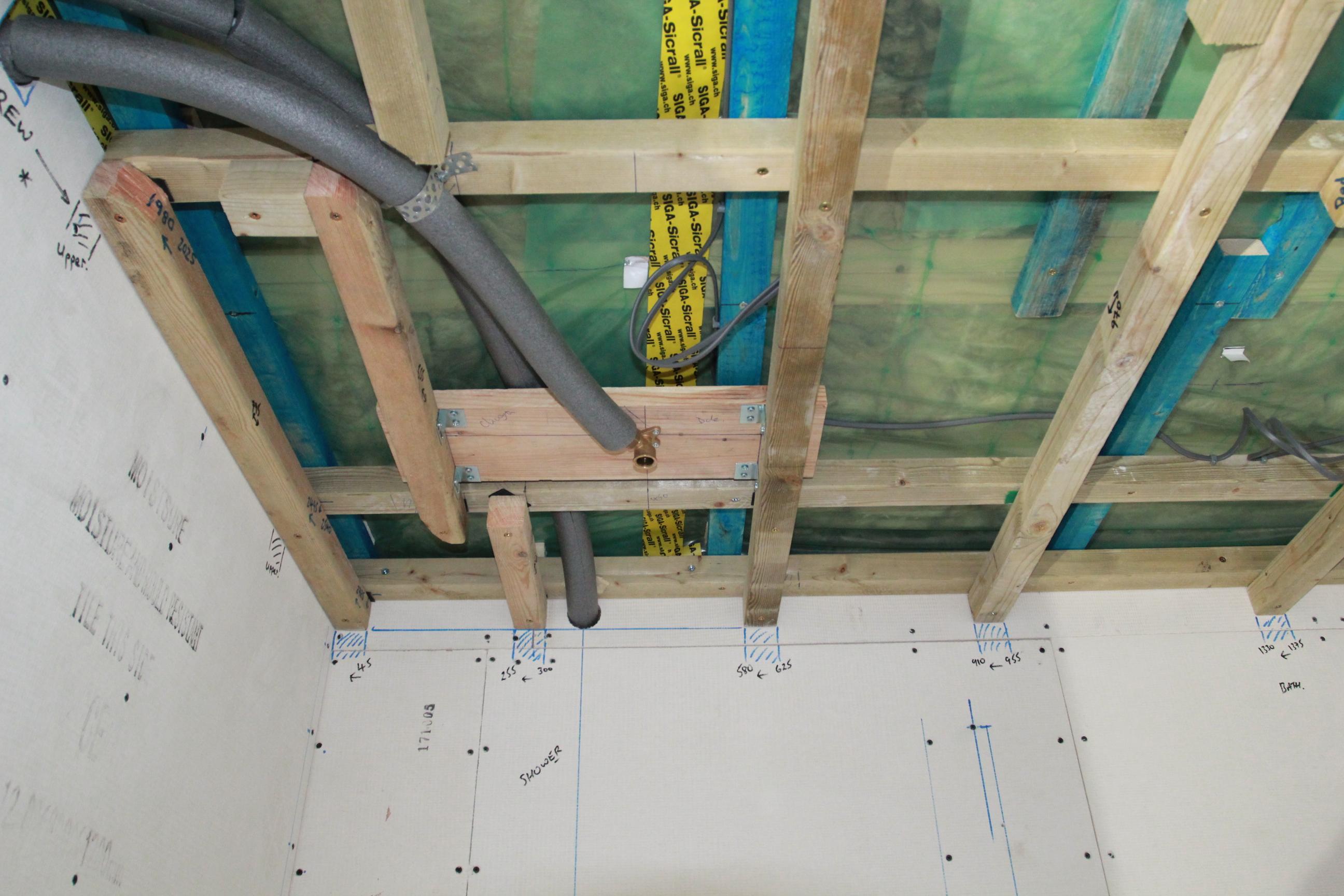

Onoff Posted April 26, 2018 Author Share Posted April 26, 2018 (edited) Setting out for the rainfall shower and I thought I'd get down off the stool and have a beer. Back up I went and promptly marked out about the other mark I'd originally marked for a downlight when I wasn't having a rainfall head or mitred corner! Bear in mind the mitre corner board wasn't in place as I was insulating the wall. Boy did it look wrong when I put the corner board in! Duly adjusted: I've the centre of the shower 570mm from the mitre board. Seems to give me enough elbow room. Fitting a ceiling shower arm then. Yet to get one. Seems there's a short type: And a longer version: Both the above are Hudson Reed dimensions. Does the short one day affix to a thin steel bracket above the plasterboard and the longer one through a noggin? Cheers Edited April 26, 2018 by Onoff Link to comment Share on other sites More sharing options...
PeterW Posted April 26, 2018 Share Posted April 26, 2018 Both just fix to a 1/2” male iron on a piece of copper. Last one I did I put a ballofix on the end of the copper on a swept bend and clipped the bend to the joist above. I reinforced the ceiling with 3 squares of plasterboard stuck on with no nails or similar and then drilled the hole from below. Bit of silicone around the rim of the hole and pushed the piece through from the top and a baby wipe later it was all done. Looking at that one, it’s a smaller hole and then the back nut holding it on so probably just needs the PB pad making up about 3 sheets thick. 1 Link to comment Share on other sites More sharing options...
CC45 Posted April 26, 2018 Share Posted April 26, 2018 Ive just fixed a tap outlet to some ply - up behind the plasterboard. Once the new skim is dry its going to be drilled to expose the outlet and then ptfe and screwed in. Job done. 1 1 Link to comment Share on other sites More sharing options...
Onoff Posted April 27, 2018 Author Share Posted April 27, 2018 Thanks @PeterW & @CC45. If ever you remove the shower head for cleaning is it just then a case you need to firmly grip the chrome stalk coming out of the ceiling to stop that turning, or you could end up undoing / backing off the joint in the loft and affecting it's PTFE joint? Link to comment Share on other sites More sharing options...
PeterW Posted April 27, 2018 Share Posted April 27, 2018 Head has a rubber washer in it like a shower hose - stem is done up tight into the fitting with PTFE as per any joint and then the head just spun on to finger tight so comes away easy. If you are using stillsons to put a shower head on then you’re doing it wrong..... 1 Link to comment Share on other sites More sharing options...
CC45 Posted April 27, 2018 Share Posted April 27, 2018 Ive got that HR ceiling arm. No washer came with it? the tap fitting cant move - 3 screws hold it in place. I put loads of ptfe on it and screwed it hand tight into the tap fitting. Pressure tested up to 6 bar - no issues. As @PeterW said no stillsons necessary! Link to comment Share on other sites More sharing options...

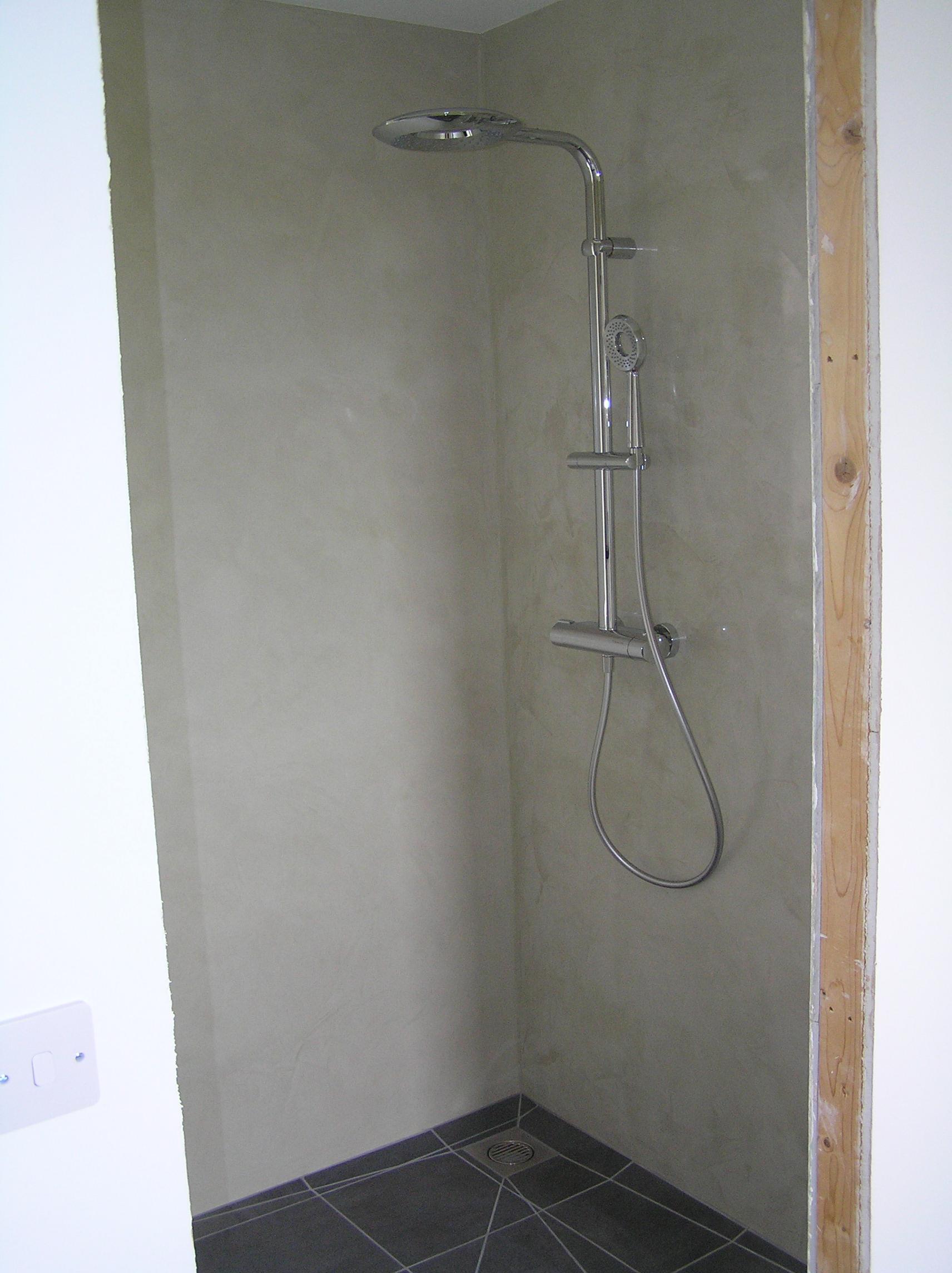

jack Posted April 27, 2018 Share Posted April 27, 2018 On 05/01/2018 at 12:25, ProDave said: having spent a week in a house with this sort of shower I would say I would most definitely NOT want it as my only shower. Personally I hate water falling on my head all the time with no option to get your head out of the water. Give me a wall mounted adjustable spray head any time, I can wet my head when I choose and just wet my body when I choose. All I am saying is find someone with this sort of shower and give it a try before you commit to that as your only shower. You may like it, you may not. We have high overhead showers in the new place. As I'd feared, it's exactly as you say - virtually impossible to shower without having your entire head under running water. I also don't think they rinse as well/quickly as an angled wall-mounted shower head. One thing it's done is reduce our water consumption. I used to be a big one for thinking in the shower in the morning, but now I just wash and get out. Interesting that a larger flow shower would be a net reducer of water consumption! Link to comment Share on other sites More sharing options...

Hecateh Posted April 27, 2018 Share Posted April 27, 2018 I love the rainfall shower - and only last week had the same 'discussion' with my sister who prefers the wall mounted, adjustable one. Link to comment Share on other sites More sharing options...
joe90 Posted April 27, 2018 Share Posted April 27, 2018 Well I know people who hate rainfall heads and I like “ normal “ ones so I installed dual ones where you can switch from one to the other. Everybody is then happy ( I hope!). 1 Link to comment Share on other sites More sharing options...
Onoff Posted April 27, 2018 Author Share Posted April 27, 2018 5 hours ago, jack said: I also don't think they rinse as well/quickly as an angled wall-mounted shower head. That's why I'm making the walls strong enough to do a handstand... 1 Link to comment Share on other sites More sharing options...
newhome Posted April 27, 2018 Share Posted April 27, 2018 3 hours ago, joe90 said: Well I know people who hate rainfall heads and I like “ normal “ ones so I installed dual ones where you can switch from one to the other. Everybody is then happy ( I hope!). I love rainfall showers but have the dual ones as on occasion I just want a quick shower without washing my hair and it’s much easier to do that with a normal shower head that’s not raining down on top of your head. Link to comment Share on other sites More sharing options...
Hecateh Posted April 27, 2018 Share Posted April 27, 2018 34 minutes ago, newhome said: I love rainfall showers but have the dual ones as on occasion I just want a quick shower without washing my hair and it’s much easier to do that with a normal shower head that’s not raining down on top of your head. Me too, the normal shower is better for rinsing our hair dye to as you can hold it closer and don't get the dye splashing everywhere so much, Link to comment Share on other sites More sharing options...
Gone West Posted April 27, 2018 Share Posted April 27, 2018 7 hours ago, jack said: We have high overhead showers in the new place. As I'd feared, it's exactly as you say - virtually impossible to shower without having your entire head under running water. I also don't think they rinse as well/quickly as an angled wall-mounted shower head. You could try a shower cap or the type we have that allows both options. 1 1 Link to comment Share on other sites More sharing options...
